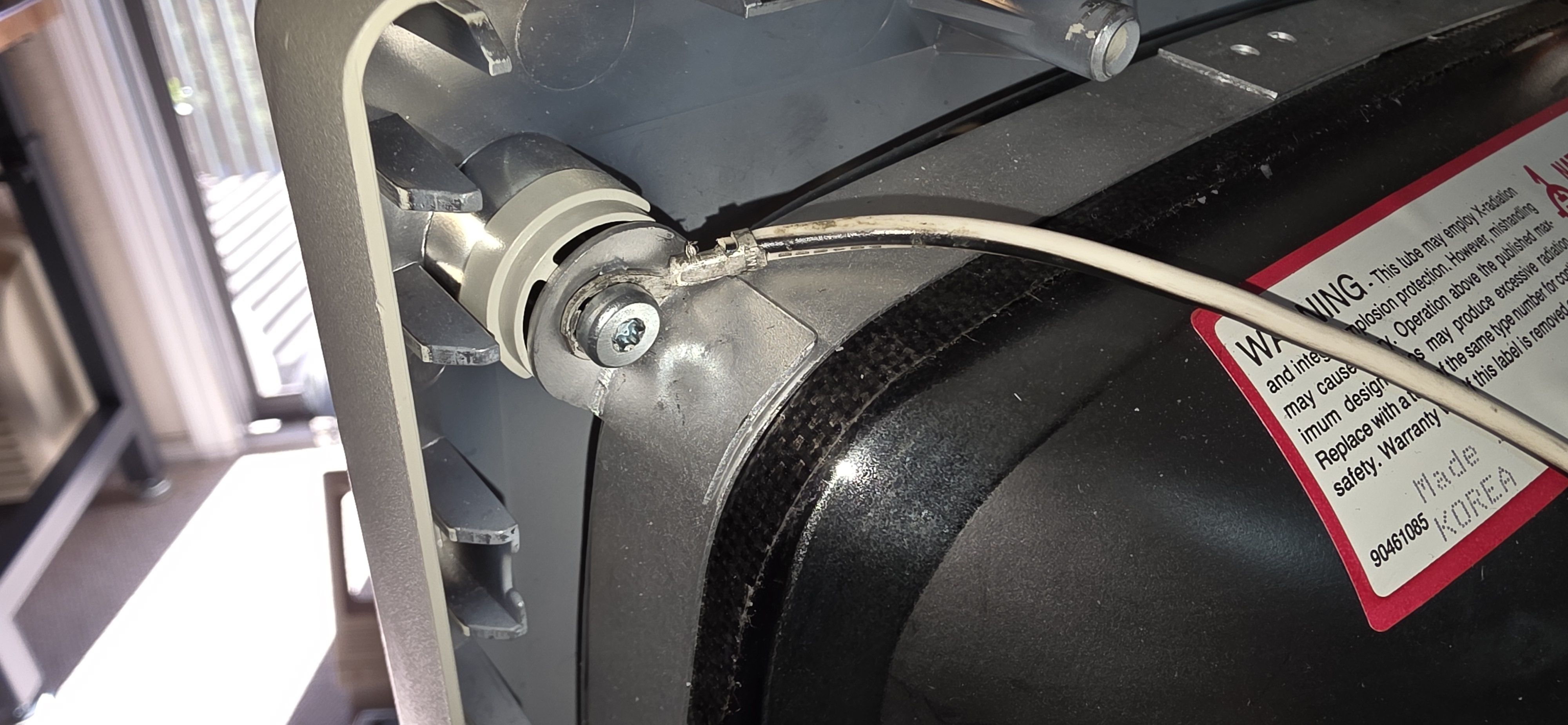

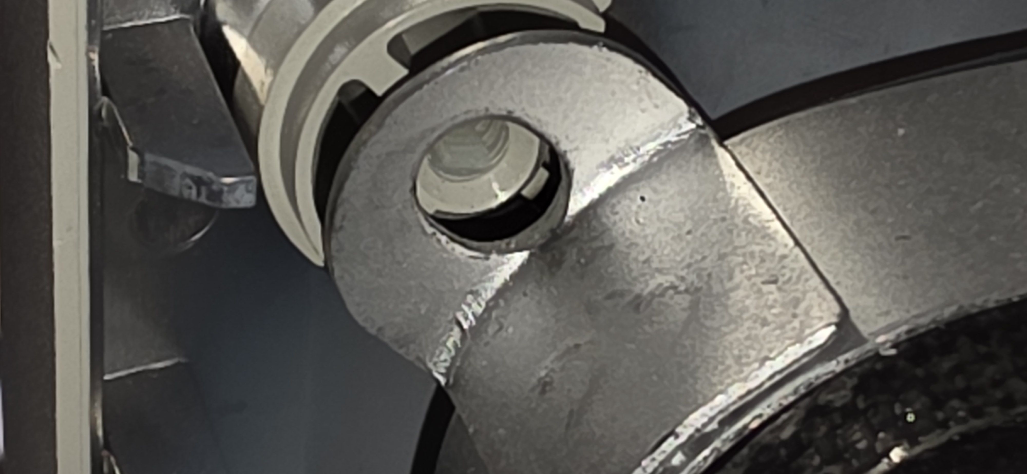

Specifically I'm looking to fix the screw hole where the CRT is grounded to. My front case/bezel arrived with the CRT ground hole in a stripped condition and when that screw pops out, the ground wire lets loose and I get video distortion.

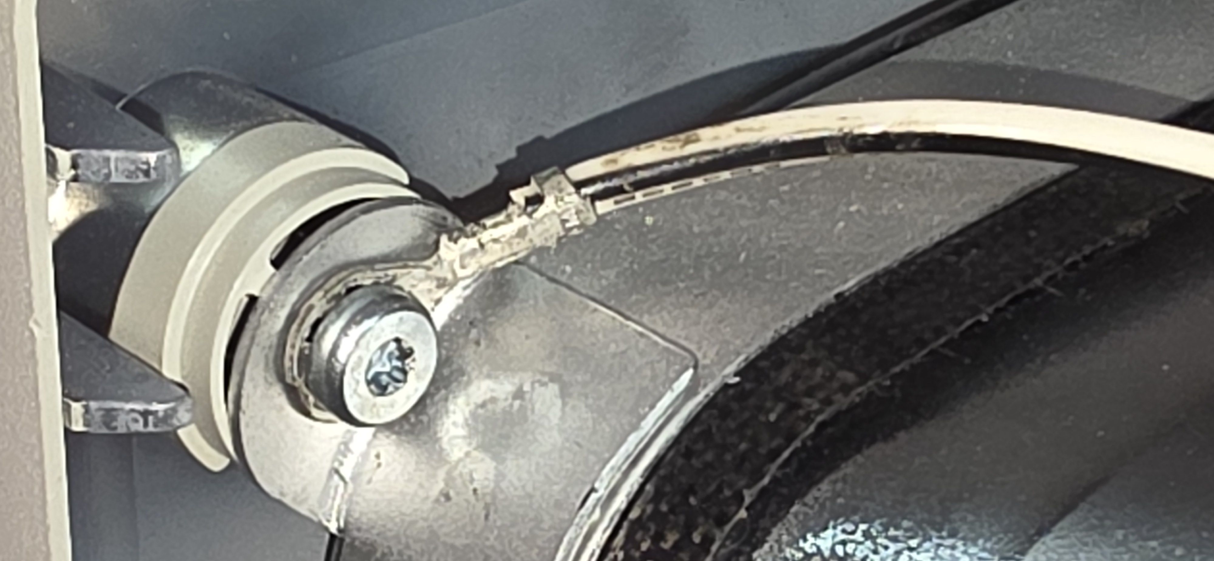

I won't say the following is the best way to fix a stripped case thread but I can say this definitely worked for me.

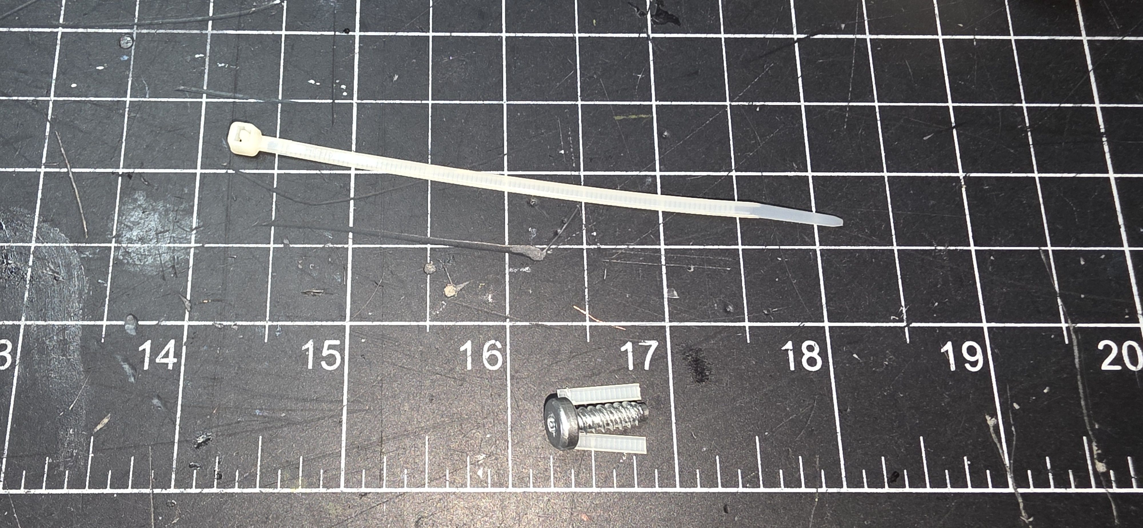

Take a small-medium size clip tie and cut two pieces of it as long as the screw threads are:
If the case isn't badly stripped, just one piece of clip tie may be enough, insert the piece in the hole:

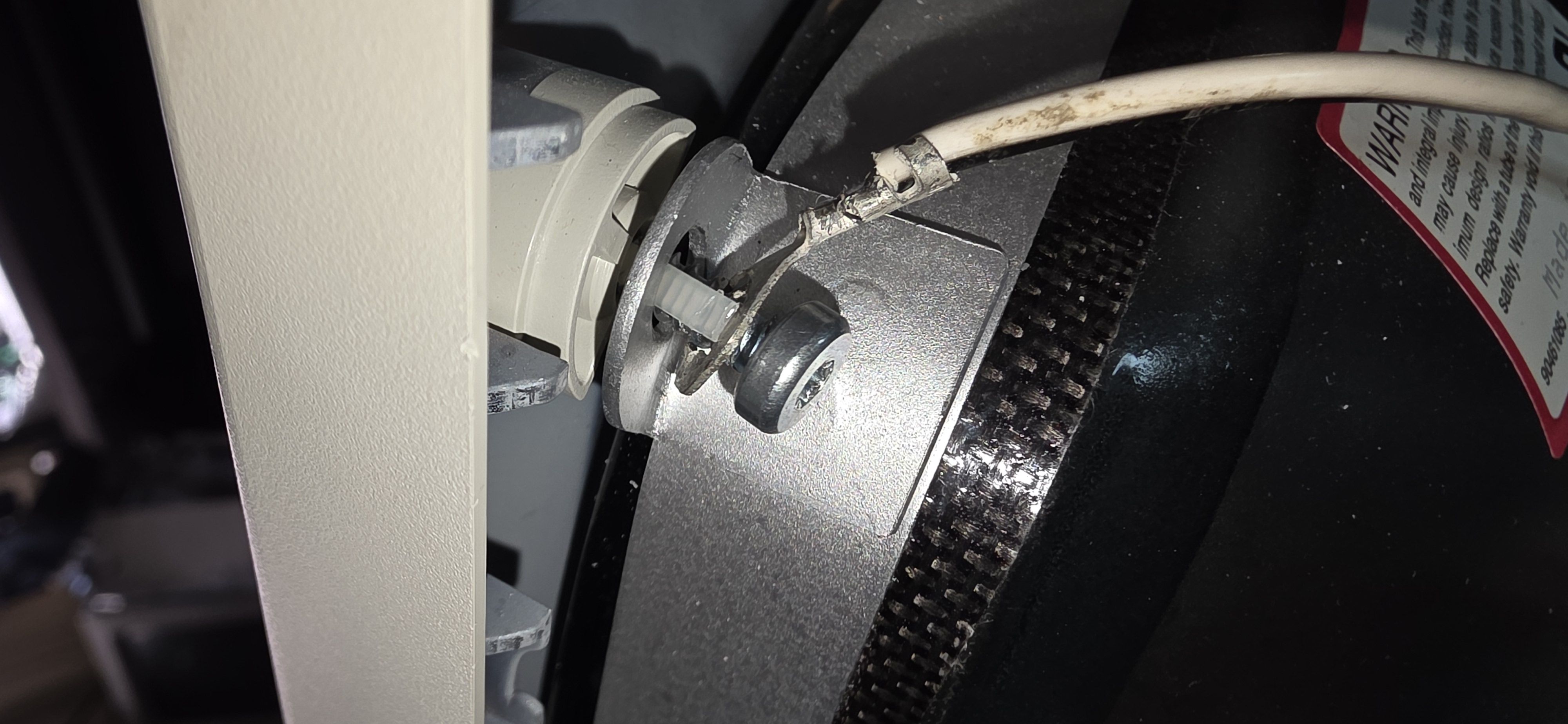

Put the screw on top of it and twist it in:
If the case is badly stripped, remove the screw and put the second piece of clip tie on top of the screw:
Screw it in:
And cut off the excess:
Much easier and less of a mess than JB Weld, or baking soda and super glue.
