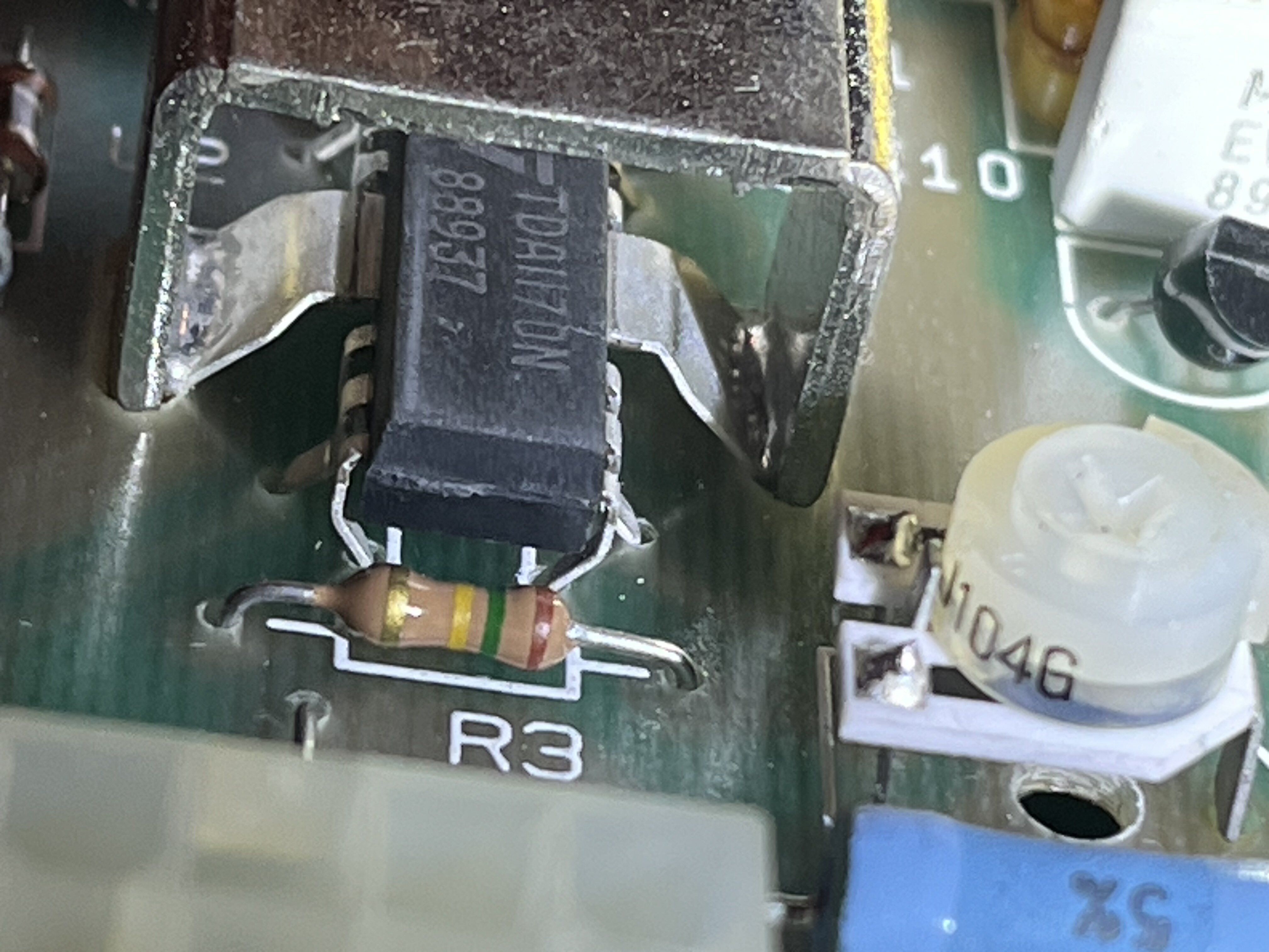

My se/30 just started doing this out of the blue. going to try a different analog board first, then see if I can source a chip from somewhere.
wondering if there’s a significant difference between a TDA1170n, sh, s… I’m guessing there is. I found at least TDA1170N in France.
Reactions: MacOfAllTrades
