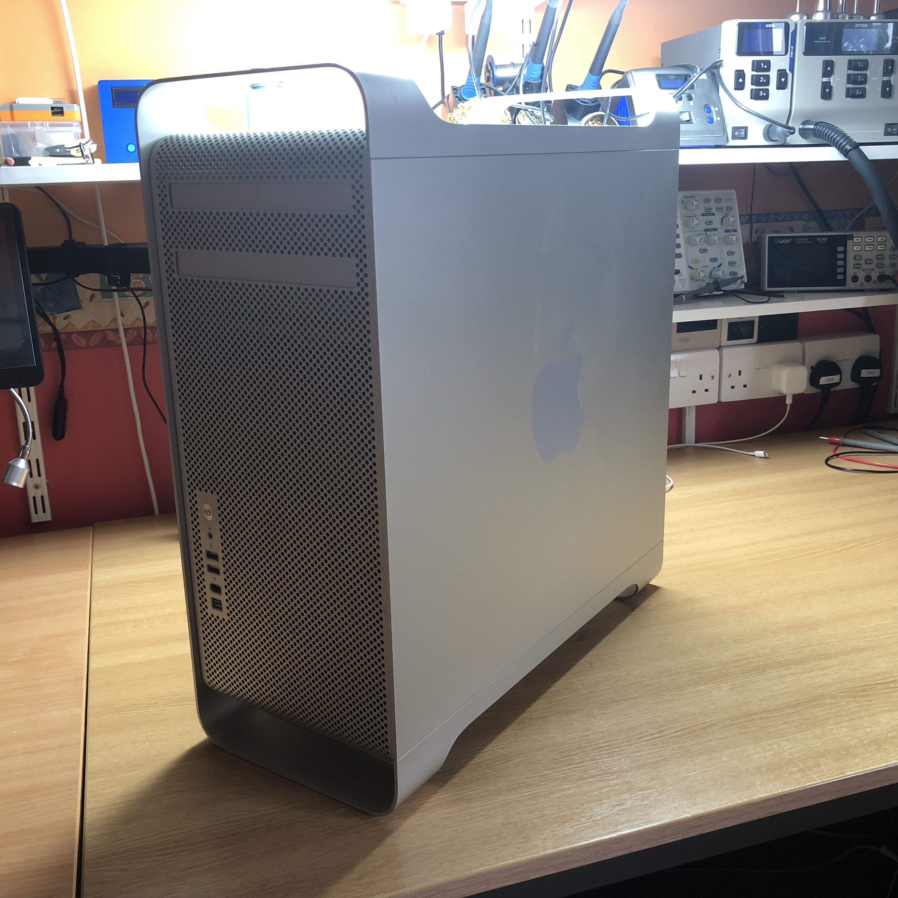

Hi folks,
I was gifted as part of a IT clearance I did, an Apple Mac Pro 1.1 in amazing cosmetic condition but there is a problem.
The original owner said it just started rebooting after it had been on for a while. I removed the hard drive and fitted into her 5.1 MacPro so she has access to any data that might not have been backed up (it happens to even the best).
Anyways, got the 1.1 back to the workshop and fitted a new HDD and installed Lion on it but sure enough when it’s been on for a while it randomly restarts (took 3 attempts to install macOS).
My question therefore should I try and fix it? Or break it? Any ideas what can cause these machines to do this?
Seems a shame to break it and still possibly has a use even today.
your thoughts!

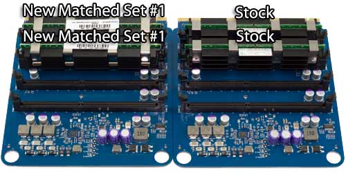

Sorry, yeah, G5 will run with a single DIMM, but intel requires 2. OWC lists 1 in each if you are only using 2. But I have run them with 2 in either riser as well.
Two DIMMs (standard configuration)One on the top memory card and one on the bottom card
Four DIMMsFour DIMMsOne pair on the top memory card and one pair on the bottom card
Six DIMMsSix DIMMsTwo pairs on the top memory card and one pair on the bottom card
Six DIMMsSix DIMMsTwo pairs on the top memory card and two pairs on the bottom card
https://eshop.macsales.com/Customiz...=install_videos/macpro/macpro_quicksheet.html

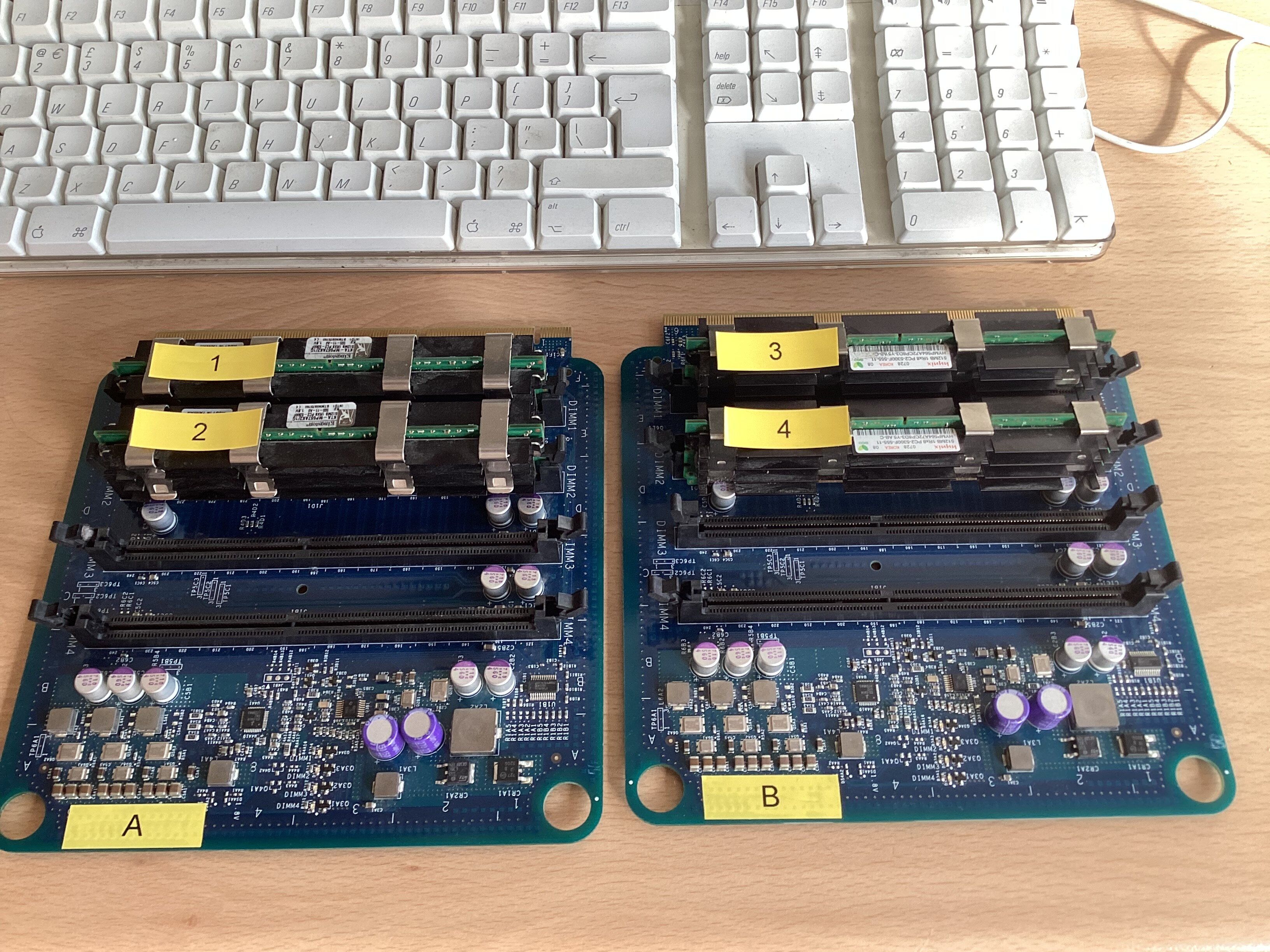

Umm this is weird.
first off, thanks go out to @phunguss for suggesting memory as that seems to be where there is a Bus issue.
For clarity Riser A top, Riser B bottom DIMMs in riser A 1+2 and in riser B 3 and 4
Removed DIMMs 3 and 4 from riser b - machine runs fine
Swapped DIMMs 1 and 2 for 3 and 4 in Riser A - machine runs fine.
DIAGNOSIS: DIMMS OK?
Swapped riser A for riser B (A moved to bottom and B now top) with DIMMS 1 and 2 in riser B - machine runs fine.
DIAGNOSIS: Riser A and B ok?
moved riser B with DIMMs 1 and 2 to bottom and empty riser A to top - machine still ok.
Fully populated riser A with DIMMs 1, 2, 3 and 4 - machine runs fine. (Is there an issue running it this way?)
But machine will not work with DIMMS in both risers.
Solution? Put larger capacity DIMMs in one riser only.
Any advice very welcomed as I think it would be a shame to scrap this. I can get a replacement logic board here in the uk for about £40, is that the way to go.
Just as an aside- the machine used to be used in the original config that now exhibits the pro let almost daily.
So you are saying riser A had ram in slot 1+2 and riser B had ram in slots 3+4? The correct config should be both A+B with ram in 1+2 (closest to the edge connector).
Yes your pictures show the config I am using.
In my description DIMM 1, 2, 3 and 4 refer to the actual physical DIMM
Regardless of whether using RISER A or B DIMMS are in Pairs in the slots nearest the edge connector so RISER A is populated in Slot 1 and Slot 2 and Riser B is populated in Slot 1 and Slot 2.
Currently I am using it with Riser A populated with DIMM 1, 2, 3, 4 in Slots 1, 2, 3, and 4 and Riser B is Empty.

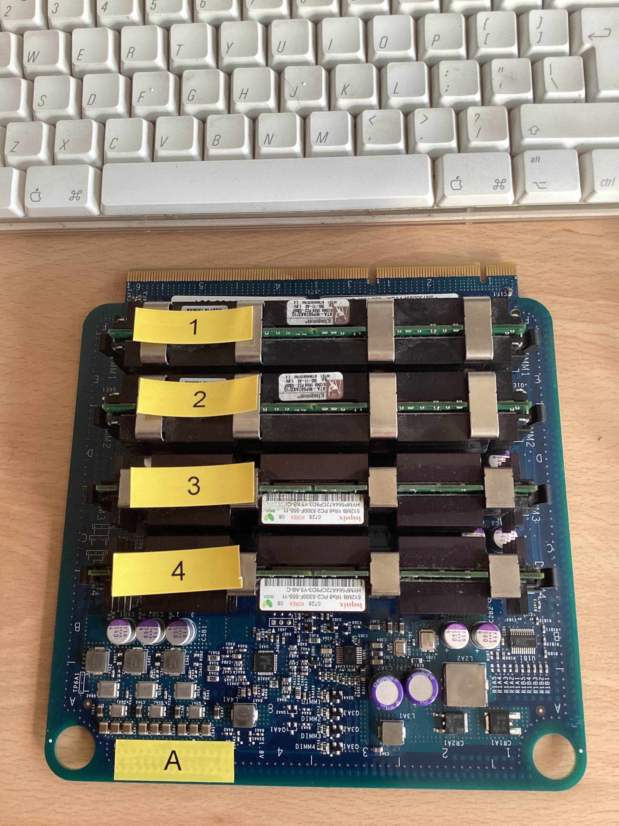

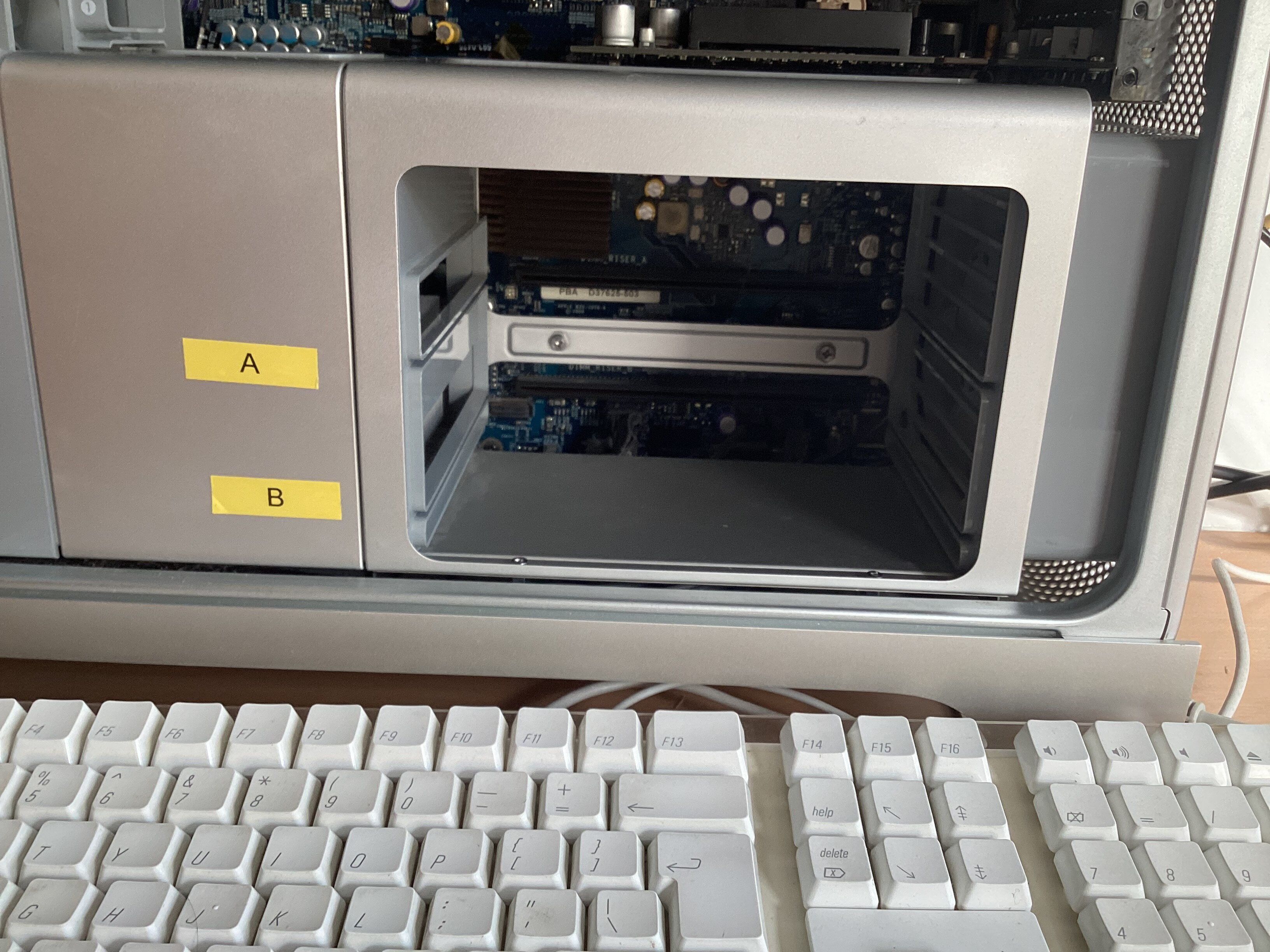

IMG_0443/4/5 Not working configuration but how I tested each board singularly with the other riser empty. (and yes the clips are open on Riser B it's just for reference and not used in service lol)
IMG_0446 How I am using it now and working perfectly but not to Apple recommendation.
I don't think it will work in the other slots (3 and 4 only) as the bus needs to see output from a preceding down? stream DIMMs in order to address the higher memory addresses to be allocated.??
