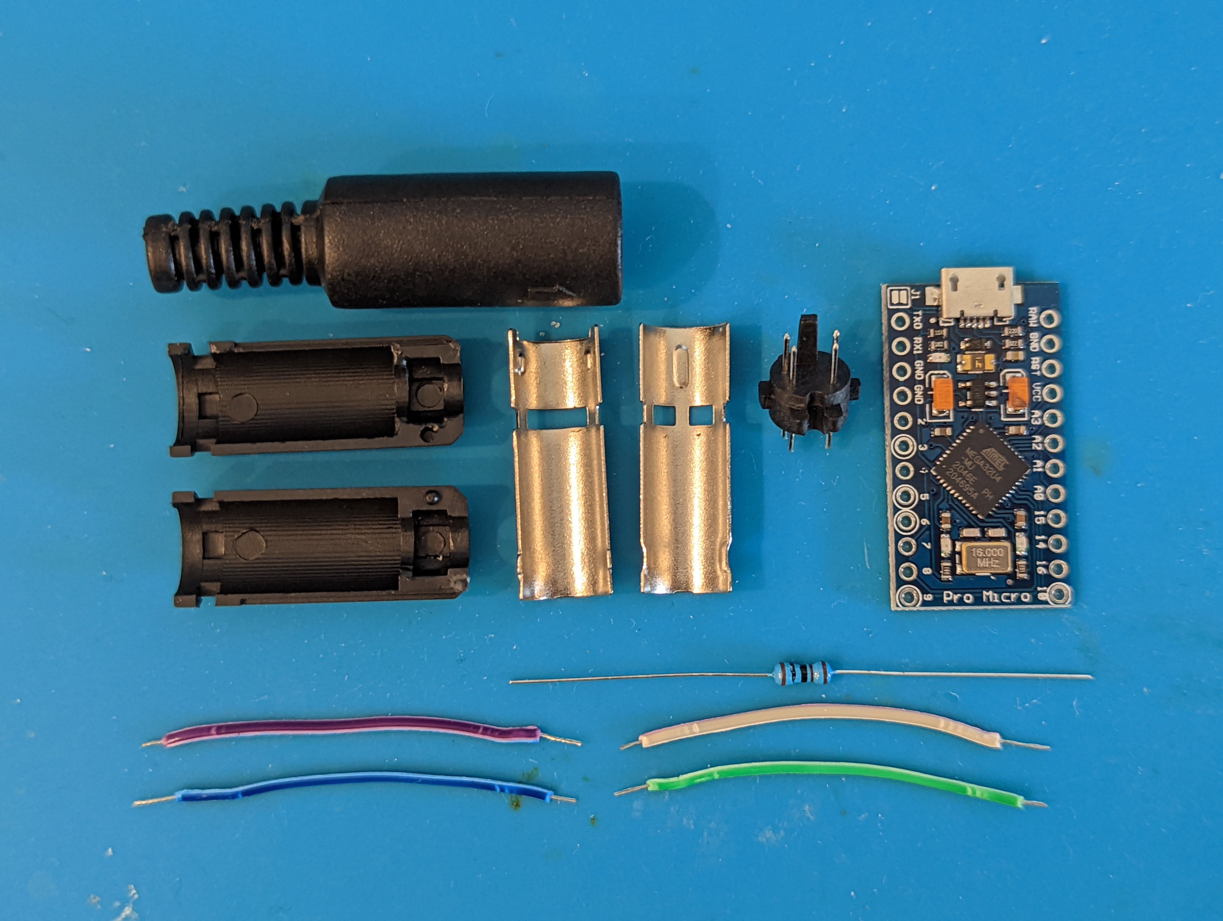

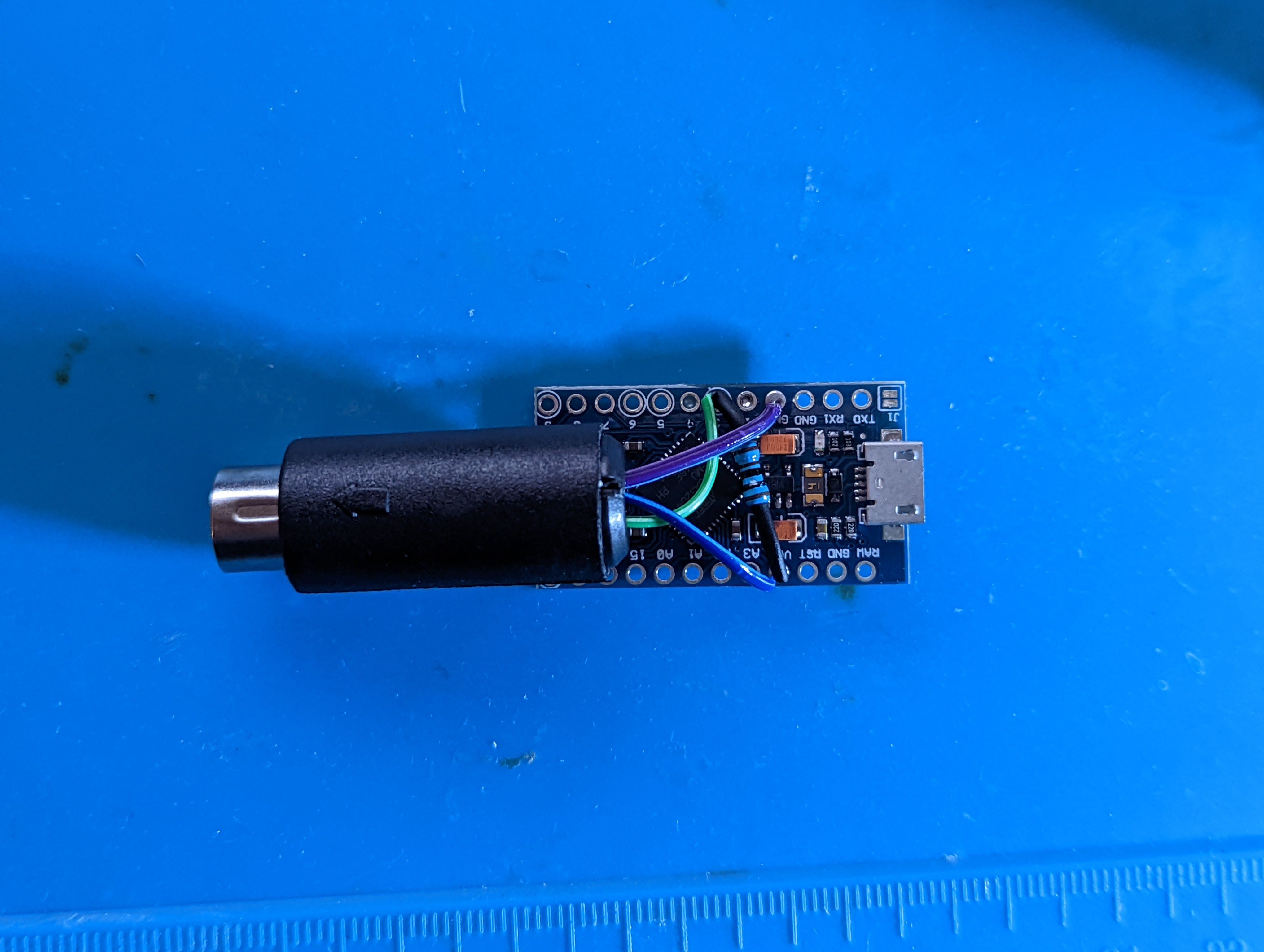

Required components: ATMega32u4, mini 4pin din (male or female), 1k - 10k Ohm Resistor, 3 wires.

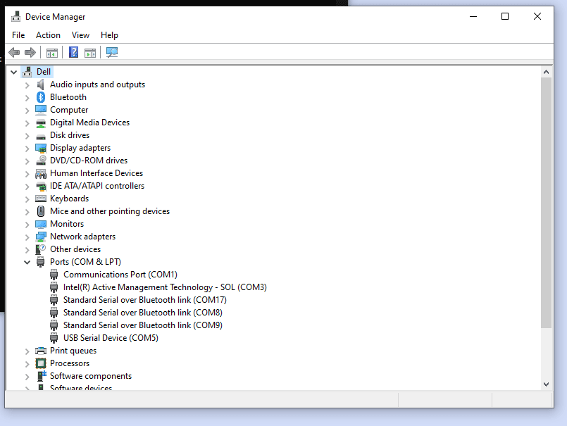

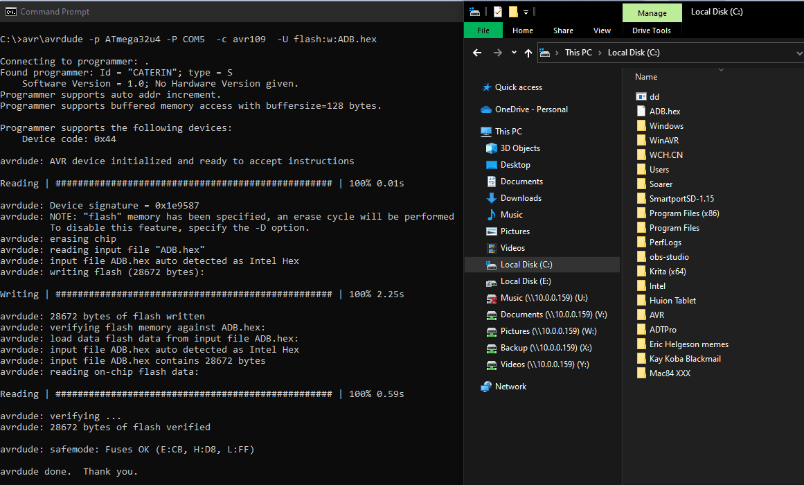

You will want to know exactly what Com port the Pro Micro is assigned, Open up device manager and plug in the device. Here we see it appears as "USB Serial Device (Com 5)"

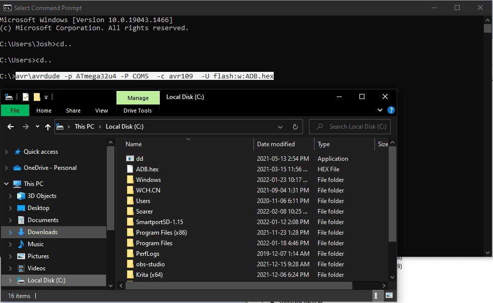

Open your Command Prompt as Administrator and navigate to your C:\
knowing YOUR com port prep the following command BUT Don't execute just yet!
avr\avrdude -p ATmega32u4 -P COM5 -c avr109 -U flash:w:ADB.hex

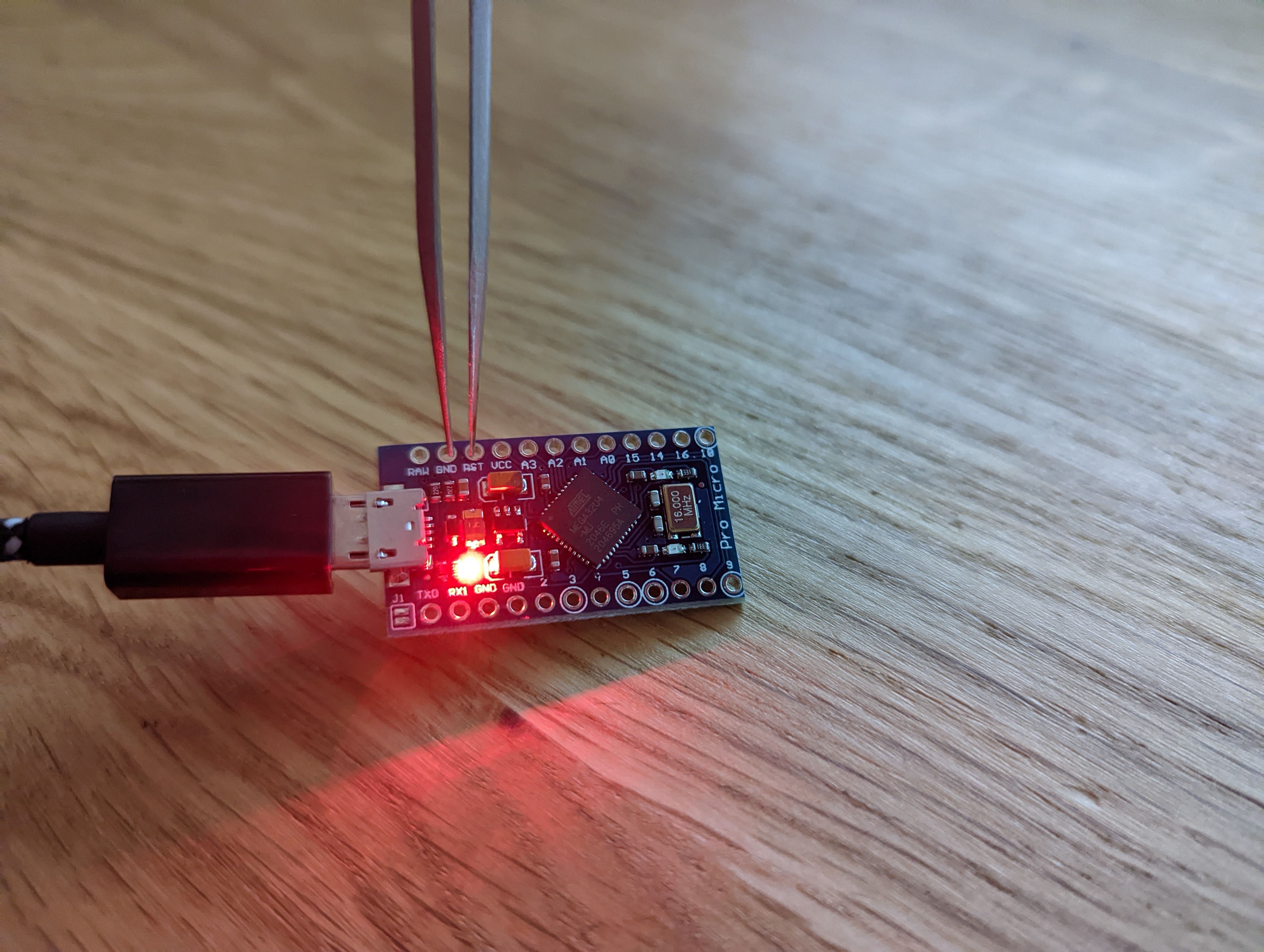

The Pro Micro will need to be tripped into boot mode to accept our firmware, this is achieved by bridging GND + RST twice, slowly. Once you've done that hit "Enter" and execute the command.
If successful AVRDude will begin the erase and flash process on the Pro Micro, It should look like the following:
If flash verified, you are now ready to assemble the device!

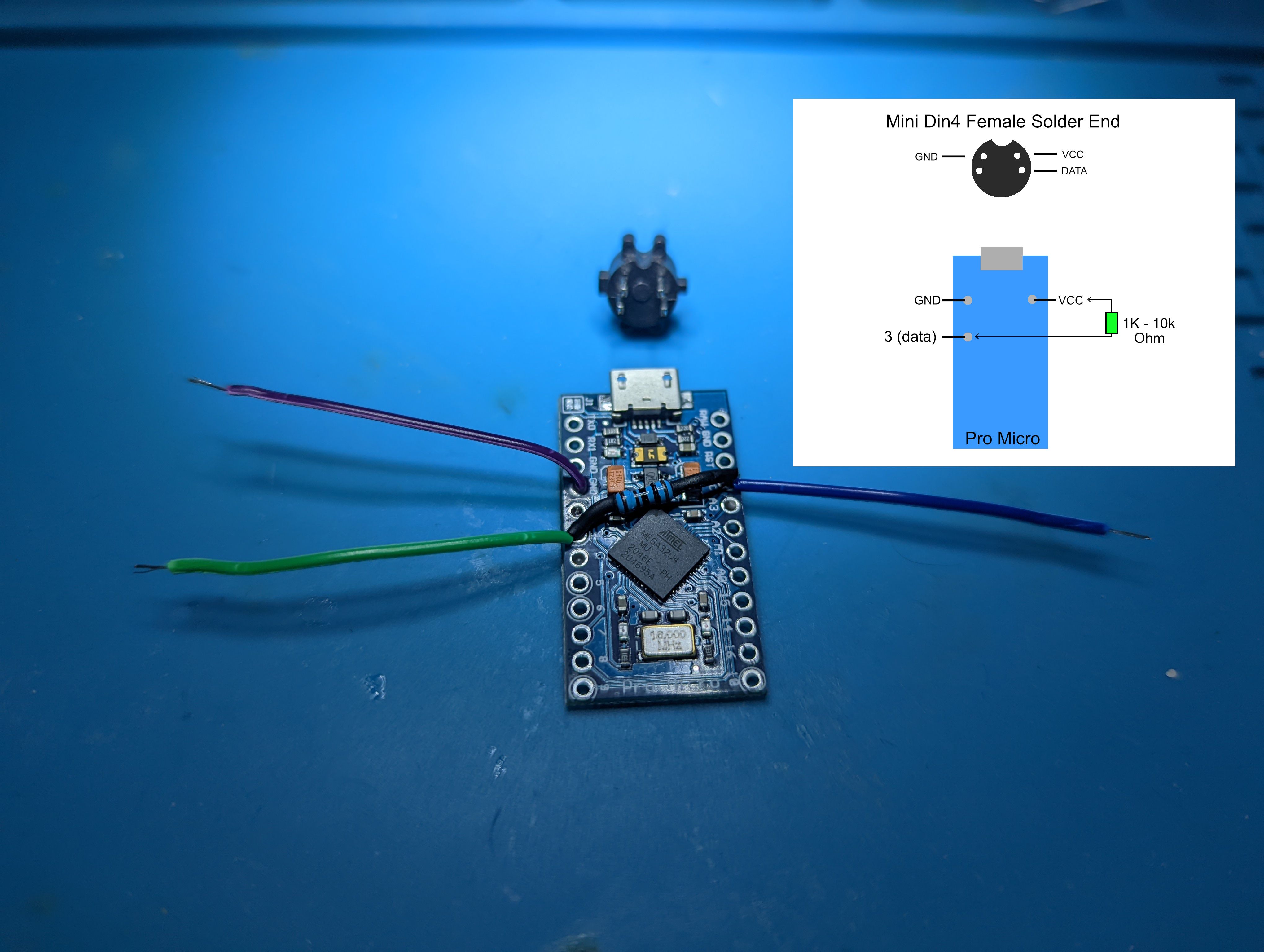

The ADB connection is quite simple and only requires 3 wires and one pull up resistor. You can see the pinout here:

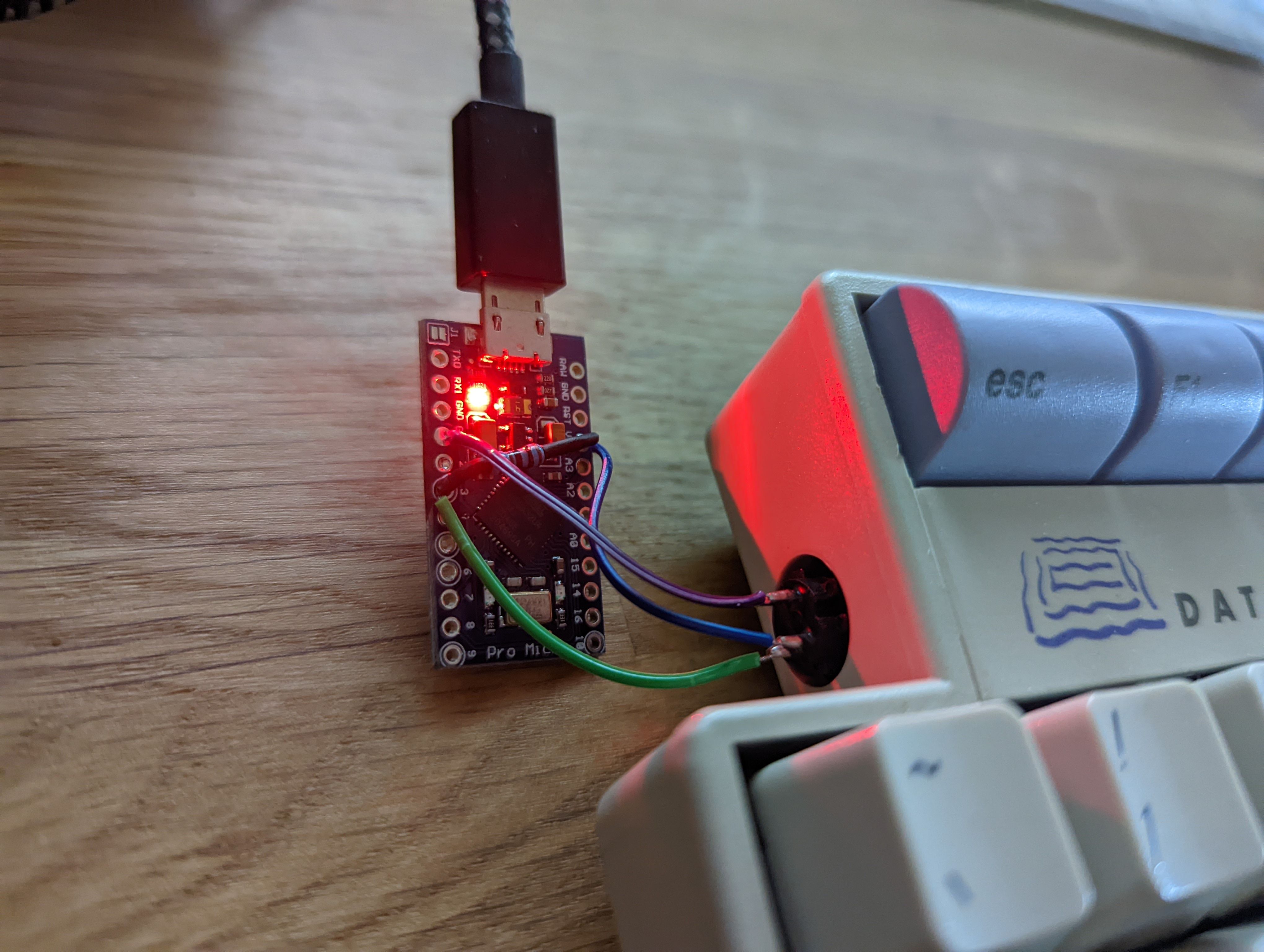

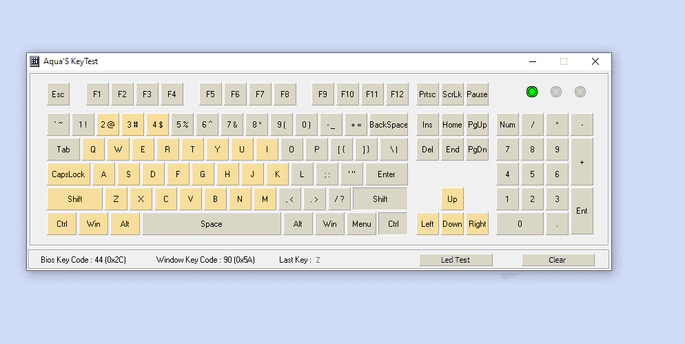

It's important to note that the device should ALWAYS be inserted into the ADB port first! "hotplugging" not suggested. After Windows detects the adapter you can use any given program to test the keyboard and mouse, here I am using "AquaKey" a lightweight keyboard test utility. While my DataDesk Trackboard has a built in mouse you can use any ADB mouse on the opposite port of the keyboard.
You can dress up your new adapter any way you like, I currently have no appropriate housings or shrink tubing so kepton tape may have to do!
