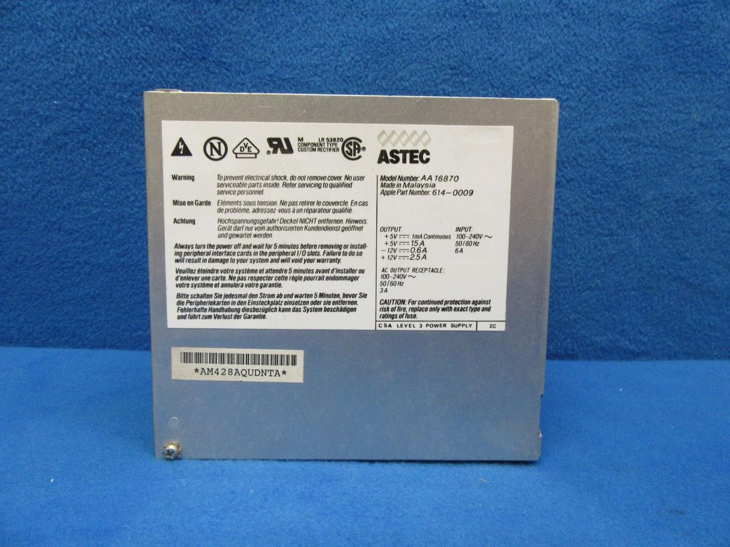

ASTEC AA16870 Recapping Guide
Cap RefuFVLead SpacingLocation
C1410252.5Main board
C2547252.5Main board
C1322502.5Main board
C811502.5Main board
C3122502.5Main board
C52220505Main board
C602200165Main board
C492200105Main board
C442200105Main board
C482200105Main board
C53120162.5Main board
C322.2502.5Main board
C6947252.5Vertical sub-board
C671502.5Vertical sub-board
C361502.5Vertical sub-board
C404.7252.5Vertical sub-board

Very helpful.
Although, just a note to future Tinkerers, that C81 may not always be 1uF 50V.
My AA16870 C81 original was 4.7uF 35V
