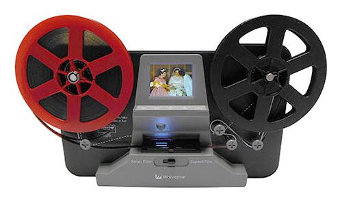

There are a number of budget 8mm film digitisers available, the two most well known are probably the Kodak Reels and the Wolverine, and I purchased a Wolverine back in 2021. The Wolverine is actually available in two versions: the base model for $300 USD and the Wolverine Pro for $400. The main differences between them are the Pro can load large film spools up to 9" diameter and captures the video at 1080p. The standard Wolverine can only support up to 5" reels and captures video at 720p.
But here's the kicker, both devices use exactly the same camera and capture technology, the difference in resolution is set by the device firmware. The image sensor actually has a whopping capture resolution of 2304 pixels wide by 1536 pixels high.

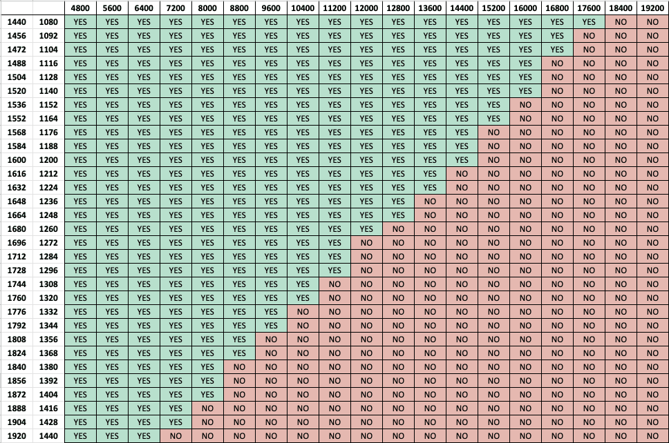

One last thing I should mention is that the little CPU inside the Wolverine definitely has limits, and you need to find the right balance of resolution and bitrate. If you set these values too high, the resulting file will be too large for the frame buffer to handle, and the Wolverine will record nothing. I have provided a matrix of resolution/bitrate combinations I have tried, indicating which ones work and which ones don't.
If your results contradict any of these, please let me know!

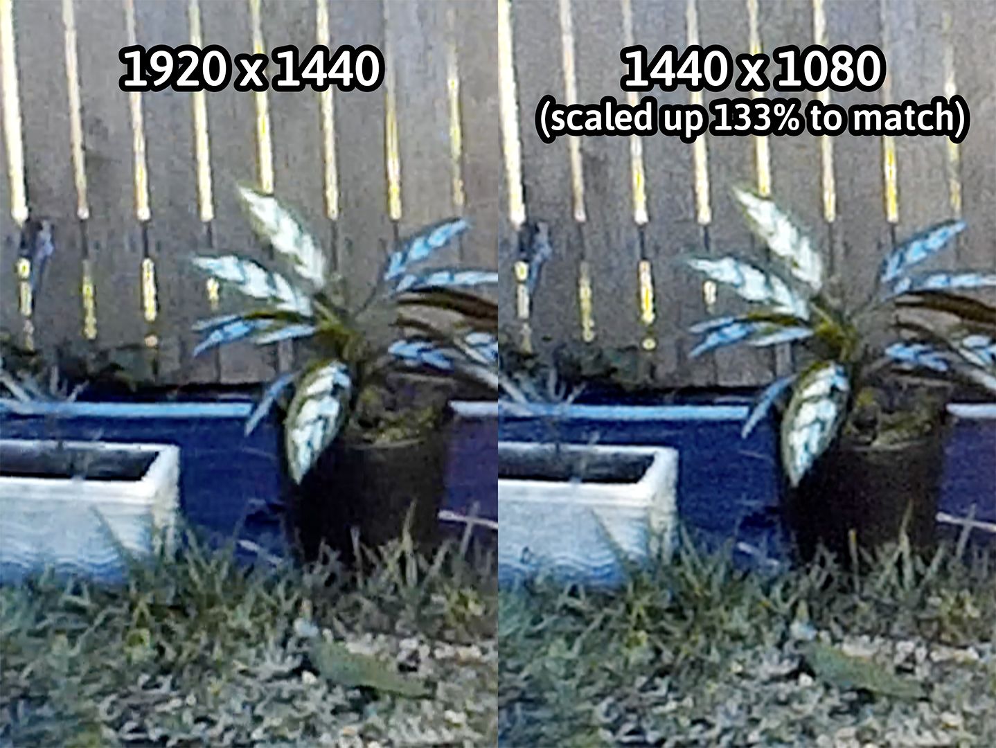

Well I'm glad you asked. While this firmware hack does allow you to capture at up to 1920 x 1440, is there any benefit in doing so? Let's not forget we're talking about 8mm film here. Maybe your films were shot by Steven Spielberg, but most of my home movies are pretty rough around the edges. Some aren't even in focus!
So do you actually capture more detail with a higher resolution? Based on my tests, the answer is no. In fact a higher resolution will force you into a lower bitrate, and as a result you could end up losing fine detail due to over compression.
Have a look at the following image. On the left is part of a frame captured at 1920 x 1440 and a bitrate of 6,400, and on the right is the same part of the same frame captured at 1440 x 1080 and a bitrate of 17,600. I have scaled the 1080p frame up to match the size of the 1440p frame. The frame on the left has been decimated by the high compression and has resulted in a significant loss in detail. If you look at the right image, you can see the actual film grain, but the image on the left has been all smoothed out. Take a look at the detail in the waves of the white planter, and the variegated leaves of the plant, there's just no way the higher resolution is better.
I did these same tests with a whole range of resolutions, and I have concluded that capturing at 1080p with the highest available bitrate gives me the best result. Things may be different with your films, but for me, 1080p is the go.

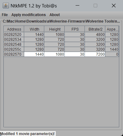

  3. Launch the NtkMPE.jar file from the Windows Tools directory.
  4. Select File > Open Ntk firmware and navigate to the new_firmware.rbn file in the Wolverine Tools directory and open it.
  5. You will see 6 columns and 5 rows of data. You can ignore the first four rows, the last row is the only one that has an effect. The columns are Address, Width, Height, FPS, Bitrate/2 and Aspect. Ignore the Address column, and as far as I can tell, Aspect has no effect, so leave this set to zero. Click the field you want to edit and replace the existing figure with your new one.
  6. Once you have made your changes to the fields, select Apply modifications from the menu bar to apply the updates to the new_firmware.rbn file. At the bottom of the window a message will appear, indicating how many parameters were changed.

If you encounter an issue, such as no video file being created after capture, this is probably because you have selected a resolution or bitrate that the Wolverine doesn't like. If this happens, go back to step 3 and try some different settings. Try using one of the safe settings from my supplied matrix (above).
