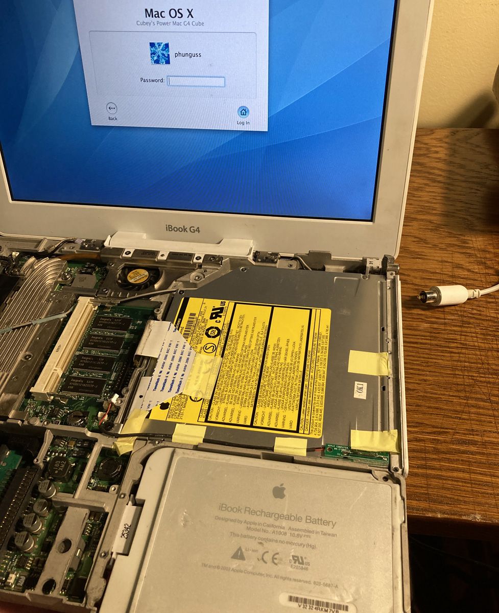

I wanted to check the solder job on my 12" iFrankenBook, so I booted it up from a battery. All is well. You can see by the computer name, that I have just been cloning drives instead of clean installs.
And the battery charges when plugged in, so all is good.

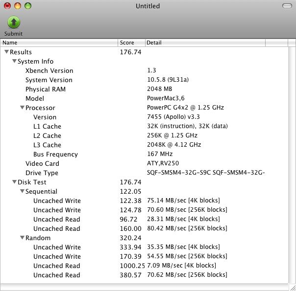

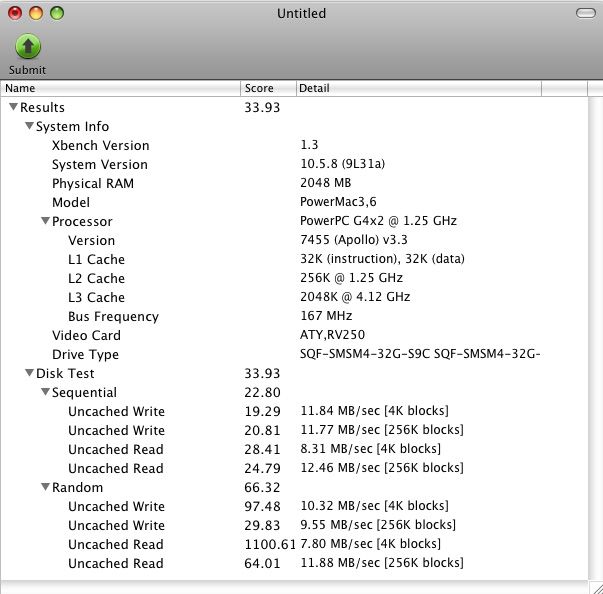

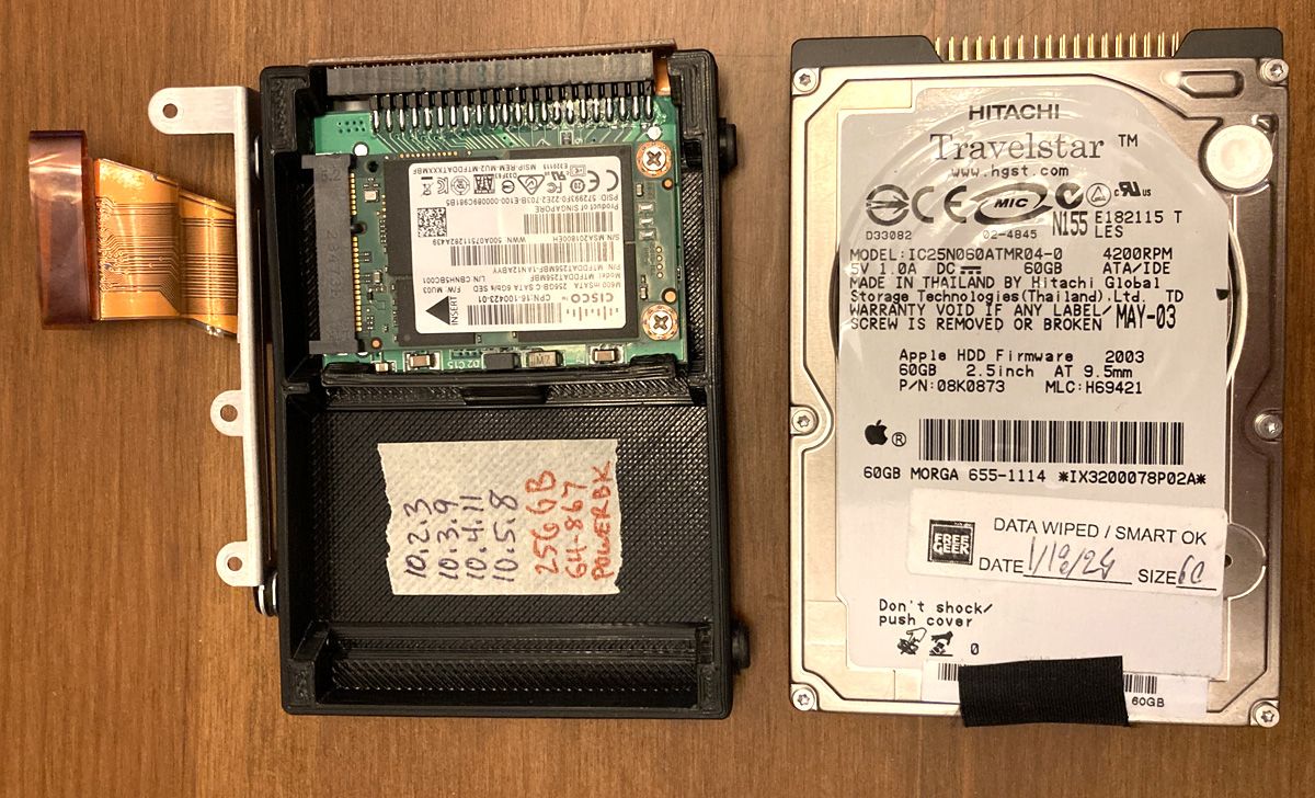

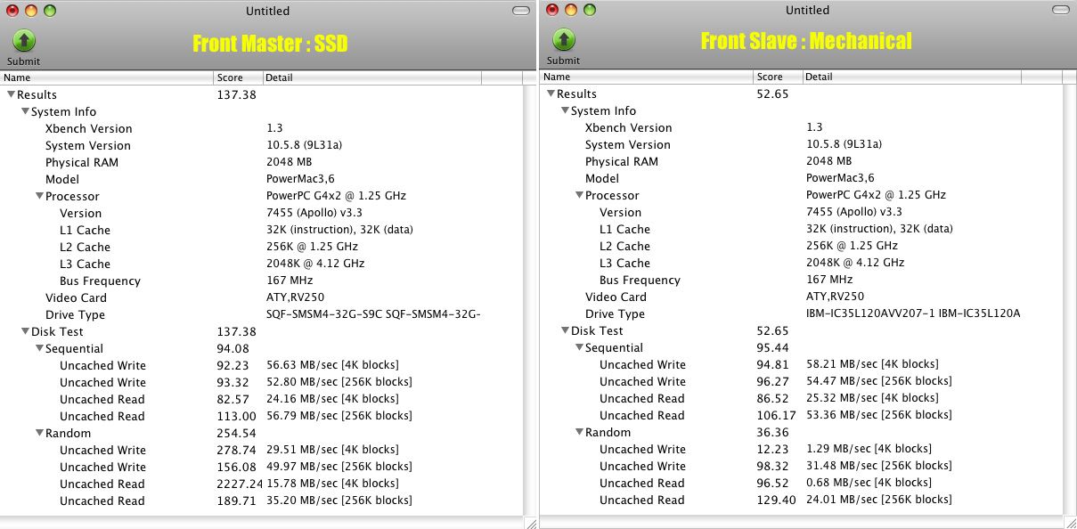

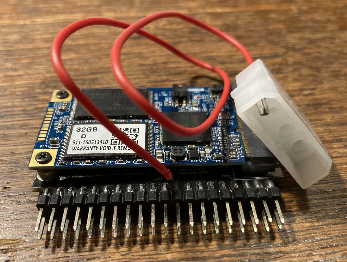

I pulled out the MDD and tried the 3.5" mSATA to IDE in all 3 busses. I ran Xbench with drive only test.
Front bus with mechanical drive as slave:
Optical drive bus:
And the rear bus:
So that black adapter with red cable boots on all 3 busses. I will try a couple other PPC towers this weekend, maybe the Cube as well.

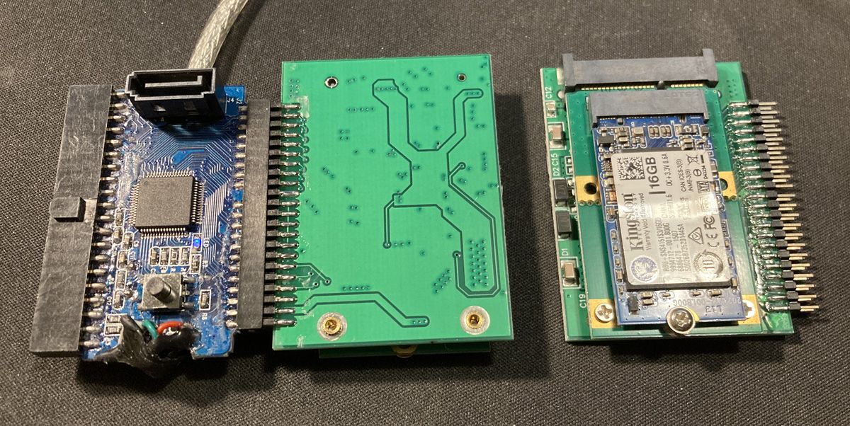

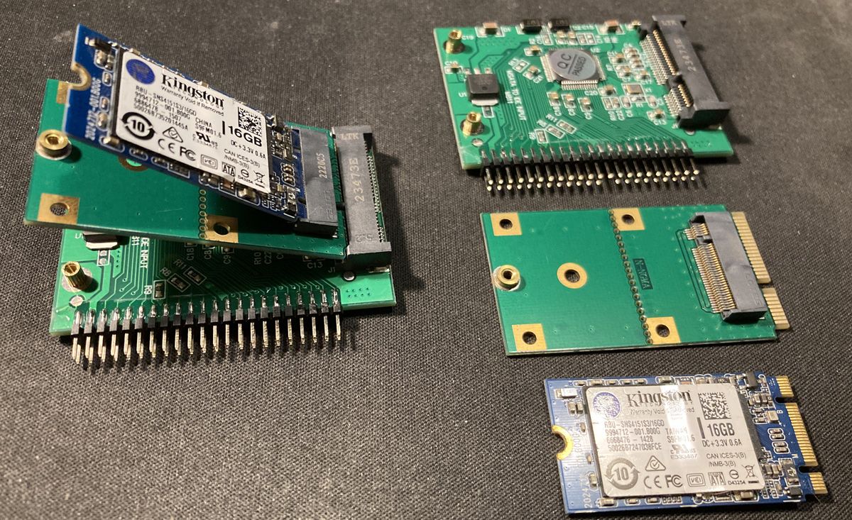

Other adapters arrived in the mail. M.2 sata to mSATA, and more mSATA to IDE.
Then attached to IDE to USB and to my iMac for formatting.

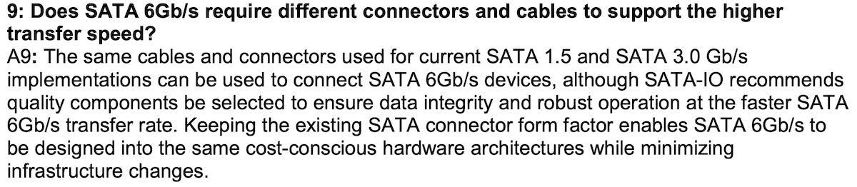

I just found yesterday while at work some official documentation from the SATA-io group on their host website about the SATA-3 (it's quicker than typing the capital letter I three times, sorry) protocol and they confirm that there should be nothing interfering in compatibility between the connectors. The following screenshot was taken from this helpful .pdf they provided here: https://sata-io.org/sites/default/files/documents/SATA-Revision-3.0-FAQ-FINAL.pdf.
Was I just under a misconception the whole time, tragically exacerbated by confirmation bias while working on my PowerMac? Something must have gotten passed on to me along the way in the past. Let's just forget about that o_O:LOL:

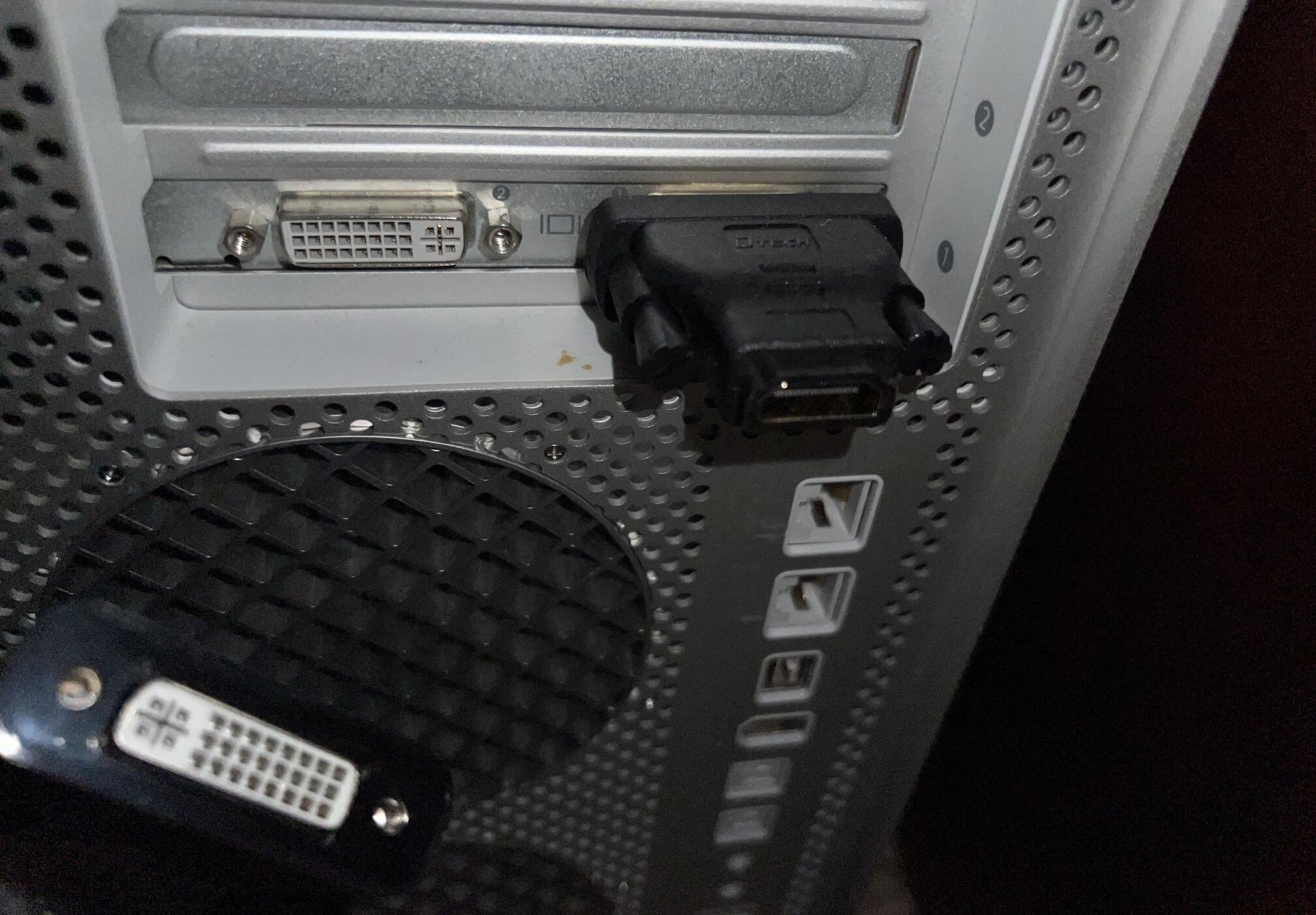

Also, as I noticed I didn't have a picture for it, here's my DVI-to-HDMI adapter connected to the I think it was NVIDIA GeForce 6600 in the PowerMac? I'm holding the DisplayPort-to-DVI adapter in my hand in the bottom left corner of the image, too:

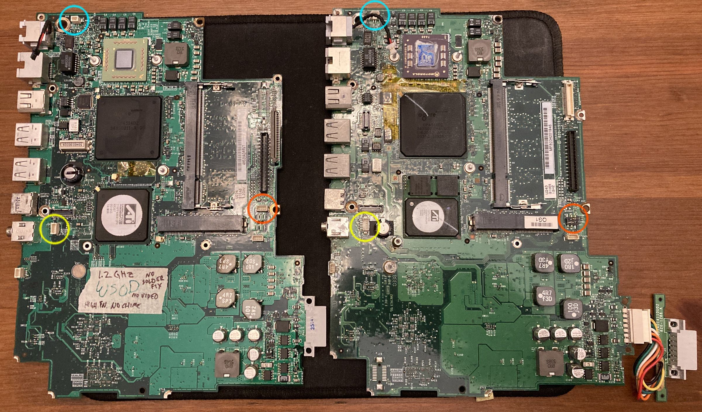

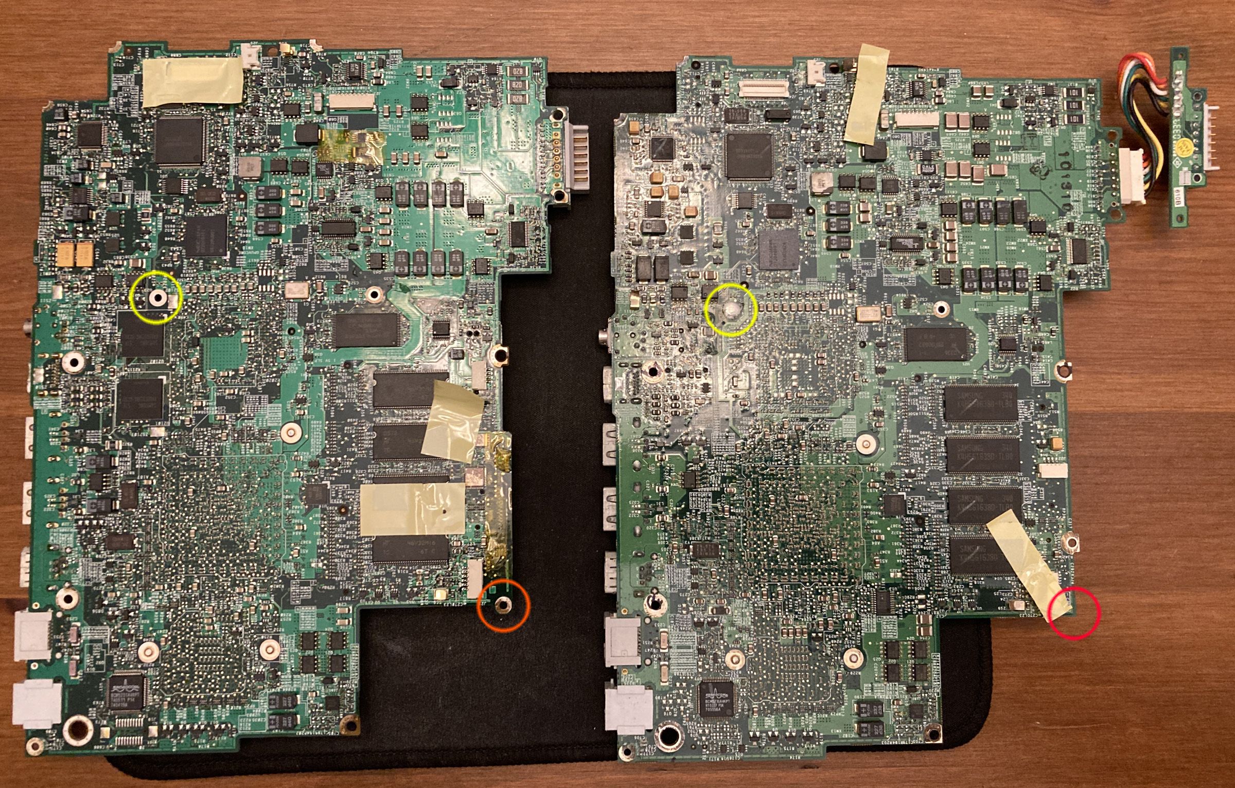

All over the place today. Stripped down an iBook 14" 1.0GHz to put inside a 12" 1.2GHz frame. I found a couple things that will require mods, aside from the battery connector.
Front side:
-Power switch and speaker jacks are wrong pitch, but I think I can salvage some from other boards and swap them
-Trackpad connector on the 1.0GHz is similar to a Powerbook one vs an iBook one. Same amount of pins, maybe I can hack something.
Back side:
-Mount holes are different
-Mount hole has a standoff soldered in it, I should be able to remove it.

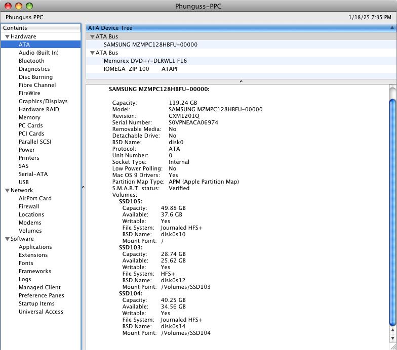

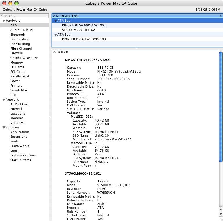

Since this adapter worked great in my MDD, I tried it in other G3/G4 towers. mSATA to IDE 3.5" desktop (not 2.5" laptop).
Booted off both busses in my B&W G3
Booted in my QuickSilver
Booted in an AGP

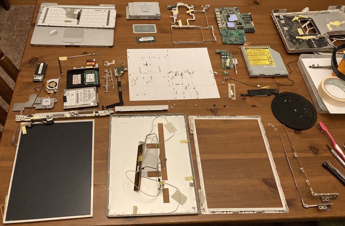

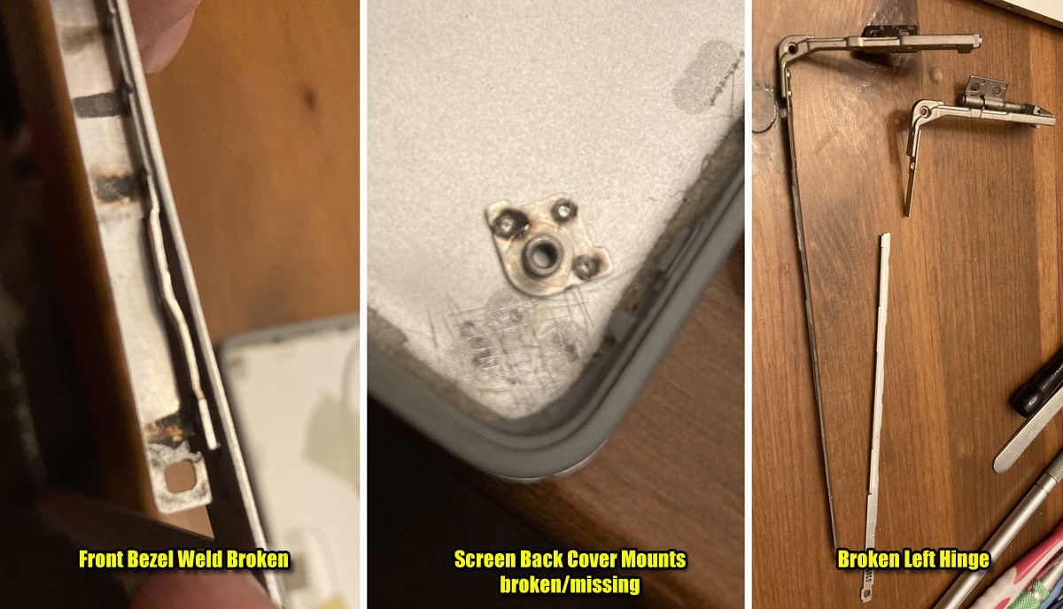

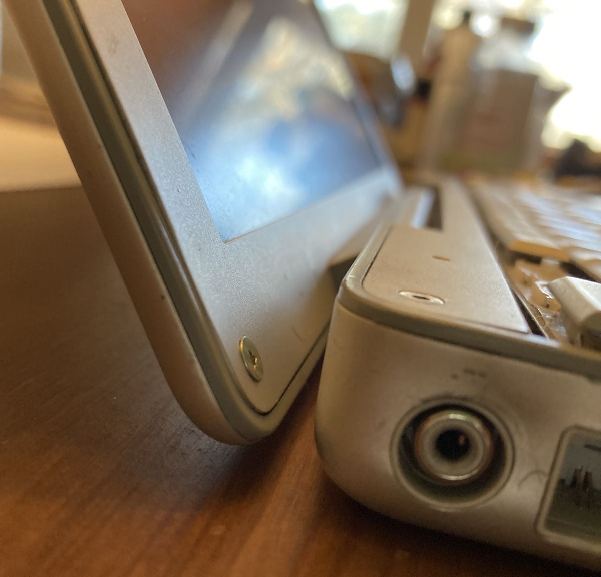

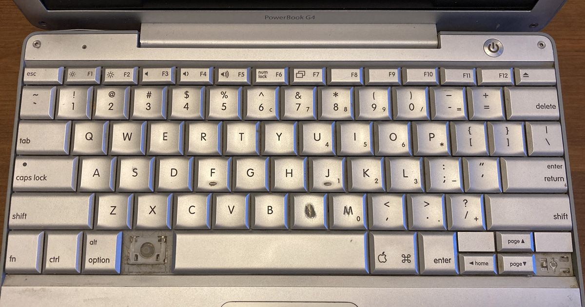

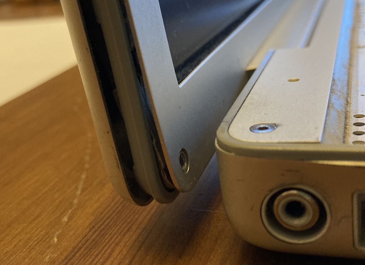

Then on to an ailing PowerBook G4 867MHz 12" that has seen much better days. I have the replacement keys for this keyboard.

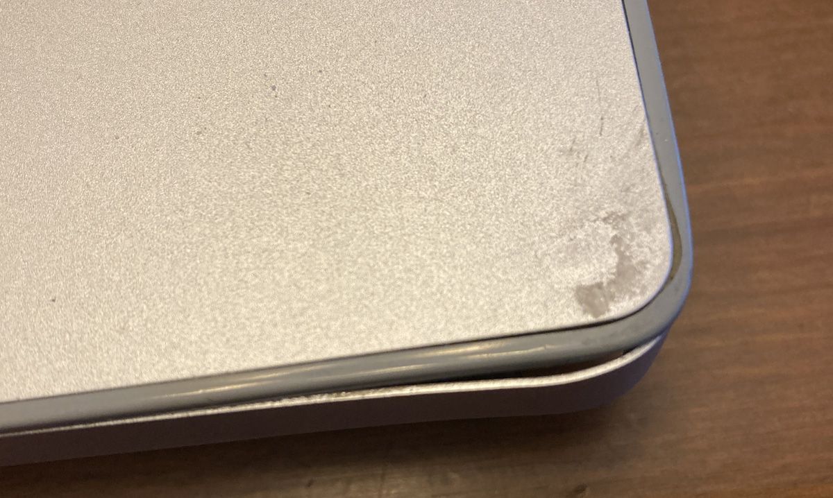

The screen bezel is missing a screw.
Corners are dented
Full tear down.
She was dirty inside

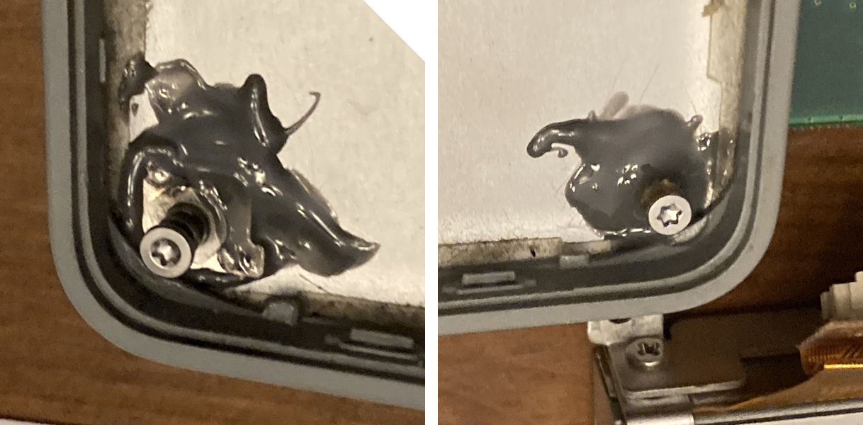

And found more problems. I had originally purchased spare hinges when I bought this machine, because I assumed they were broken.
I replaced the missing back cover mount with a knurled insert and used JB Weld epoxy.
I will let that dry for at least 24 hours and then start the reassembly. SSD all ready to go.

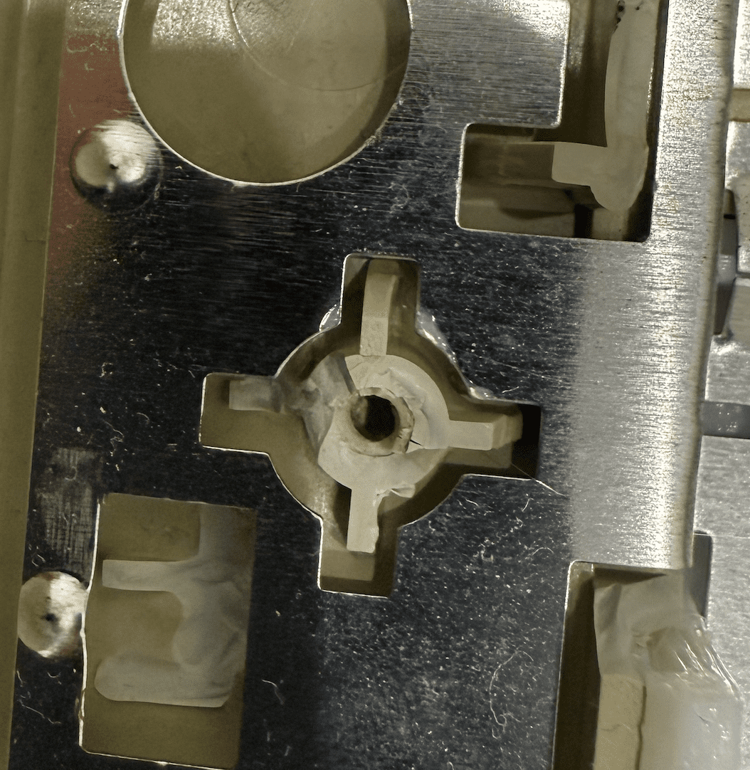

Hey, folks!

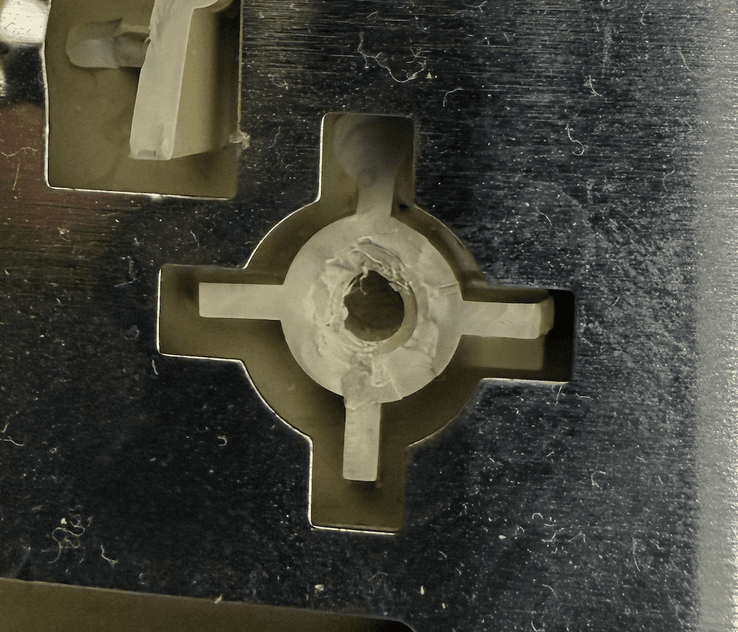

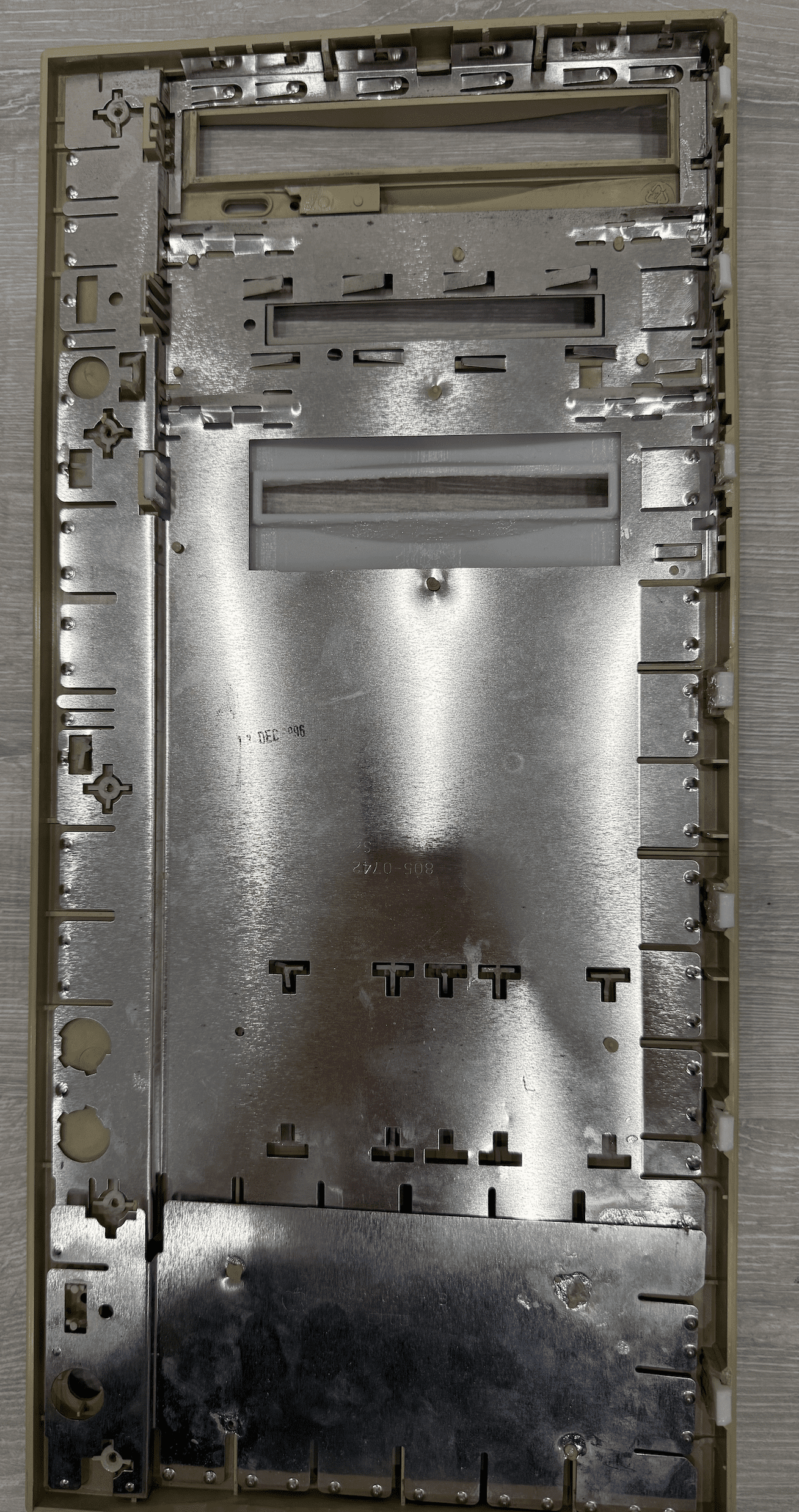

I'm restoring my PM9500, and I've encountered problems that I don't understand how to solve.
The front panel mounts were completely broken, I restored the right side by printing clips, but what to do with the left side?
All self-tapping mounts are broken, in some you can use a self-tapping screw, but it seems very unreliable.
Who would have experience in restoration, what would you recommend?

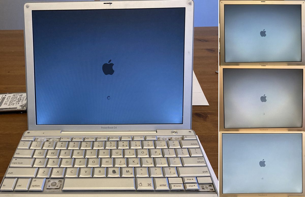

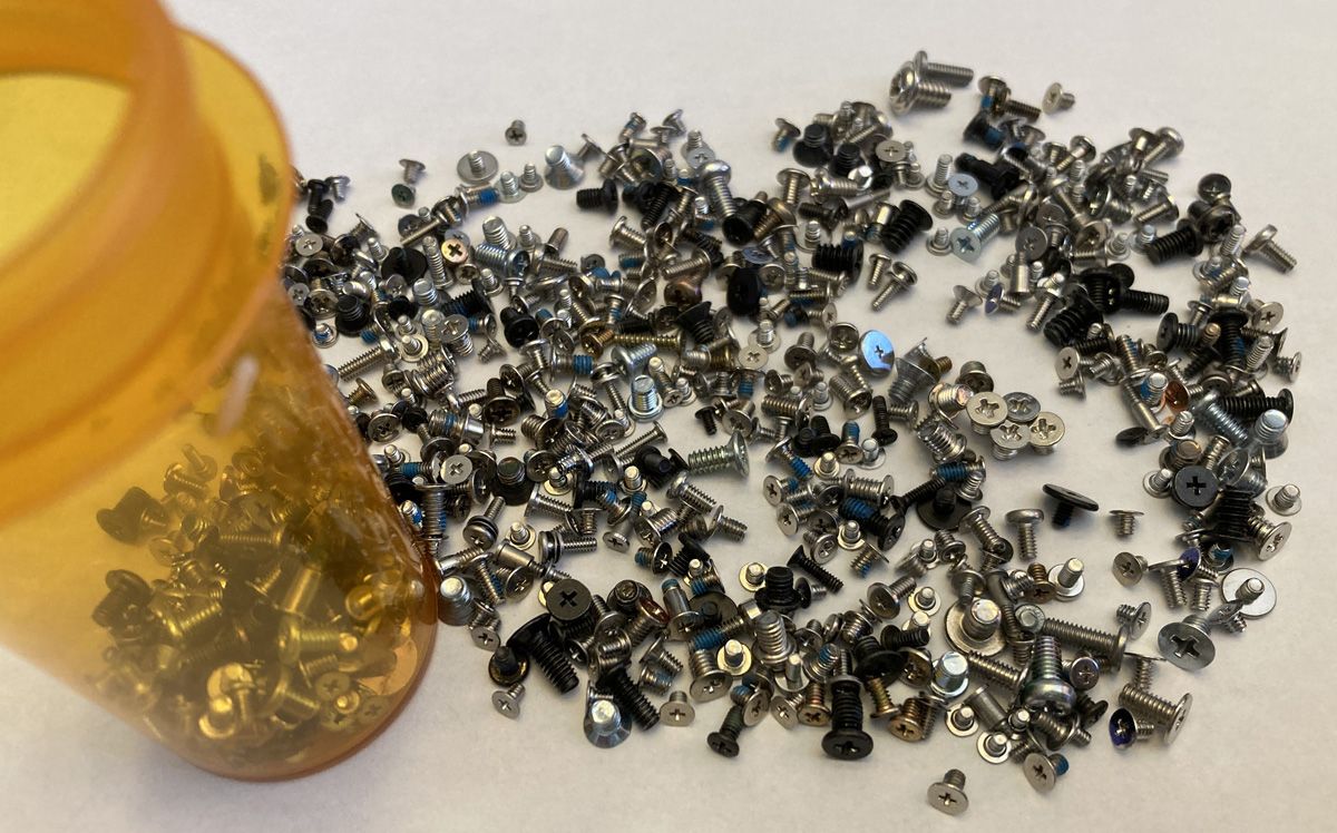

The PowerBook G4 is reassembled. There were a few missing screws inside, but luckily I keep a bin of spares.
The screen could probably use a new backlight (I have a couple LED strips), but I left it as is. Bottom corners are brighter but you usually only see it on flat full color screens. If you are busy with other backgrounds and work, it is not that noticeable.
The bezel has been repaired.

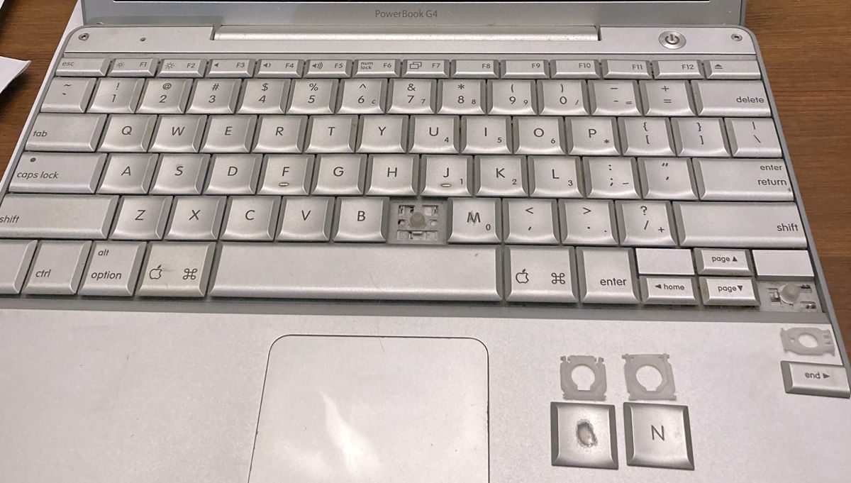

The spare keys I had ordered, only the Command key fit correctly. The others seemed to have been from other versions of PowerBooks. Try, try again.

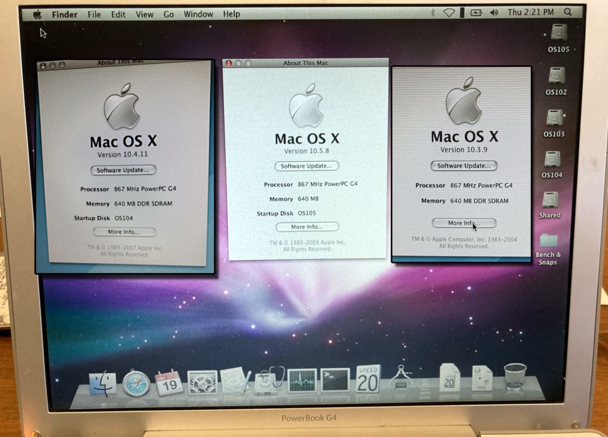

Three version of Mac OS X, pending install of 10.2

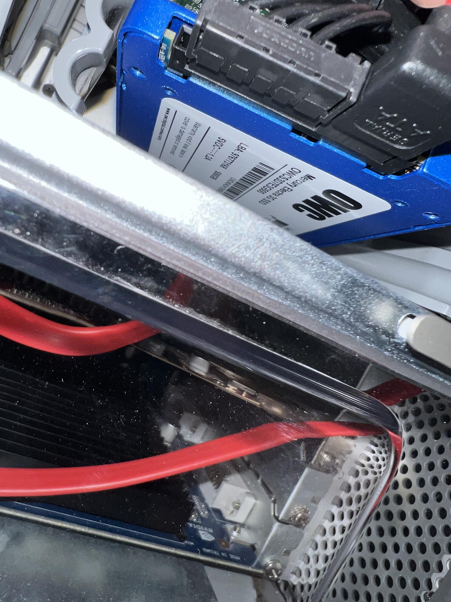

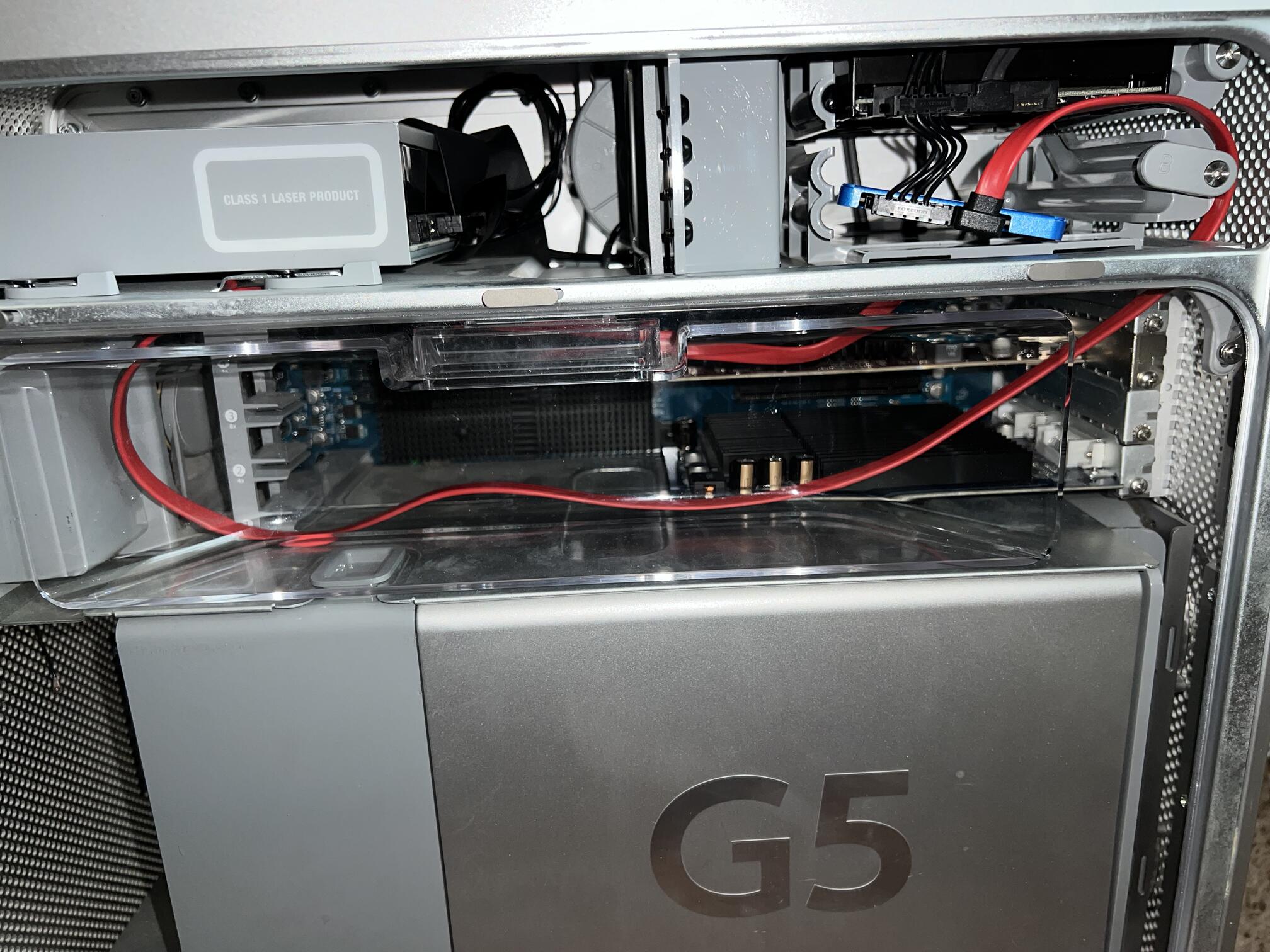

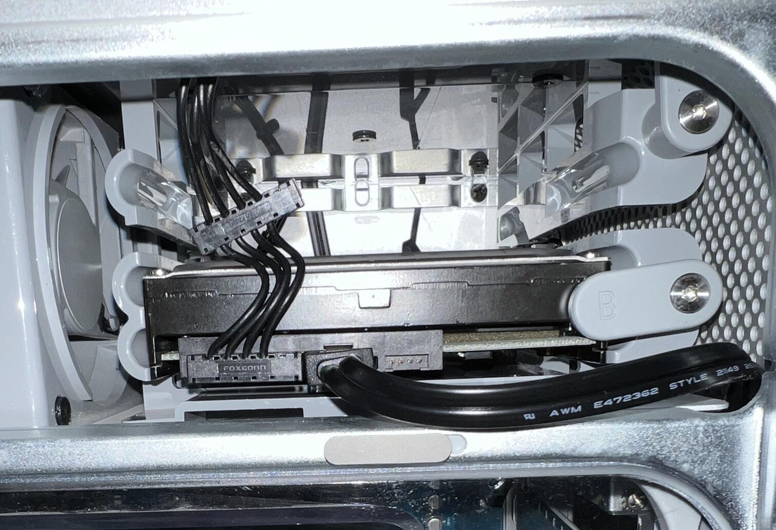

FELLAS, I NEED YOUR HELP​

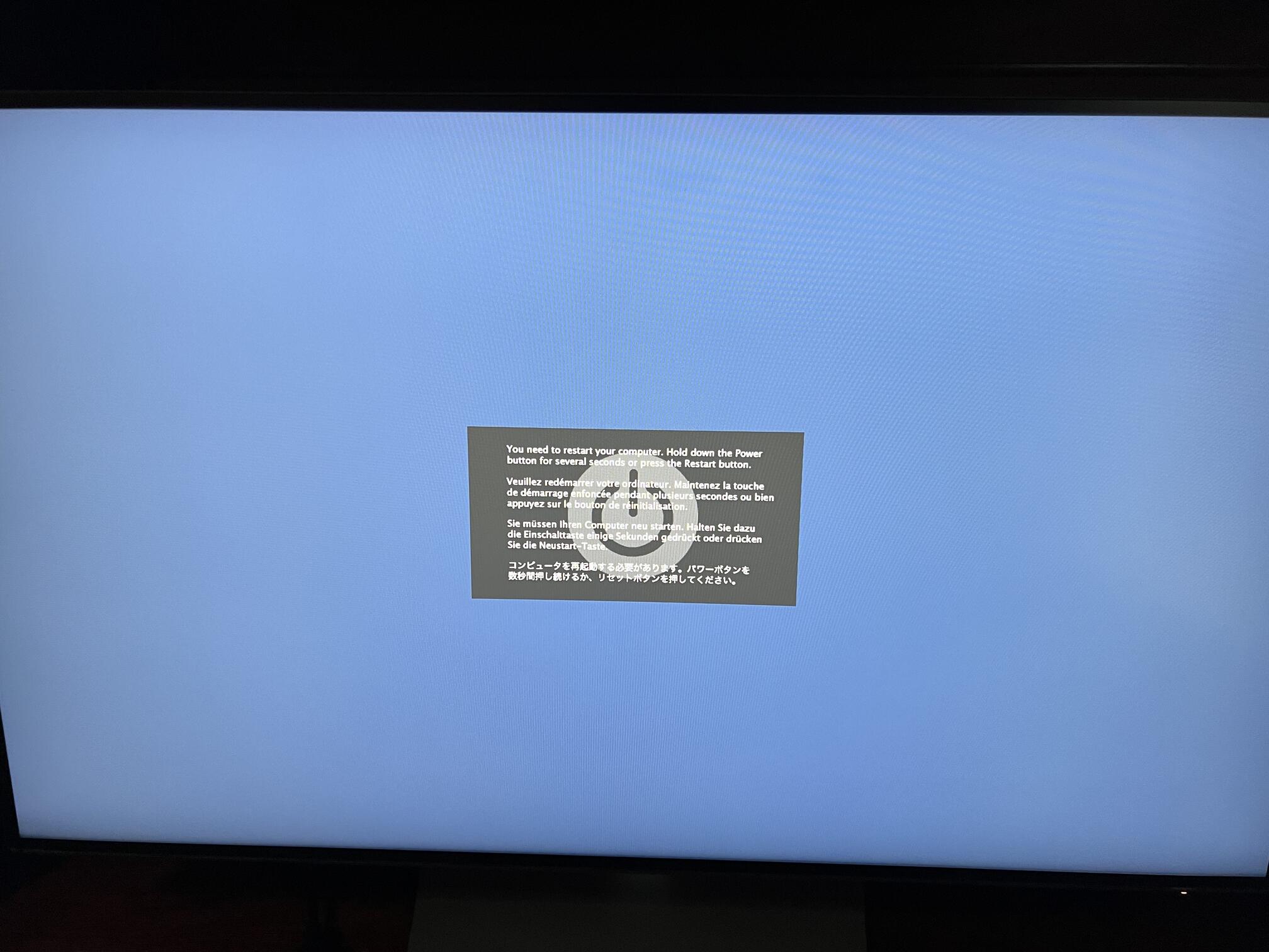

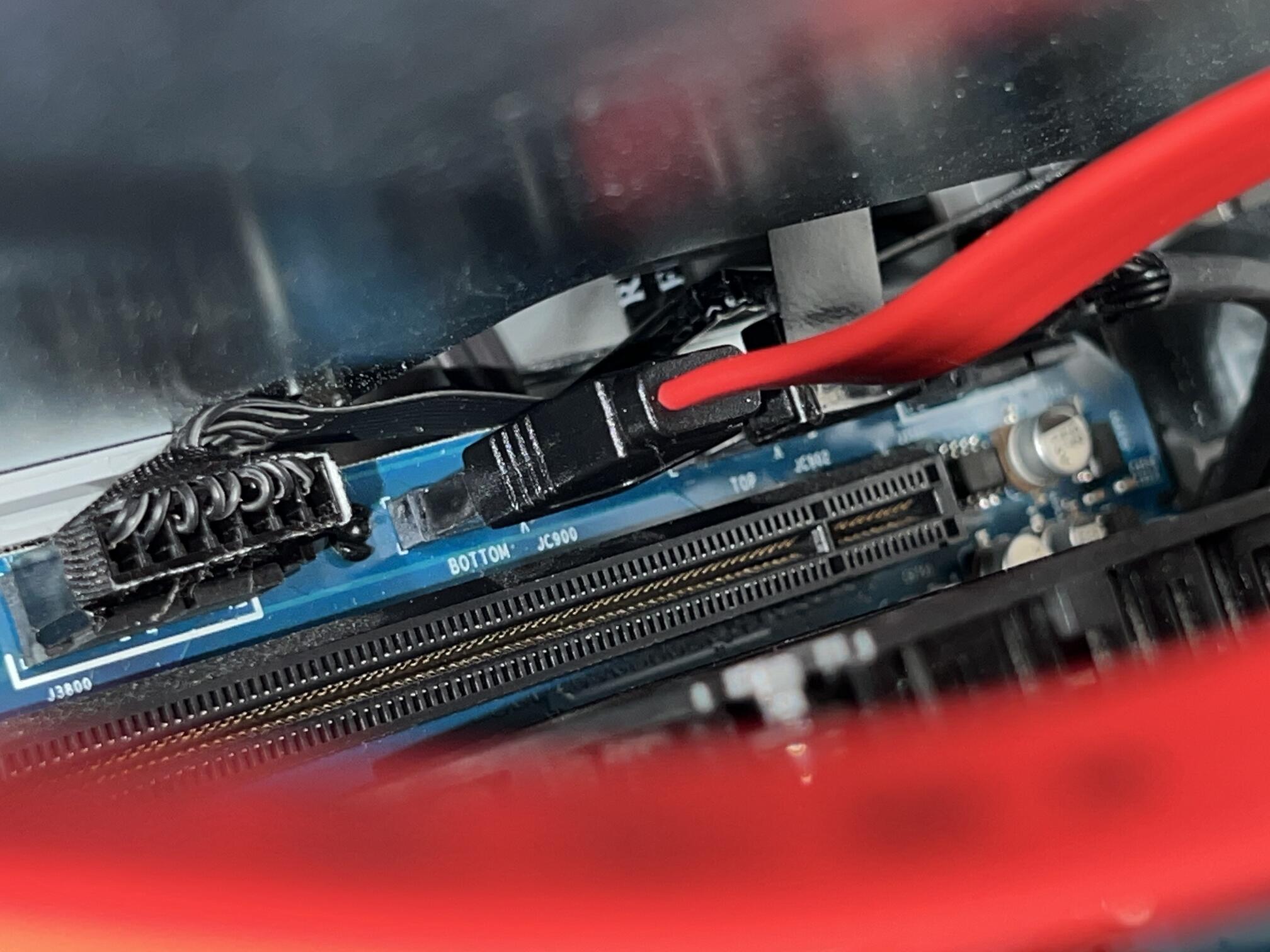

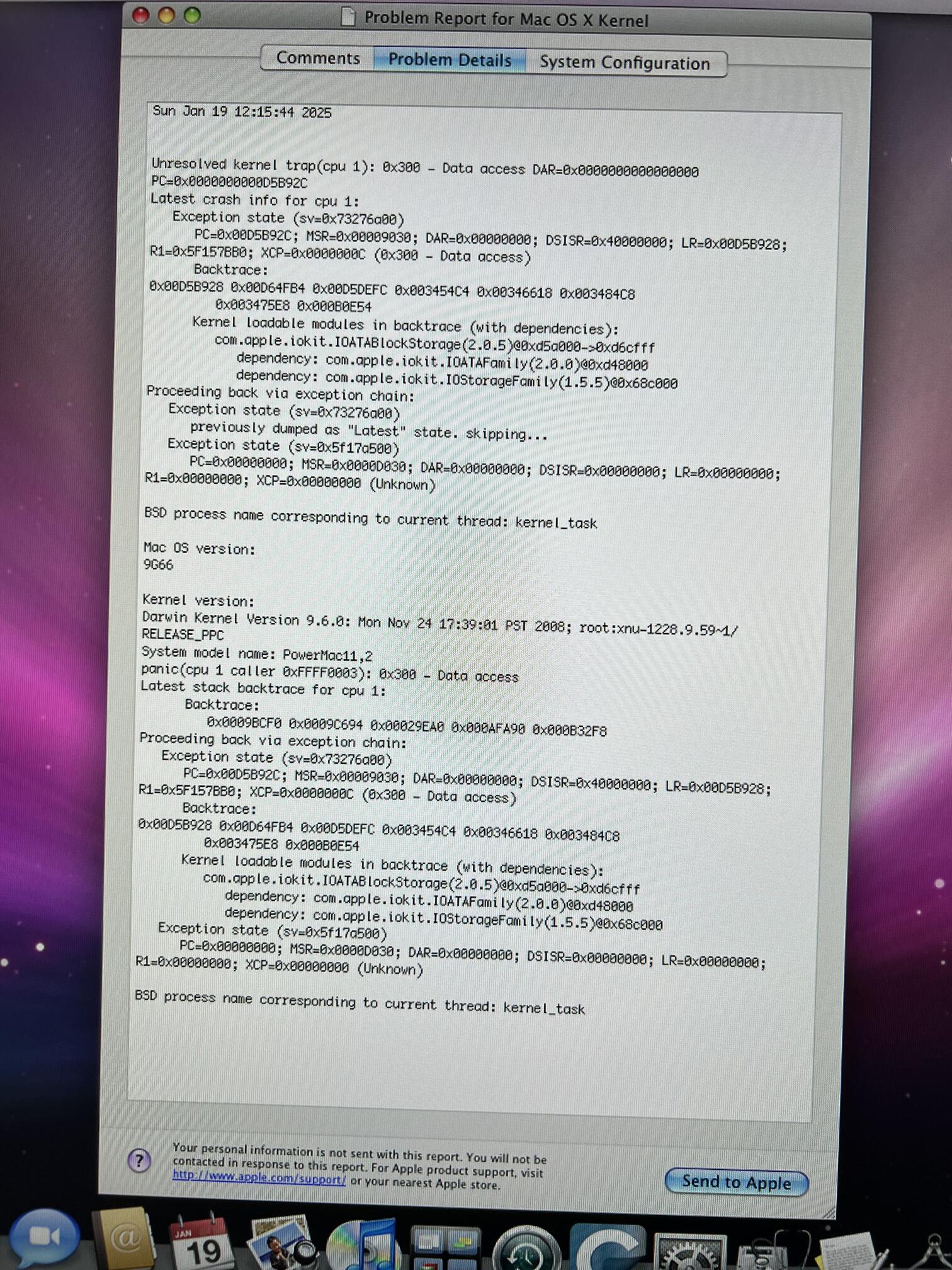

Alright, so one of the two SATA data cables I ordered has arrived. I know it's quite long and it looks humorous at this length, but I think this was the shortest they had available.
aaaaand.... I get a kernel panic
Here is what the kernel panic log shows in case anyone want sot make any sense of it:

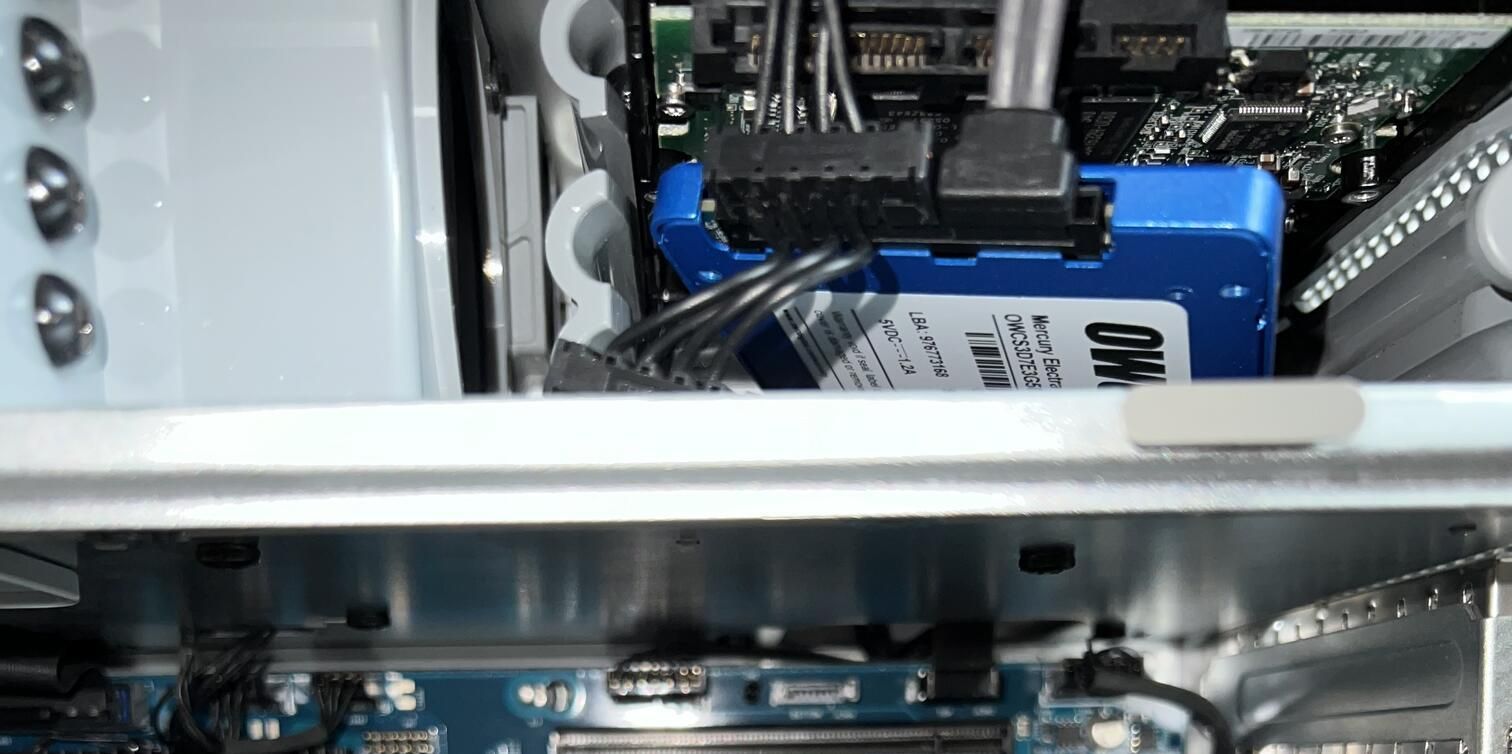

Unplugged everything. Took it apart. Checked to see if the cable is plugged in all the way even though I really shouldn't need to be doing this. Is it plugged in to the drive? Yep. Plugged in to the motherboard? Yep.
Turn it on. The SSD still doesn't exist.

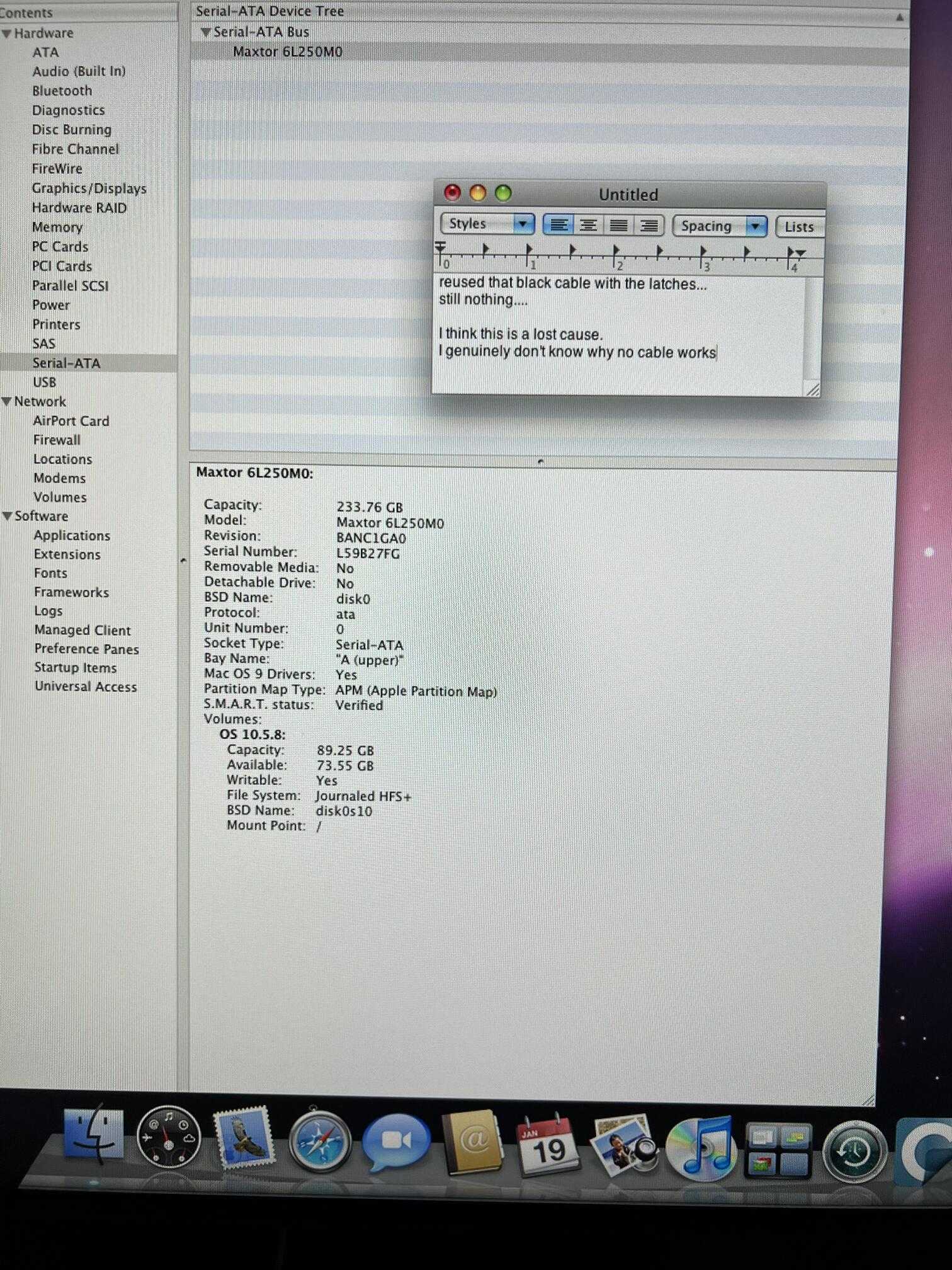

I went and got the black cable with the latches from my earlier post.

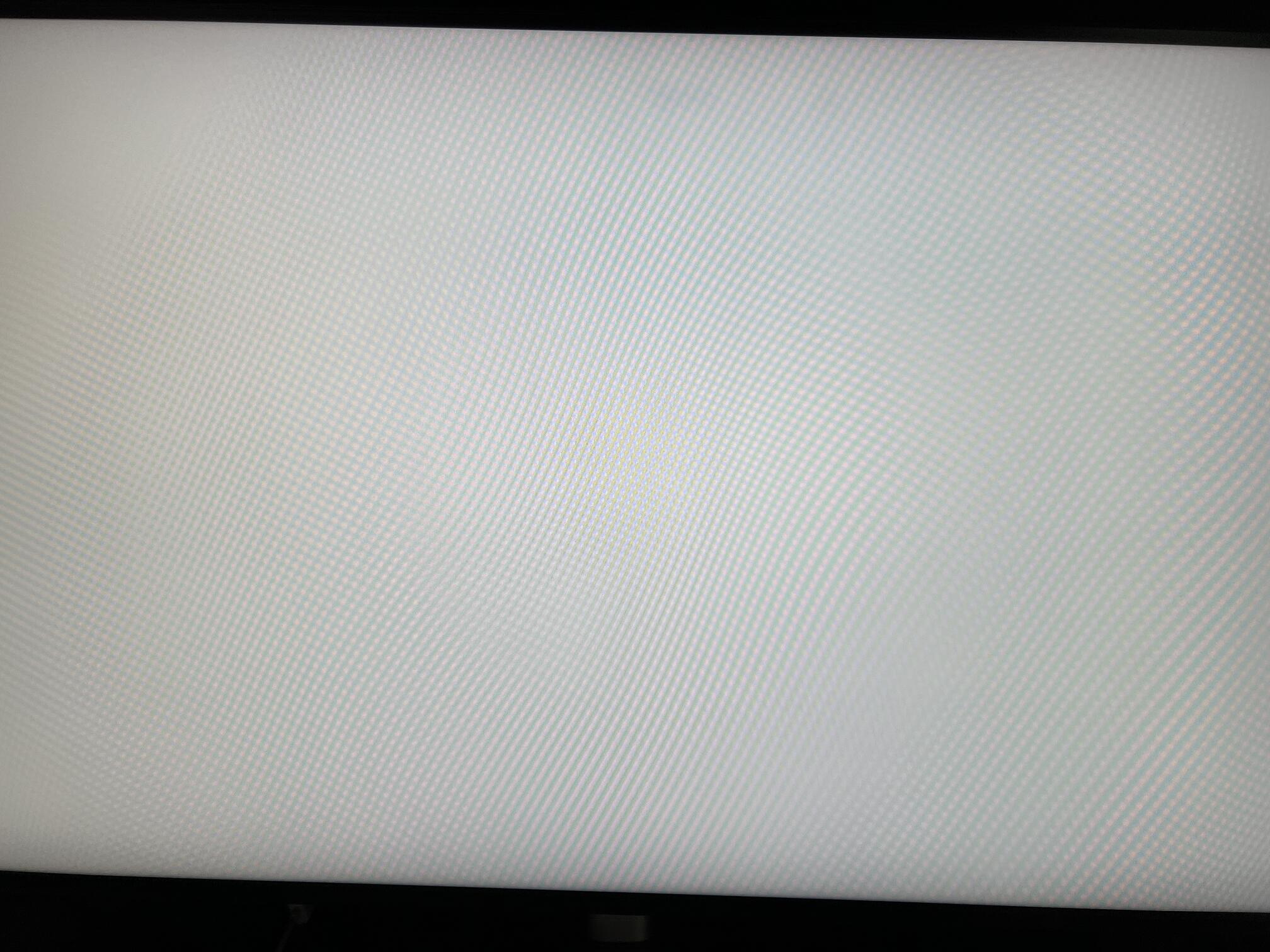

I take out the cable and just plug in the SSD using the upper drive bay's power and data cables to force the PowerMac to boot into Sorbet Leopard which is cloned to the SSD using Carbon Copy Cloner as you saw in Part 3.
And that just leaves the computer on a blank screen with no Apple logo ... indefinitely... with the fans on full blast.
I'm throwing in the towel and tapping all of you into the ring. Just in case it wasn't clear what I am trying to do, here is a quick summary of my predicament and a run down of my goals:
1. The SATA data cable for the bottom drive bay is out of commission
2. I have used two cables in its place with no success
3. I want to use my Mercury Electra 3G 500GB SSD as a bootable drive with 10.5.9 "Sorbet Leopard" installed
4. The drive is recognized by the system and seen by Disk Utility only when plugged in via an external USB enclosure thus far
5. Plugging the drive into the system using the top bay's cables results in nothing booting even after cloning 10.5.9 "Sorbet Leopard" to it
I chose this SSD because of the testimonies of multiple people across various Mac forums claiming that it's basically a guarantee to work with any PowerPC Mac with a SATA connection, but I'm having the exact opposite experience with all of my troubleshooting.
View attachment 19642View attachment 19641

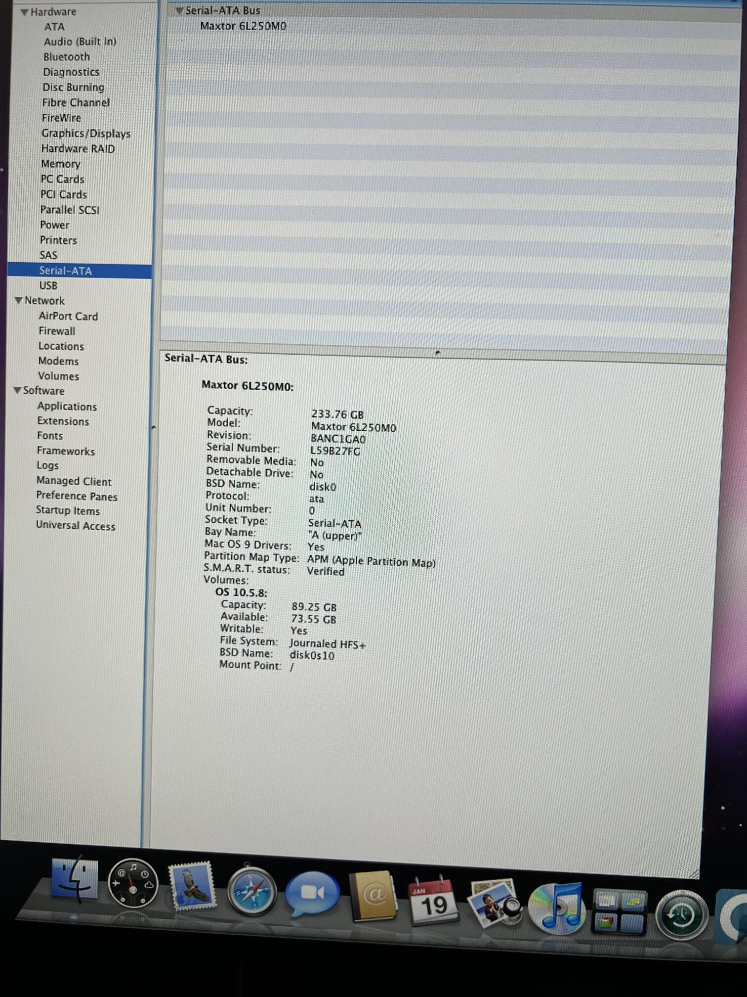

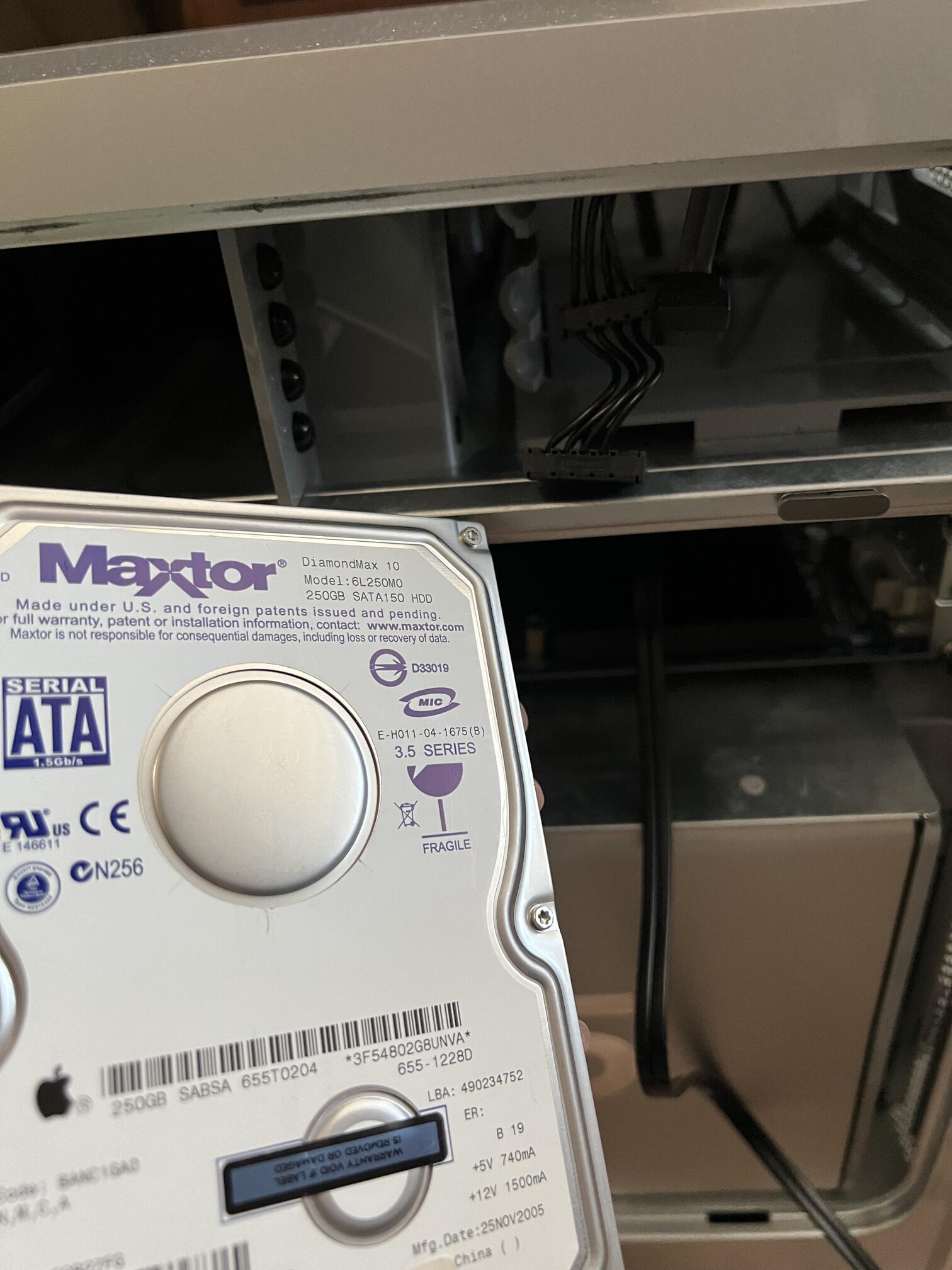

Alright... Can you still boot off the original Hard Drive in either bay (top or bottom) with any of your cables (short black or long red)? Lets just make sure there are not some other system issues other than the SSD drive at this point.

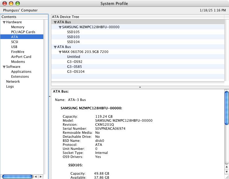

Let's try it.

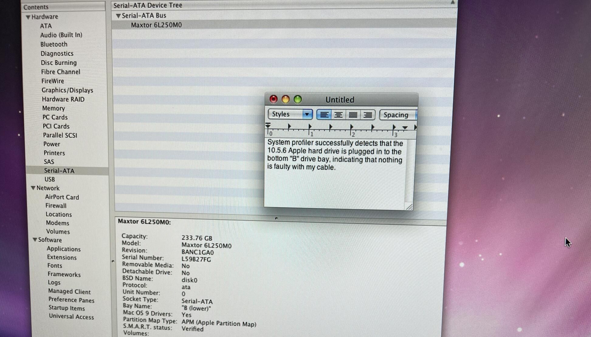

Hard drive out:
Hard drive in:
PowerMac G5 recognizes the drive and safely boots into 10.5.6 Leopard. System Profiler shows the hard drive is plugged in to the bottom drive "B" with no issues:
same SSD I'm using in my 1.6 iMac G5... really not sure why it wouldn't work?
That's why I continued under the assumption that my cables were at fault and not the SSD since I purchased it with its reputation as being guaranteed compatible with PowerPC G5 Macs. Yet, the drive mustn't be at fault either considering it was properly recognized and formatted when plugged in to the PowerMac externally inside of a USB enclosure!
The external USB case has a converter/controller in it that converts the SATA to USB. Put the SSD back in the USB external and see if its recognized. If it is not recognized, I call bad SSD. If it is recognized, I have no reason to explain why it does not work.

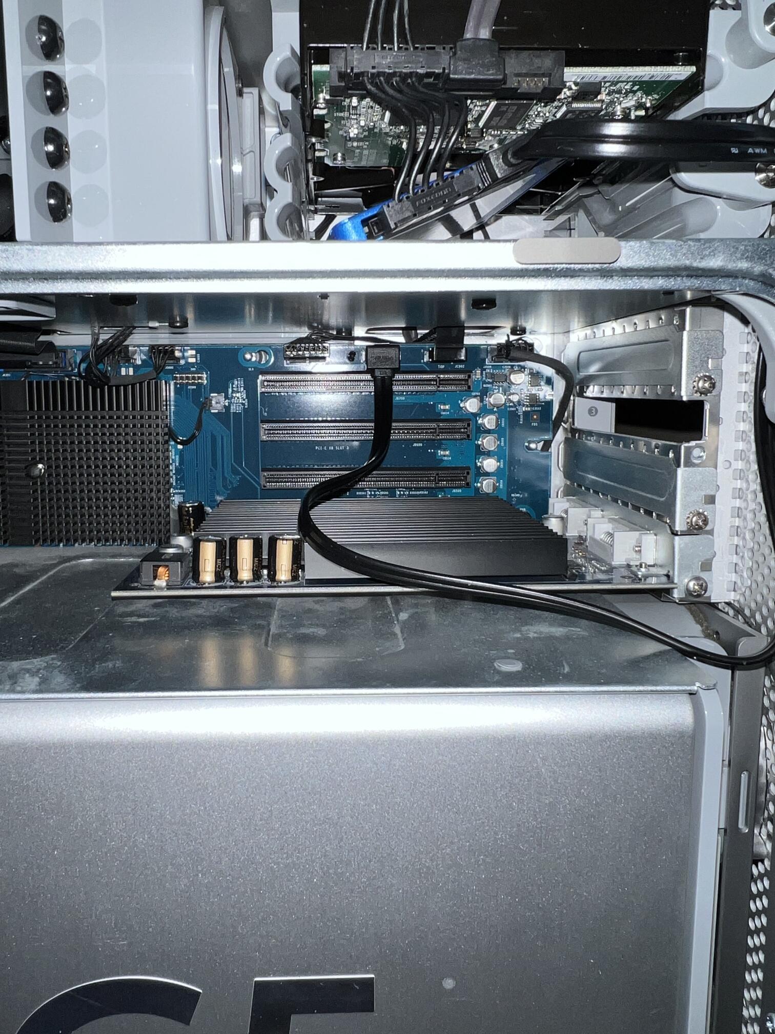

I performed another test by plugging in the SSD to the top drive bay, leaving the Apple hard drive in the bottom bay now knowing that my cable is not an issue. No modifications taken to the current setup. Turned on the PowerMac G5 and I am returned to the blank white screen with no Apple logo. That's interesting. If there was no bootable OS installed to the SSD, shouldn't I be taken to 10.5.6 Leopard which is installed on the Apple hard drive? So, the upper drive bay takes precedence in the boot order, it seems.
Here are the results with this in mind:
1. SSD plugged in to bottom bay "B", hard drive plugged in to upper bay "A"
RESULT: 10.5.6 Leopard boots and the SSD is not mounted nor recognized
2. SSD plugged in to upper bay "A", hard drive plugged in to bottom bay "B"
RESULT: nothing boots and the blank white screen sans Apple logo appears indefinitely
3. SSD is the ONLY drive plugged in regardless of which bay it is plugged in to
