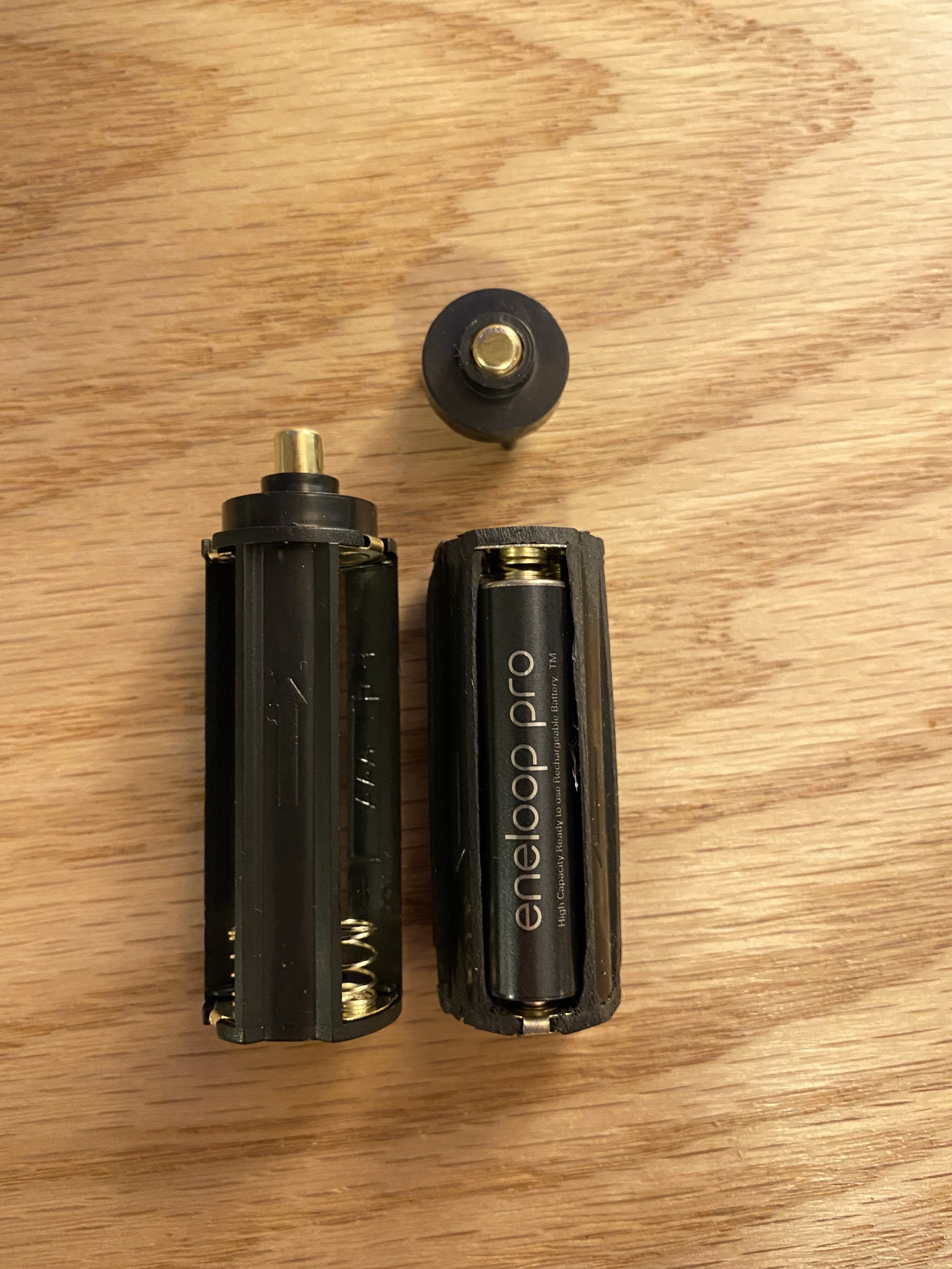

I've used AAAs in stuff like this:
If you have one of the old dead batteries, you can snip the connector end off of it and use some heatshrink to connect it. You don't have to order from Amazon either. Stuff like this is available on most electronic and hobby sites. And I think there are some pre-made ones on ebay.

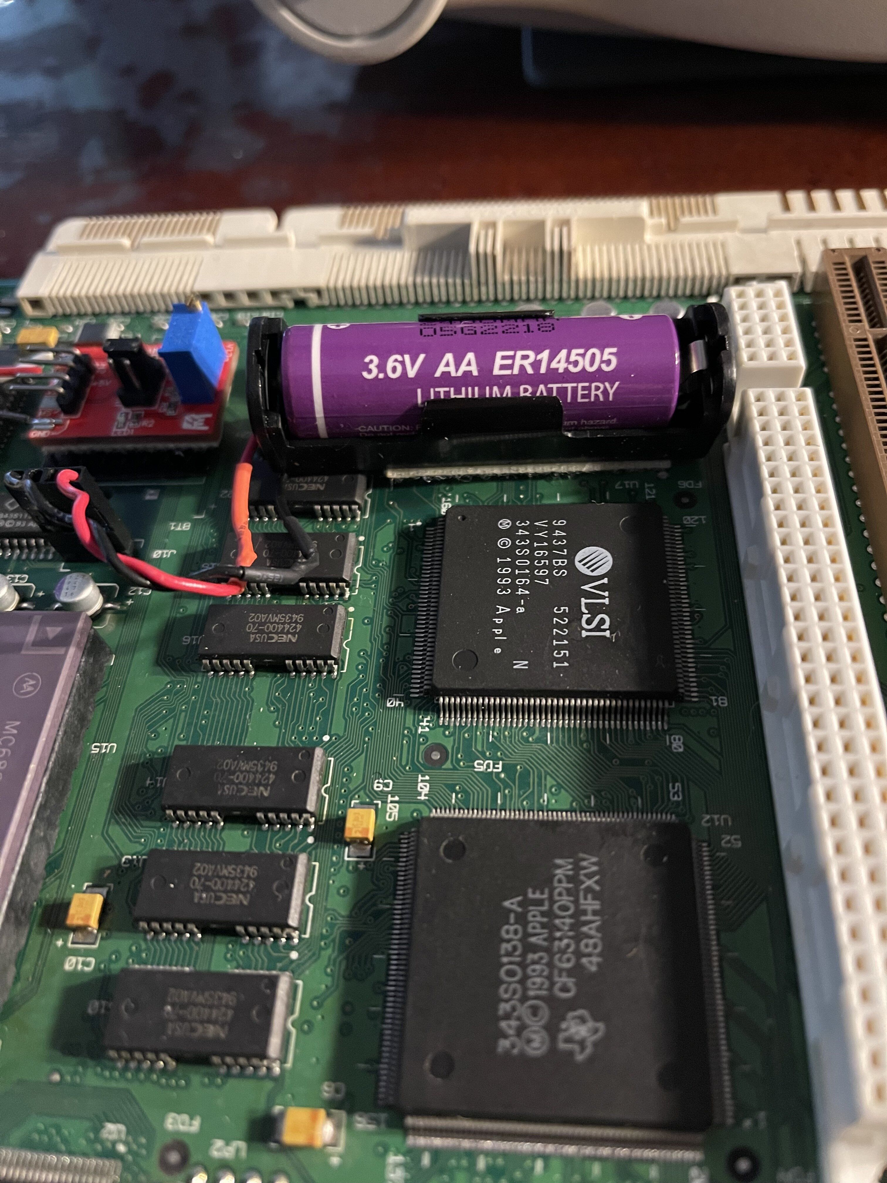

Update. The triple LR44 setup didn’t last very long for me, with one of the cells going flat in less than a year and thus not retaining enough voltage to preserve the settings. A little over a year ago I opted to try a 3.6-V AA-sized ER14505 I purchased from Mouser for a little over $8 - I know, a bit pricy for a battery. I opened my Color Classic Mystic this morning and measured the battery voltage, and it’s doing fine, measuring 3.66 V after a year.

That makes great sense for almost everything. But, the Mac 128, 512ke and Plus have a battery compartment on the back intended for a 4.5V battery that's long unobtanium. Stacking 3 LR50 cells gives you the right voltage and fits perfectly in the existing holder. But for anything with an internal battery I'll go with the AA sized 3.6V cells. Some systems (Amiga) expect a rechargeable battery. In that case I use a schottky diode to prevent reverse current flow. Most have a forward voltage drop around 0.2V.
After reading your post, I searched Amazon Japan for one of those ER14505 batteries and found a cheaper price than you paid:
I see those are NOT rechargeable, making the cost of replacement something to ponder. I therefore look forward to hearing updates from you about when it dies. If it lasts two years, it's probably worth the price.
Not sure of the stock CC motherboard draws the same amount of current as the LC575, but I measured the current draw from my board (from the PRAM battery):
LC575 Current Consumption: 63µA @4.5V
With a triple LR44 kit attached, that often gives me about 70 days of use. Pretty pathetic. LR44's are roughly 115mAh rated batteries.
But your battery seems to be 2600mAh rated, albeit with a fairly large drop from the nominal 4.5v. Even so, you said your 3.6v-rated ER14505 measured 3.66v after 1 year, which suggests it is higher than 3.66v when fresh. 3.8v? Because that is unknown, let's assume 3.7v for now. Using a battery life calculator ("Disarchge Safety" set to 6%), we have this:
4.4 years
Now if that is true... Wow! That would definitely be the way to go for the stock CC motherboard and LC575 too.
