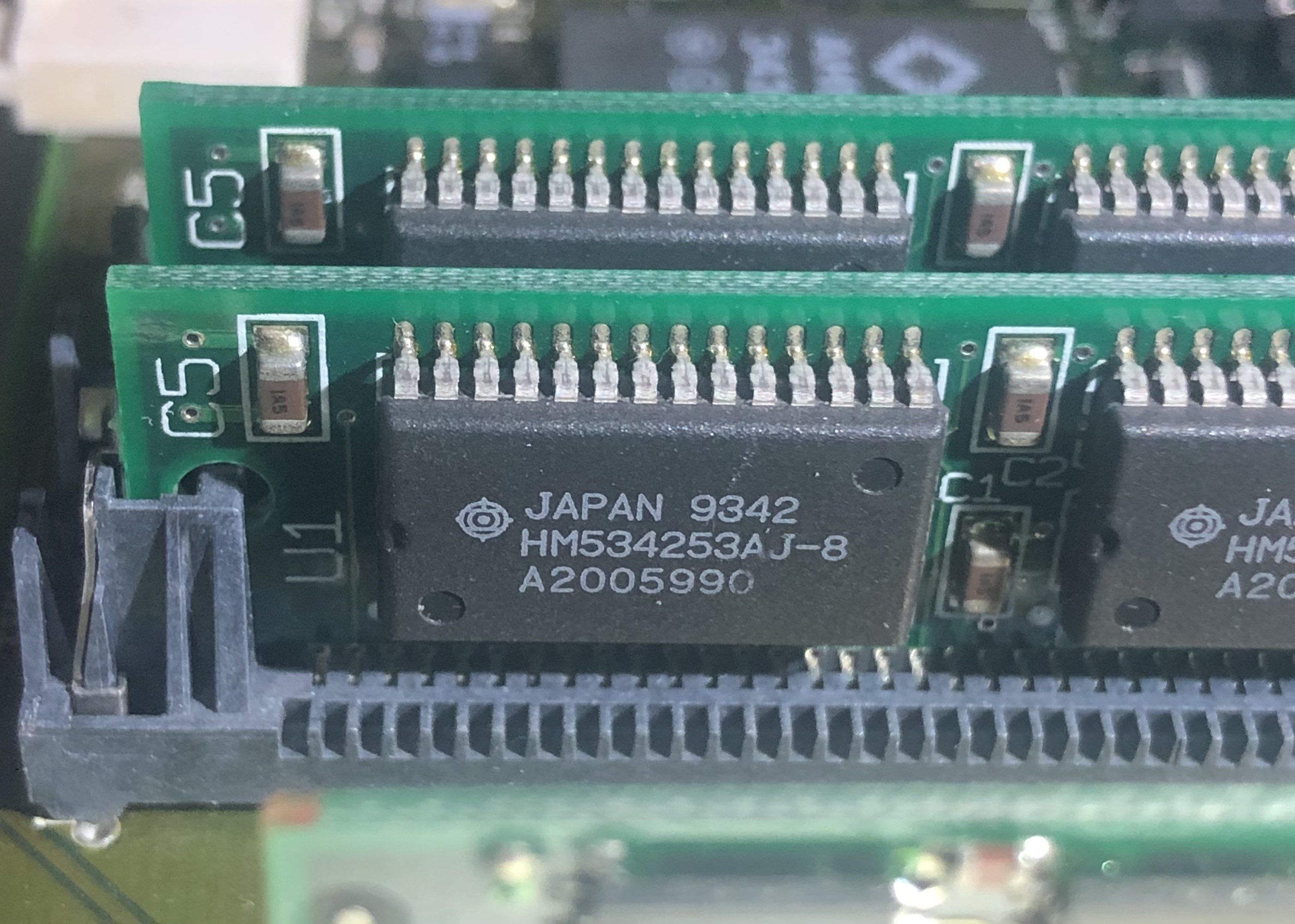

How can I tell if I already have the 60ns VRAM though? Mine already has 2x 512K VRAM SIMMs, but it was updated back in the 90s by its original owner.

And as to identifying what speed VRAM you have right now, I would recommend shooting a clear photo of the markings on the chips and uploading that to this thread.
Here it is. These sticks are actually Apple branded, and dated 1991:
Reactions: Nitram78
The -8 at the end shows they are the slow 80ns type, which is typical for stock VRAM in the LC575.
