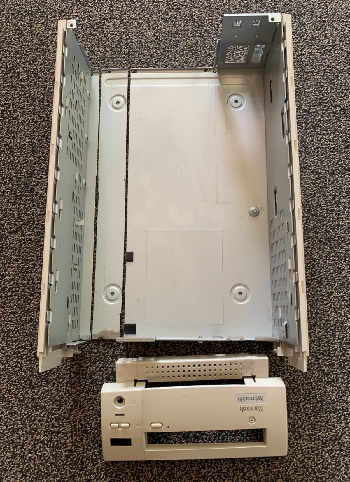

Short weekend update…..
Narrowing the sheetmetal bottomsection to fit the front again.
Next getting these sections together again.
Then shortening to purpose….

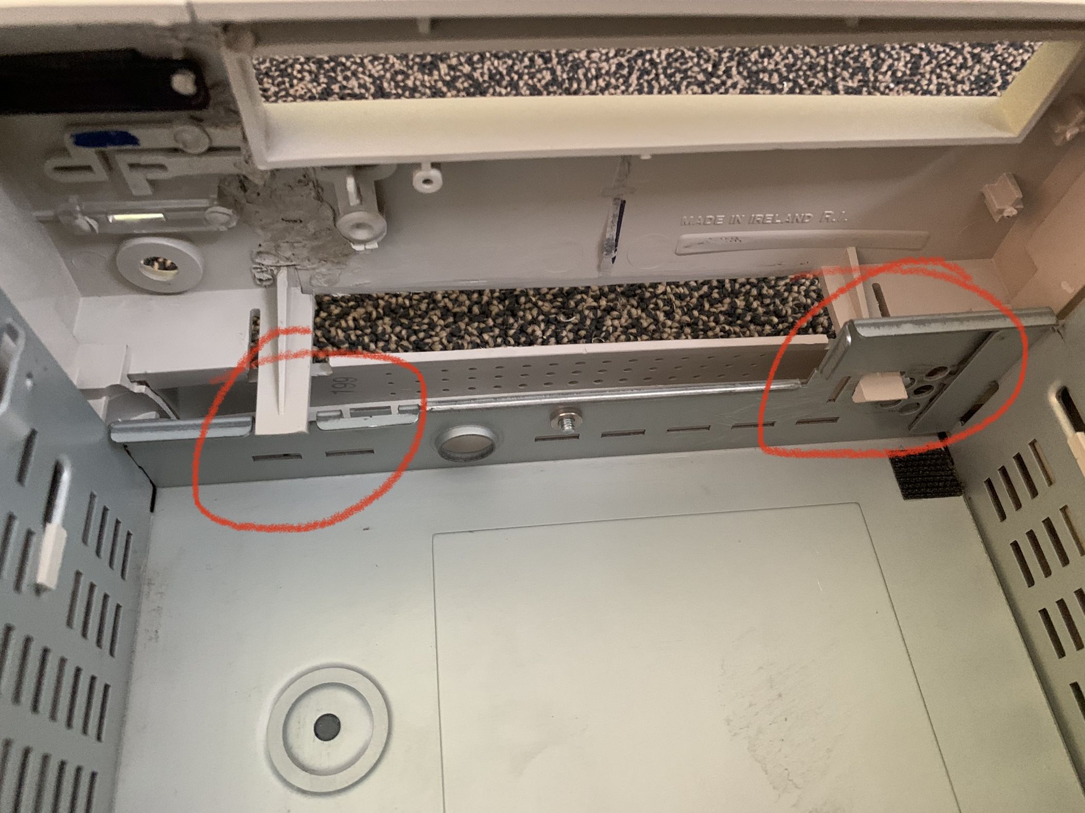

Cool! :)(y) Does it look like a rail on the left and right side of the big open boxed gap on the back to slide in the PSU with side rail grooves?
Thanks!
No rail, at least dont think so…there was a PSU …once…..

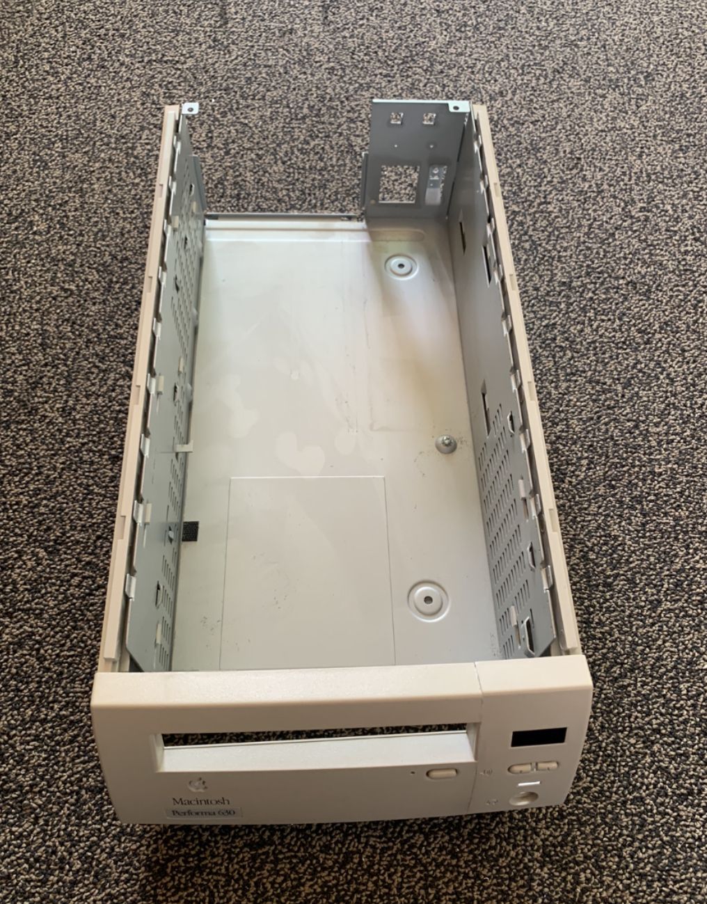

As its length will be (about) halved, the backend will go.
Then a new back panel in alu or pla (3d printed)is made.
This, with all needed holes/connectors.
Just to make that decent again.
