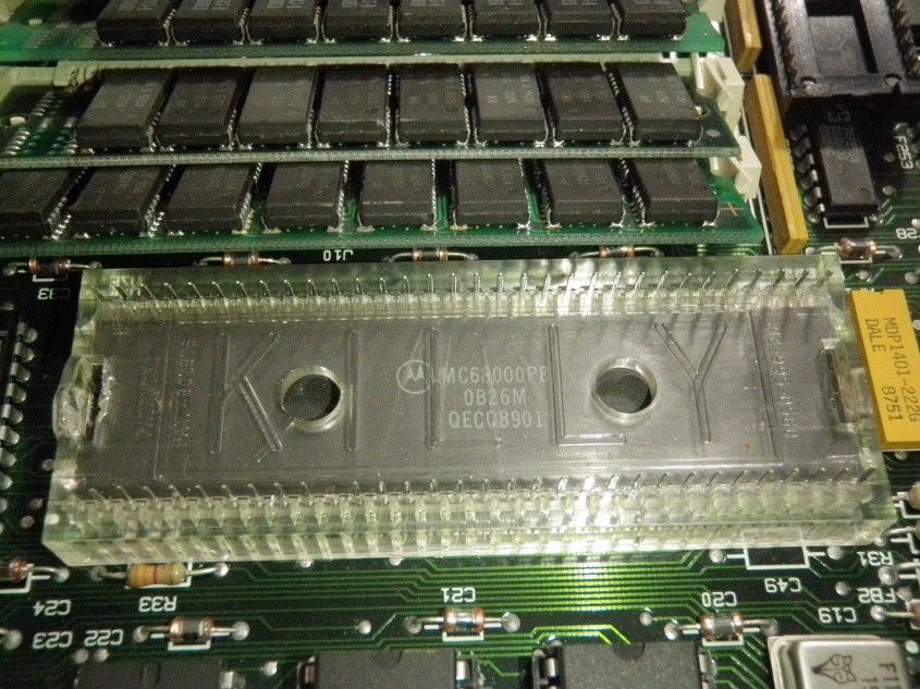

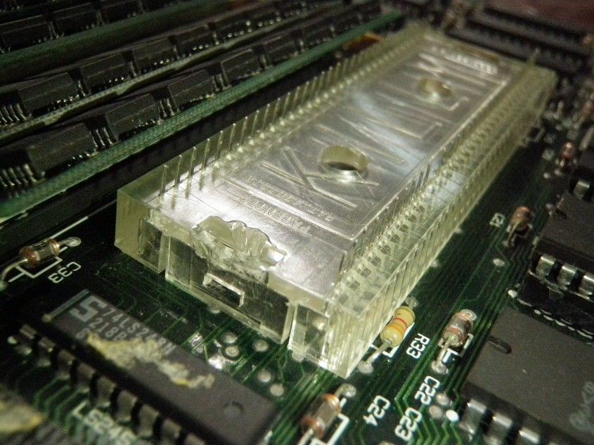

Been a bit, but just ransacked my MLA pics archive. This is what needs replacing with something more workable for the 10cm Square PCB era/card development era.
That was a wonderful, fairly mass produced kluge at the time, but not doable in a short run in this day and age. Besides, it was a bit wonky back when and we certainly don't need that now.

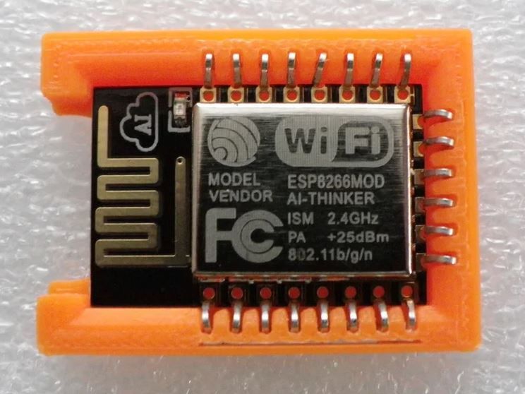

Design will be useful across any number of DIP IC adapters for experimentation if a chip select or power cutout is implemented on the original IC.
Might that be the one mentioned in a thread over at the MLA? ISTR the designer saying it was a one use kinda deal at the time. I posted that first pic over where that was mentioned.

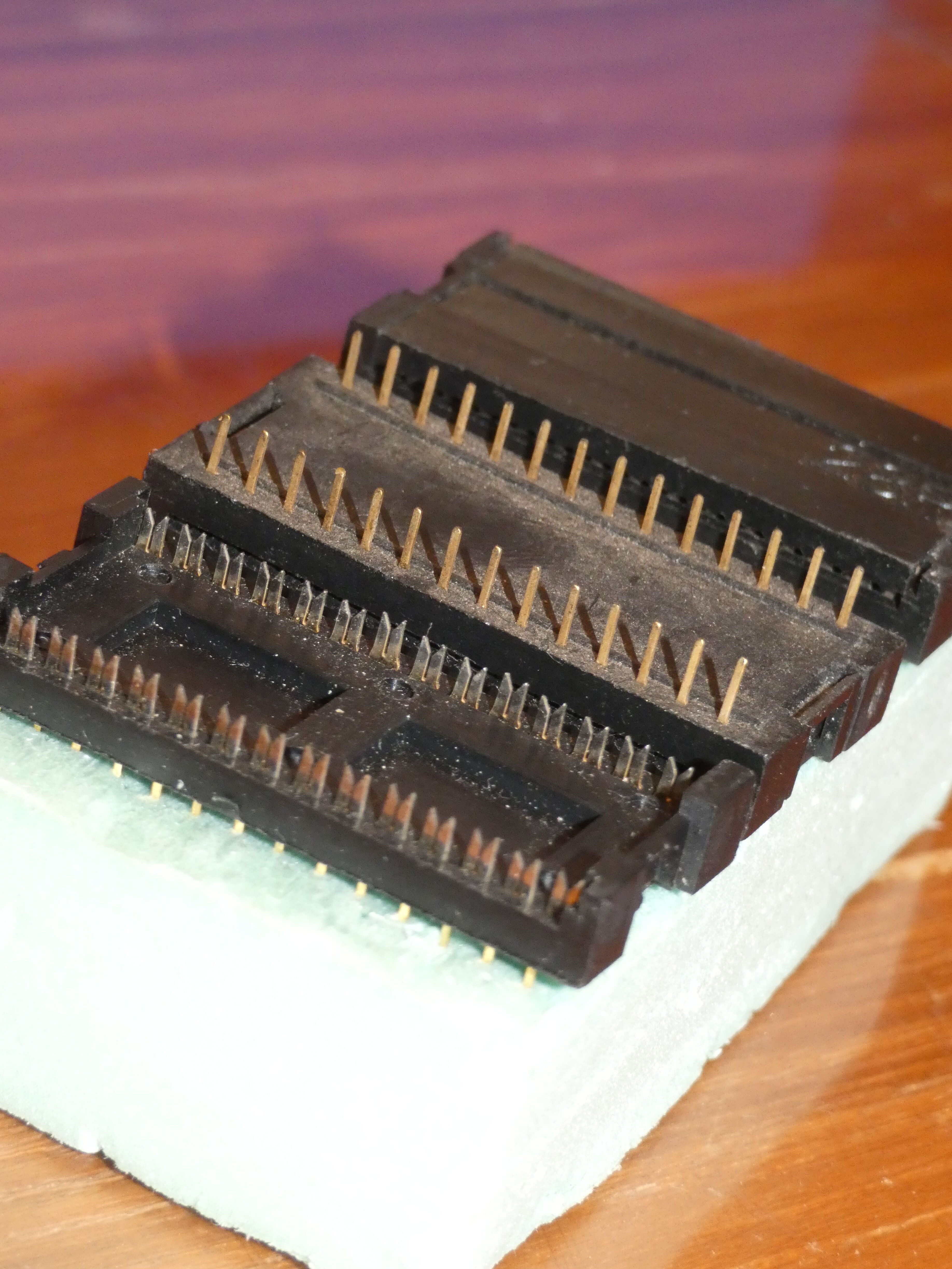

Took one glance again and now am wondering how flexible the thinnest single sided PCB might be if cut in a comb pattern dividing pads for flex-contact up along IC legs with RA Headers installed in the thruholes pointing straight up?
IOW, split your board in halves to sock the teeth of the comb upside the IC legs with header pins (or sockets?) pointing straight up? The inter-leg support structure of the orange beauty above will come in handy for corralling such a bodge?

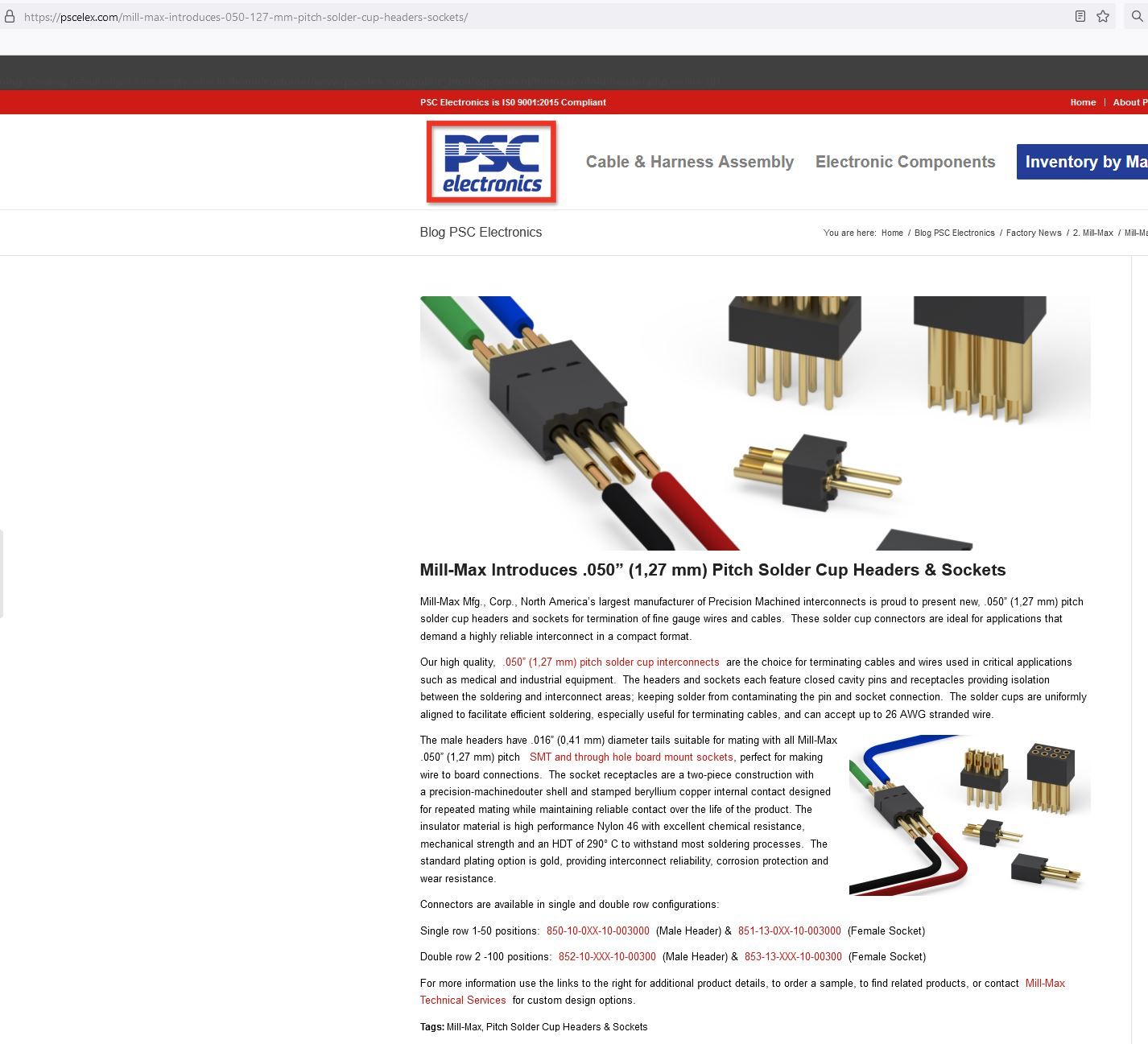

Had snagged these pics for a budding Interesting Parts Catalog thread.
Pic illustrates the concept well enough I think?
moar goodies:

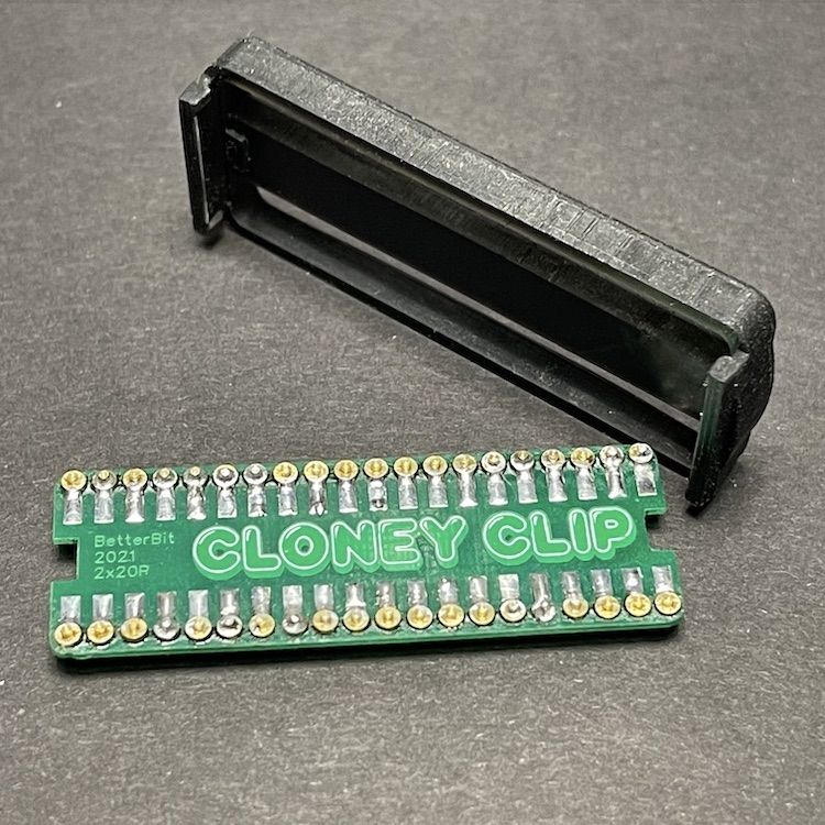

I was lucky and could submit a few prototypes to JLC before they enforced minimum PCB size guidelines. I used the thinnest board and made "tongs" that came down to touch the sides of the legs, held in place with a 3D printed frame. My results weren't promising but perhaps there is a better technique.
Can you provide any data? I need to replicate and print. Thank you.
