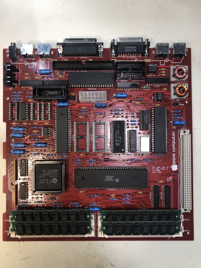

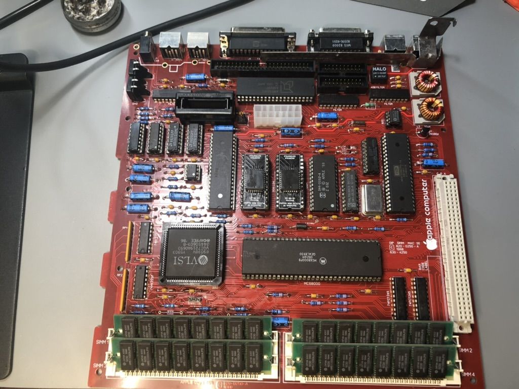

Another visual update. I believe I have all the components on the Reloaded board:
You can see I also put back in what was left of the bracket, since it will be needed to provide a ground connection to the rest of the chassis.
What's left to do? Plenty:

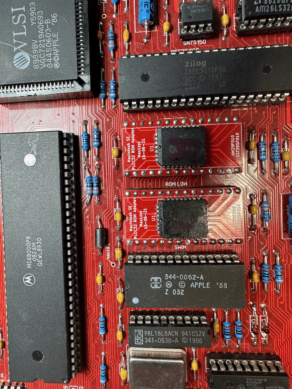

The main next thing to do is to soldered the newly programmed ROM PLCC chip onto the adapter board, which will be whenever I have a nice block of time to patiently deal with that.

I remade the Low ROM and tried it out, but no dice
No chime at all, as well.
I'm hoping this is a pretty easy thing to diagnose.
Following the advice of the folks on the discord, I've remade the ROMs, but I'm still pretty much where I was as of the last update:
If anyone has any pointers, I'd really appreciate what to look at next.

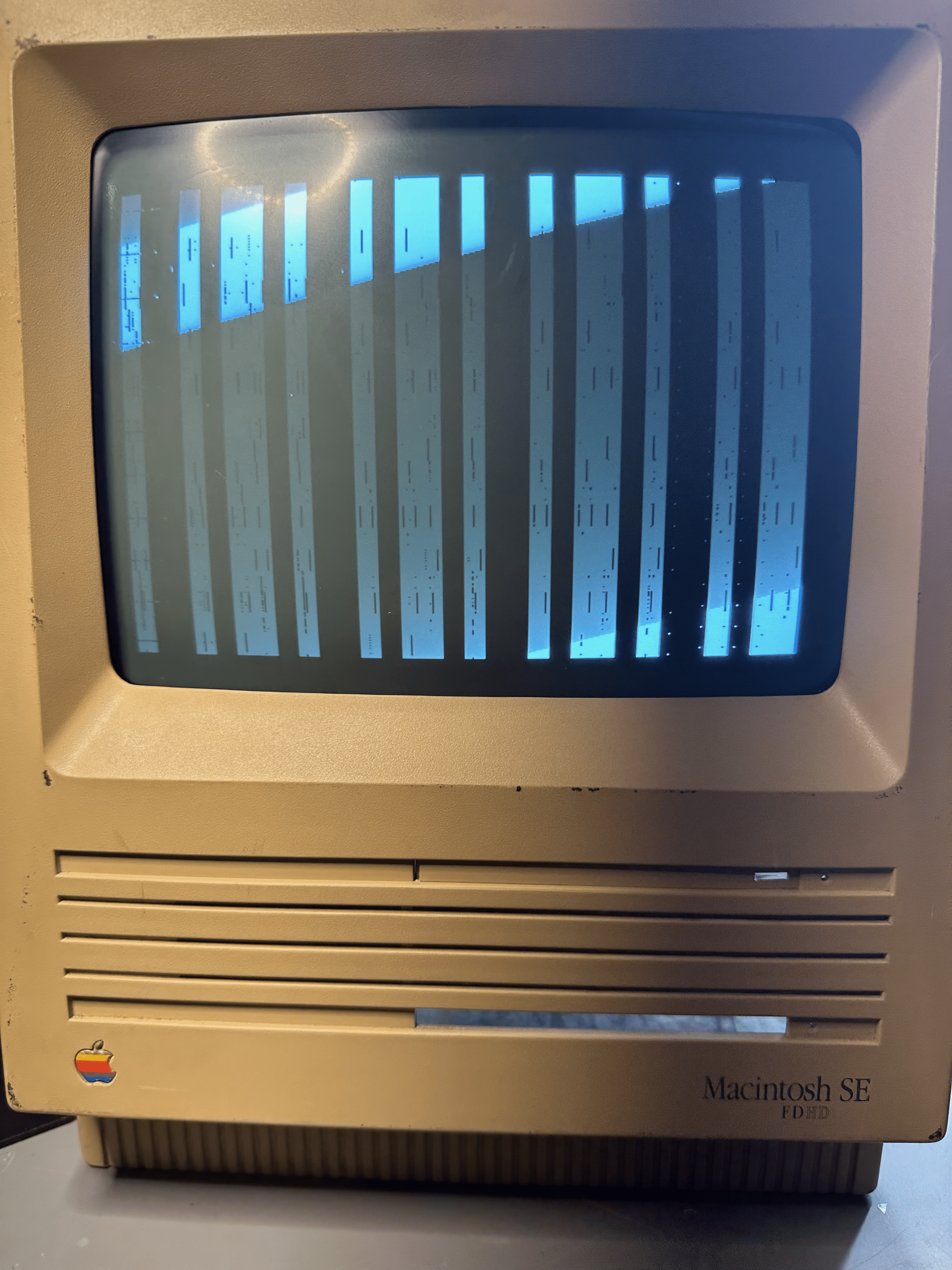

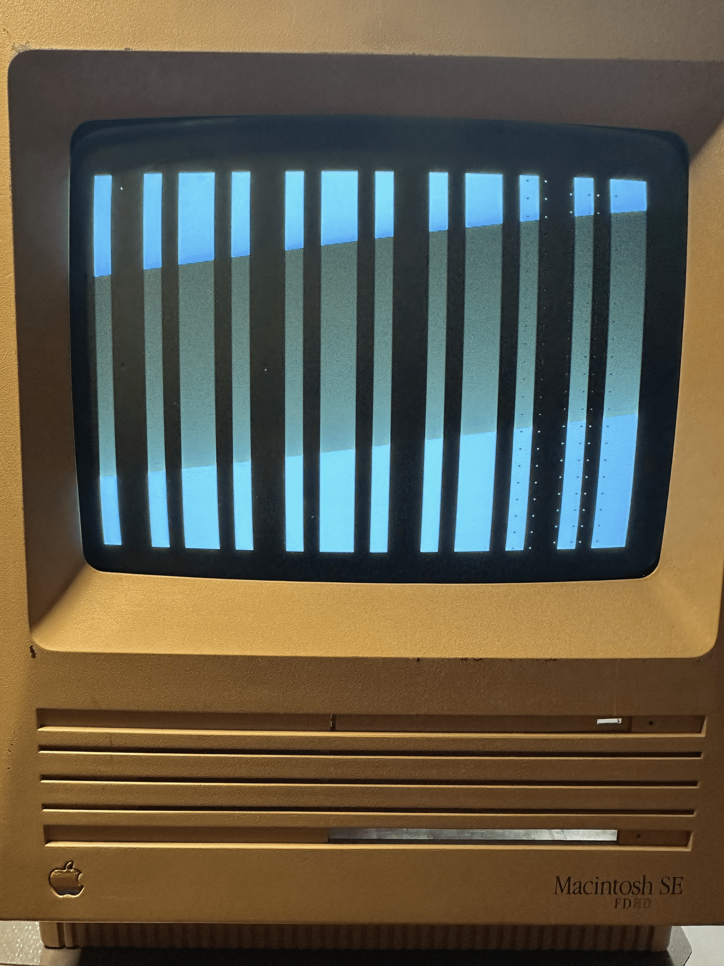

Does anything change if you move the analog board to logic board harness at all? My SE was showing the weird artifacts before I changed out the harness for a different one. It didn't show the jailbar pattern, which, according to the Repair Mac site for the SE/30, says is RAM related...
Just tried wiggling the harness between the 2 boards and the pattern doesn't change at all. I did reflow the usual suspect on the analog board where the cable to the logic board connects to.
I'll try messing with the RAM sticks I have, but the contacts on them seem a bit worn.
