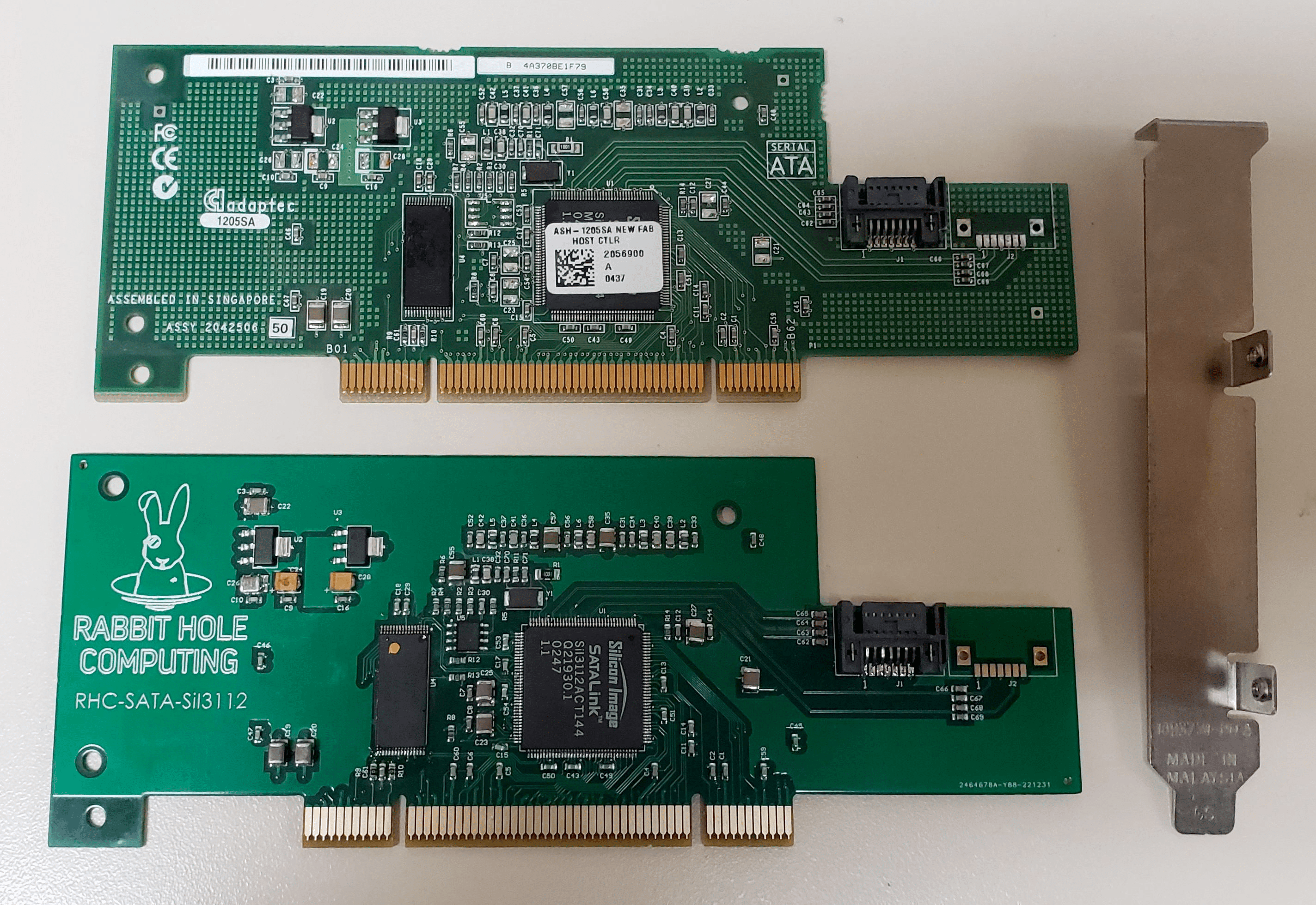

We chose the Adaptec ASH-1205SA (The AAR-1210SA RAID uses the same board design, the only difference is firmware), which was based on the SiI3112A SATA controller IC. It's a four layer board, with internal ground and power planes. All components are surface-mount.

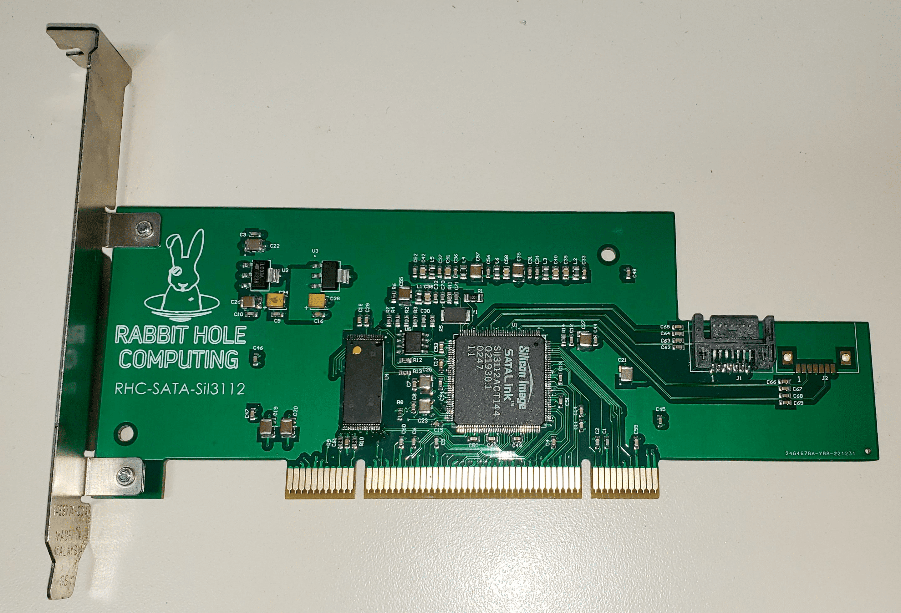

Here's the first 1:1 assembled and tested clone:
Here's an original Adaptec ASH-1205/1210SA (same PCB) that we cloned, next to the resulting clone board. Some of the capacitors from the Adaptec board were cannibalized to test the initial prototype. The majority of the passive components, as well as the voltage regulators on the PCB, were assembled via pick-and-place. Once we received the partially-assembled prototypes, we then hand-mounted the SiI3112, harvested from a low-quality Chinese donor board via hot air rework. A small quantity of the flash memory was purchased off eBay, and soldered down.

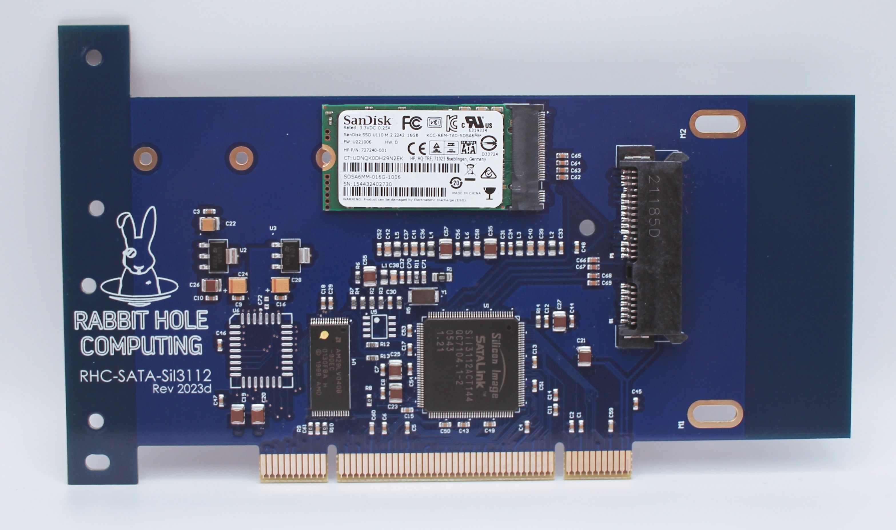

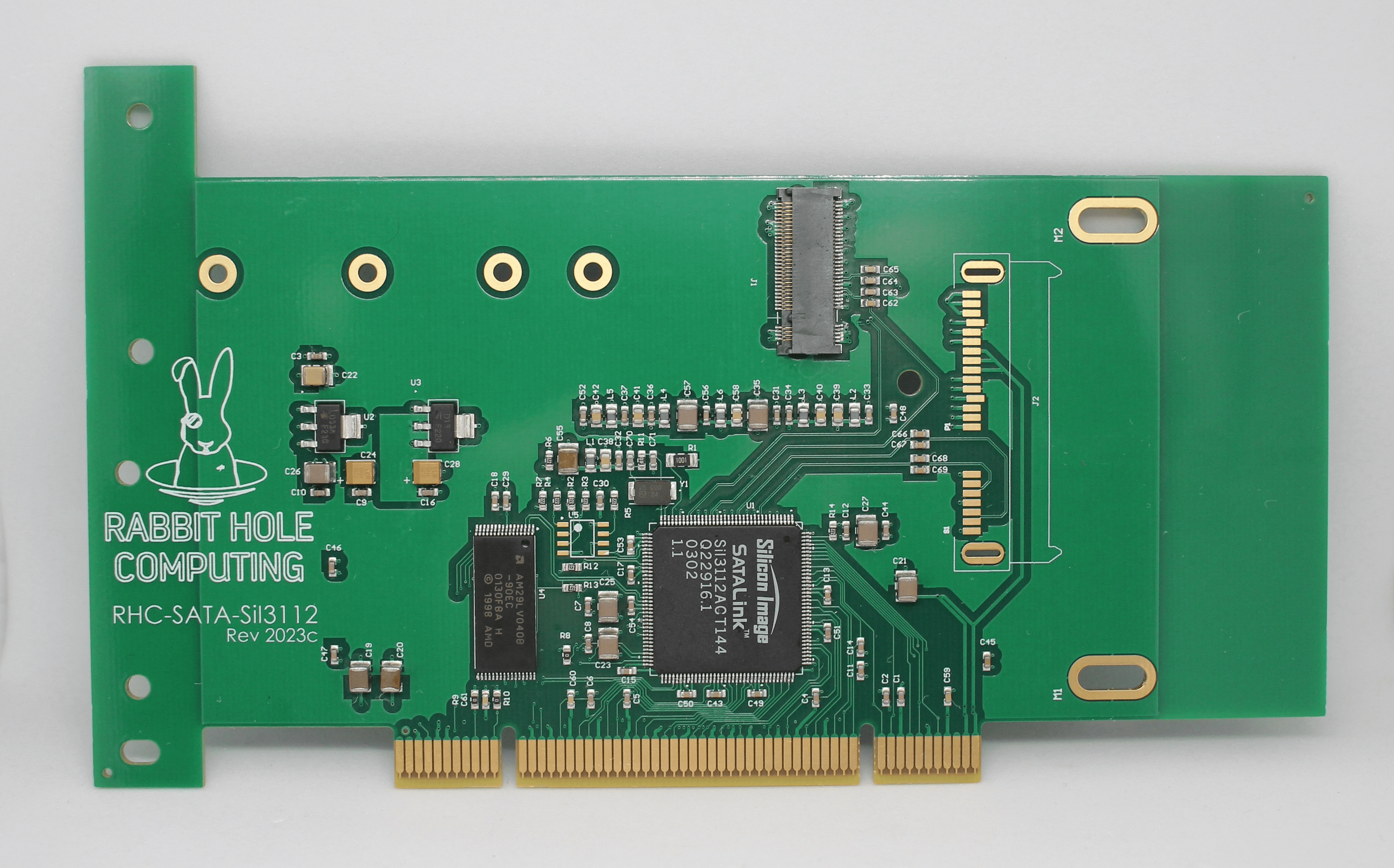

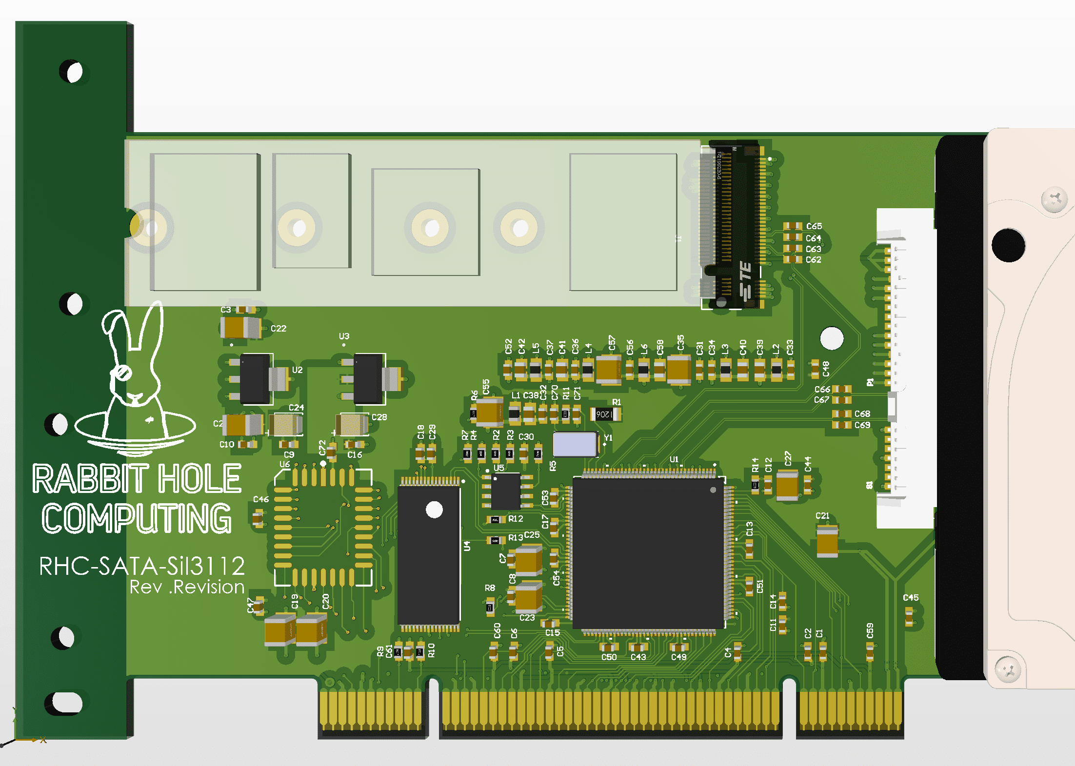

Now that we've validated that the 1:1 clone works well, here's where we're evolving this design to be. It has one M.2 SATA connector, and one power+SATA connector for a 2.5" SATA SSD, with two mounting holes in the PCB to securely fasten the 2.5" drive from the bottom.
The final production board is nearly identical to the one above, with the addition of support for an optional PLCC32 EEPROM, in lieu of the TSOP flash.
