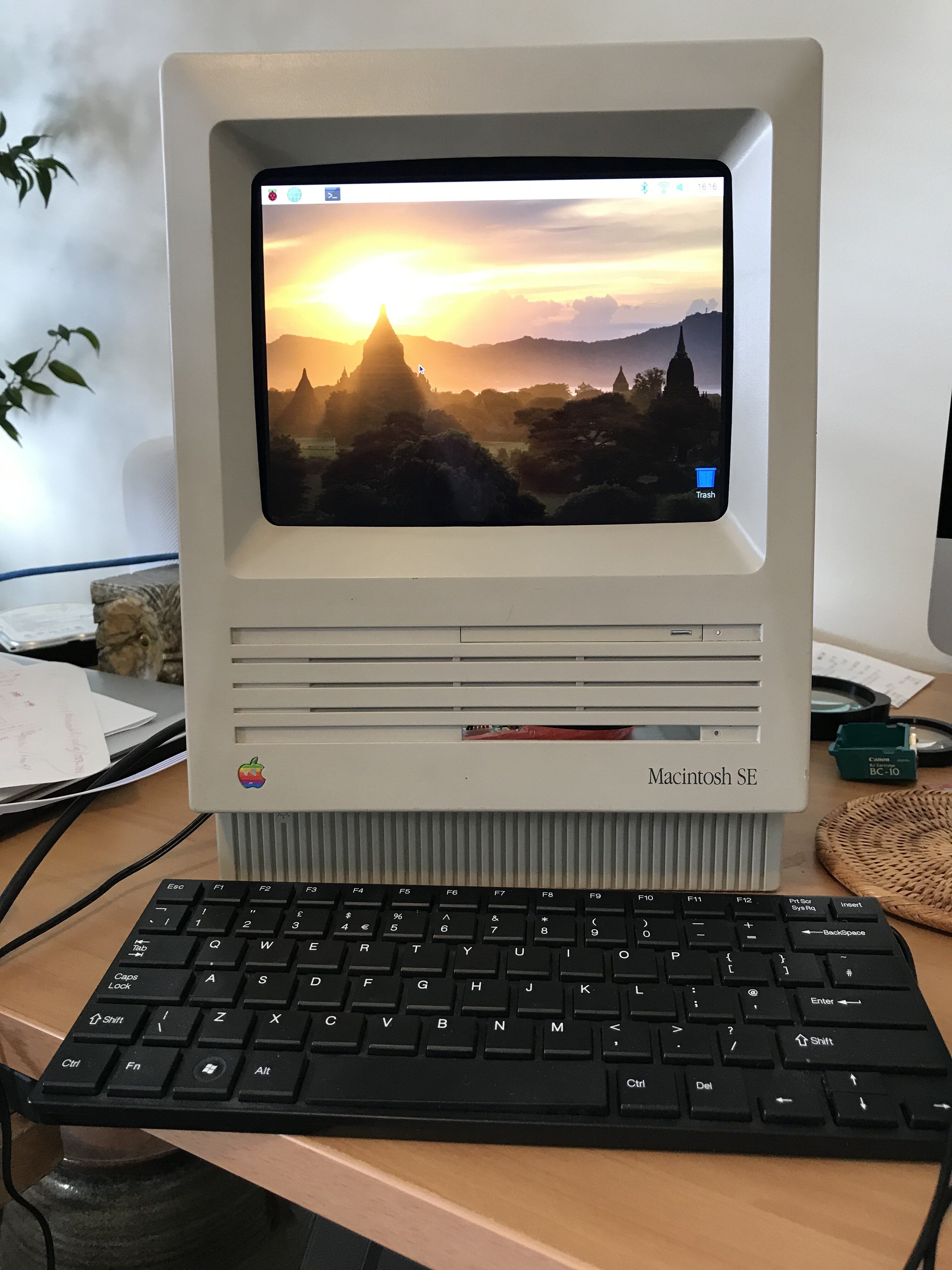

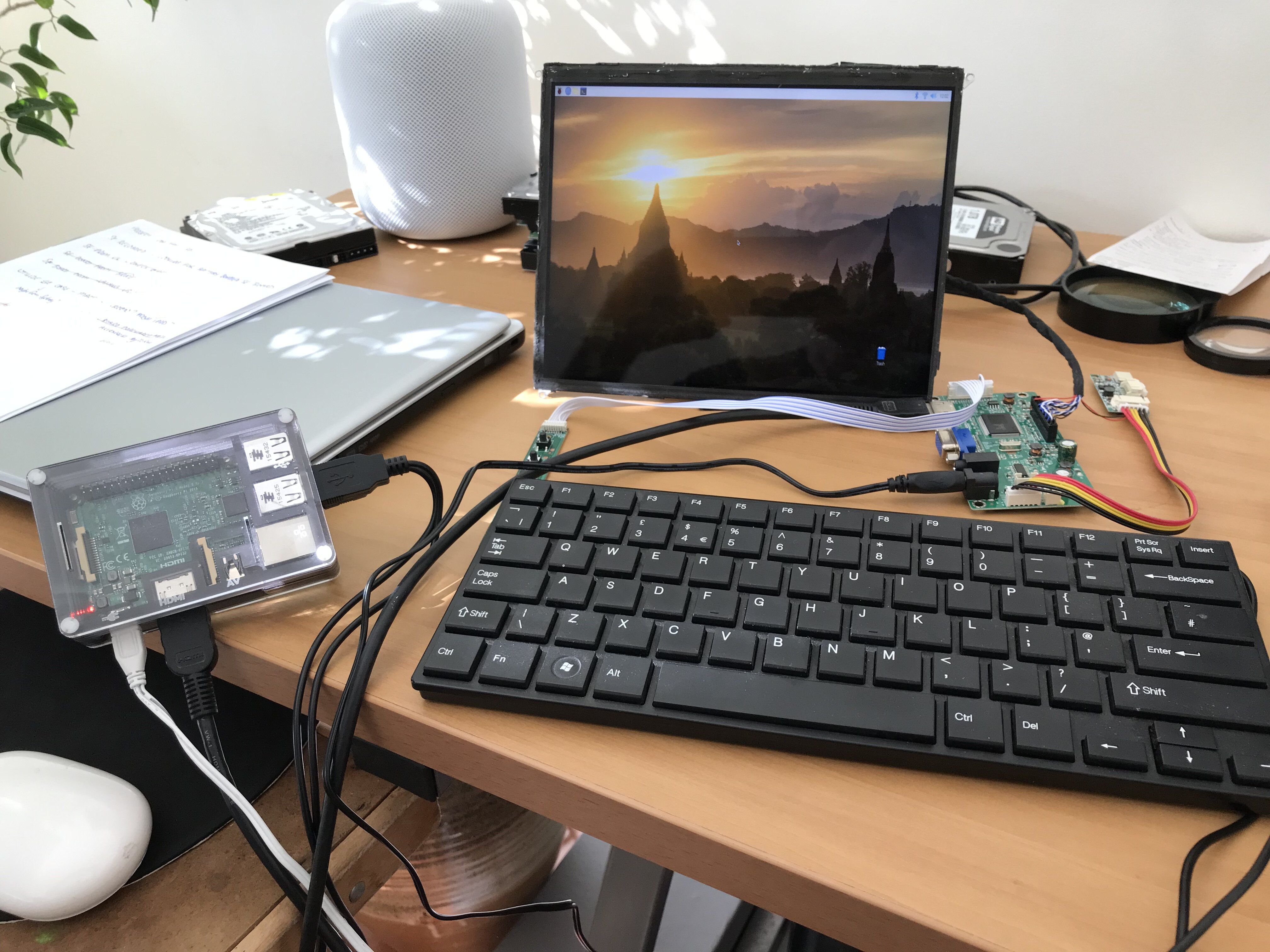

I'm using a panel from a ipad 3 with a raspberry pi in a compact mac case. It fits nicely and you can adjust the size of the window to fit. The controller board I purchased from Ali Express. May be the thing you need.

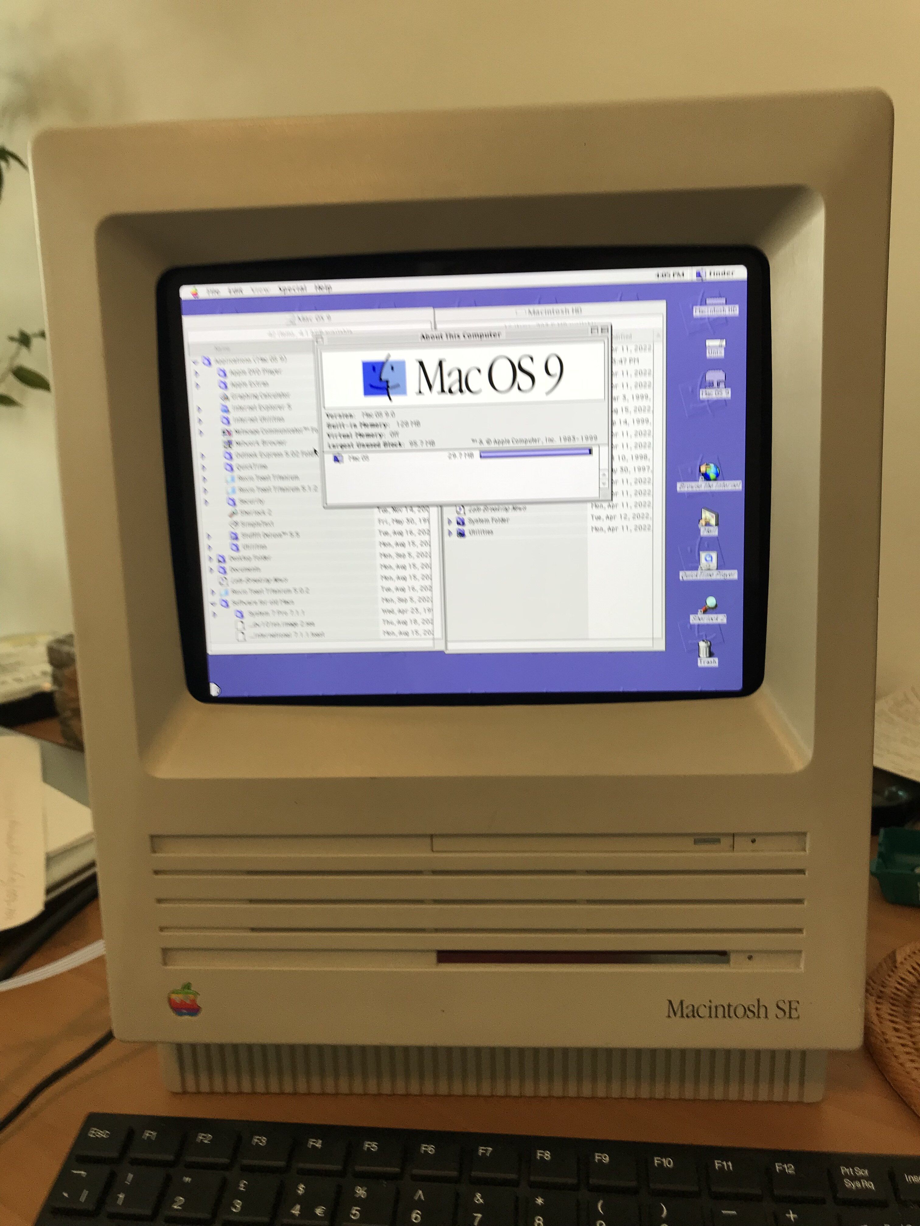

Don't want to highjack this post. So I'll give a brief rundown.
Had a spare pi 3B+ and a damaged ipad 3. Dissembled the ipad and the screen was OK. Purchased driver board from Aliexpress (https://www.aliexpress.com/item/32765195617.html?spm=a2g0o.order_list.0.0.77fb1802OwmMKr)
description -
4K HDMI LVDS Controller Board for iPad 3 4 9.7' LP097QX1 SPA1 SPAV SPC1 2048x1536 EDP Signal 4 Lanes 51 Pins LCD Display Panel​
Followed this - https://github.com/jaromaz/MacintoshPi
You can adjust the screen area using overscan in the config files for each install of Sheepshaver or Basillisk.
Still havn't permanently homed the pi and screen in a case yet. Pics of test setup

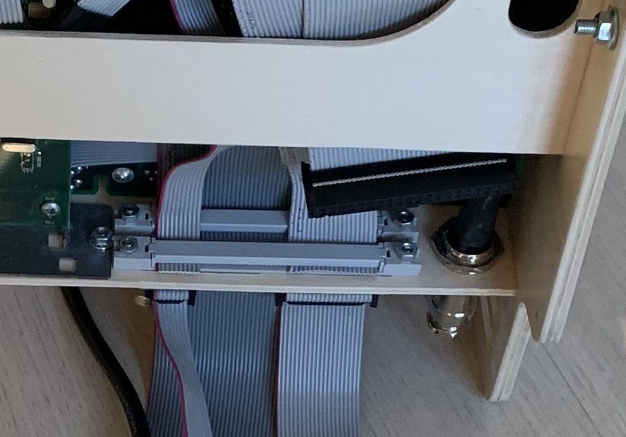

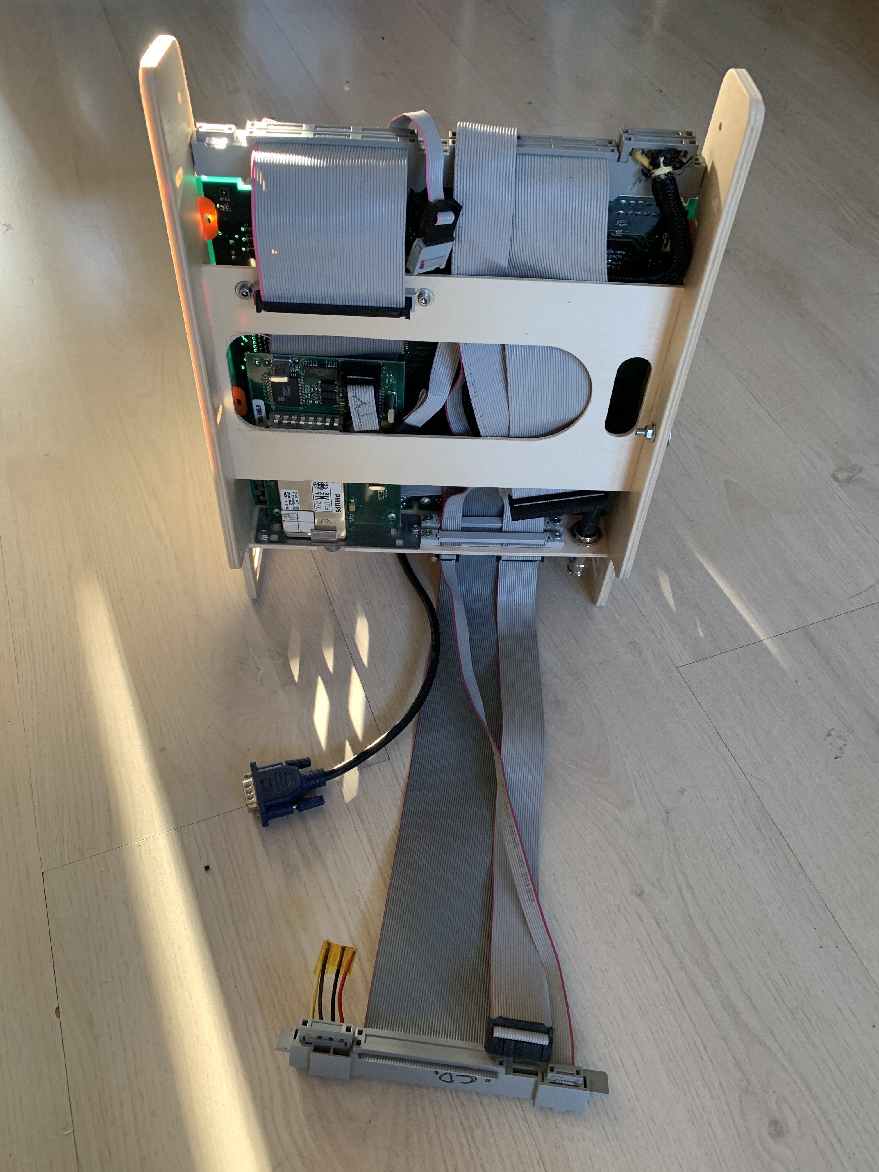

Cable update….
Not much too mention….
Bandcables are ready and connected,
PSU cables extended,
the external powerconnector left todo.
Next display assembly, and trying to get the new psu going.

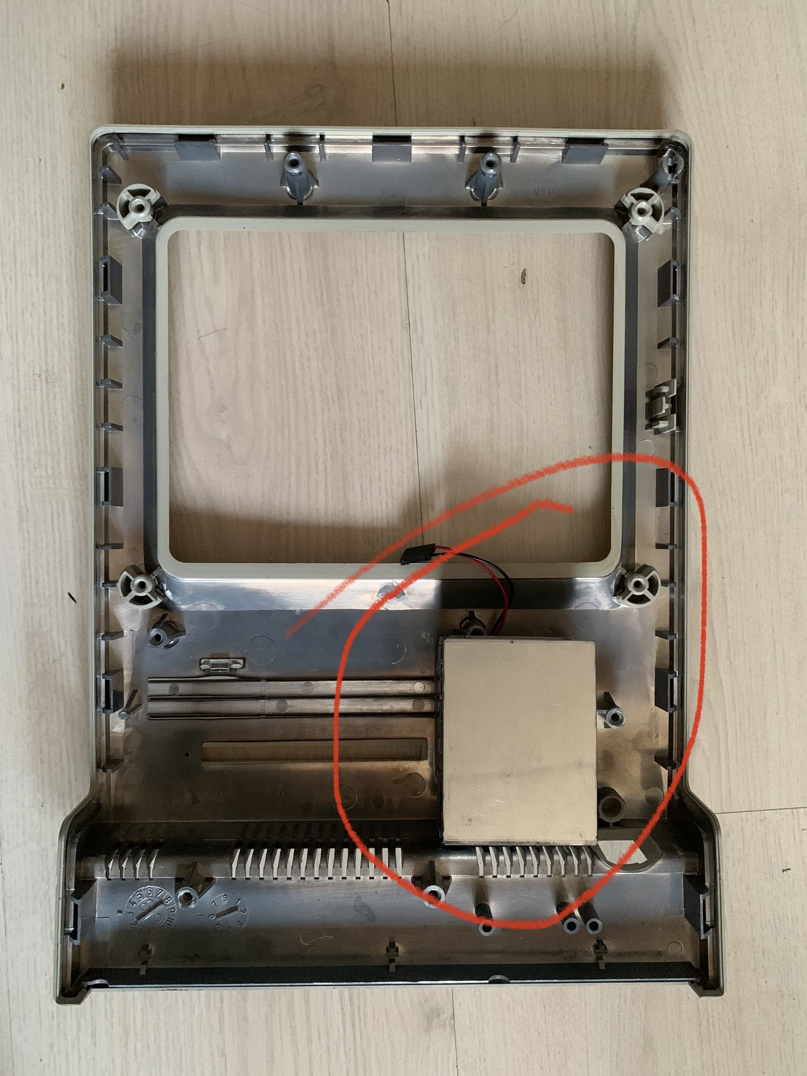

Hi,…..no, in this case I will be using the flatpanel previously shown.
The front/bezel needs machining to make use of the full 9,7“ view.
As soon as ive got the electronics in good working order, I shall finish the enclosure & details.

You don't have enough thickness a/o height in the void for the cables below the display on the lower right side to mount the box parallel to the vertical frame? It looks like plenty of cubic is available even, worst case you'd need to notch out the vertical member:
All you'd need to do is desolder the IR sensor and use extension wires (legs of a radial resistor type) to line it up with the HDD activity LED opening. given a bit of clear plexi magic, the opening could do double duty achieving function of both applications.
Reactions: fred1212
Thanks again for your suggestions.
There is still sufficiënt space behind de front panel, below the display, above the cooling vent ridge.
If proven a usefull feature I will place that remote box there. The controls switches can then positioned downward and so manual/remote control that (almost invisible) from the frontside.
No soldering needed.
For evaluation its now mounted in the backside, until I feel its a usefull control feature, worth adapting the frontpanel.
(For ir remote, just place a mirror tile behind the unit btw)
