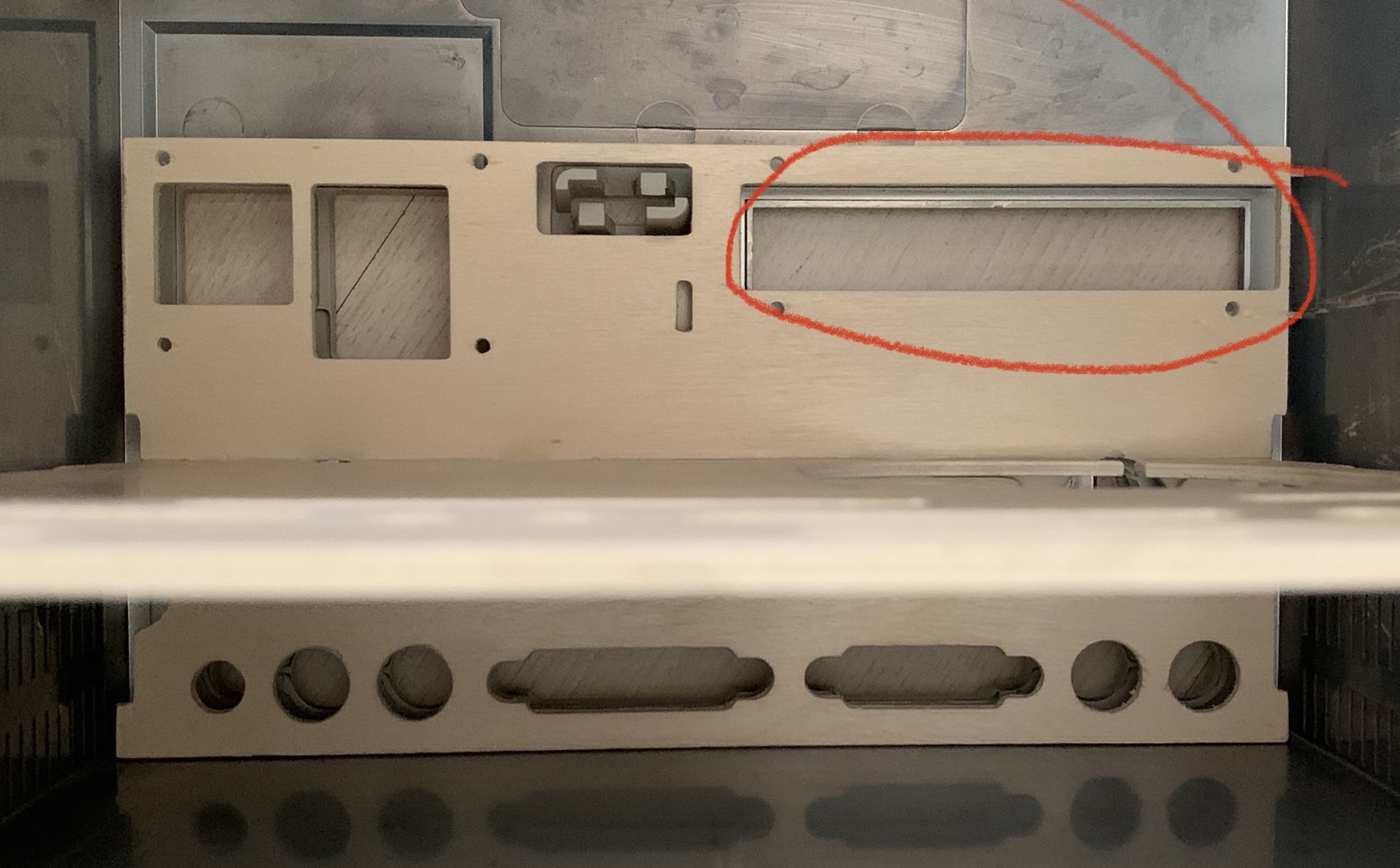

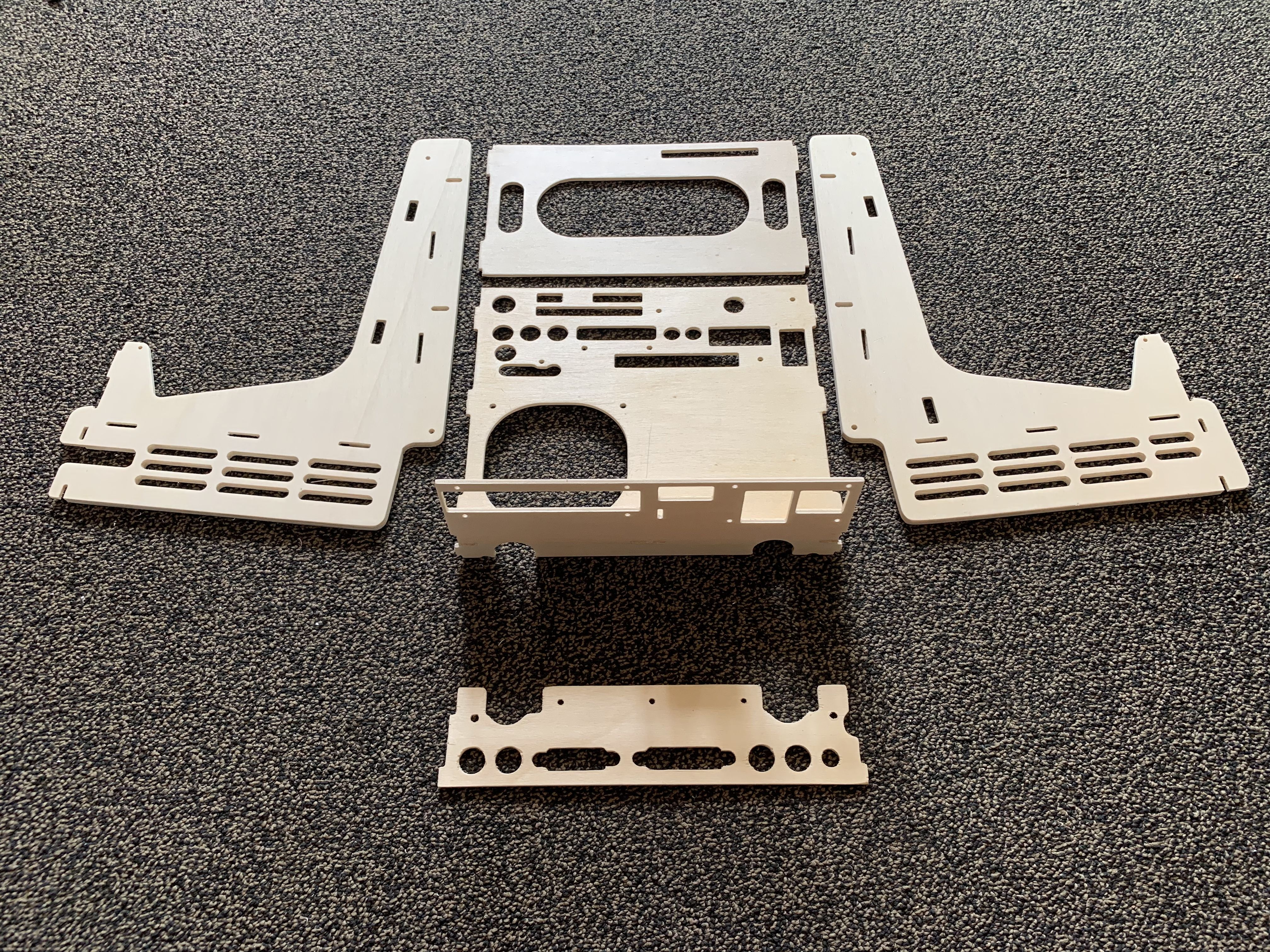

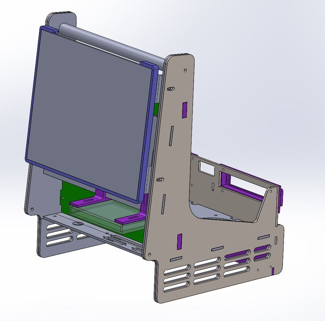

-Ok, finally ready for testing-
Here are the prototype files for my SE40 project.
Files and use are free under Creative commons- use on your own risk-
See also the readme file for additional info.
Looking forward to see the work done by members on this.
(Edit- Files can be found in the recources section)

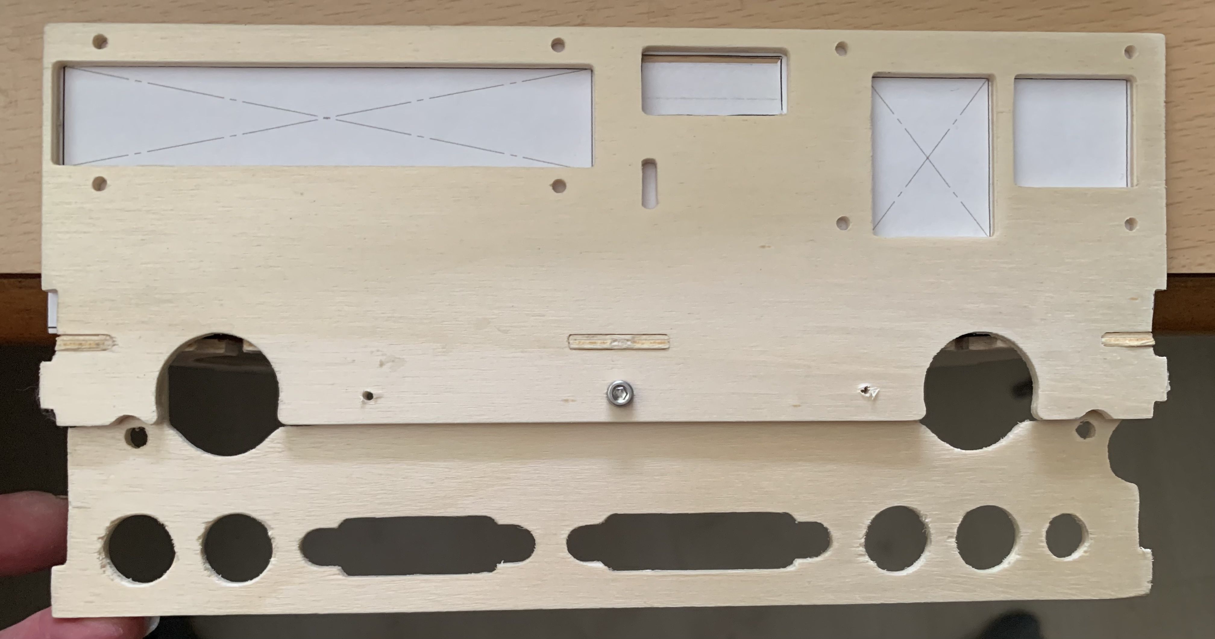

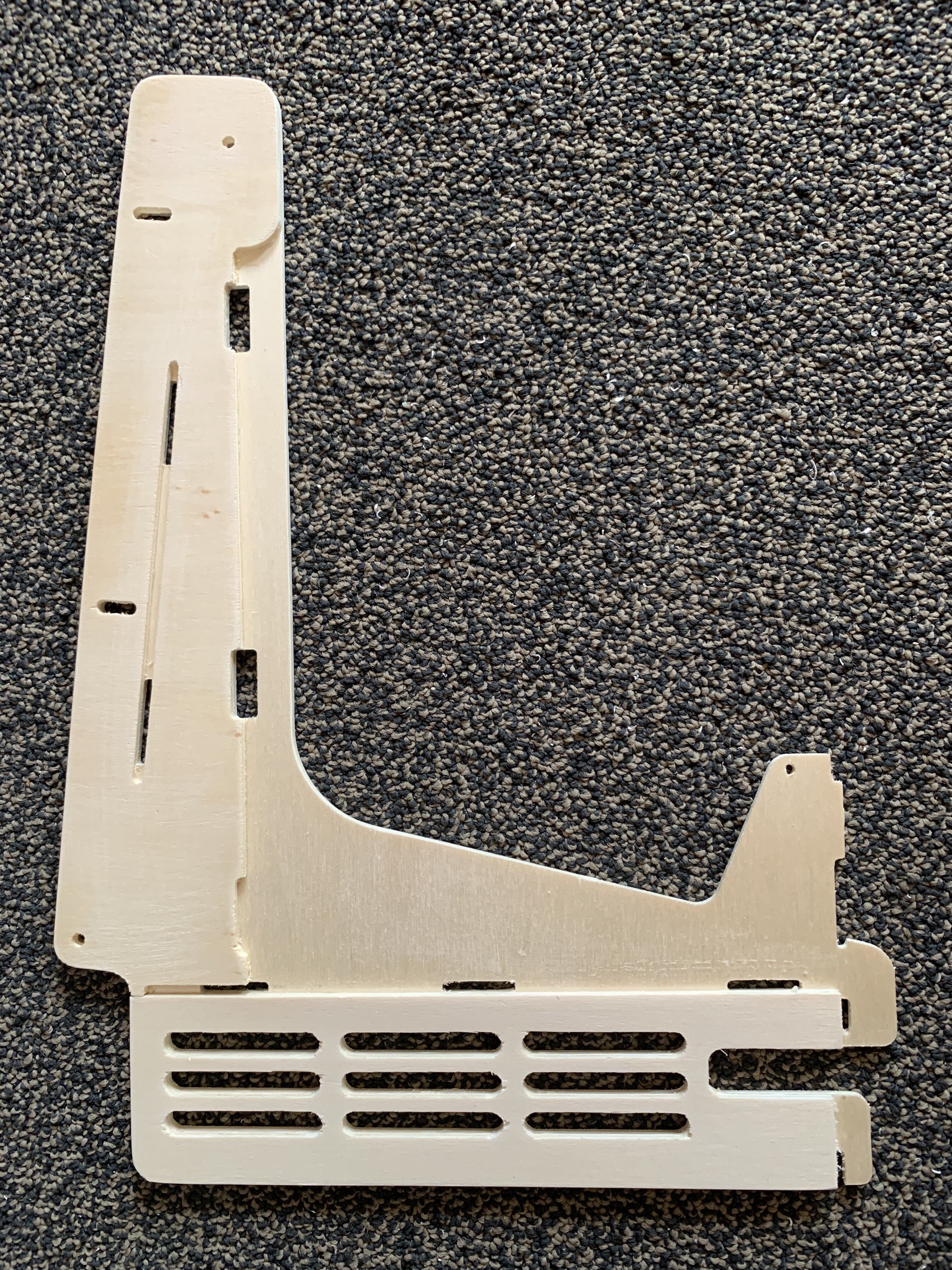

Well, I did gave V2 a chance, cut the parts and overall it does fit well, but there are a few improvements to make ….
- V2.1 comming up next!-

Beautiful! Wondering how long it will take you to have a sheet of plexi laid out like that for a clear bucket? We don' need no steenking handles! Not in a short stroked bucket with a beautiful wood chassis anyway. ;)
@Trash80toG4 - cutting cast plexiglass with a suitable cutter is no problem.
Troublesome is the cheap acryl with a unsuitable cutter. But having cheapo acrylics lasercut (or I guess hydrocut) is no problem again. As for speed, I am not interrested as its no production. Think cutting time took me an hour incl post process .
Well, I make some adjustments in and recut these items next.
(handle is optional btw)

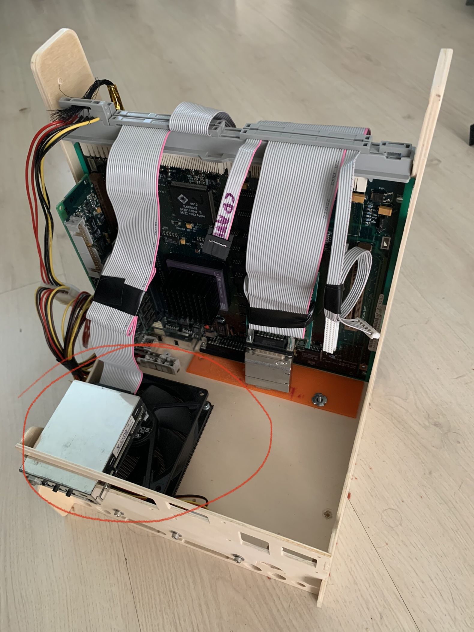

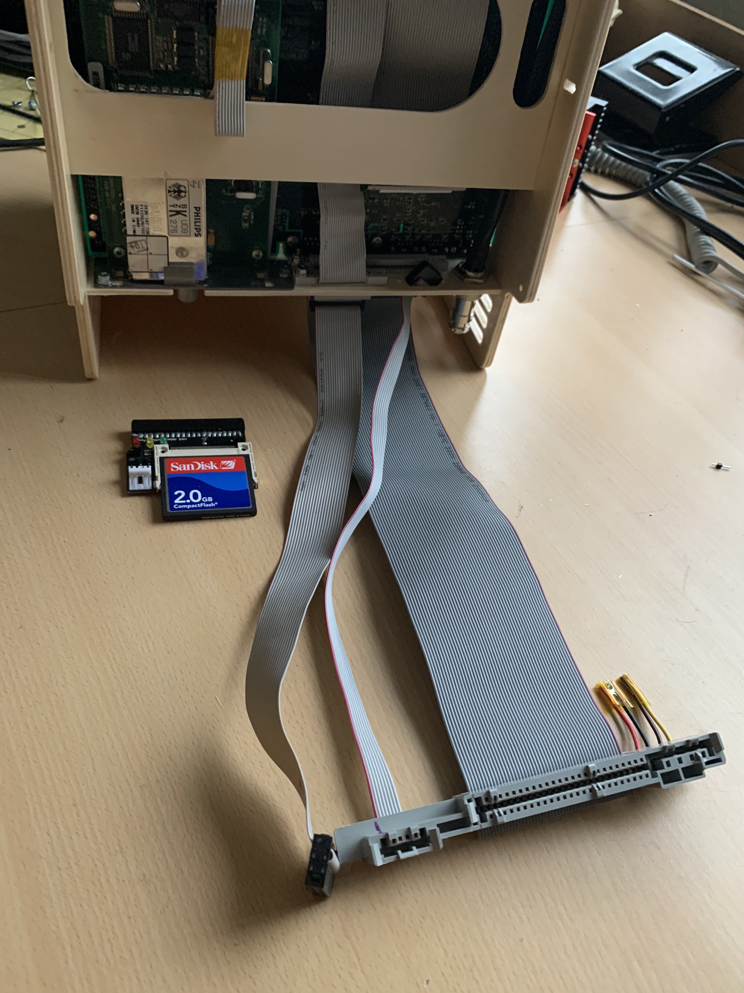

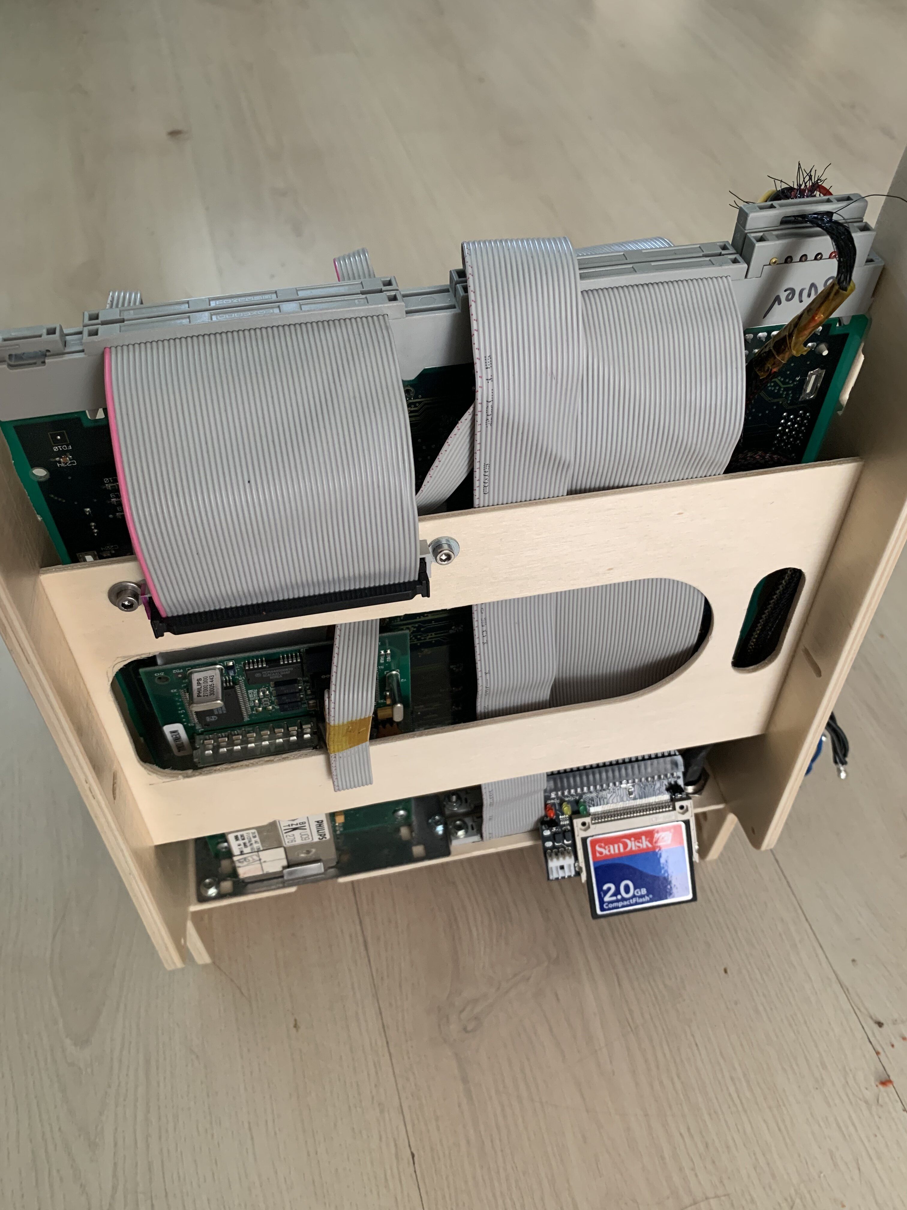

Hello all,
New frame testbuilt on the way.
Minor adjustments to the TV-out card - position.
Further its spot on
(asfar a I can see)
Next the assembly and cablemanagement.
Due to rising of the PCB baseplate,
the remaining space above the connector has become minimal - as expected-
It does fit well!
Glad I made these adjustments!

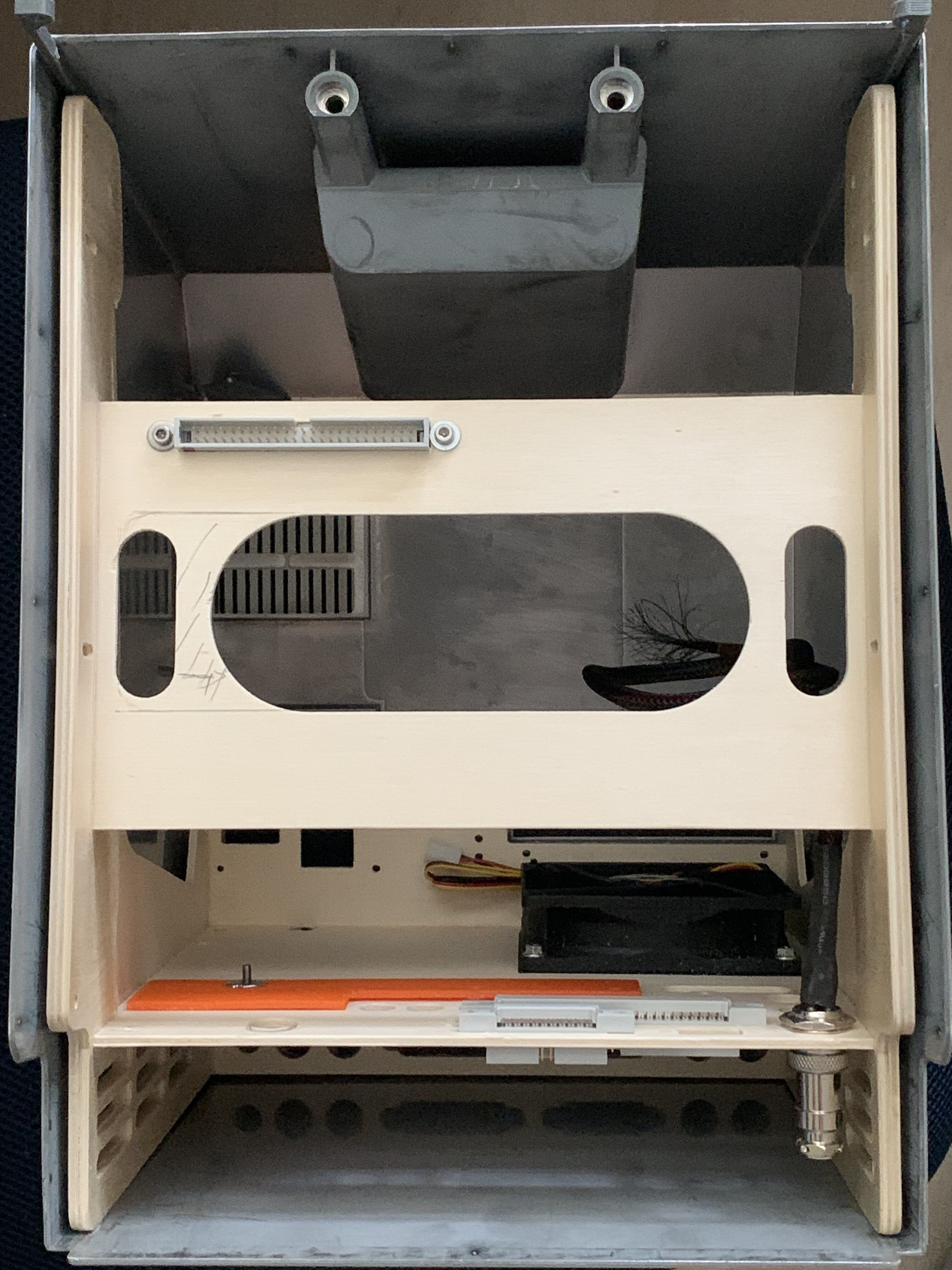

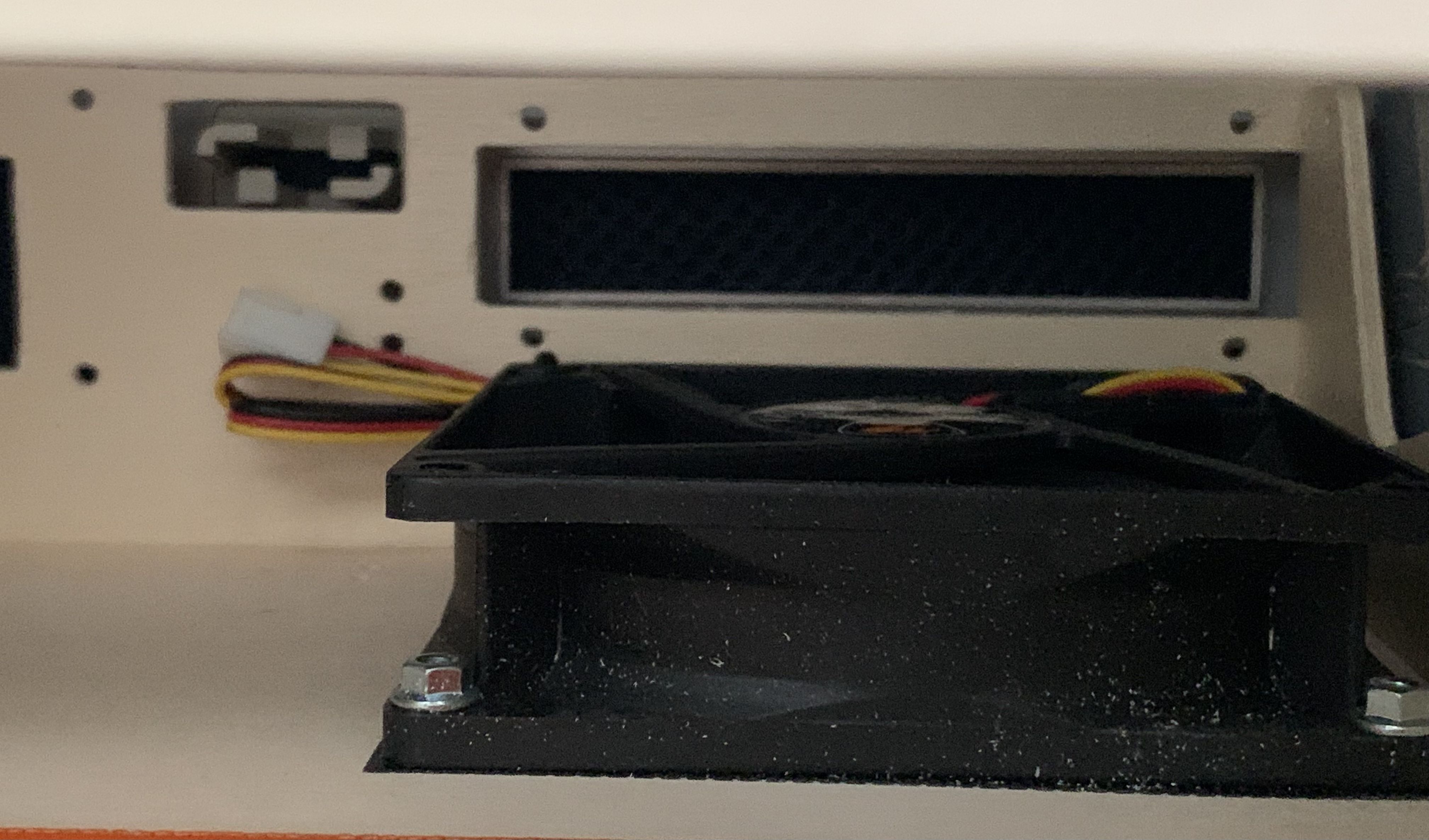

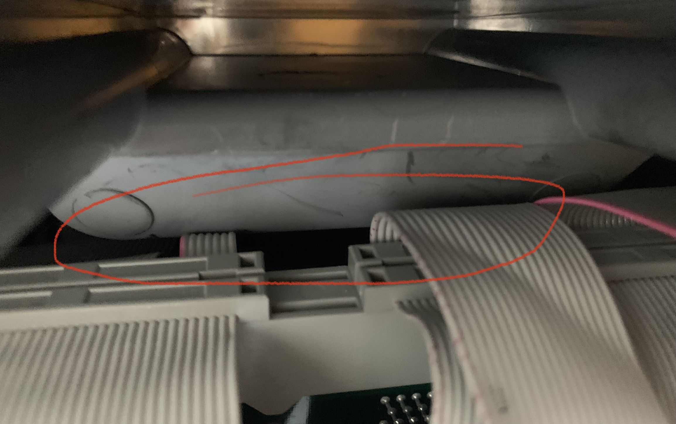

Toying with the connections/cables showed that the fan position could better be on the right side. This to allow undisturbed airflow upwards….I just have to see how that combines with the mains connector and switch. Otherwise - instead of the bigger - to apply a smaller fan in the middle, free space…

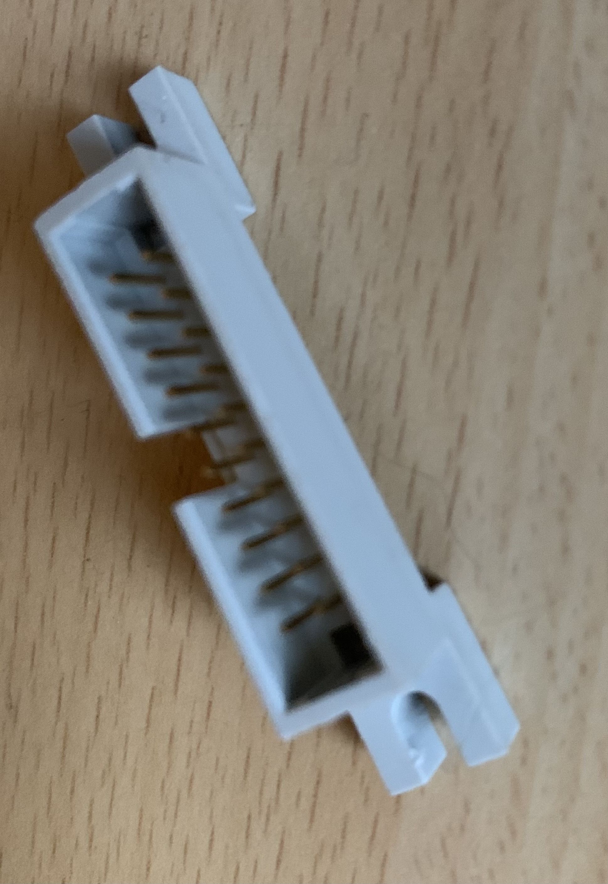

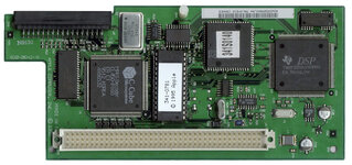

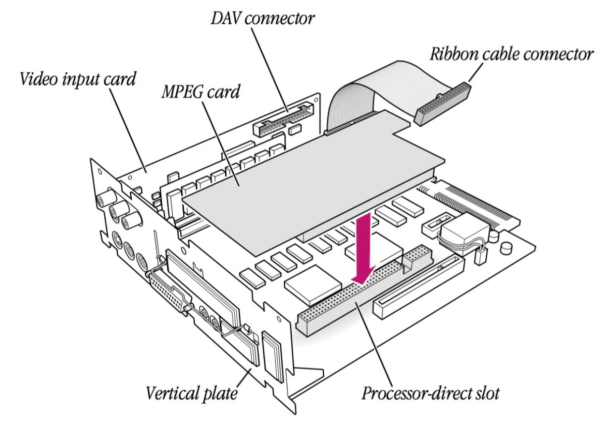

Anyone knows what this connectors purpose is for?
Nothing was connected when I got this 630.

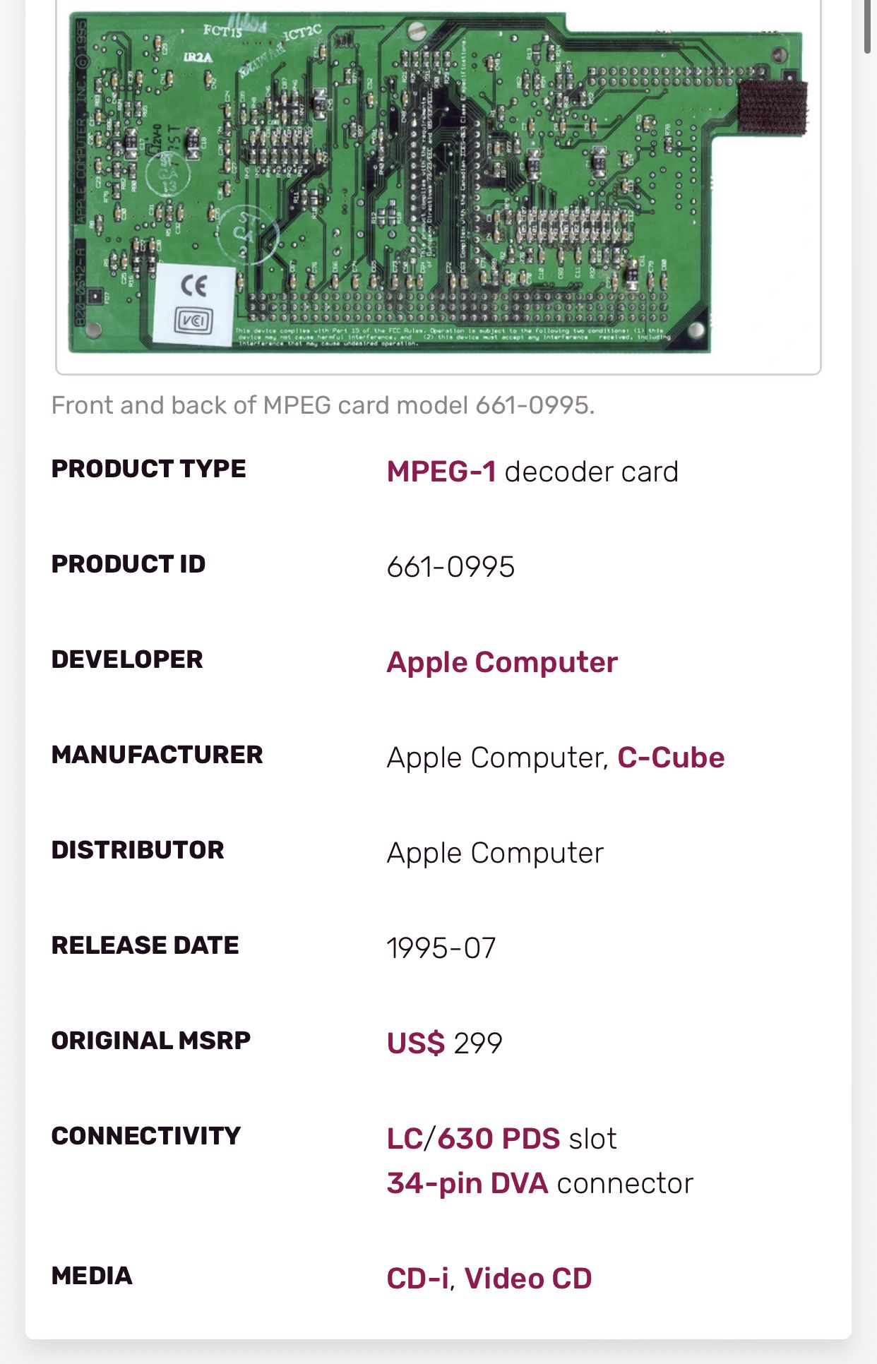

The MPEG Media PDS Card cables up to that connector. DSP on board does some CODEC or other for early video and PhotoCD and if you want to use it as a pictureframe. I think the Presentation System Card hooks up to it too? Not awake yet . . . :sleep:
edit: forgot, looks fabulous! Where does SCSI go and have you got a link to those connectors, panel mount IDC?
Reactions: -SE40-
Right! Thanks ….that was usefull!
Found some info on that….👍
Just wondering …..Is this a must have item ?
SCSI HDD/FDD go down to the baseplate for possible future connections.
Dont need it for now, but better to have it available for quick connect floppy/CD?
I am in need for some 50pin band cable.
Or 2x25pin to finish that.

I'd say it's fun to play around with it, I did, but only if you're interested in doing that kind of thing on 68K. PPC finished off the need for DSP IIRC. If I could just find that dratted Q630 board. :rolleyes:

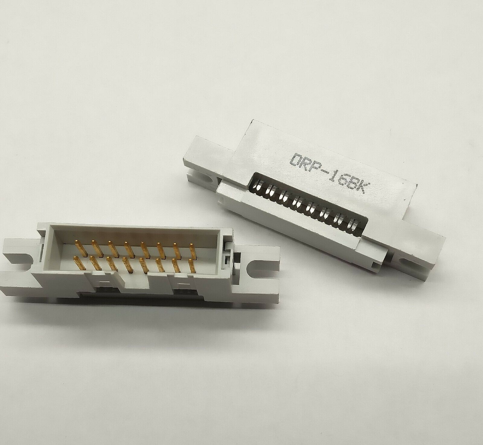

Info on those connectors?
Ok great! So mpeg 1 is the only format supported by system 7/8 - hard/software? Or is there a way to update this up to some more modern standard? Maybe borrowing a card from a powermac?🙈 (guess not)
Info on those connectors? …….
These are just male bandcable connectors with screw lugs, so you can mount a flatcable endpoint in a chassis. Very compact. I could not get the 2x4 male mount, so prob endup making one myself by modifying a male band connector with a 3D printed holder.
