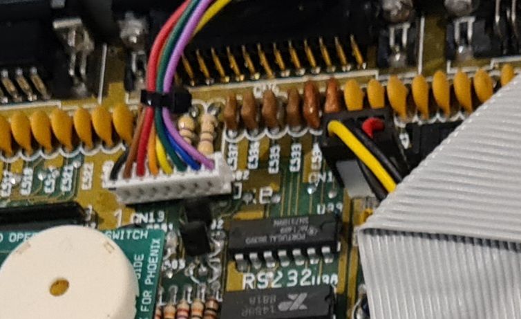

Hi there,
I'm having an issue where I connect a hitek keyboard to (any) Amiga 500 and the machine simply will not boot up. Unhook the keyboard and everything is a okay.
I'm thinking/hoping it's a short on the keyboard PCB but wondering if anyone else has had this issue? Any suggestions on the best way to diagnose the issue?
Thanks for any input
Could keyboard is connected wrong way round , or maybe the reset is being held ?
I don't believe it is the wrong way around as it is the same behavior in either orientation. The only difference I see is if the cable is in the wrong orientation the light stays on for the disk drive. Other two keyboards work on the same machine but are either missing keys or someone badly retrobrighted it and bleached the keys. Ideally I'd like to get this one working.
Could you swap the pcb and cable for one of the working ones , or are they different style/manufacturer keyboards?
Yes and it's a more desirable keyboard . I suppose you need to findout if keyboard is holding reset low or shorting 5v down maybe isolate the reset pin( or wire) and see if amiga comes up
And measure for shorts across caps , or across 5v snd ground pins

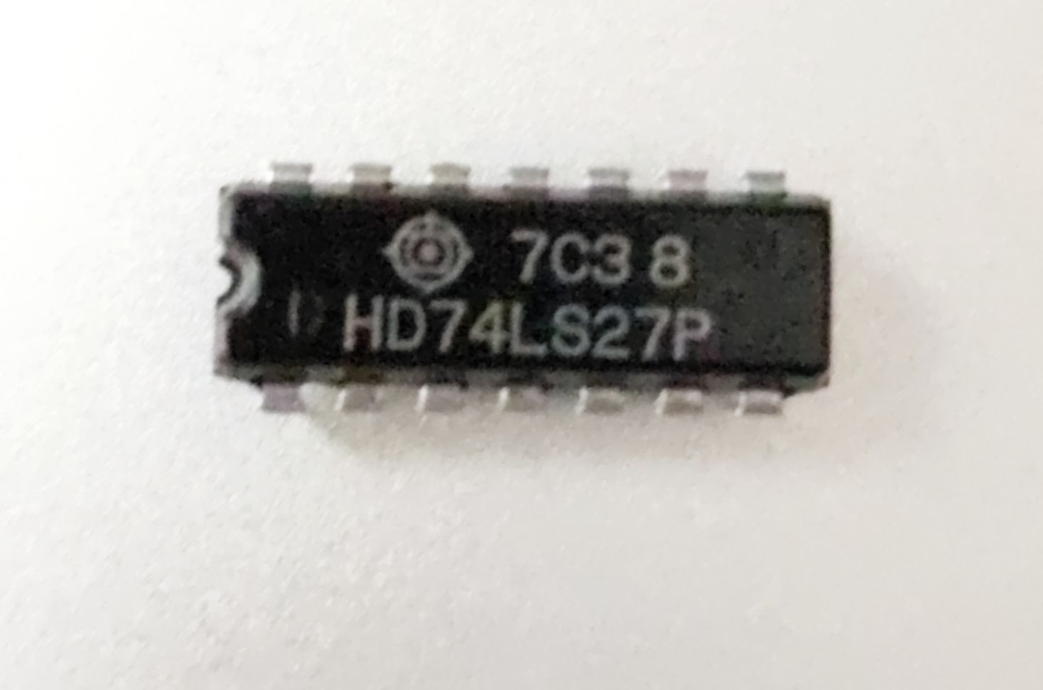

Well I'm not 100% certain but I think I may have a different issue. I went ahead and re-flowed the solder joints on the board where the capacitors are and tried plugging in the keyboard to the logic board. No difference.
I decided to pull out the multi-meter again and check all the capacitors and chips to see if any of them were going to ground that shouldn't be. When I got to U2 (see pic) I noticed it had three grounded pins. I thought it a bit suspect since the other chips only seemed to have one ground pin so I decided to pull him off the board with my desoldering gun.
When I plugged the keyboard into the Amiga with the chip removed it booted up just fine! If I put the chip back in (I put in a socket) the machine fails to boot!
So now I guess I need to source a new HD74LS27P to see if this really is the culprit. Anyone have a spare please?

Well shoot...
Put in the new chip and the machine boots up! BUT now the caps lock key light is always on and the board is completely unresponsive.
