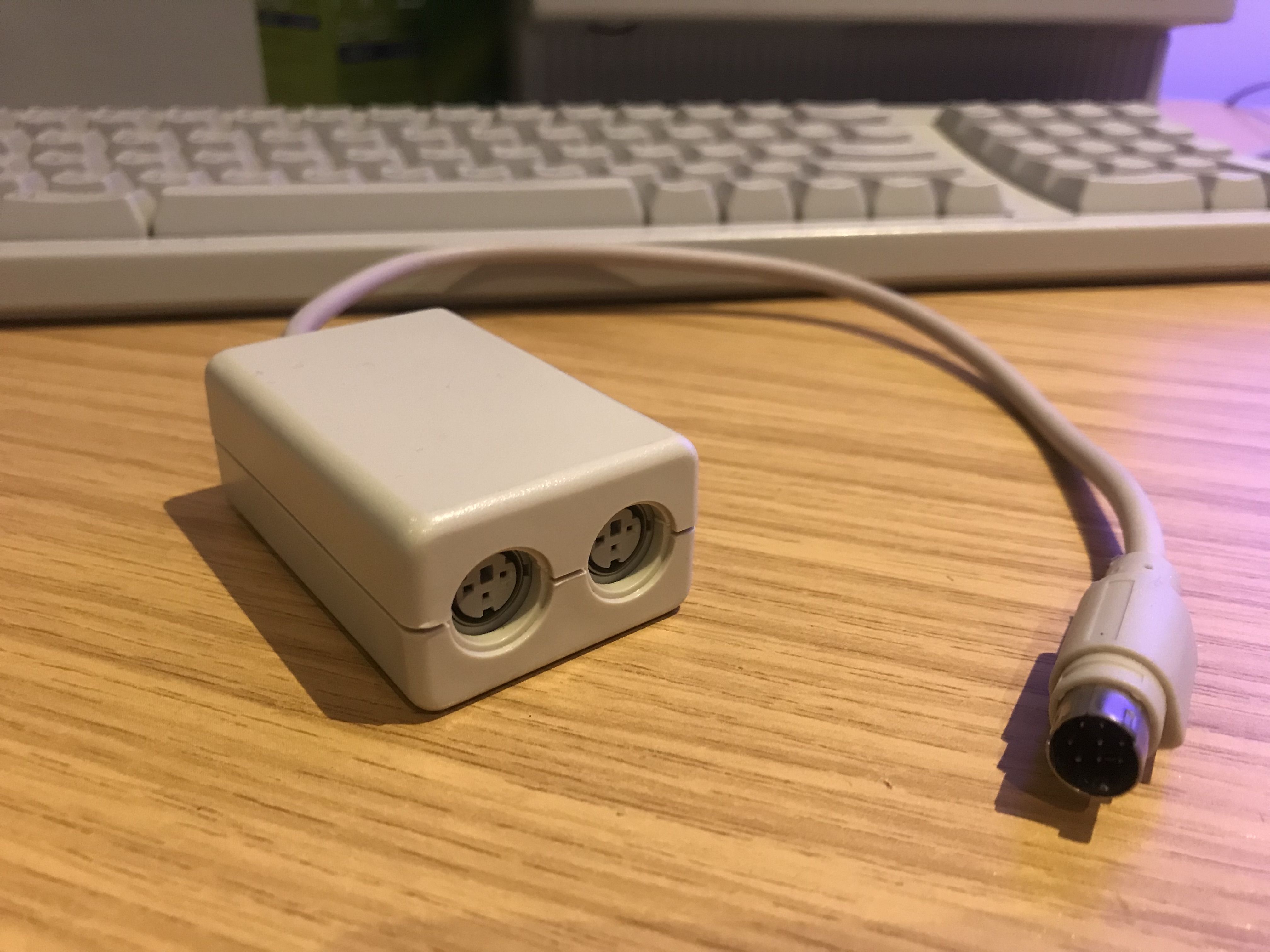

I would like to make up a LocalTalk connection cable (the one that goes between the transducer boxes with 3 pins.)

Hi Patrick, thanks for you reply and info, you are spot on. its the Apple ones IIRC $99 each originally.
Yes I watched Joes video and I pulled the parts from stock to have a go but they have just sat in the project bag since. The video sorta answered one question - if he used standard Cat5e then they are not cross over cables although to be far he does not denied nor confirm this so I am making an assumption here. What it does not answer though is which pins as obviously he has four pairs eight pins RJ45 were as I have one pair three pins MDIN.
The cables come up often on a certain auction platform in the USA but not so often in the UK and the last time I saw them the guy wanted £45 for a I think 2mtr one which is just short of what I paid for the (working) Macintosh SE FDHD.

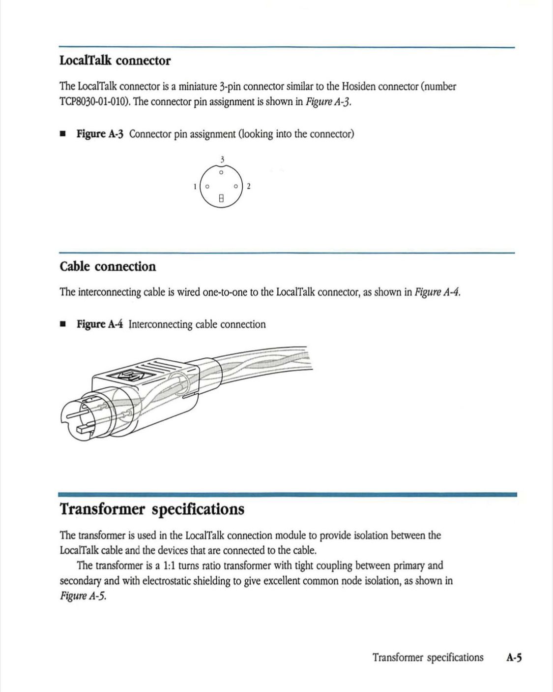

Ok i remembered that i have the 3-pin din cables for these local talk devices. using a multimeter i tested continuity.
it seems that they are straight through. The middle pin doesn't seem to be connected. so just uses the pins on either side.
Check Inside AppleTalk
Btw. you can swap pin 1 and 2.. It doesn‘t make a difference due to the encoding LocalTalk uses.

Wow Robin, Thank you so much. That covers everything I wanted to know.
I had not heard of that book nor did I find a reference when searching - Found it now though :)
Many thanks to Patrick as well for his input. - I think that closes this thread as there is the info for all to see.
