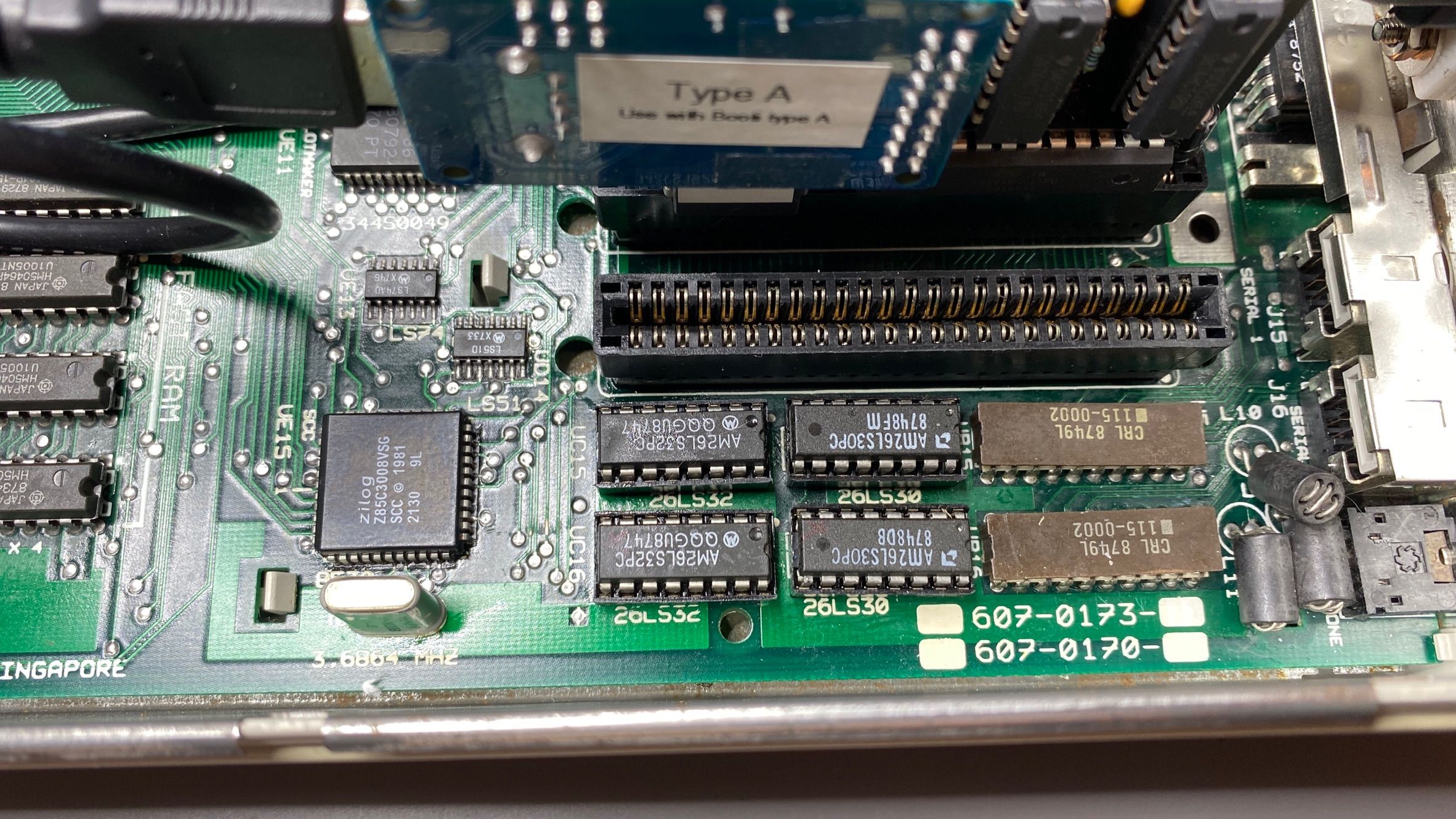

I am having issues with the serial ports on my //gs. I am getting random characters being generated somewhere on the logic board itself.
I want to find a Zilog Z8530VS SCC chip to see if this is where the issue lies. But I am having problems finding a source for this chip.
My question is does anyone know where I might source one. Be it in the form of a spares/broken logic board, a source of second hand ones, or even possibly one of the older Macs may have used the same or compatible chip hence salvage one from a spares Mac logic board.

Yep - pin compatible, the only difference is the fact the current chips are made with the CMOS process, instead of HMOS or NMOS. It's a direct replacement part.
Didn’t help. Still getting random garbage in PT3 on both printer and modem ports.
I have now replaced the both 26LS30s, both 26LS32s and the Z85C3008. And I ams still getting garbage on both ports with nothing plugged into either of them.
I have been over the board multiple times with a magnifying glass and can see nothing.
I have checked the circuit diagram and if some one can confirm what the RC4300s are I will try to source replacements for them too.
Any suggestions would be appreciated.
