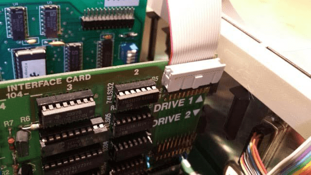

By the way, when you hook up the Floppy Emu to the regular disk drive controller card in your Apple ][+ you will need to heed this from the same instruction manual:
2.2.1 Special Note for Apple II Disk II Controller Card​
When connecting Floppy Emu to a Disk II Controller Card, be very careful to orient the cable correctly. The red stripe on the cable should be at the left, near the pins marked “1′′ and “2” on the Disk II Controller Card. An incorrectly oriented cable will damage the Floppy Emu.​

Pay careful attention to the cable orientation when connecting to a Disk II Controller Card in an Apple II computer. The Disk II connector lacks a polarity key, so it’s easy to connect the cable backwards accidentally. This can result in damage to the Emu board or your computer. In the correct orientation, the red stripe on the cable will go to the pins marked “1” and “2” on the Disk II card, as shown in the photo. The cable will be sandwiched between the connector and the board.​

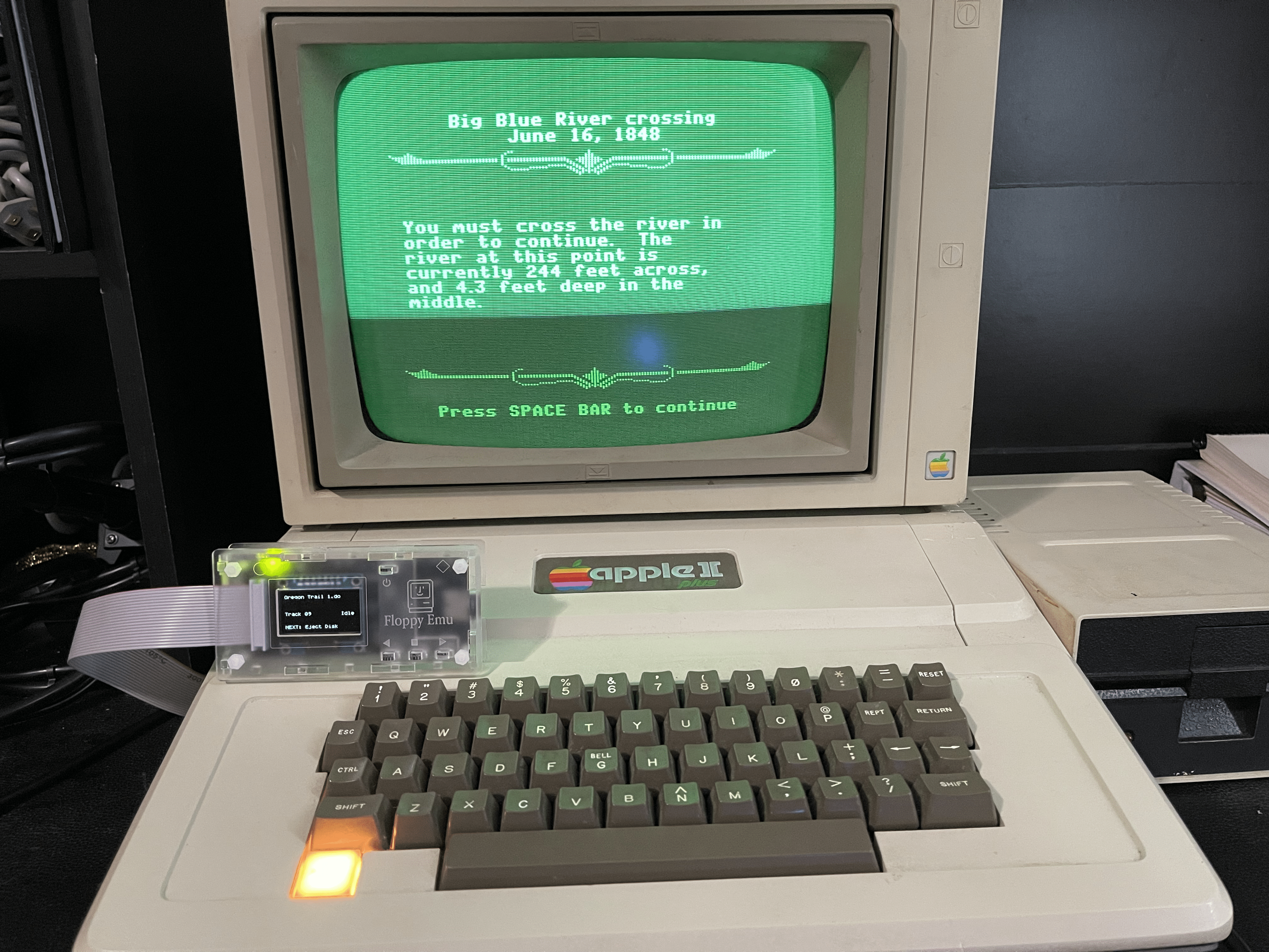

I'm gonna assume my Disk ii is haywire than. Because Floppy EMU works great, ah yes nothing like Oregon Trail.

Yay! It works using the Floppy Emu! :D👏🎉🥳
