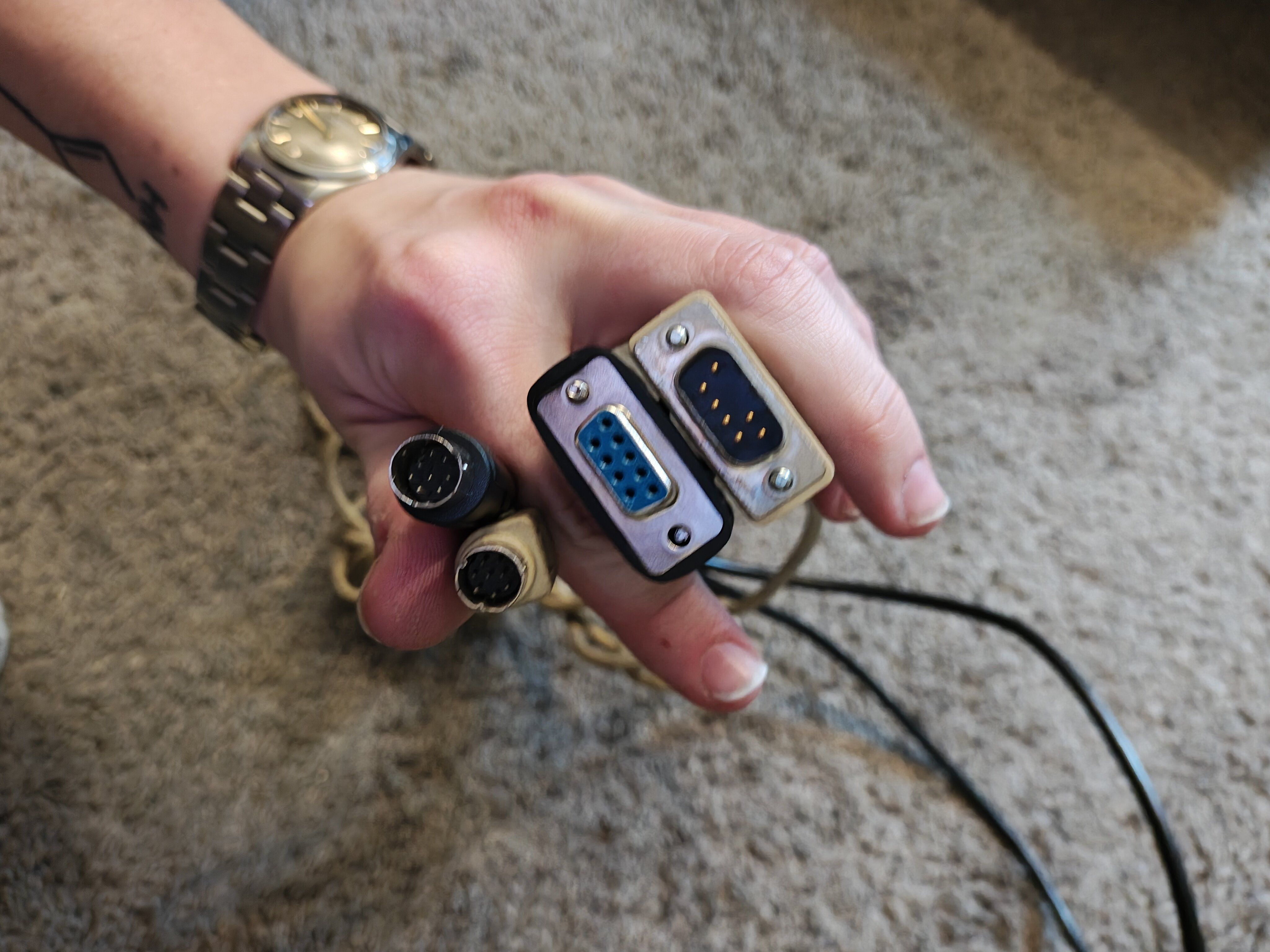

any help on how to do this would be super sick, I didn't even know OF was capable of connecting via serial like this haha!
I have these two cables, one I bought specifically for using bbs and ATDpro on my iigs, the other I'm not really sure where I got it, old apple one with just an apple logo on one side, have two different usb to serial cables, tried for hours last night to get it to work with no success....any help is super appreciated!

Try the "Connecting to Open Firmware" section here:
https://forums.macrumors.com/thread...tosh-g3.2303689/#-connecting-to-open-firmware
Connect to modem port.
In Open Firmware use this command to redirect input/output to modem port at 57600 bps:
Code:
" ttya:57600" io
To make the change permanent, you can use these commands to set NVRAM. The settings will take effect after restart:
Code:
setenv input-device ttya:57600
setenv output-device ttya:57600
Use a terminal app with XModem or VT100 emulation.
Increase the scroll back buffer to maximum so you can capture results of commands that output many lines of text.
Set the text pacing delay so that you can paste lines of text without Open Firmware missing any characters.
Text pasted into the dl command doesn't require a text pacing delay. Text pasted to the normal Open Firmware prompt does require a text pacing delay for strings longer than 14 characters or so.
Reactions: Mr. Macintosh
The ADTpro cable should work. What did you set your Open Firmware variables to? Remember that port 2 is ttya, not port 1.
success.
im 99.999% sure port 2 being being ttya is what was messing with me, why the hell apple???

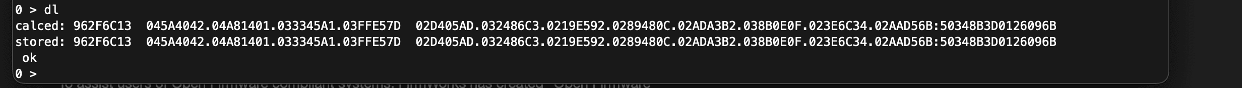

here is the data!
Code:
0 > dl
calced: 962F6C13  045A4042.04A81401.033345A1.03FFE57D  02D405AD.032486C3.0219E592.0289480C.02ADA3B2.038B0E0F.023E6C34.02AAD56B:50348B3D0126096B
stored: 962F6C13  045A4042.04A81401.033345A1.03FFE57D  02D405AD.032486C3.0219E592.0289480C.02ADA3B2.038B0E0F.023E6C34.02AAD56B:50348B3D0126096B
 ok

here is the data!
Thanks for checking. That exactly matches the info for the 2.26NT ROM which we already have.
Code:
077d.28f2.1  962f6c13  045a4042.04a81401.033345a1.03ffe57d  02cdecec.031ec3af.0213d883.02837b28.02a7be75.03853500.023892c2.02a52e8a:c60da96de537f08a  23a7bbda5681be978972517d4758bbdd  "1.1.20.1"
077d.28f2.1  962f6c13  045a4042.04a81401.033345a1.03ffe57d  02cdf1e7.031ed7ca.0213f083.0283859e.02a7b7cc.0385549f.02388b9d.02a4ffaa:d540b3dd5bcf9caa  676809c236138574282fa8416c6c5a6d  "1.1.22"
077d.28f2.1  962f6c13  045a4042.04a81401.033345a1.03ffe57d  02d405ad.032486c3.0219e592.0289480c.02ada3b2.038b0e0f.023e6c34.02aad56b:50348b3d0126096b  ad405e01c663340c479668c70f741f1b  "2.26NT"
077d.28f2.1  9630c68b  045a3ff2.04a8169b.03334745.03ffe575  02d3e2e8.0324a294.0219ffa8.02895fd8.02ada29f.038afd23.023e4a4a.02aac18a:a71fb907dd180b8a  d1d3720c38143eb2bac86b8393318529  "2.26B6"
077d.7dd0.1  49b2be8f  044701df.046e7c5d.02fa6527.03dc24a2  02c4eb7f.0302e5d4.01f7e0a8.0273a3f7.029f509f.0368984a.021b27e4.0295cecb:5f2aeeb25507b2cb  83be626679b5c74a606cd31443063a53  "2.0"

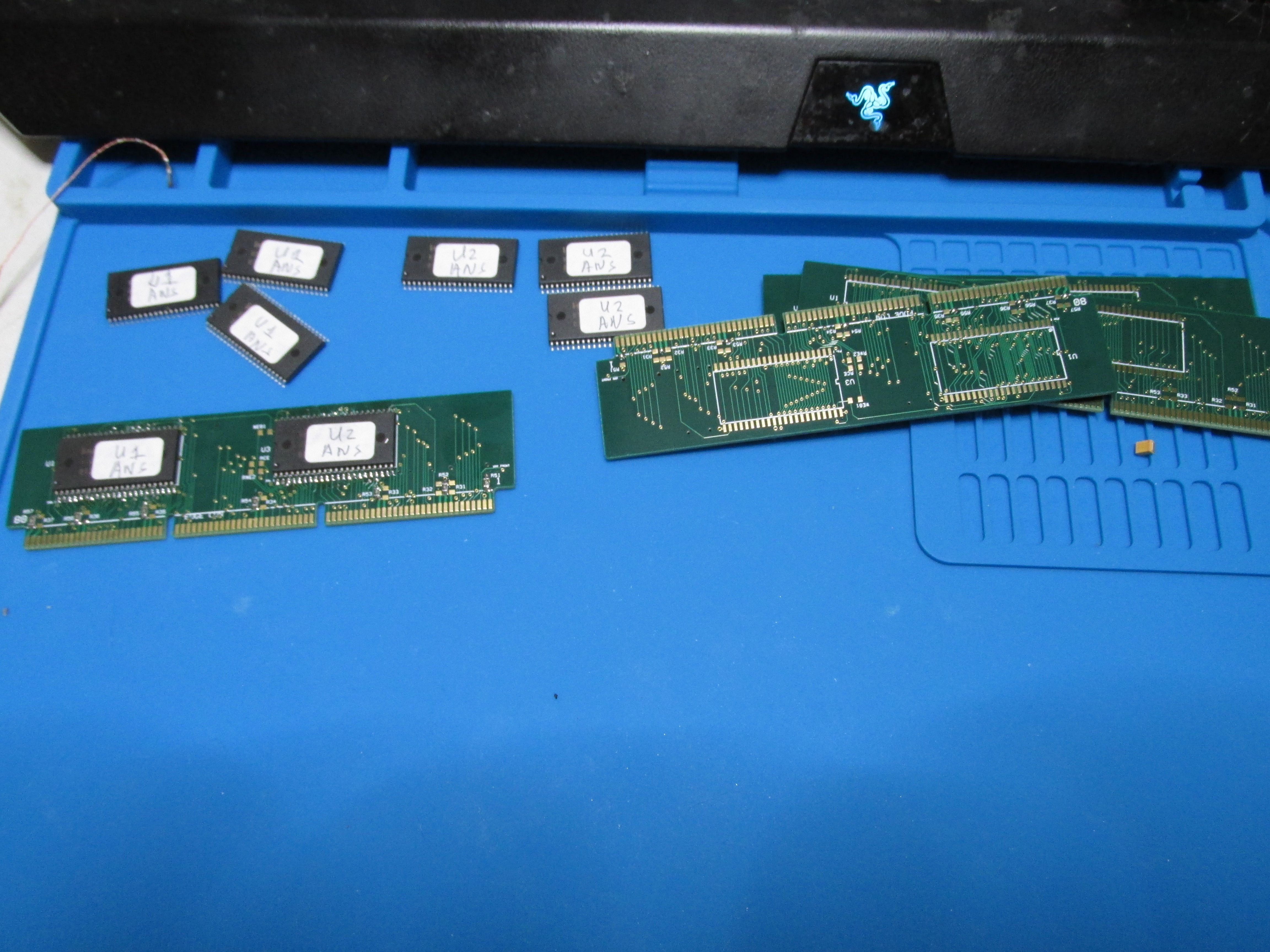

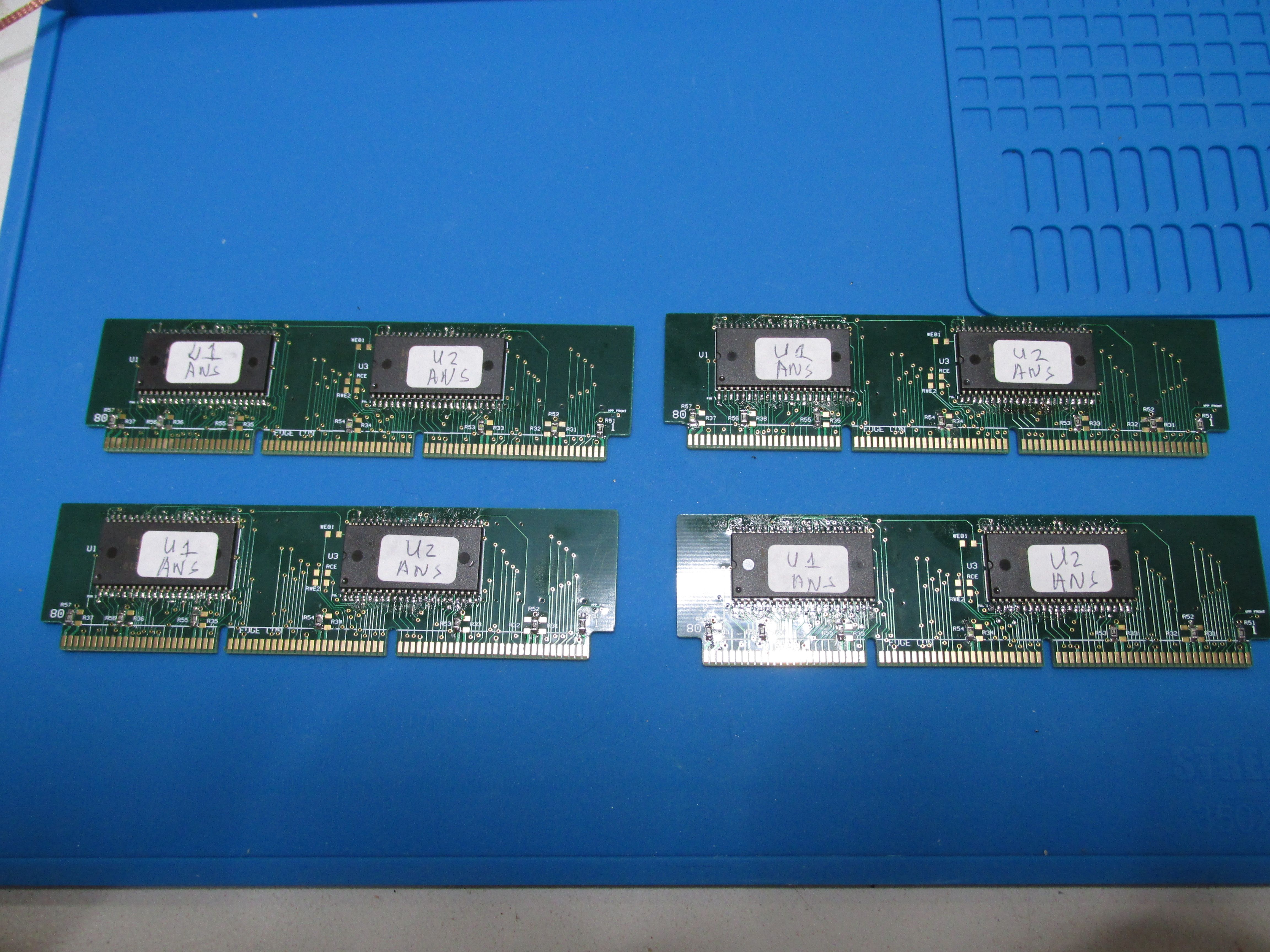

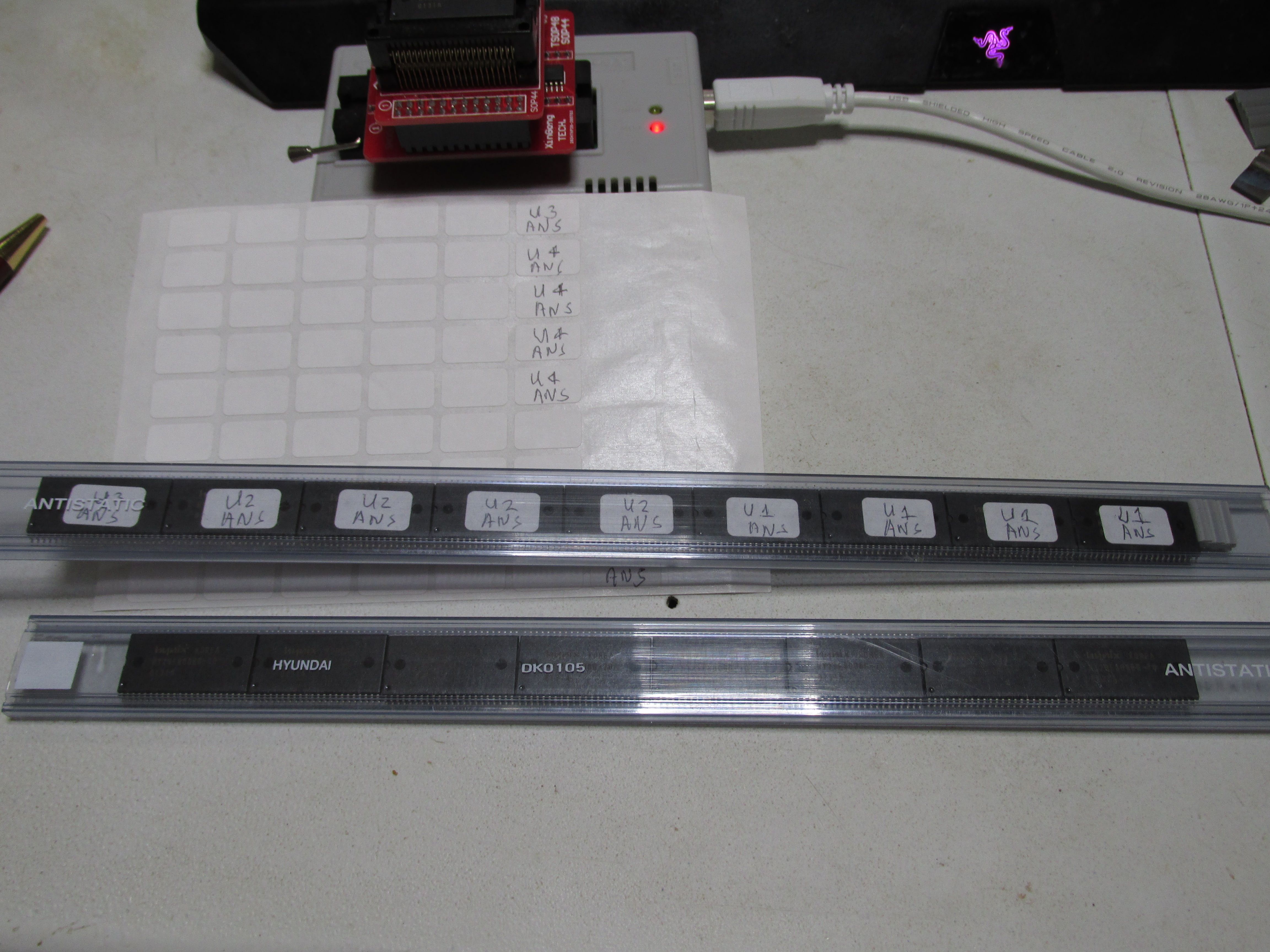

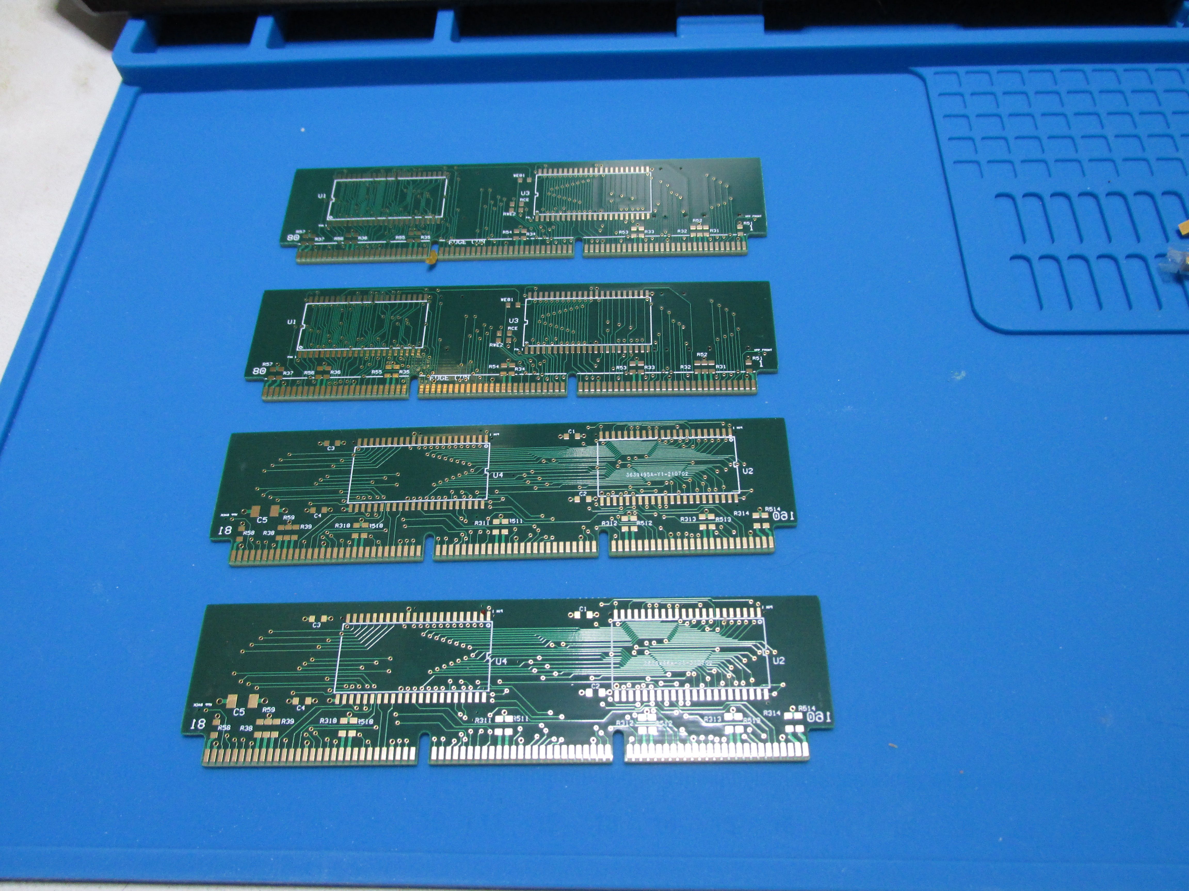

I used kansas_deinterleave to deinterleave all the ROMs. I think most people just want ANS 2.0.
Checking: You left the extracts in the order that kansas_deinterleave produced? In other words, U1 = U1, U2 =U2, U3=U3 and U4 = U4?
I must swap U2 and U3 (artifact of labeling on circuit board) and I want to confirm that you did not pre-swap them.
It seems unlikely, but a careful reading of the PEx thread might have prompted you to do so.

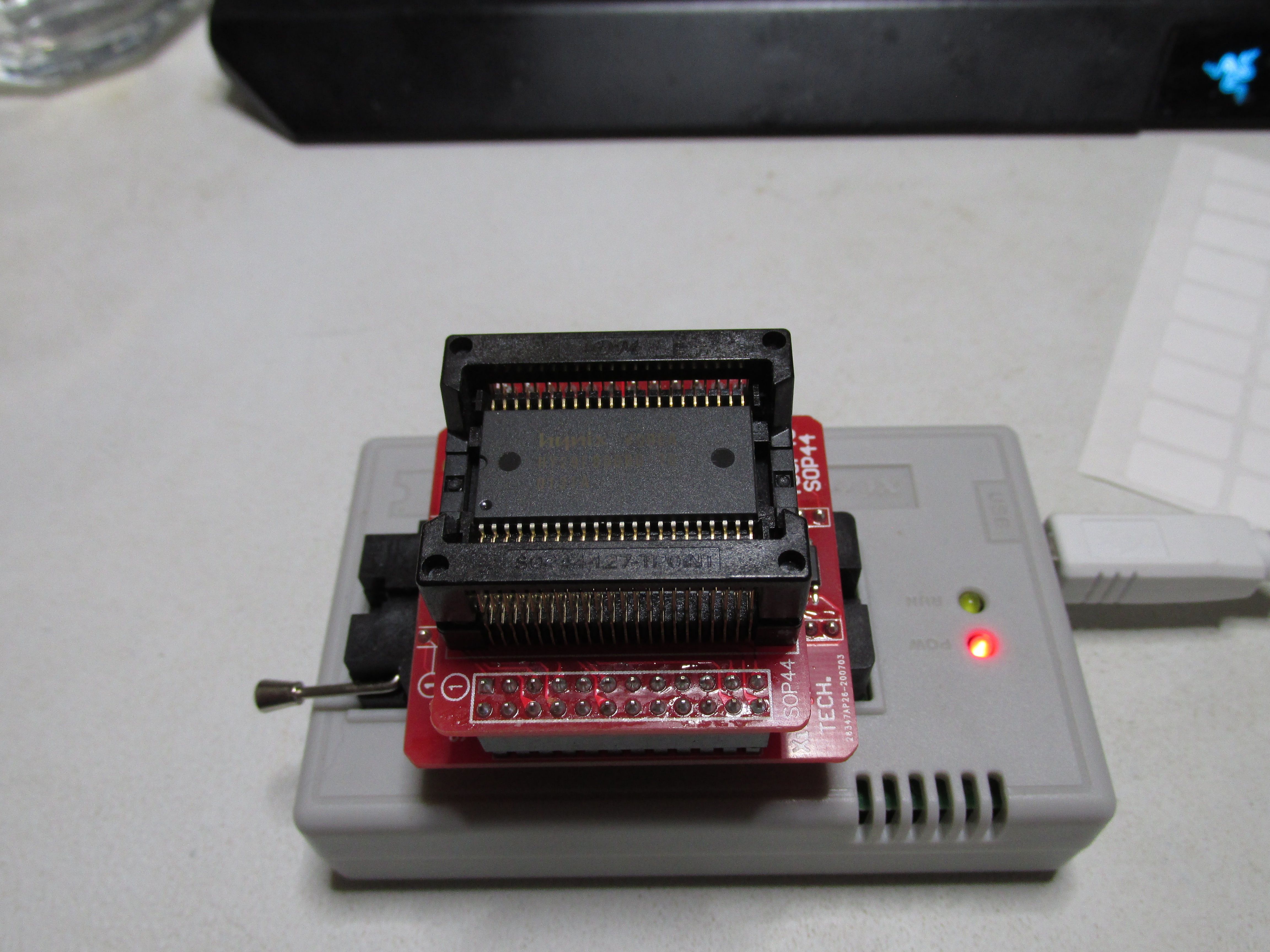

Ready to program chips...
I did not do any reordering. kansas_deinterleave processes 8 bytes at a time. 4 pairs of bytes. Each pair of bytes is swapped. The first pair is output to U1. The second pair is output to U2, the third pair is output to U3, the fourth pair is output to U4. If this is not correct, then kansas_deinterleave needs to be modified. Compare the bytes in each file with the original ROM to be sure.
Thank you. That's what I needed to know. The need for swapping order/label is not an error, so much as an artifact of historical labeling.
There's probably something that needs to be changed to make it more sensible, but I'm not sure what at this point.
Ah, here's what happened. My original assumptions about data bit order were wrong:
And I learned that I have the chip ordering of U1, U2, U3, U4 wrong with respect to the ordering of the data bus. I know how that happened. I used a Beige G3 ROM with just two 32 bit wide chips on it to determine the data order. One of the chips was labeled High and one was labeled Low, and I assumed that referred to the most significant double-bytes, but it apparently referred to the least significant double-bytes.
So instead of Low containing 1 - 32, it contained 1 - 16 and 33 - 48. While High contains 17 - 32 and 49 - 64, where I thought it contained 33 - 64.
This caused me to mis-order the four chips on the conventional ROM.
Although that still leaves U4 at the lowest bit address, yet the data coming out of the ROM dump goes to U1 first. Anyway, doesn't matter at the moment for practical purposes.
