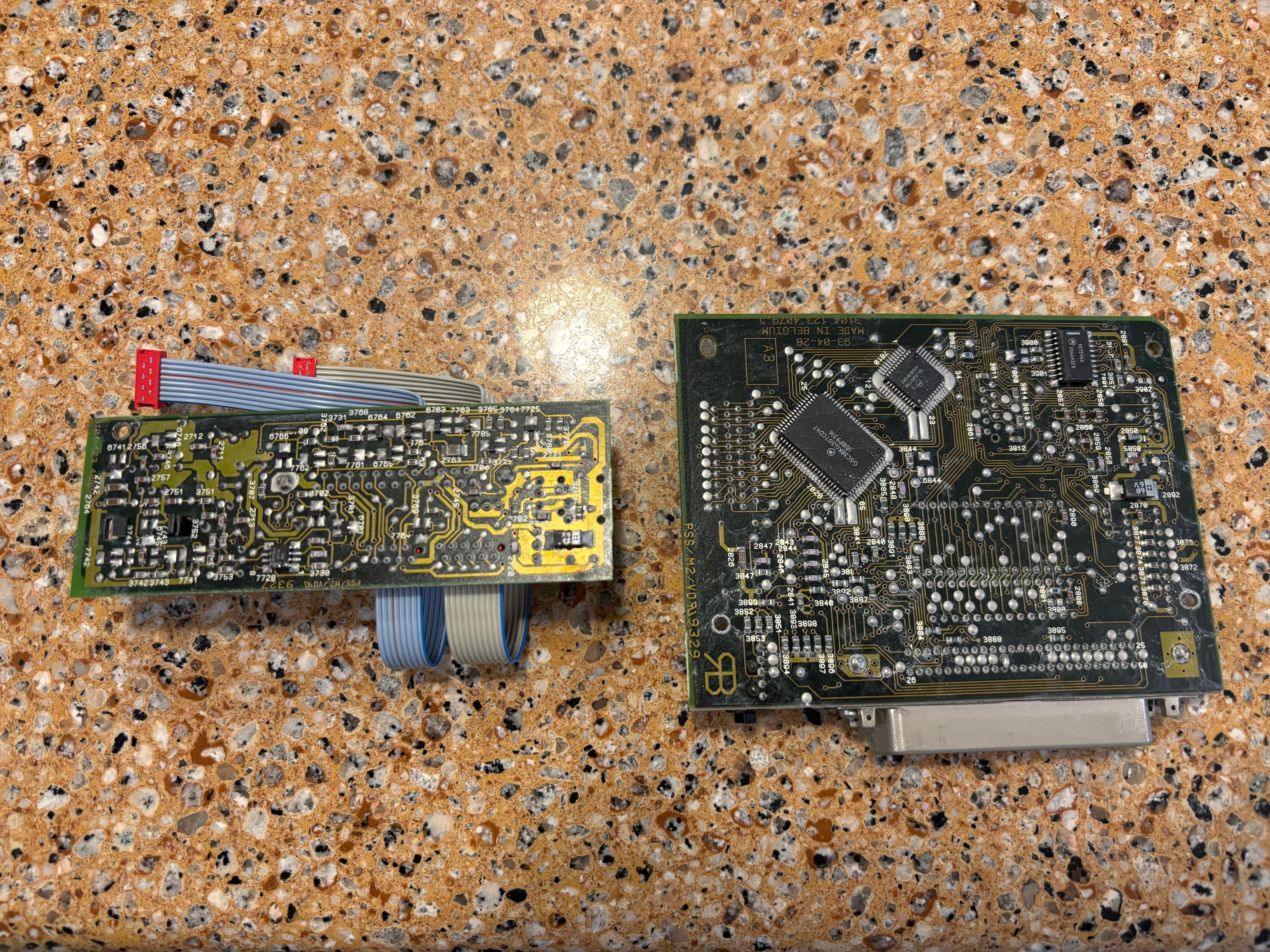

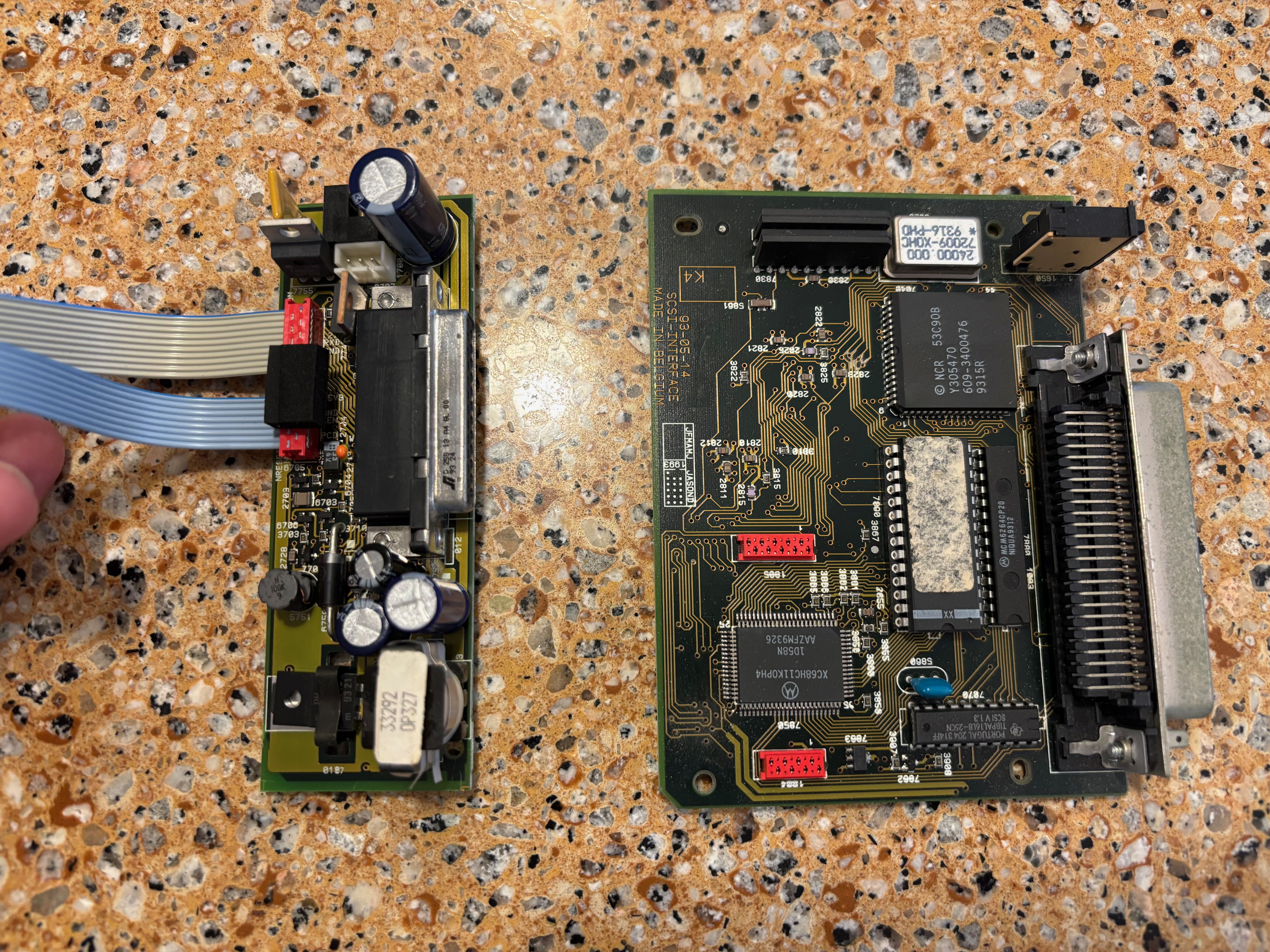

I know this is an obscure piece of Apple hardware, but I think they're neat because the color matches the old PowerBooks. I have two of these - one working and one not. Because I couldn't find any photos of the base online, I disassembled my defective unit to take a look around. For what it does, this a complex piece of hardware. I think the larger board is the SCSI controller board, and guessing the smaller top board is for power delivery/interfacing with the drive itself. I was hoping the fix for me would be leaky electrolytic caps, but all I see are through-hole parts which aren't leaking. When connected to a working drive, the orange LCD lights up, but a disc will never spin, and nothing else ever displays on the screen.
Anyone else been inside one of these wacky things?
Just because they aren’t leaking doesn’t mean they’re in spec. Do you have access to an ESR meter to test them?
What about that cap that looks like a SMD part on the power board. Is that really a tantalum or is it one of those sneaky electrolytics like those used in the newton?
Other than caps, you could check the diodes and transistors on that board to rule out more easy to test stuff.
The PowerCD is just a modified version of the Philips CDF-100. The Philips unit played CDs and Photo CDs, but didn't support SCSI. An educated guess: Based on what I'm seeing on those PCBs, they're getting the raw data from the laser assembly and doing all the "processing" (the larger board has a familiar NCR SCSI chip), so the Photo CD and audio playback smarts are likely in the drive unit itself. I wouldn't be surprised if you stuck a CDF-100 drive on a PowerCD base and the SCSI interface worked.
I've seen/had several PowerCDs over the years, and they've all had issues with the drive mechanisms in one way or another. I don't think issues with the electronics in the base are very common.
I've seen pictures of the Philips CDF-100 where it looks like the connector used between the drive and base appears to be a DB-9 connector unlike the DB-25 of the the PowerCD so unfortunately I don't think that would work (at least physically).
