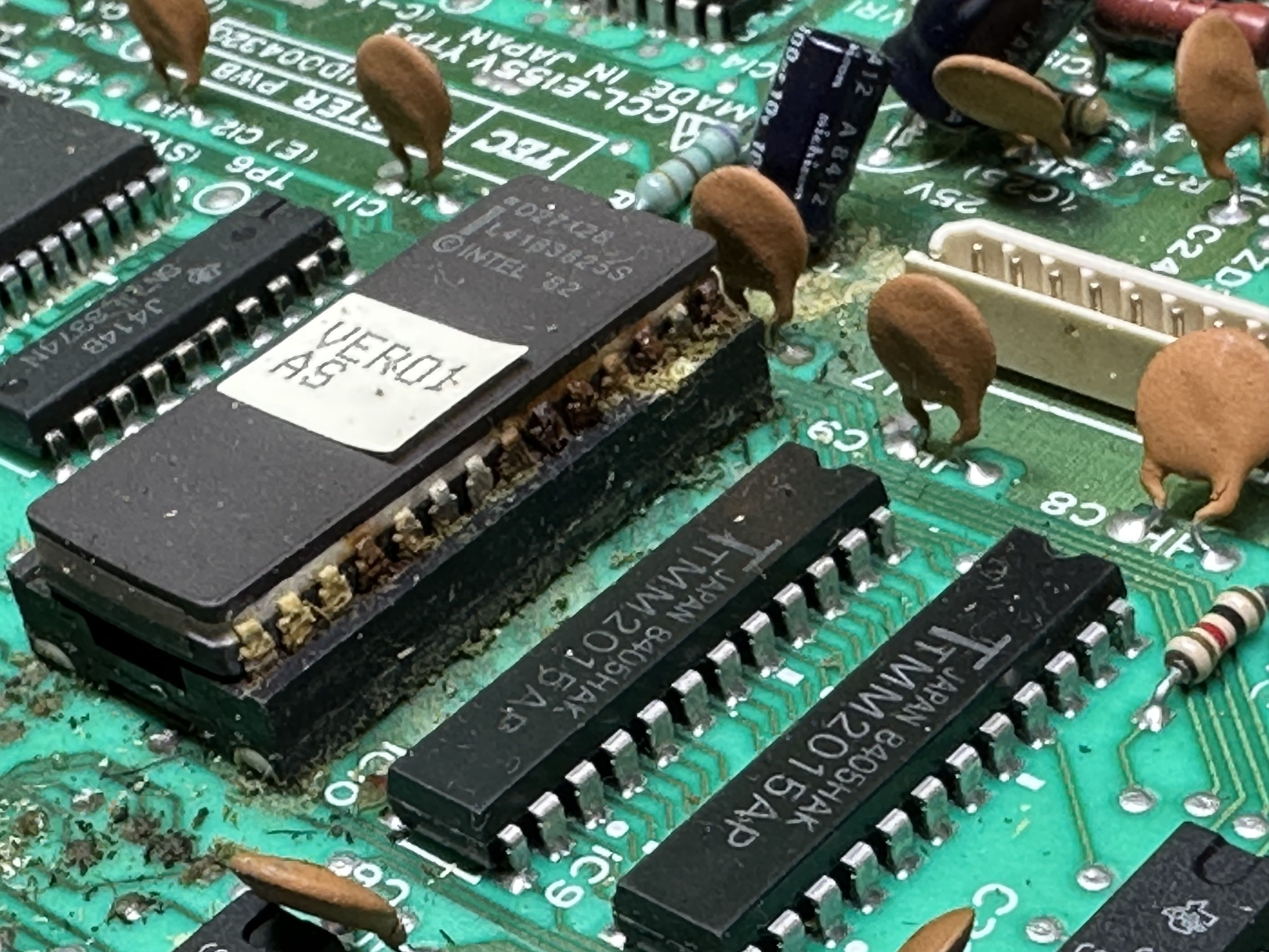

I've had an Apple Thermal Transfer printer on the shelf waiting for repair for a while and decided to dive into it.

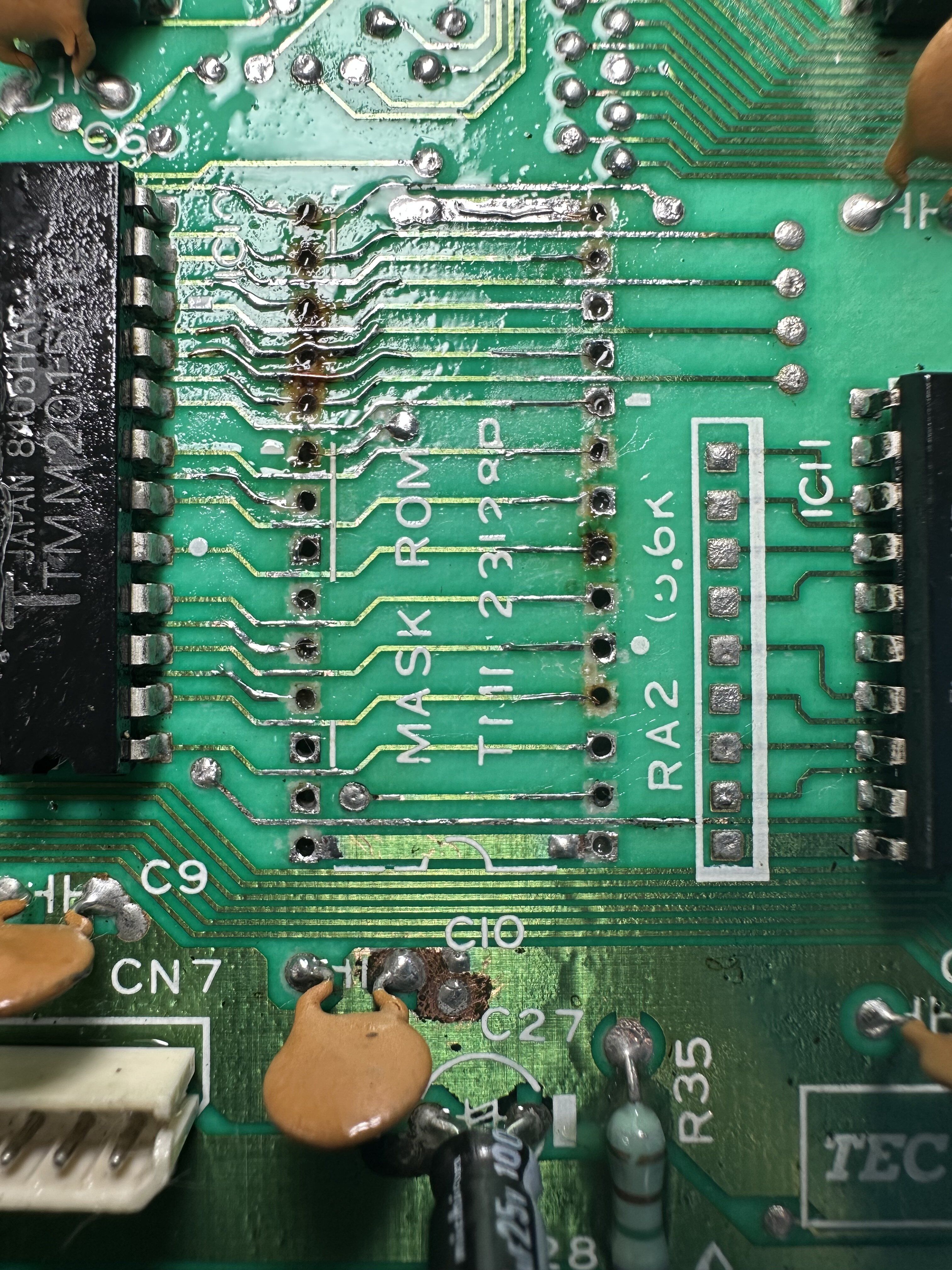

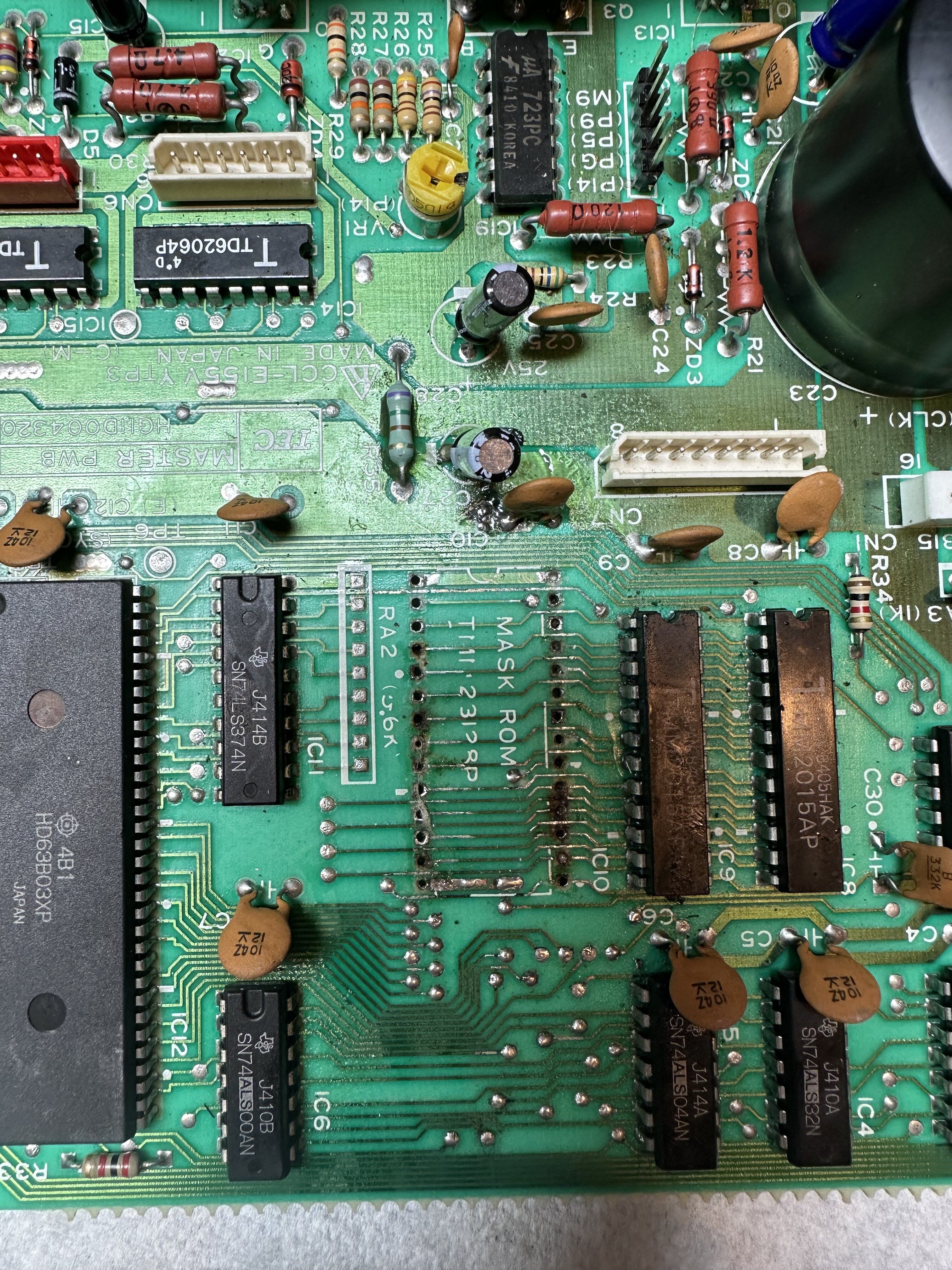

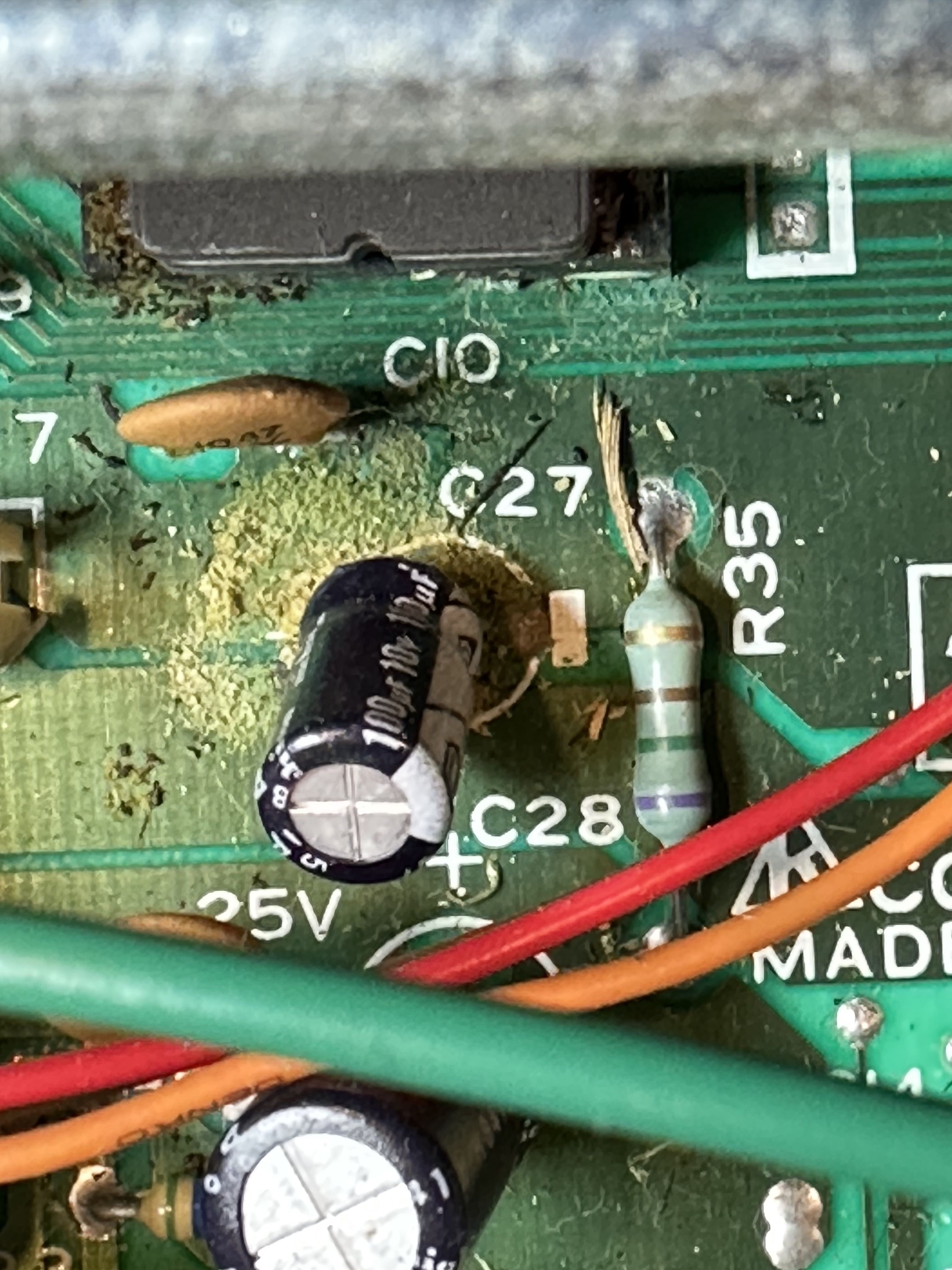

It powered up but then something started smoking. Uhoh! It looks like at least one electrolytic capacitor (C27) severely leaked and may have damaged a nearby ROM.

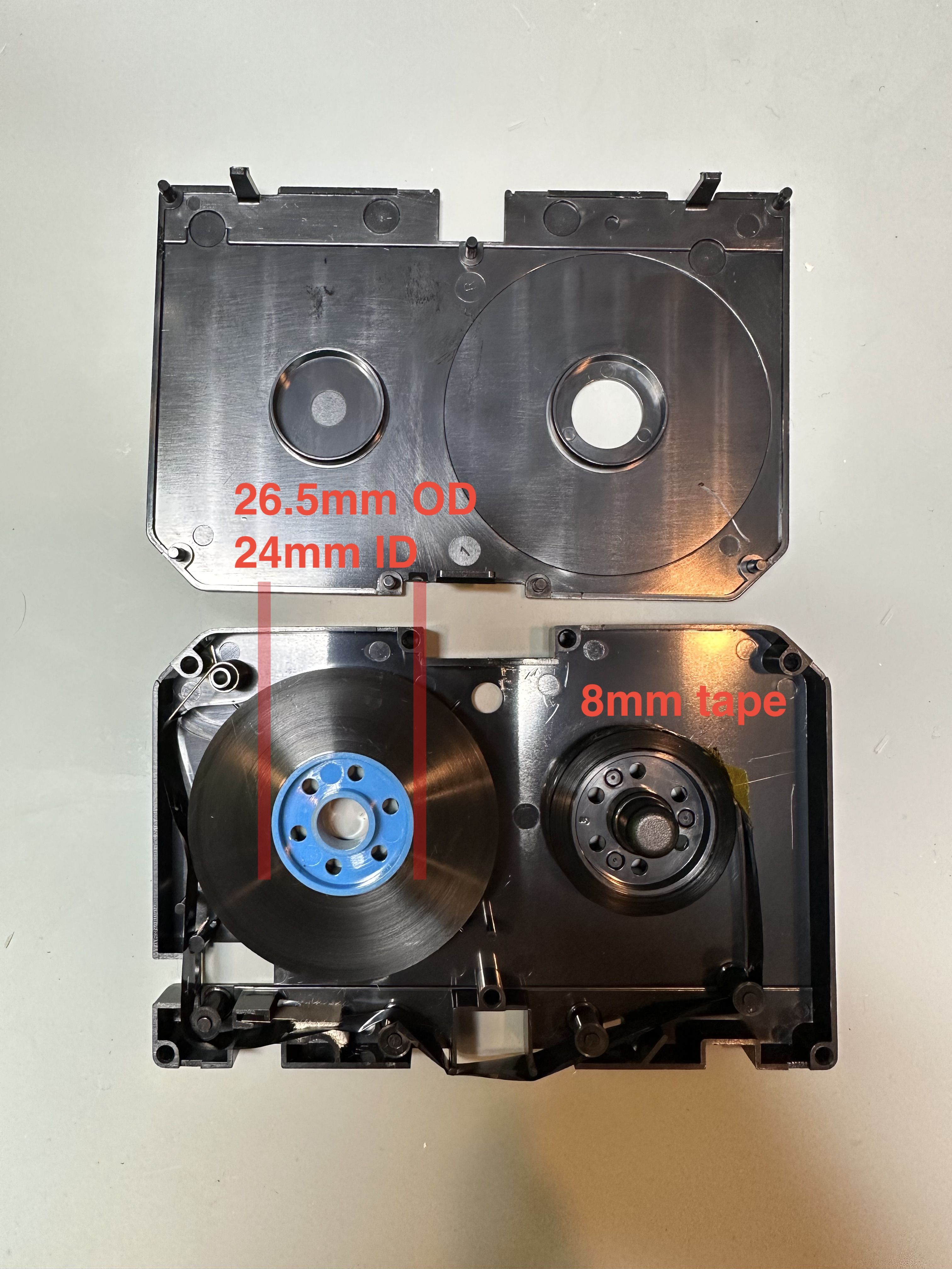

Before digging in too far I pulled out the thermal transfer cartridge to see if it'd be replaceable. It looks proprietary on the outside, but is pretty simple inside. It uses 8mm wide thermal transfer tape. The spindles rest in openings in the enclosure. Those spindles are about 26.5mm OD and 24mm ID. I wasn't able to find similar tape online. If anyone who reads this knows of a source, please post a reply.

Well, this isn't good. It looks like the cap managed to leak all over the ROM. I managed to get it out of the socket while only breaking two pins. I'm hoping it'll work well enough to dump. Fortunately replacements are cheap.

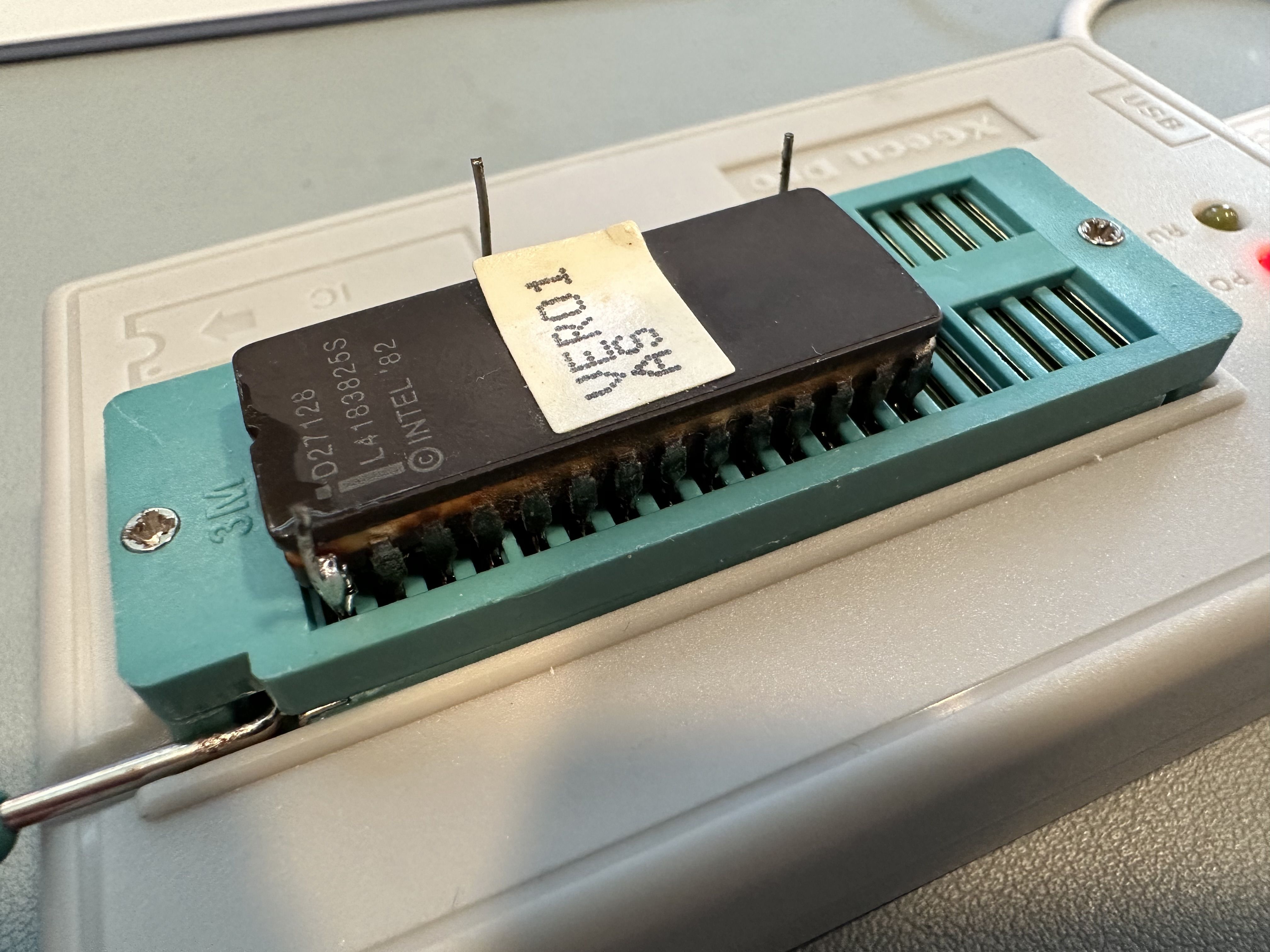

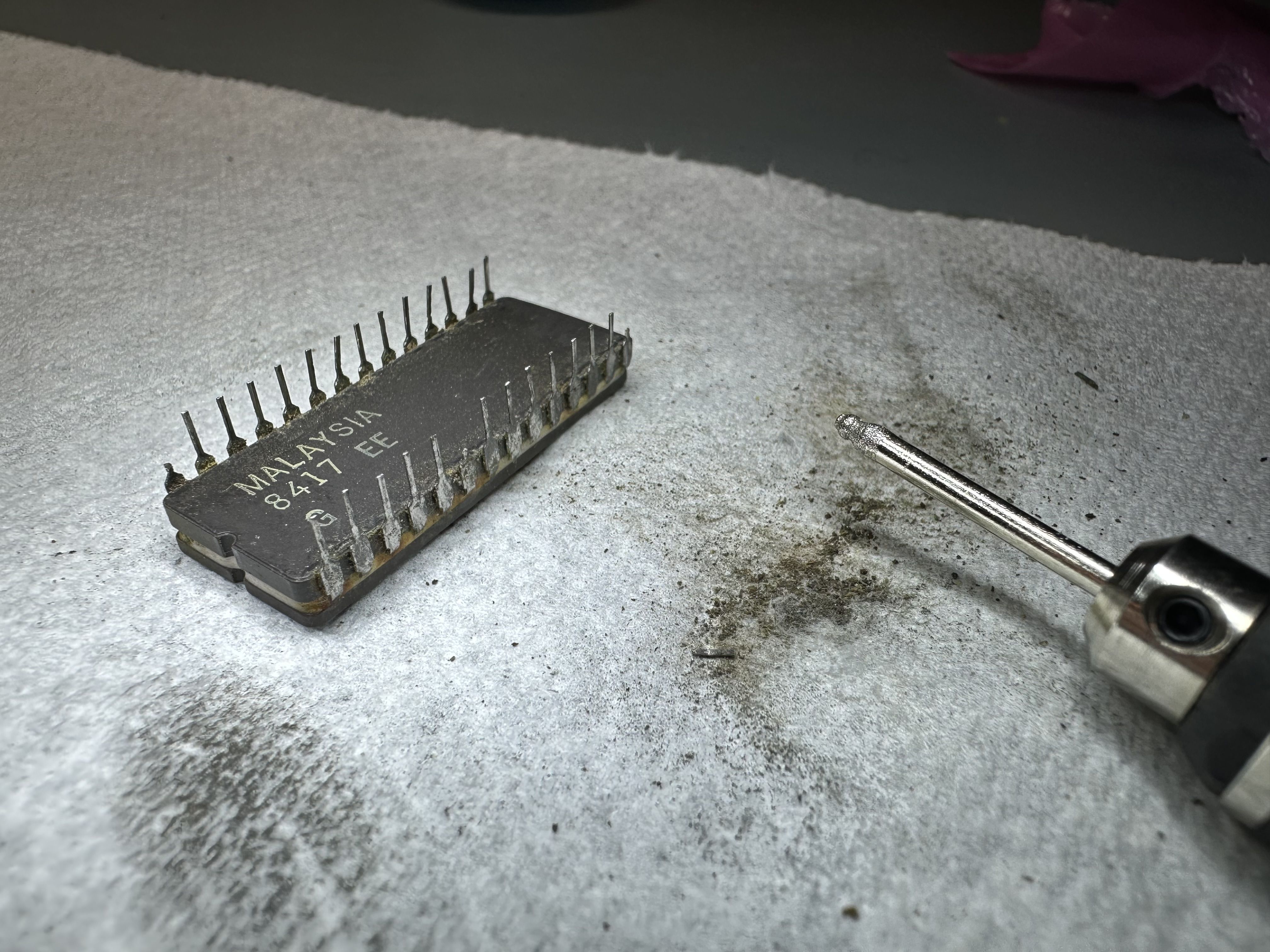

There was a lot of crust on the ROM pins! I used a USB rotary tool to scrape away the crud down to the shiny metal. A couple more pins broke off in the process. I soldered some leads on and by some miracle was able to get it to dump. the ROM dump is attached here, but not sure yet if it can be trusted. I've ordered a replacement EPROM so it'll be some time before I know for sure. In the mean time I'll replace the ROM socket and electrolytic caps on the board.

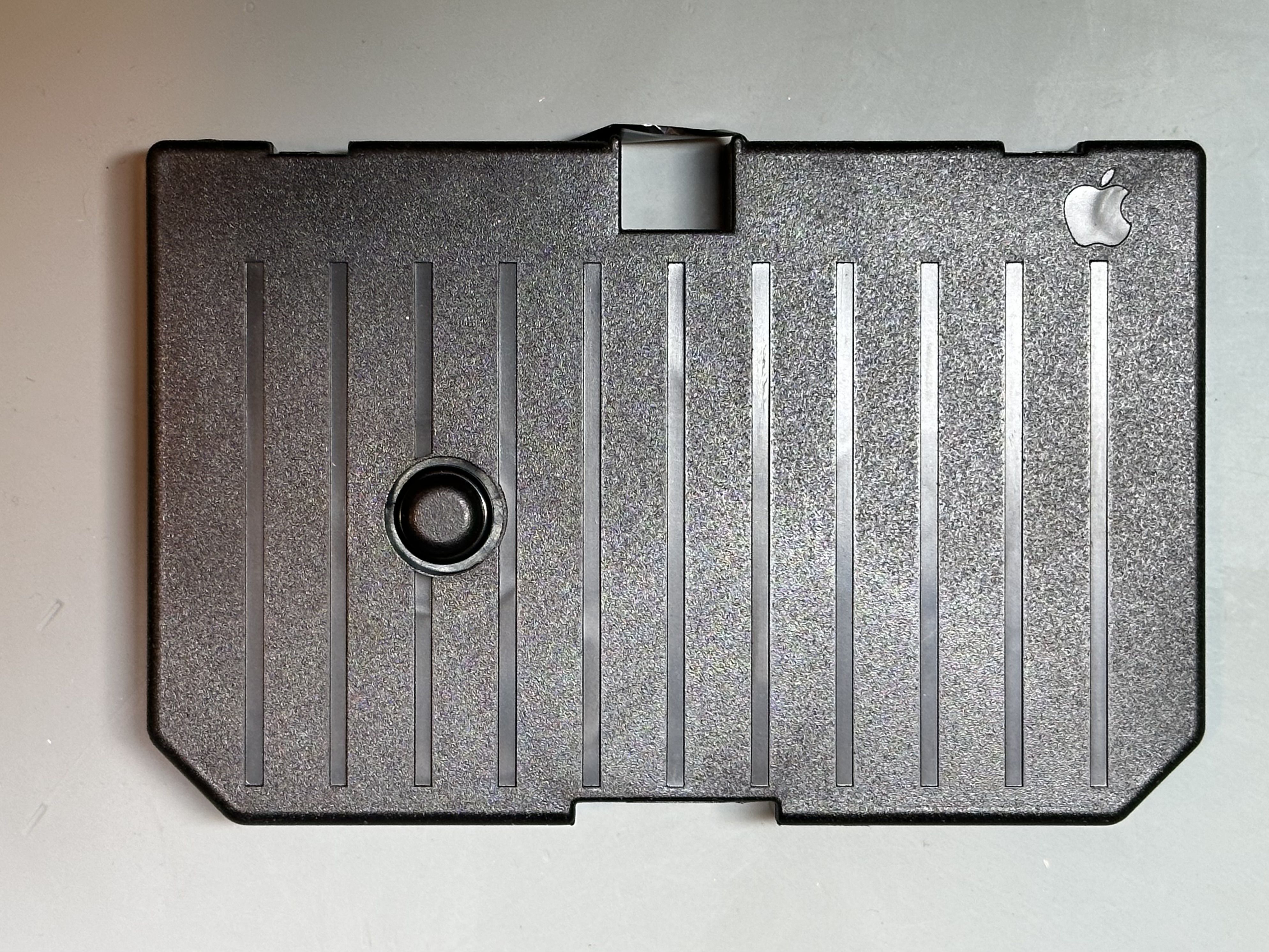

@Elemenoh, can you take picture of the cartridge holder assembly for the Apple Scribe thermal printer? I am trying to see about compatible ribbon cartridges. Sometimes some things are still used today after 30-40 years, usually in an industrial setting.
For example, certain Canon ink cartridges work with the Apple StyleWriter printers.
I see the picture of the ribbon cartridge, but I am wondering about any specific markings in numbers or words on it?

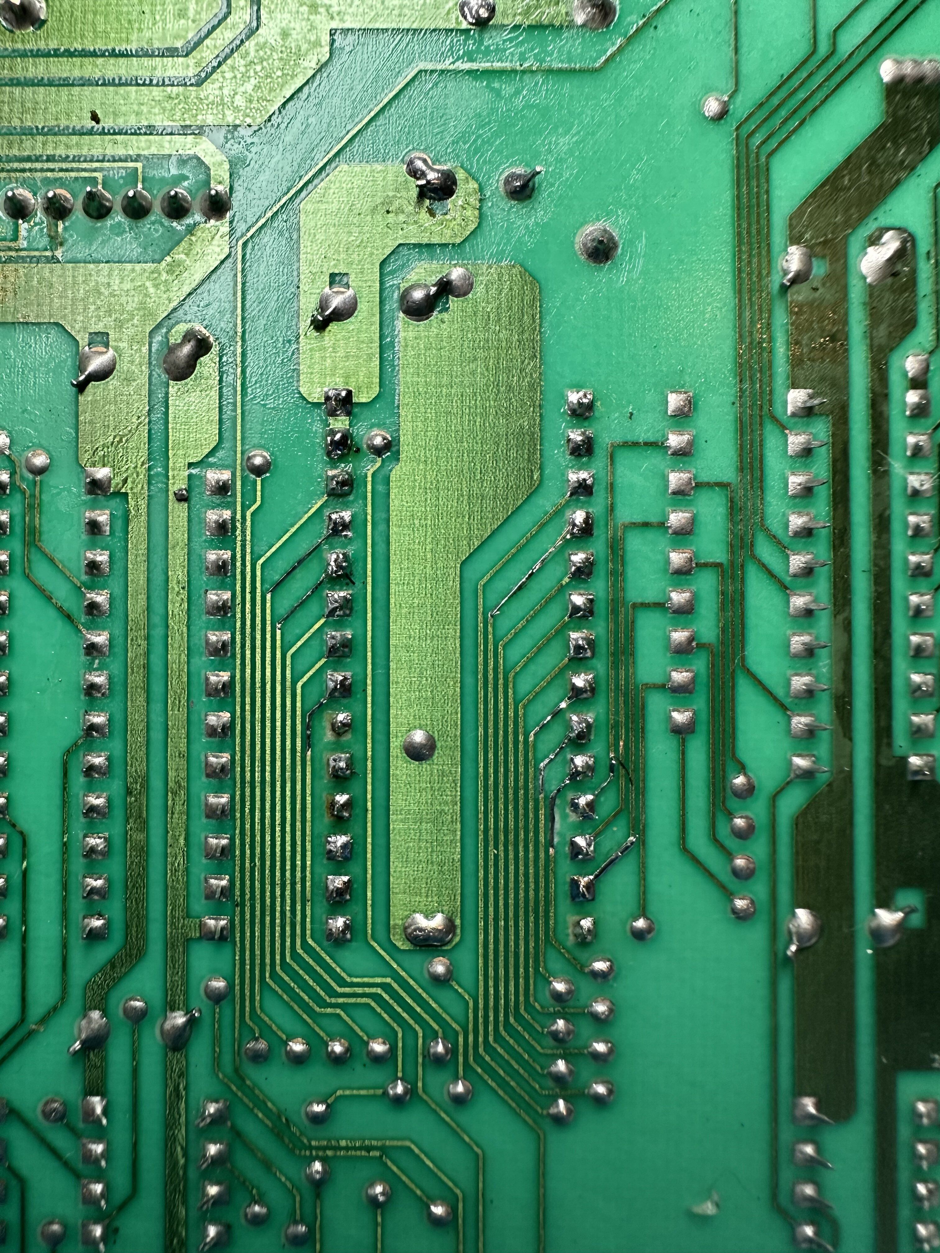

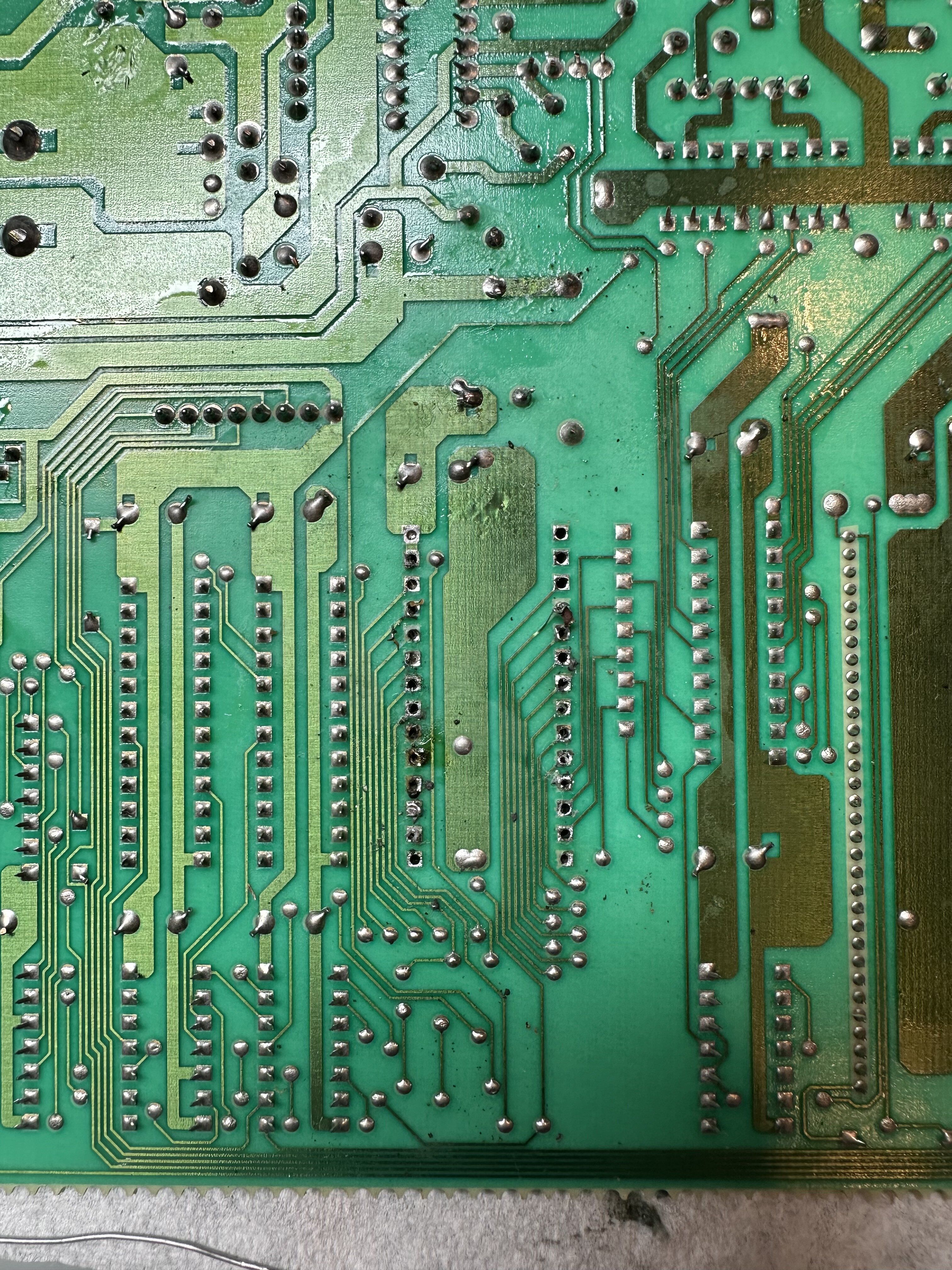

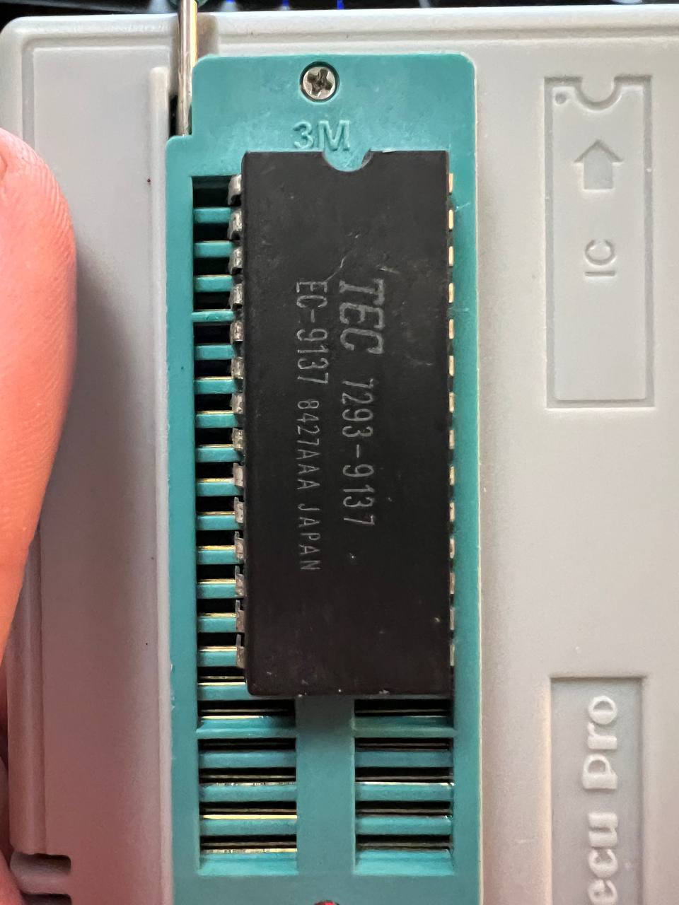

The 28-pin ROM needed 33 trace repairs. All but two needed 40 AWG wire to make space for the socket pins. It was fiddly work but kind of fun to do. I got the replacement ROM and ROM eraser. The eraser I ordered has a euro plug which is weird. It came via Amazon next day delivery. Why would they have those in the US? Anyway, I need to change out that plug, erase and program the chip before the printer is ready for testing again.
I programmed a ROM, popped it in and put everything back together. It didn't blow up which is nice, but the head is just clicking and lights are flashing on and off. Anyone know what this means? I'm still suspicious that the ROM dump may be corrupt.
