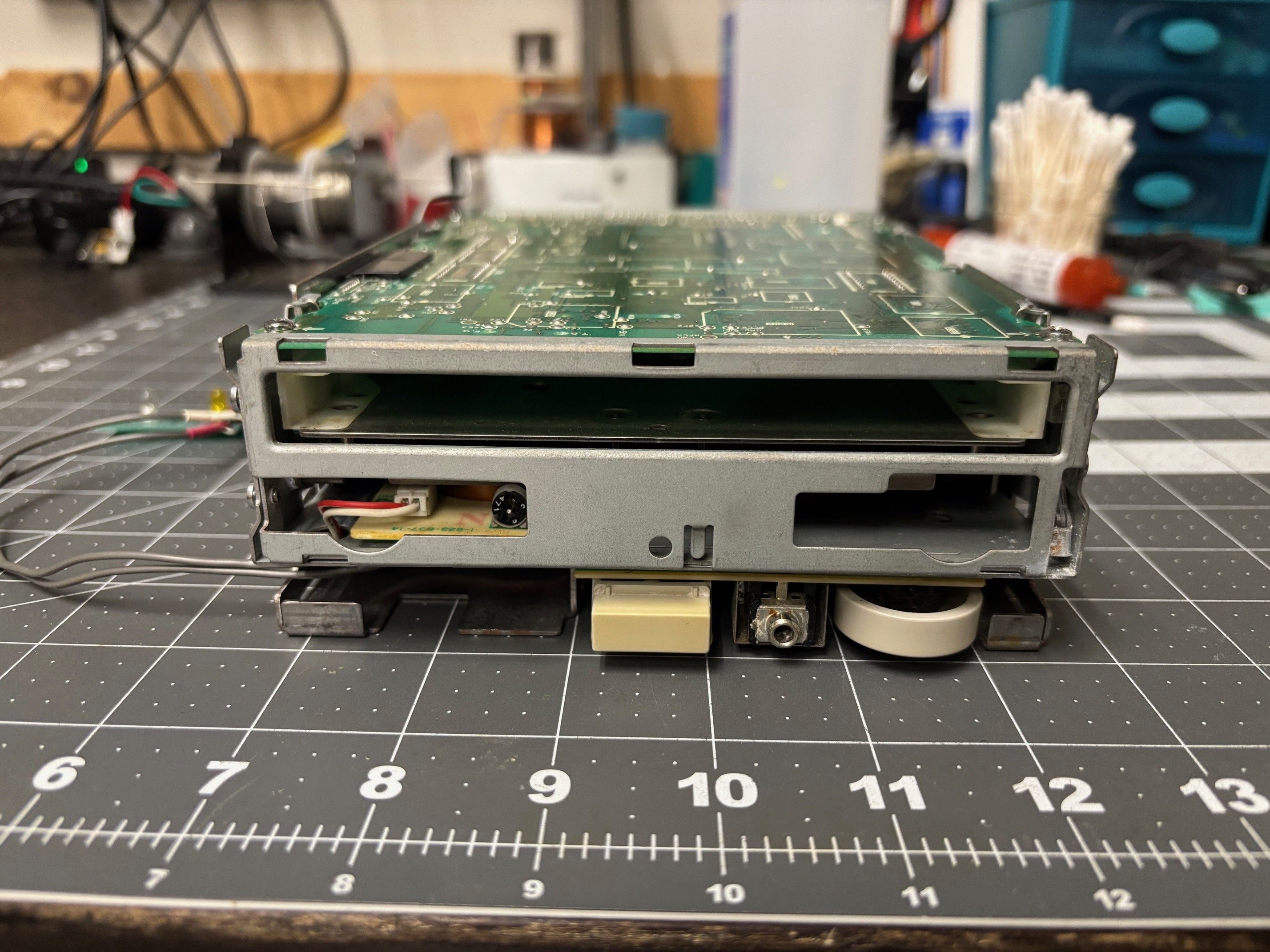

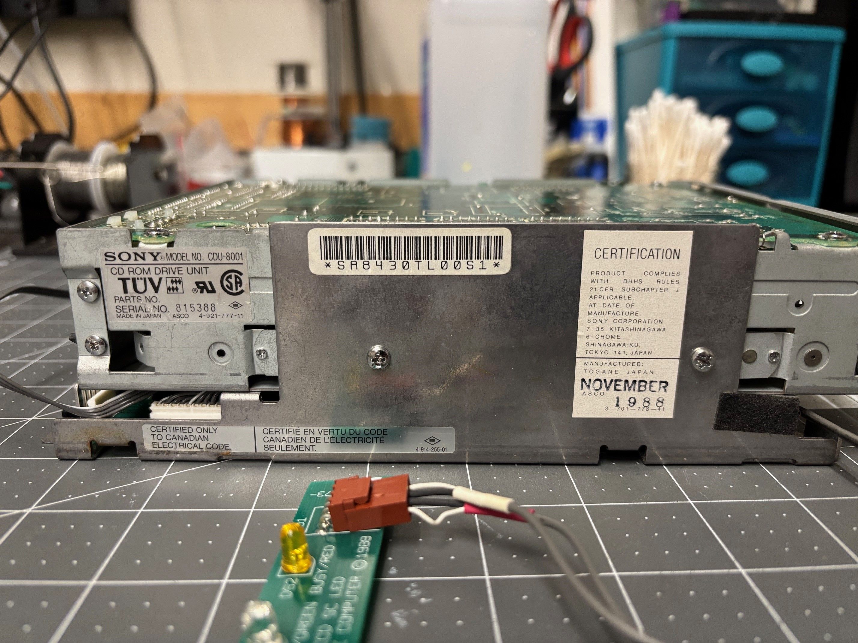

Side view. 1988 - wow this is an early CD Drive!
Rear view. So many interconnect cables.

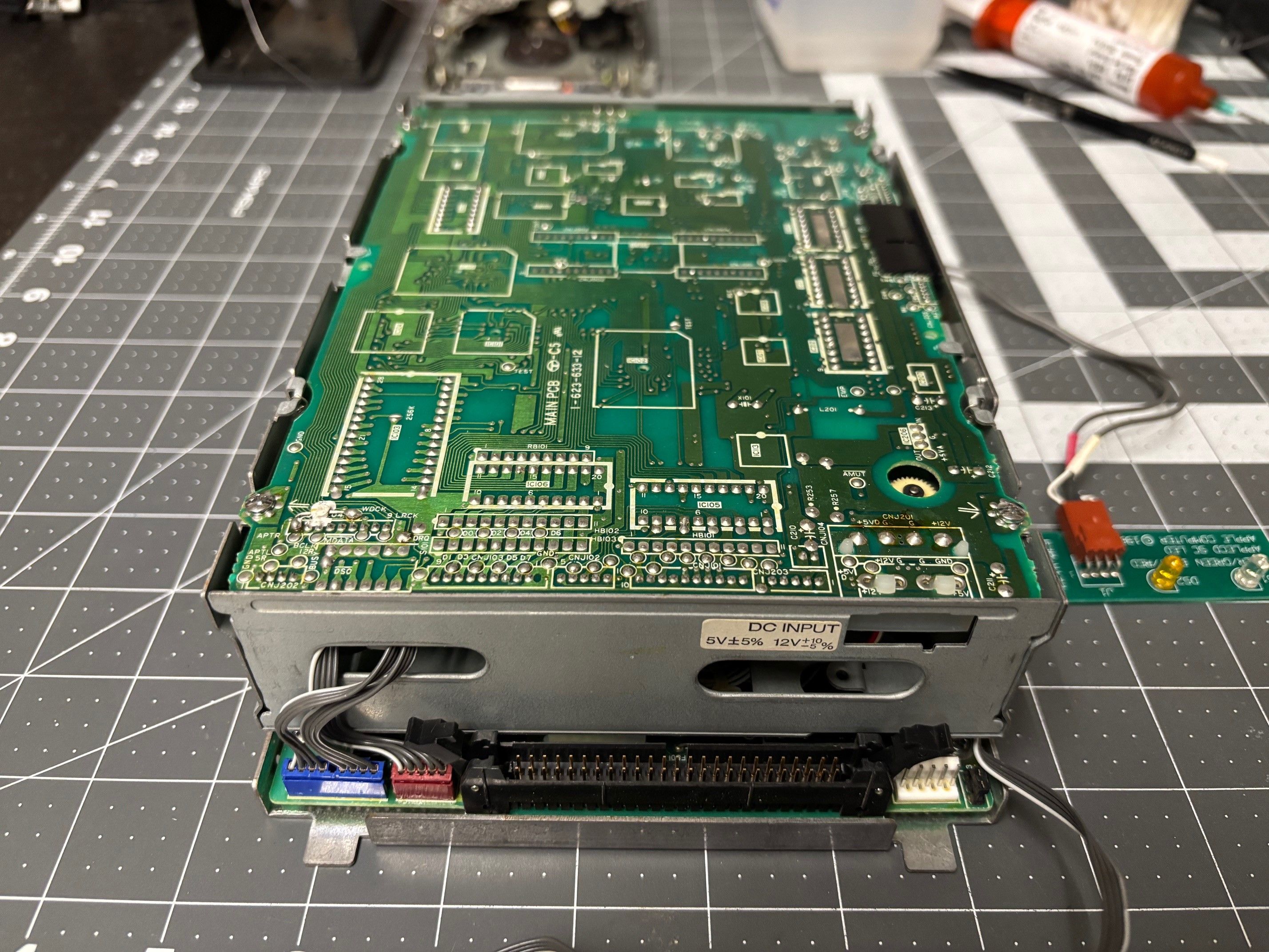

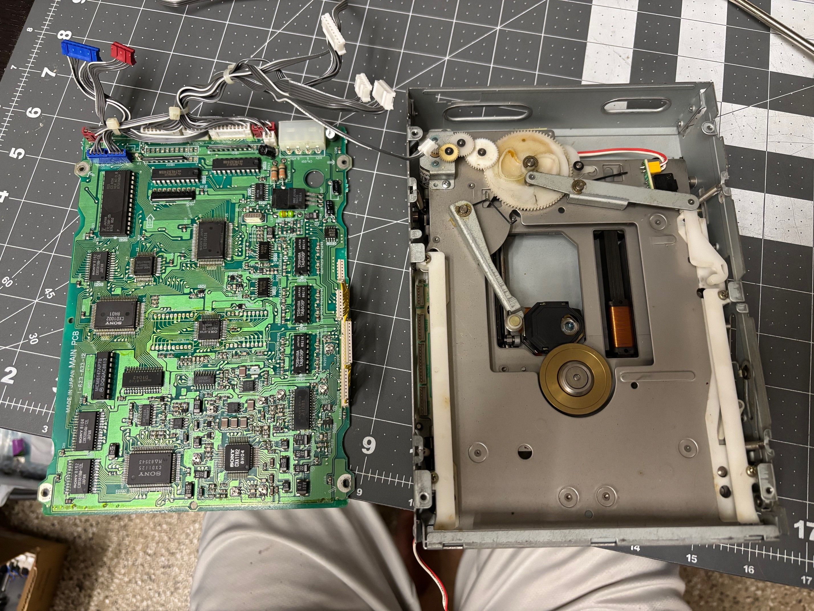

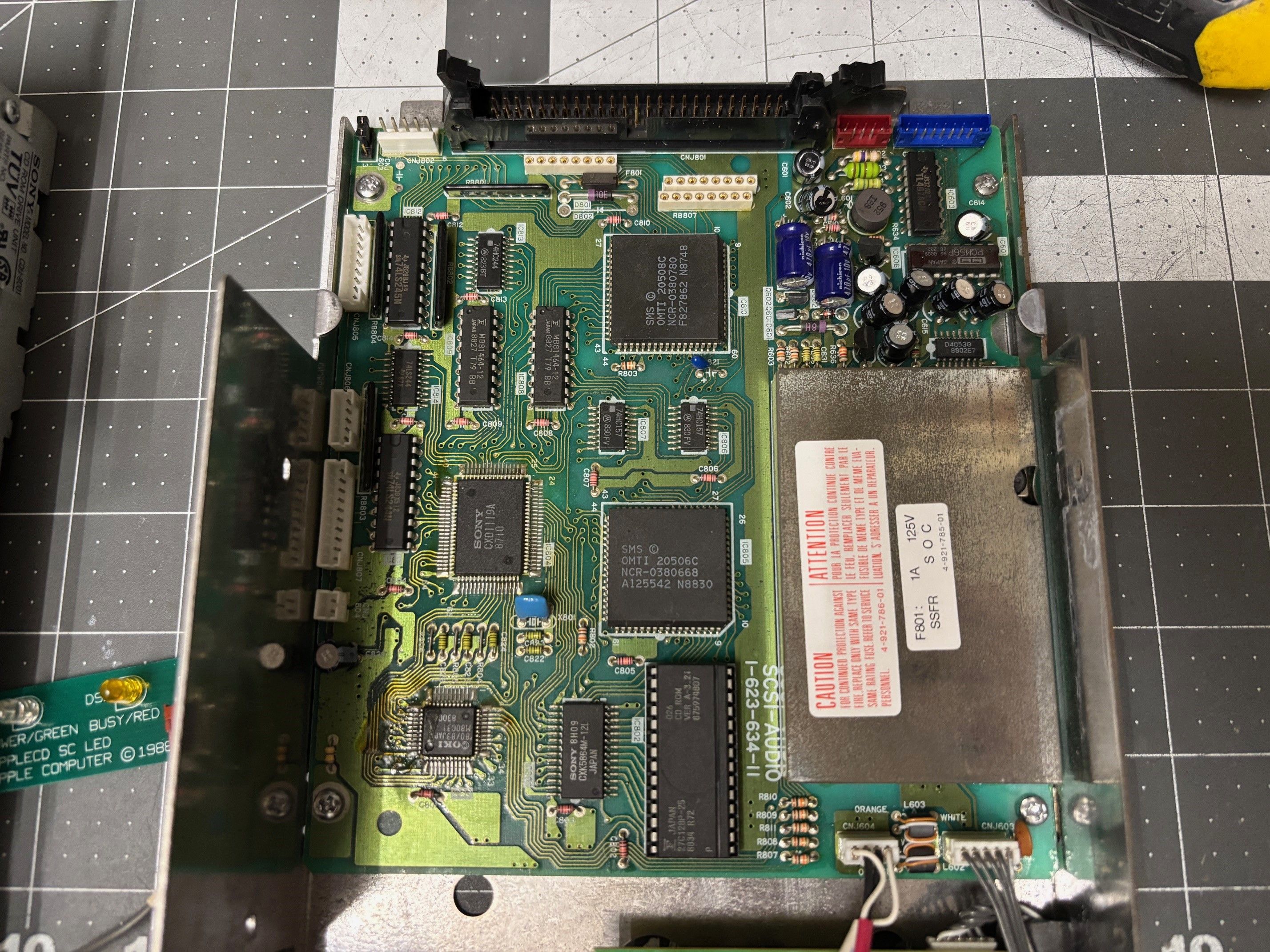

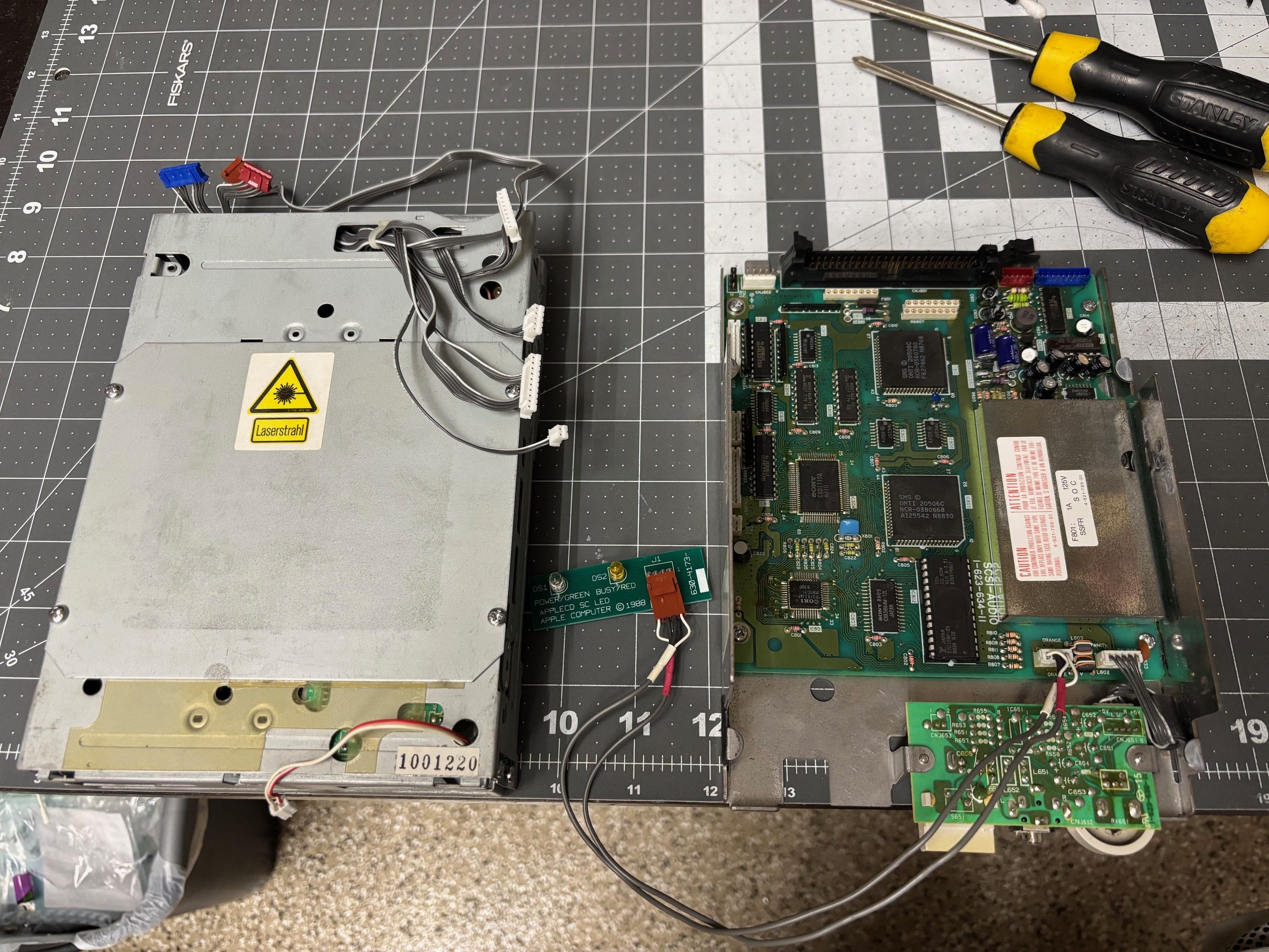

This is what the drive looks like separated from the bottom portion. I believe this board handles SCSI data and audio. More interconnect cables...

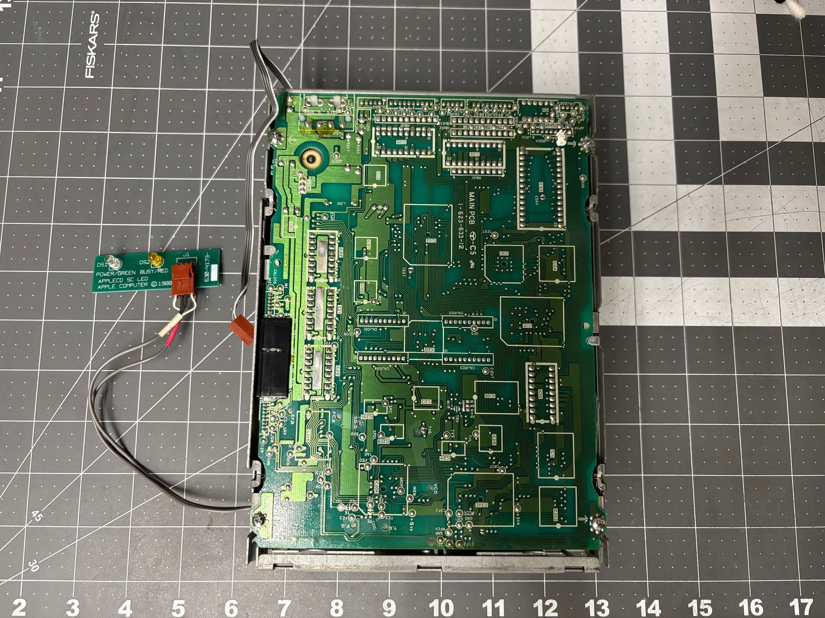

This is what it looks like with the top logic board removed. This was a pain. Those yellow wire bundles are connected tight on each end. Still no sign of any leaky SMD caps.

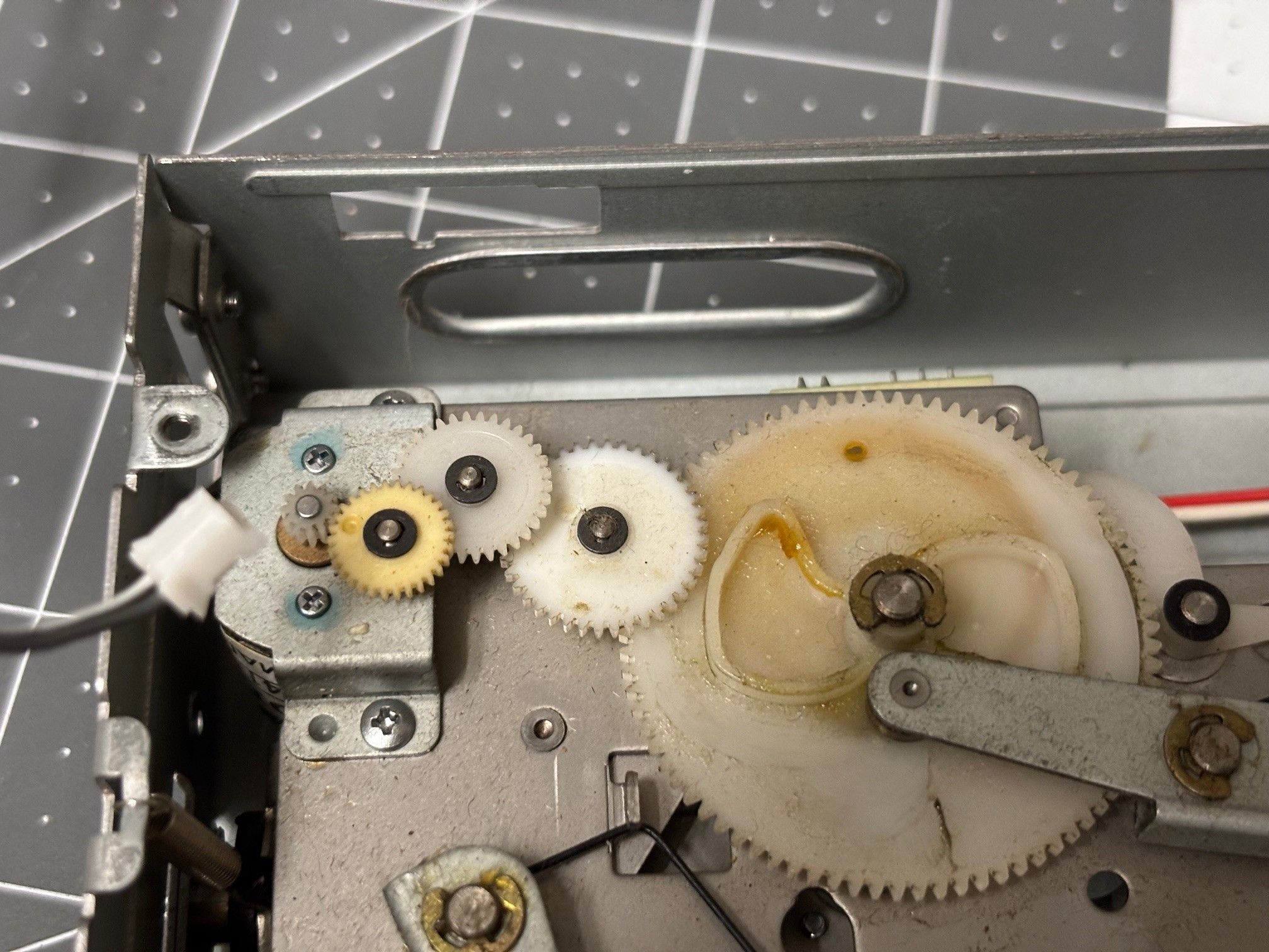

Eject system. The yellow colored gear looks familiar. Hope it's not as brittle as those found on the auto-inject floppy drives.

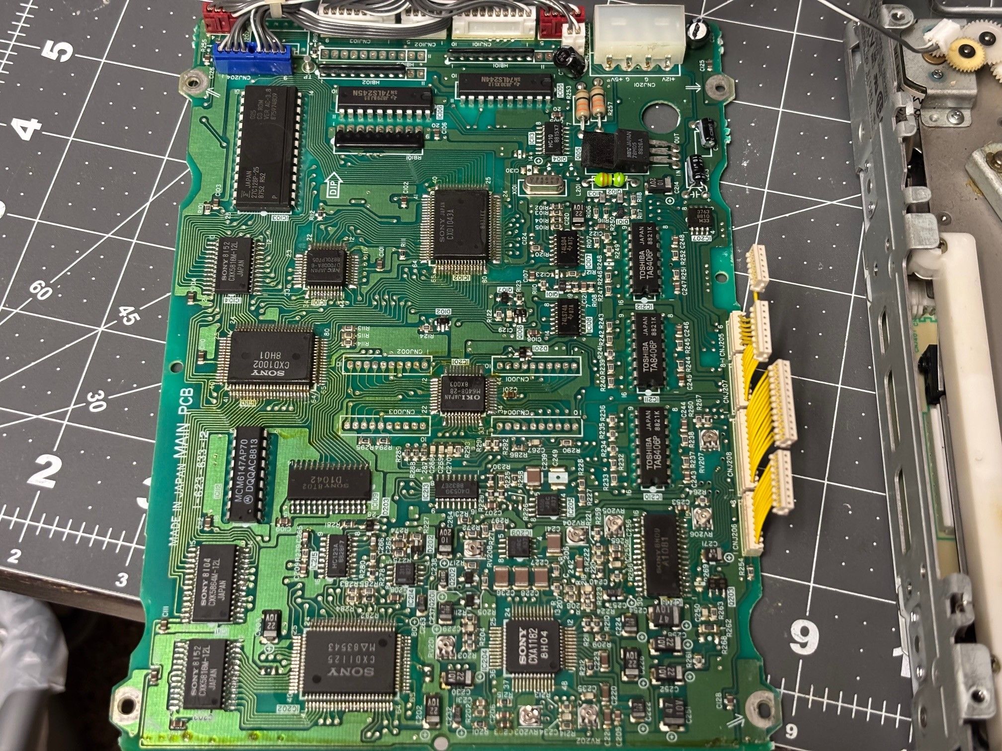

Close up of the drive controller PCB.

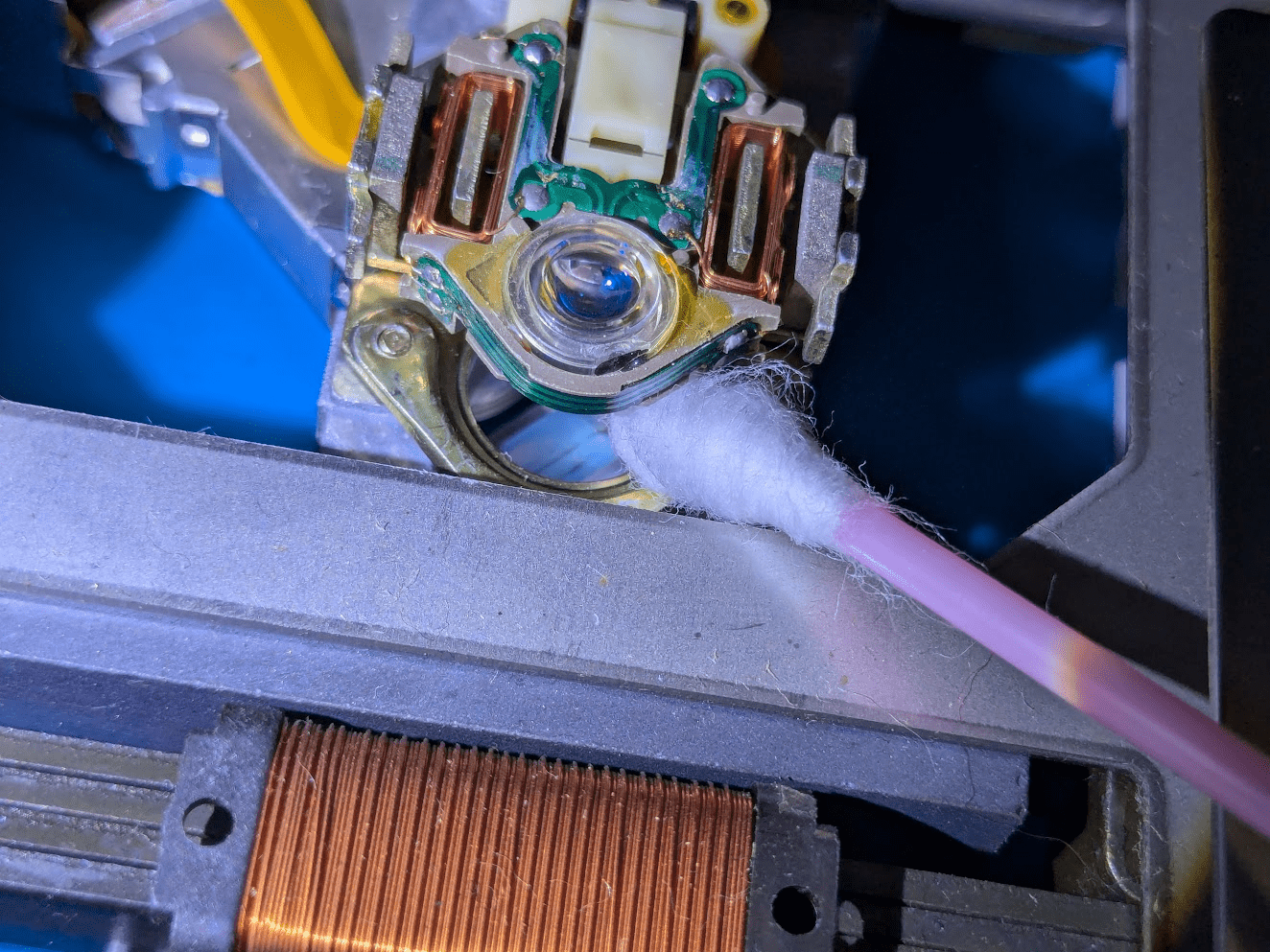

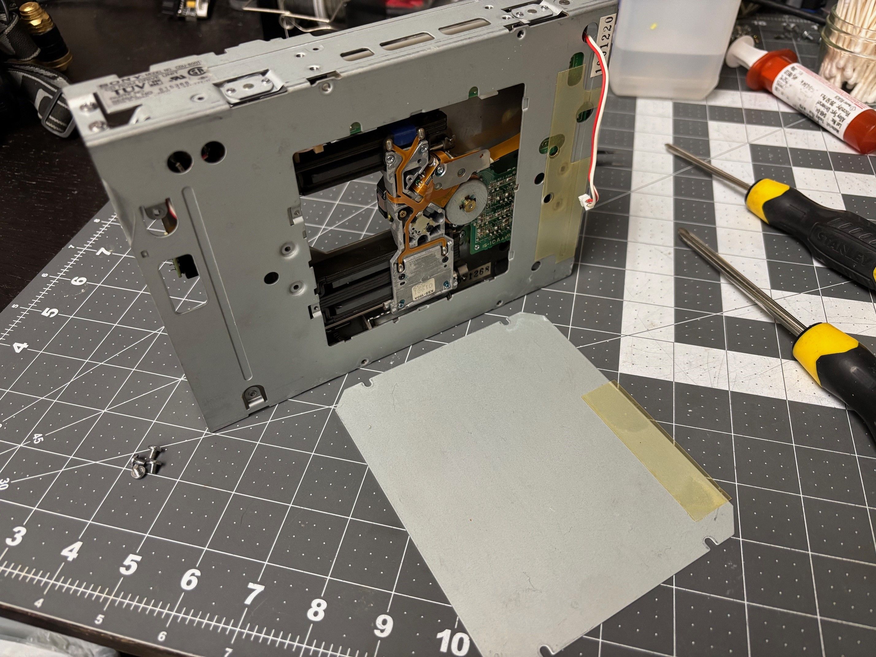

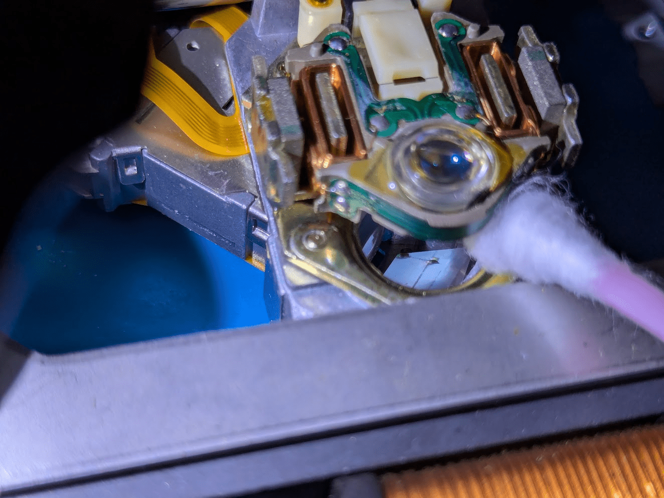

Underside with the plate removed, exposing the laser.

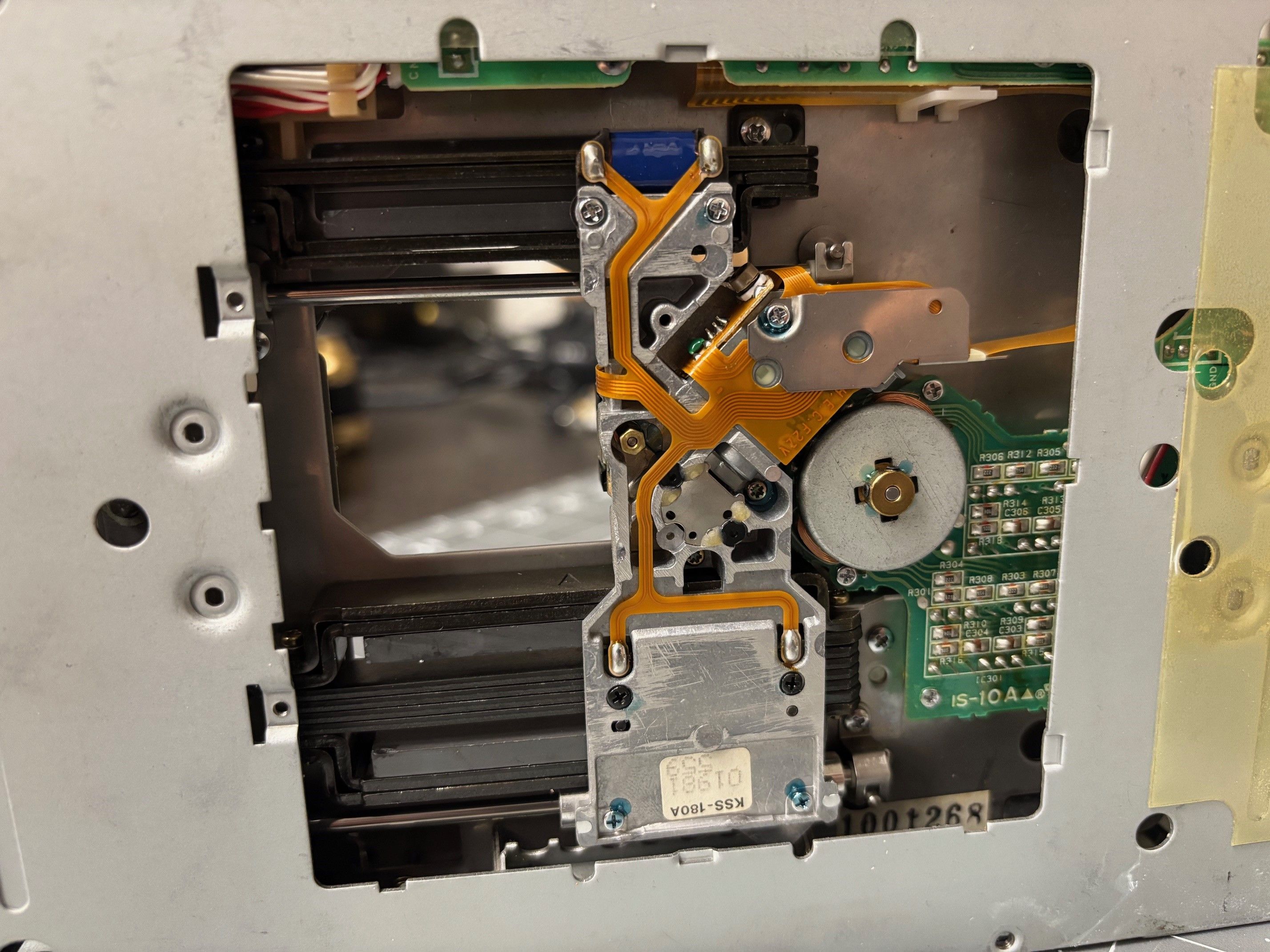

One more view inside, a little closer.
Like I mentioned, this drive isn't currently working. Neither LED on the small PCB illuminate, and it won't read any discs. I was really hoping it would be as simple as swapping some capacitors, but there aren't any leaking from what I can see. Cleaning the laser lens didn't do anything either. I recently bought an oscilloscope, so maybe I'll start there. Tough to figure out what I need to look for without schematics, but that's all part of the fun!

I used your tear down to help repair mine. It had a broken small plastic cog on the eject motor, managed to find a metal cog close enough size, pressed that on and have it working.
One thing I noticed on your tear down is that you have the SCSI selector and the front LED wires mixed up, both have the same brown connector. Might not make it work, but worth a try.
Reactions: Garrett
I'm fascinated by this observation. What you see pictured is exactly how it came out of the case, so if it's really swapped, that means someone has been in the drive prior to me. I'll have to look closer at the PCBs and correct this issue. If it magically starts working, I'll be sure to post about it!
Ive been working on 3 of these drives recently. They are starting to succumb to polarizing prism degredation. Theyre laminated much like LCDs are, and that bond breaks down and it gets hazy, killing the performance of the pickup slowly until it just... Doesnt read anymore.
We need an optical pickup rebuilding service because it needs new prisms installed and then realigned.
