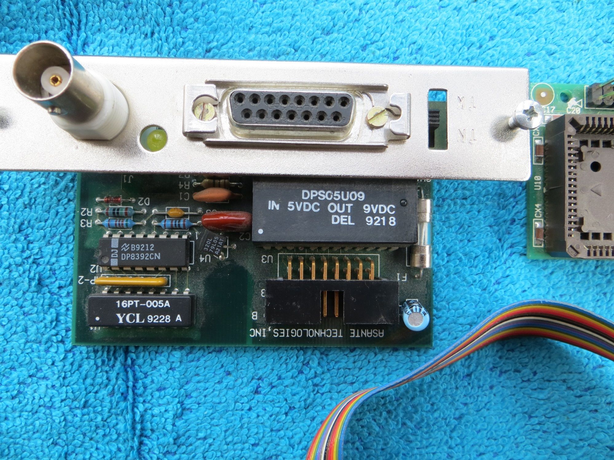

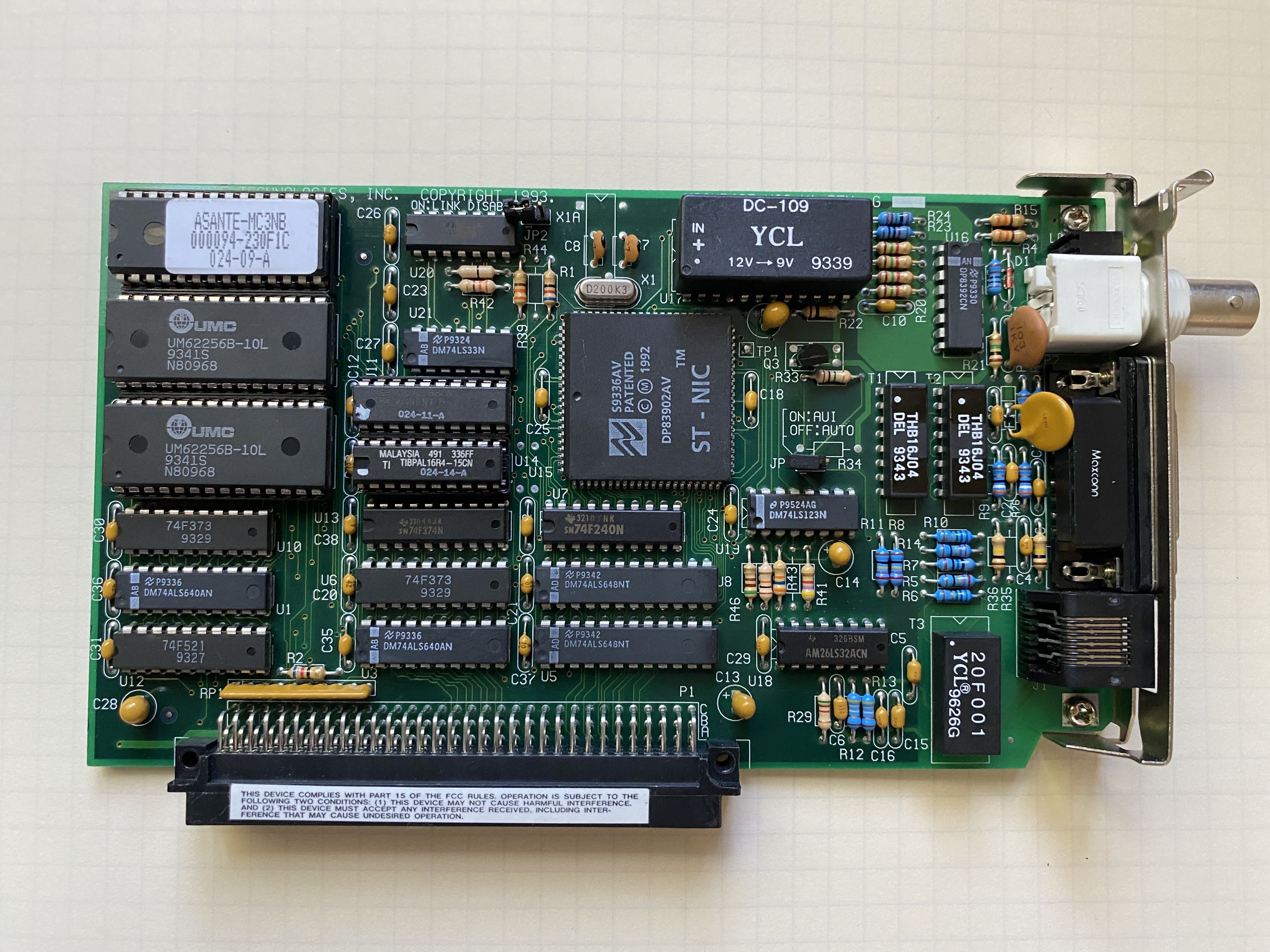

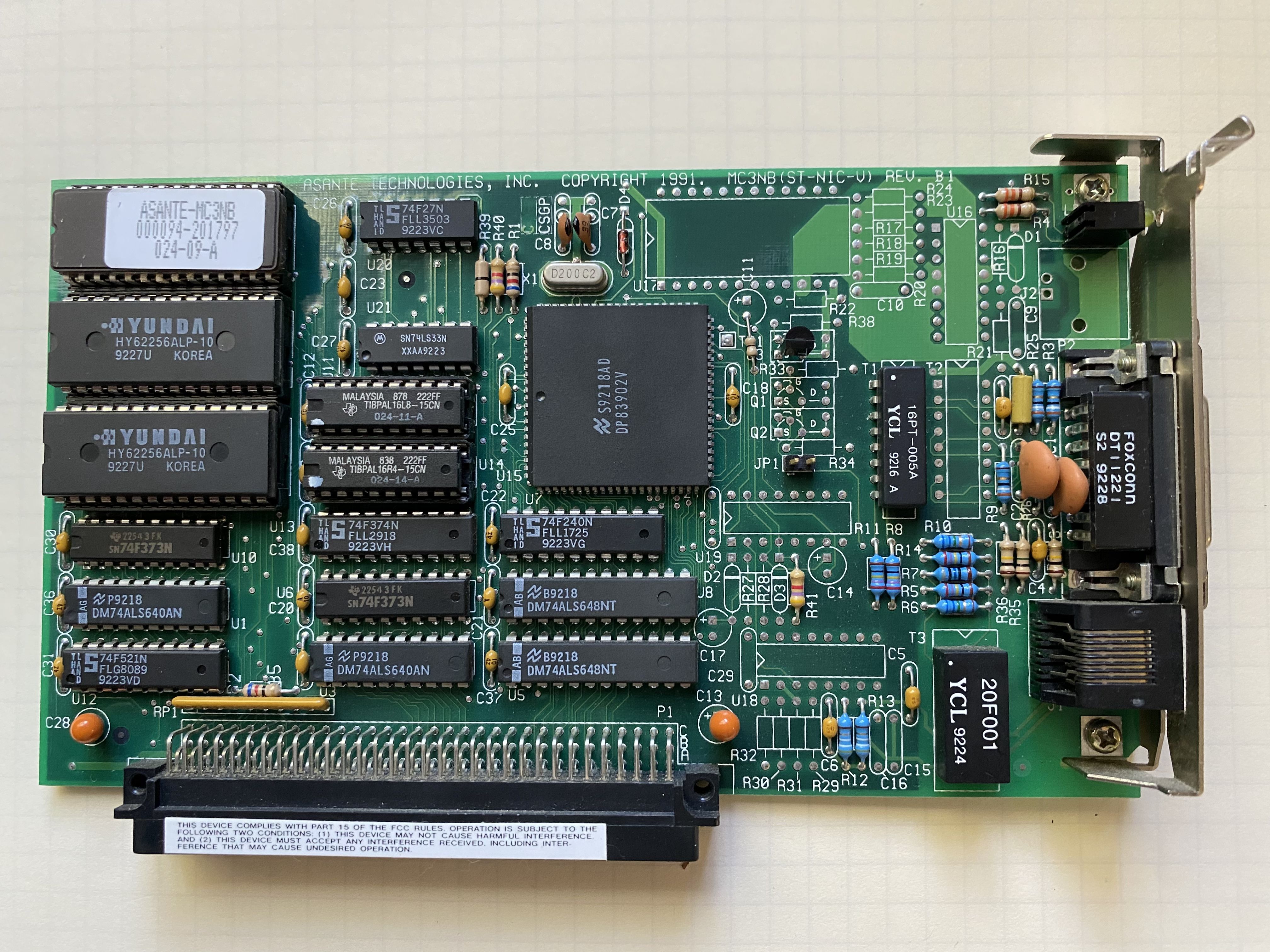

I’ve used a couple of the Rev G version of these NICs in Mac IIcx and IIci, and I’ve always have trouble with RJ-45 10Base-T. Operating through an external AUI transceiver is fine but direct RJ-45 connection mostly fails.
People have reported these NICs don’t sync with modern 100/1000 switches. I connect via a 10/100 switch and still have problems. The only way that I can get a connection is to boot/reset with Link Integrity enabled (jumper JP-2 open) and then disable this immediately after boot. Then the line syncs - although the switch reports a half-duplex connection. Obviously, diddling this jumper like this is not practicable. I see the same with MacOS, NetBSD and Linux — i.e. it’s not a driver issue.
But .. I also have a Rev B1 board which has only AUI and RJ-45. This is flawless using RJ-45 over regular cabling and the same networking switches etc. This card is a similar to Rev G and it uses the same NatSemi DP83902 network controller chip. What?
Does anyone know what’s going on with this NIC? Is there any way to fix/modify/bodge the Rev G board to work like its Rev B1 sibling?

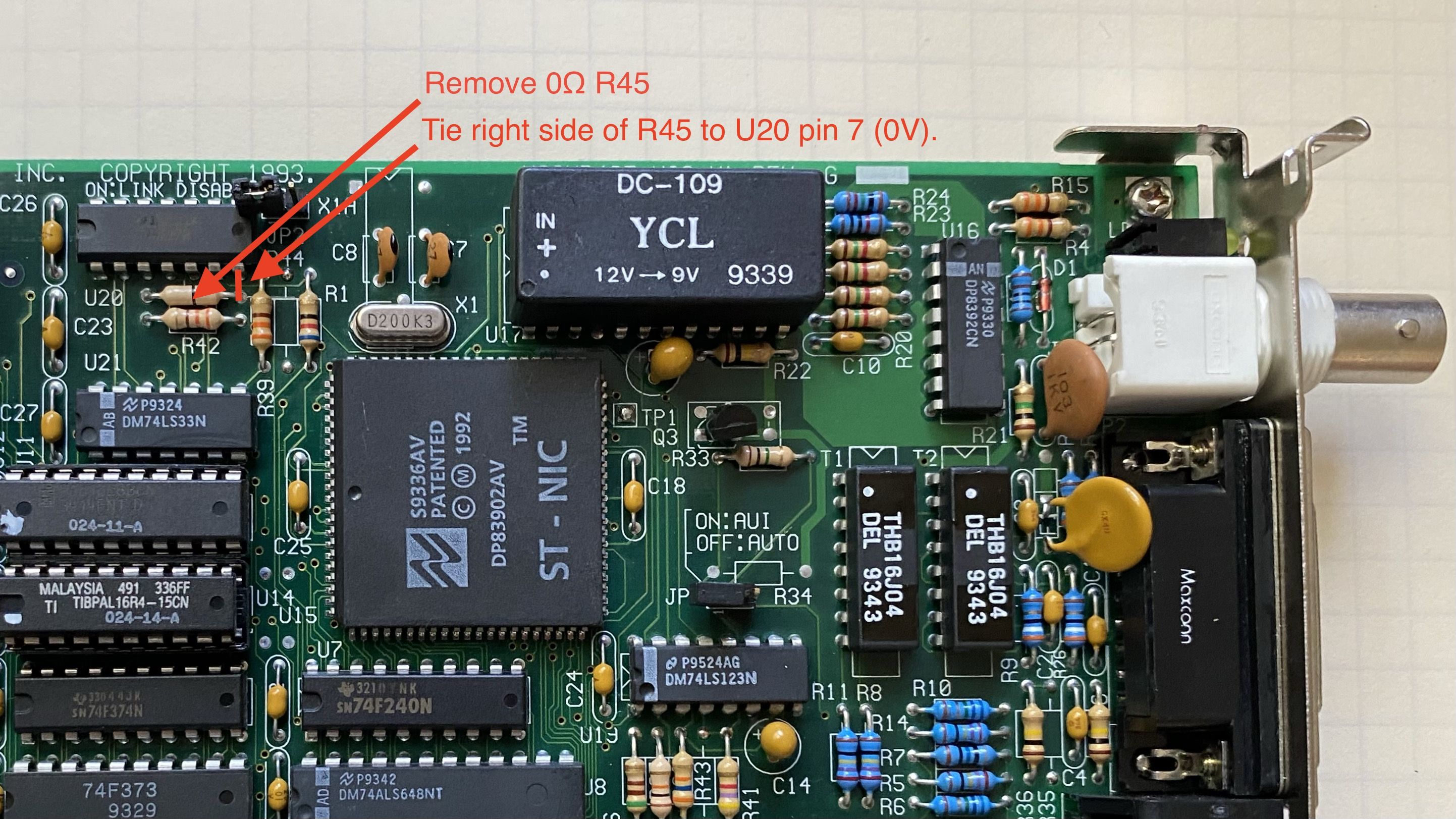

Deciding not to rewire with thin net, I took your suggestion and took a look at pin 72, the AUI/TPI SELECT line, on both the rev B1 and rev G boards.
On the G1 board, pin 72 is tied firmly to 0V vis a 0Ω resistor - hence twisted-pair goodness albeit only half-duplex.
Whereas on the troublesome G board, pin 72 is driven from a gate whose inputs are funky and I think determined by JP2 (link integrity enable/disable) and two other sources -- one may be a bit in a register set by firmware or Nubus interface, and the other is derived from the mysterious link integrity logic which toggles hi/lo to flash an LED. The result is the state of pin72 being somewhat uncertain.
But it may be possible to hack the rev G board by disconnecting the dubious gate driving pin 72 and tying it to 0V. I'll try and report back.
Reactions: luminescentsimian
One simple way to get RJ45 to work on the Rev G board is to:
  • remove R45, a 0Ω resistor
  • tie the end of R45 closest to the NIC controller (with trace to pin 72) to pin 7 of U20 which is the OV rail
See annotated photo:
There is probably a way to modify the Rev G so that the jumper JP1 can still switch between AUI and TPI.

I have a Rev G I also want to modify. Your hack is good, it is the most direct way to force TP only. One refinement I think makes sense, is to actually install JP1. The way JP1 appears to work is to disable the coax circuitry when it is installed. With JP1 off it is dynamically disabled by the TP link detection circuit.
I'm still trying to understand how the switching on the Rev B board works, as I might try and mod my Rev G so that it can still switch between TP and AUI.
Another solution, the problematic link detection circuit can be made to work by changing R28 from 36K to 220K. This increases the time allowed between detected link pulses to be long enough to allow for Auto MDI-X. I've tested this on a Rev B2 and a Rev G card, with a TP-Link TL-SG1016DE ethernet switch.
R28 is in the same physical location on all the boards I have, by pin 3 of U19 (74LS123), which is also to the left of the unpopulated D3 on Rev B1/B2/C1 boards, or to the left of the unpopulated R43 on Rev G.
For cards with TP, AUI, and Coax, I also recommend installing jumper JP1, as that will power down the coax circuitry. On the cards with all 3 connectors, TP still takes priority over AUI when JP1 is installed.

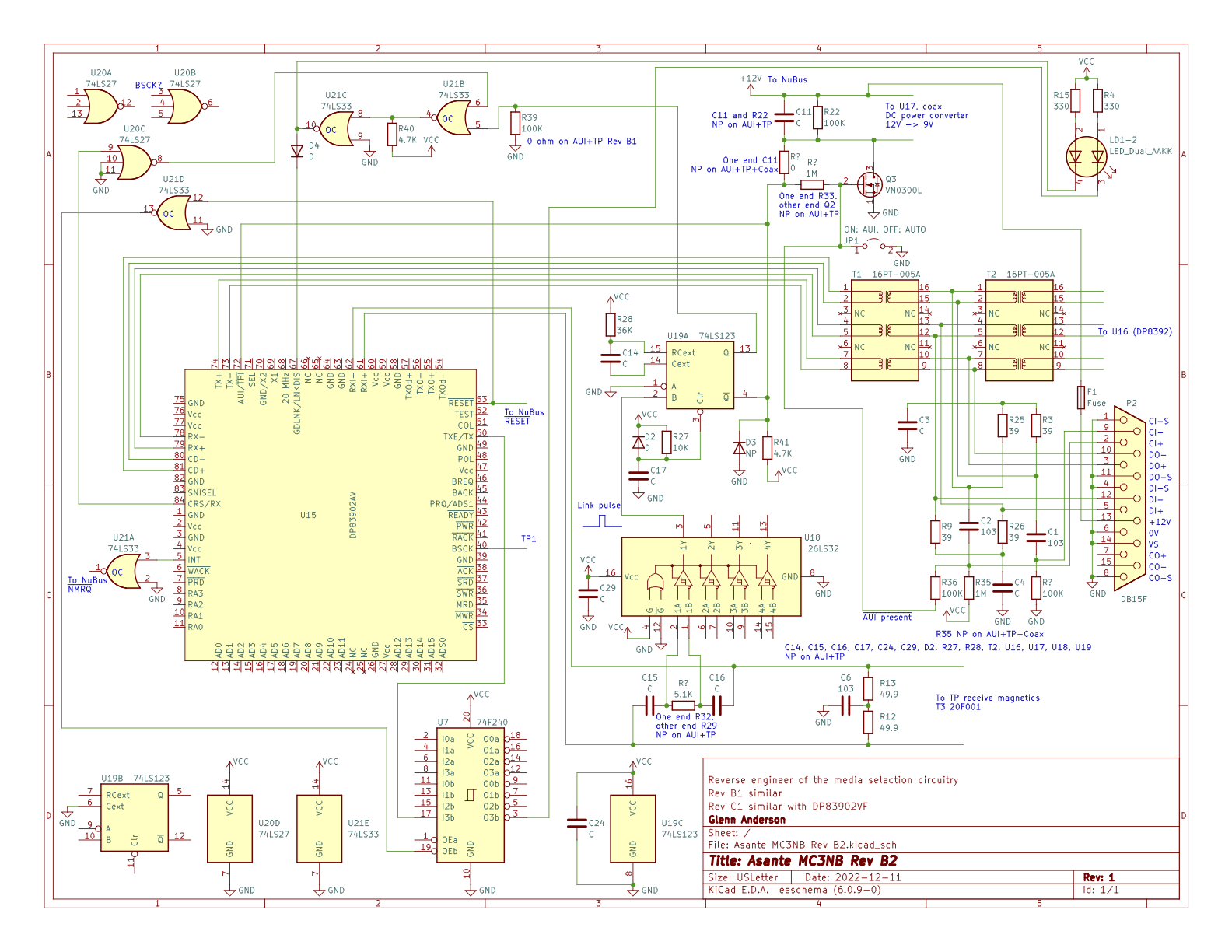

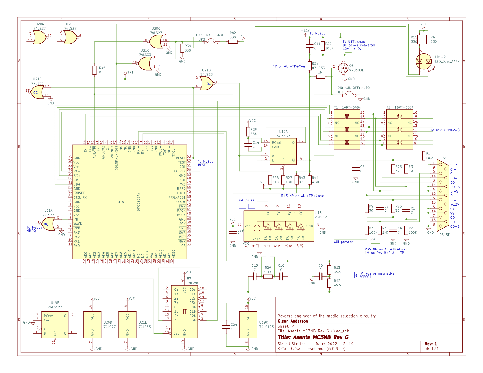

Here are schematics I've made of the media sections of the Rev B2 and Rev G
To do a full conversion of a Rev G to remove coax and the problematic TP link detection circuit, it looks like the AUI/TPI pin of the DP83902 can be connected to the AUI detection circuit by removing the link at R45, and adding links at R43 and R34. The 1M R33 would have to be moved to R35. A bunch of other components would also have to be removed, I think at a minimum U17, U19, C11, and R22. Much more involved than replacing a single resistor, but I might give it a go at some point.

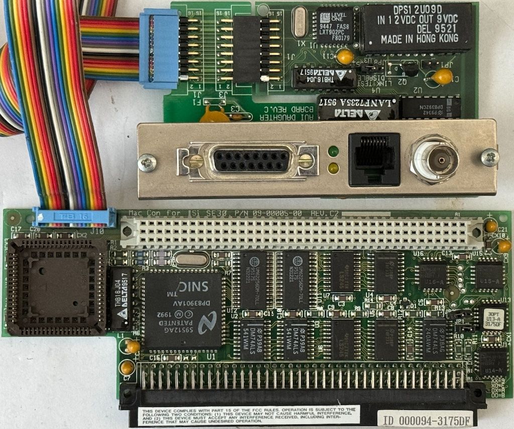

Hey @Glenn Anderson you wouldn't happen to know if the MacCon SE / SE30 cards are compatible with such a modification like the 220K ohm resistor change above?
The ones I have don't have this issue, so it isn't applicable to them. I have a MacCon for SE Rev C, and a MacCon for IIsi SE30 Rev C2. I haven't had any issues with these cards and modern ethernet switches.
Cards that have this compatibility problem have a DP83902, and automatic media selection, using a 26LS32 and 74LS123 to detect link pulses. Changing the resistor is changing the time constant for the 74LS123.

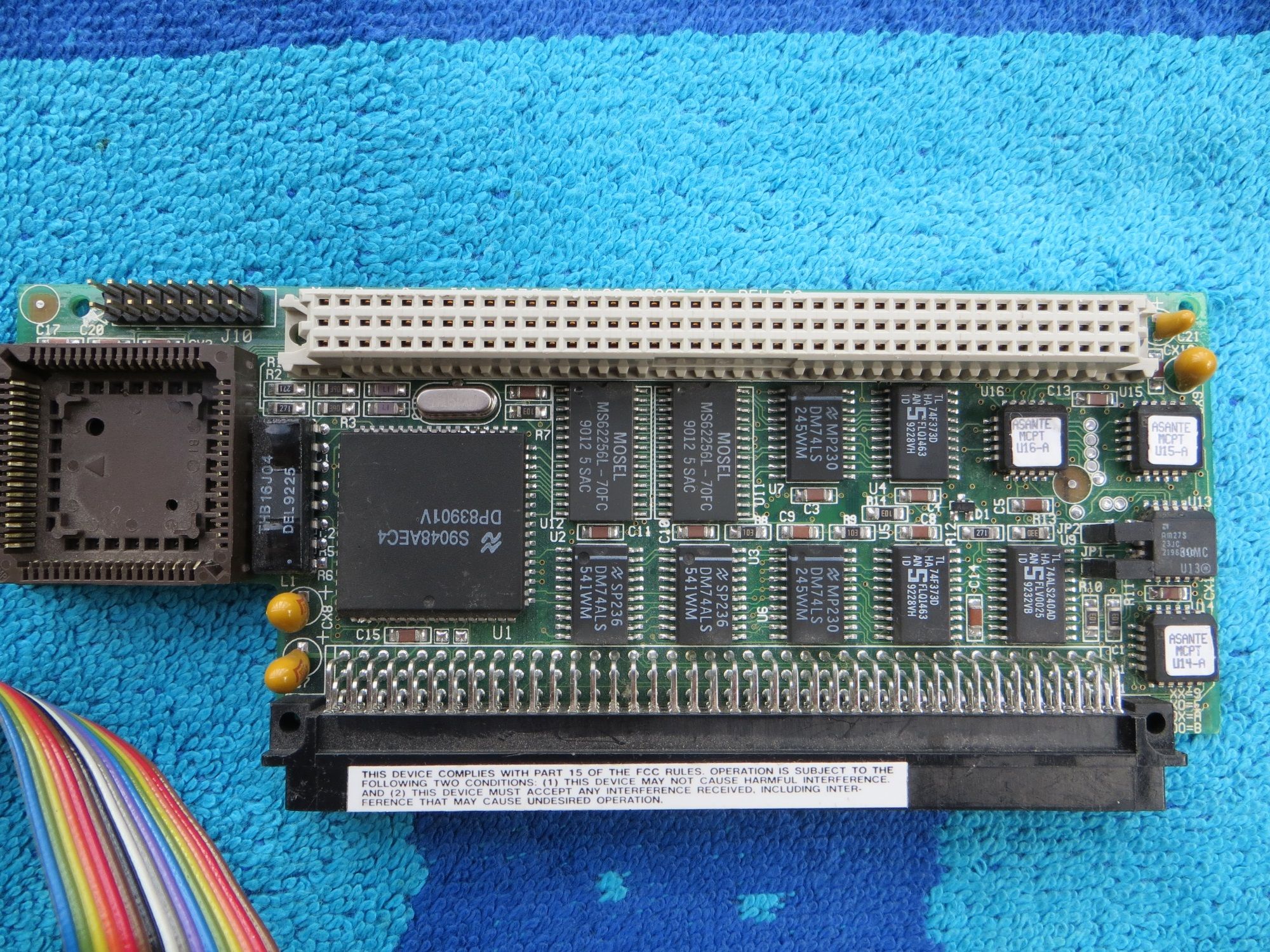

The MacCon for SE Rev C that I have uses a DP8390, with an AT&T T7220 transceiver IC on the connector board. The MacCon for IIsi SE30 I have uses a DP83901, with an LXT902 transceiver IC on the connector board. The MacCon for SE has a switch for manual media selection.
The switch on the MacCon for SE has 3 positions, TPL, TPN, and TK. For 10base-T it needs to be on the TPL position, the TPN position turns off link pulses. TK is an abbreviation for Thick, which selects the AUI connector. The MacCon for IIsi SE30 has JP8 labeled LINK TEST DISABLE, that jumper needs to be off.
I you are having trouble getting this style of card to work, try an AUI transceiver. If you can't get an AUI transceiver to work, then the problem is probably with either the main card, or the ribbon cable and it's connectors. Although if the AUI transceiver doesn't power up at all, do check the fuse on the connector board.

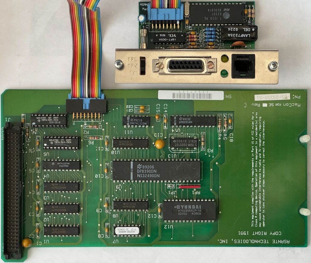

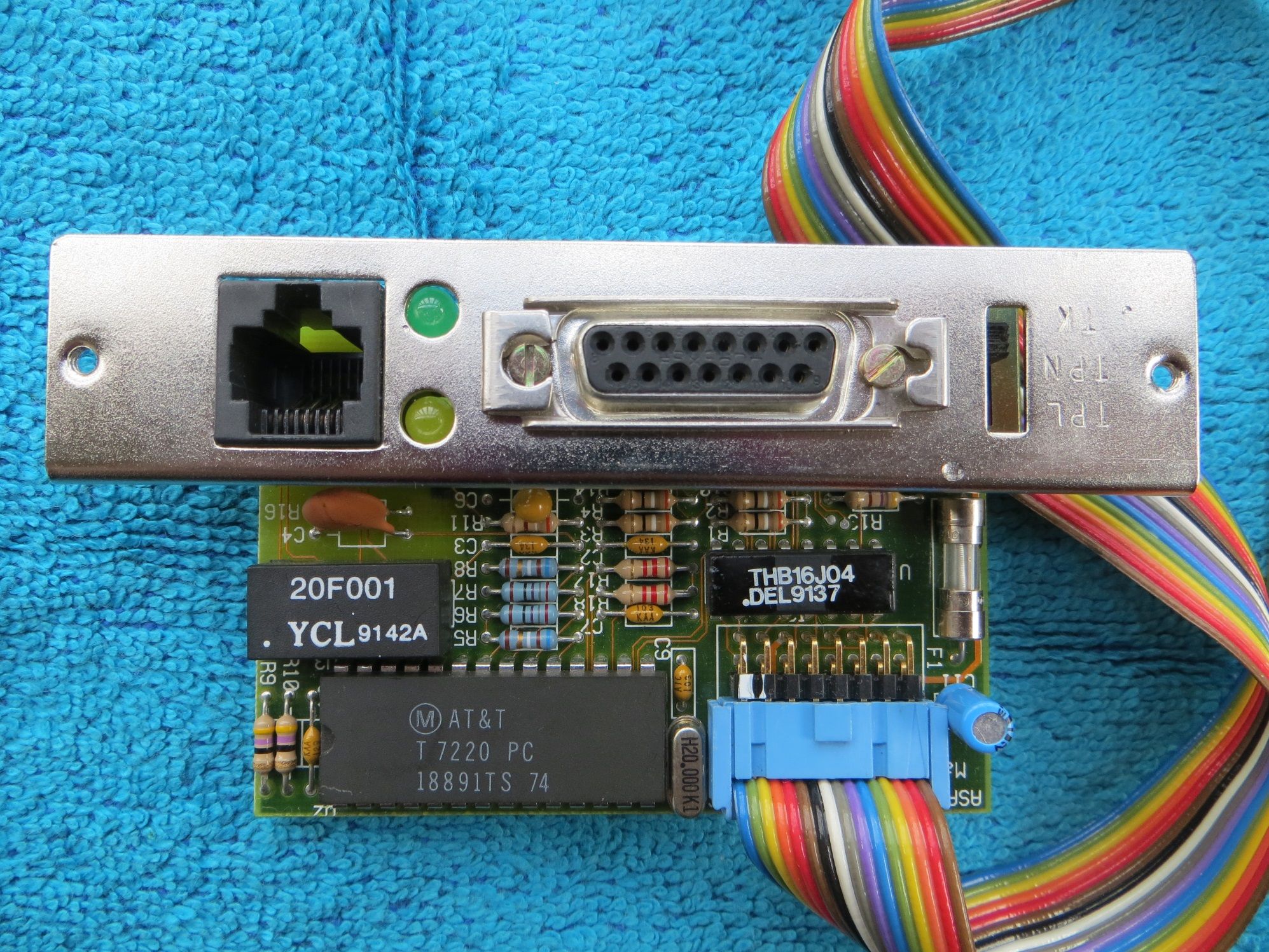

Here are pictures of the cards I have. If you have different version cards, feel free to post pictures and I'll be happy to take a look at them.

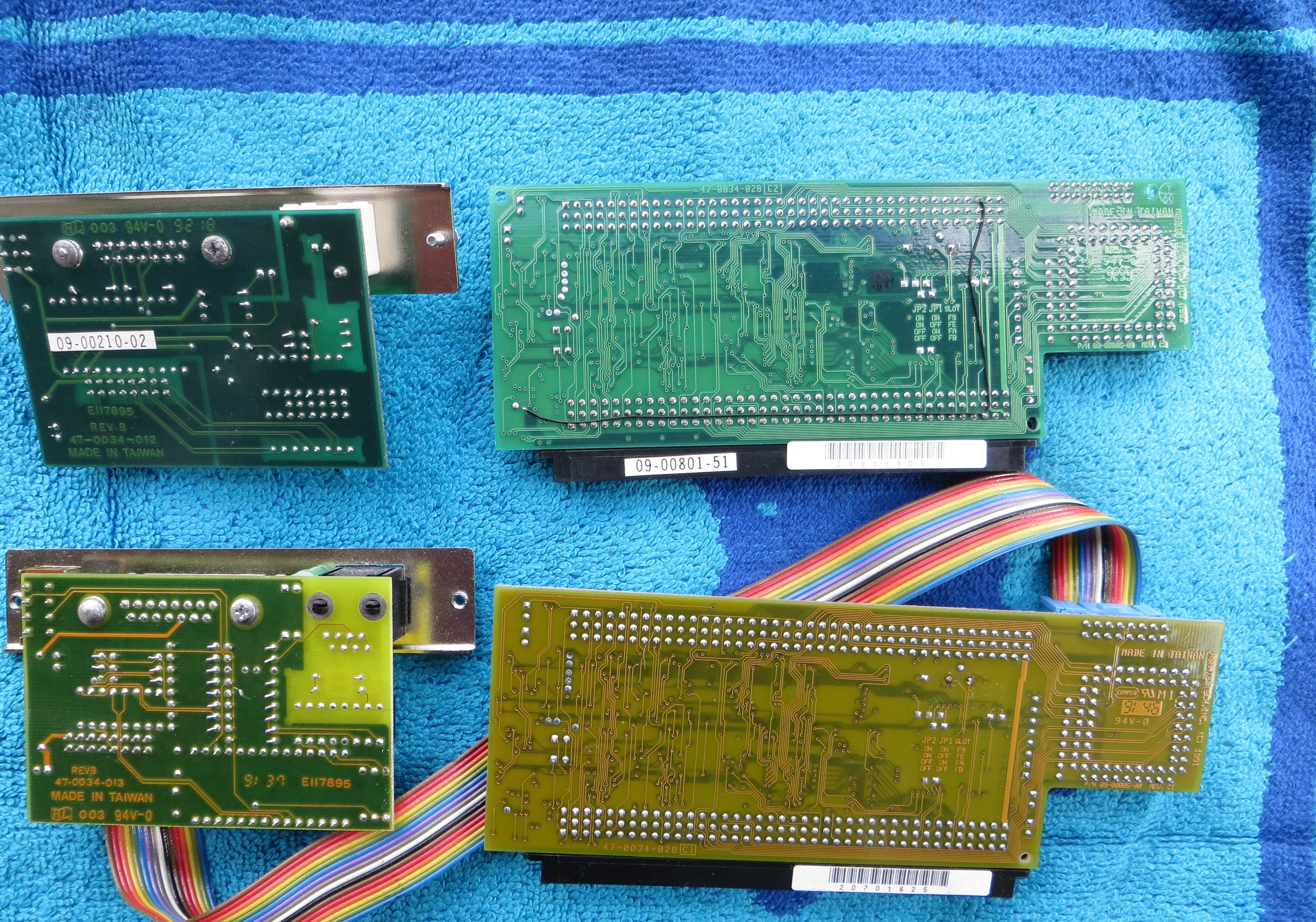

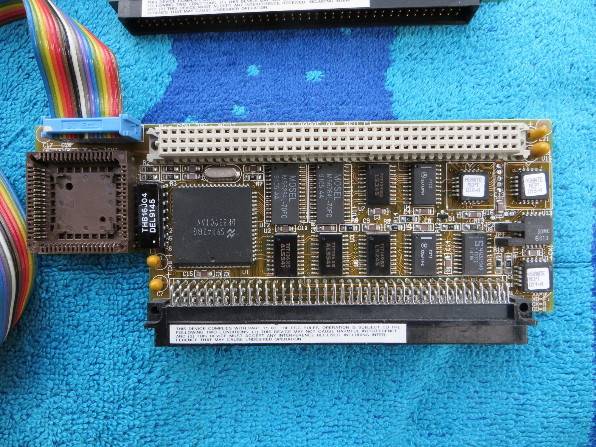

Here's my cards. First up is one I got with the machine, which caused me a small amount of head issues owing to the fact that I didn't have an AUI adapter for it. Fun fact: Those cable-less AUI adapters won't work on these or the Mac II series ones because the body of the unit is larger than the space in the case, so you ... need to either buy a AUI drop cable or similar DB15 non-VGA cable. Revision C2.
This recent one I forked over 150 bones for. Rev. C1.
Back of both cards.

Did you just replace the 20MHz oscillator on the main card, or did you also replace the one on the connector board? Between the connector and the AT&T T7220 chip.

If the socket doesn't seem to be the problem, check the 20F001. It is an isolation transformer, should read about 1 to 3Ω between pins 1 to 3, 6 to 8, 9 to 11, and 14 to 16. If any of those high resistance or open circuit, swap it out. There are newer revision 20F001N and 20F001NG parts available on eBay for reasonable prices.
I would have thought the 20MHz oscillator on the connector board failing would impact both the transmit and receive sides, but maybe the receive side could still be working well enough to detect link pulses, but the outgoing ones are too slow or infrequent?

While I have you on the sound power, you know anything about this thing? I used it many moons ago on the CMN Guide for general Ethernet things and also to peg a 10/100 card at the max using a Rocket under System 6. (Short story: 866KiB/sec down, 605KiB/sec up using a RAM disk on the Rocket itself.) Right now the Asante software installer can't even recognize the card.
I've never seen one of those cards in person, they are rare. Does anything detect its presence? If the NuBus interface on the card and the ROM are working, it should show up in the Network/MacTCP/AppleTalk/TCP/IP control panels as an option, it will just fail promptly if you select it and the drivers are not installed.
However looking closely at your picture, it looks like the ROM might not be seated well in its socket?

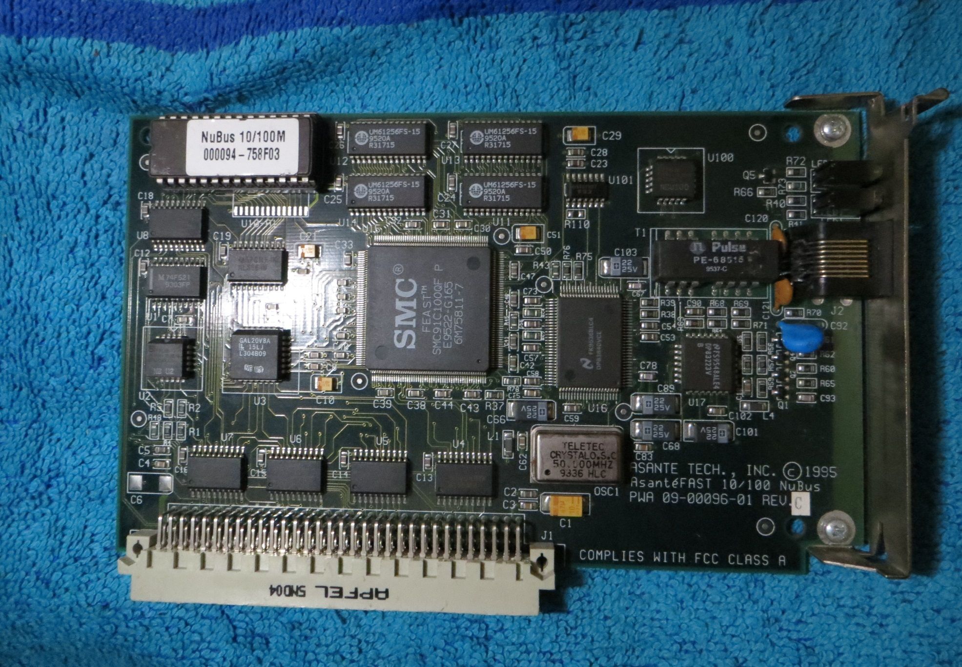

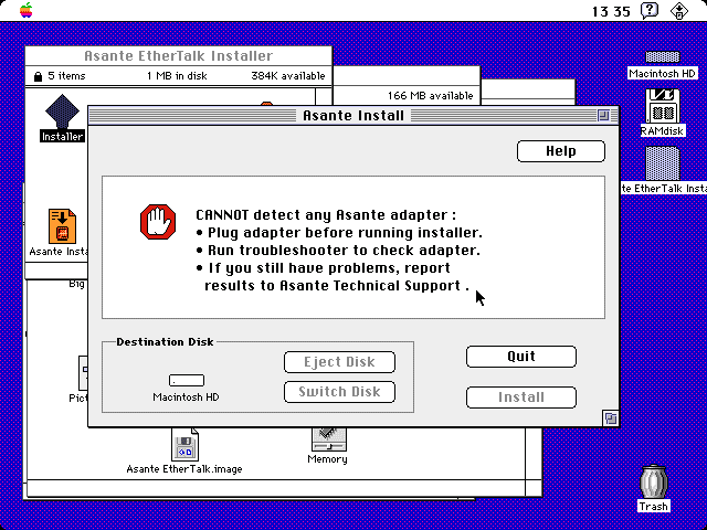

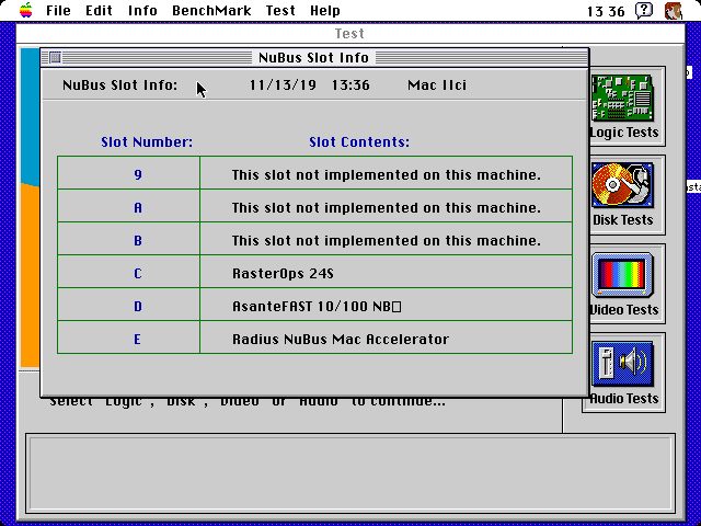

The 10/100 NuBUS card I took another close look at. Reseated the ROM. Using a loupe, I saw no knackered pins on the main chip U15 or U16. There looked like a scratched trace from Pin 1 and possibly Pin 2 of U14 leading to U16 but a ohm test said it was OK.
Dunno. The green signal lights light up with 10 or 100Mbit connections respectively, but does nothing else. Huh.

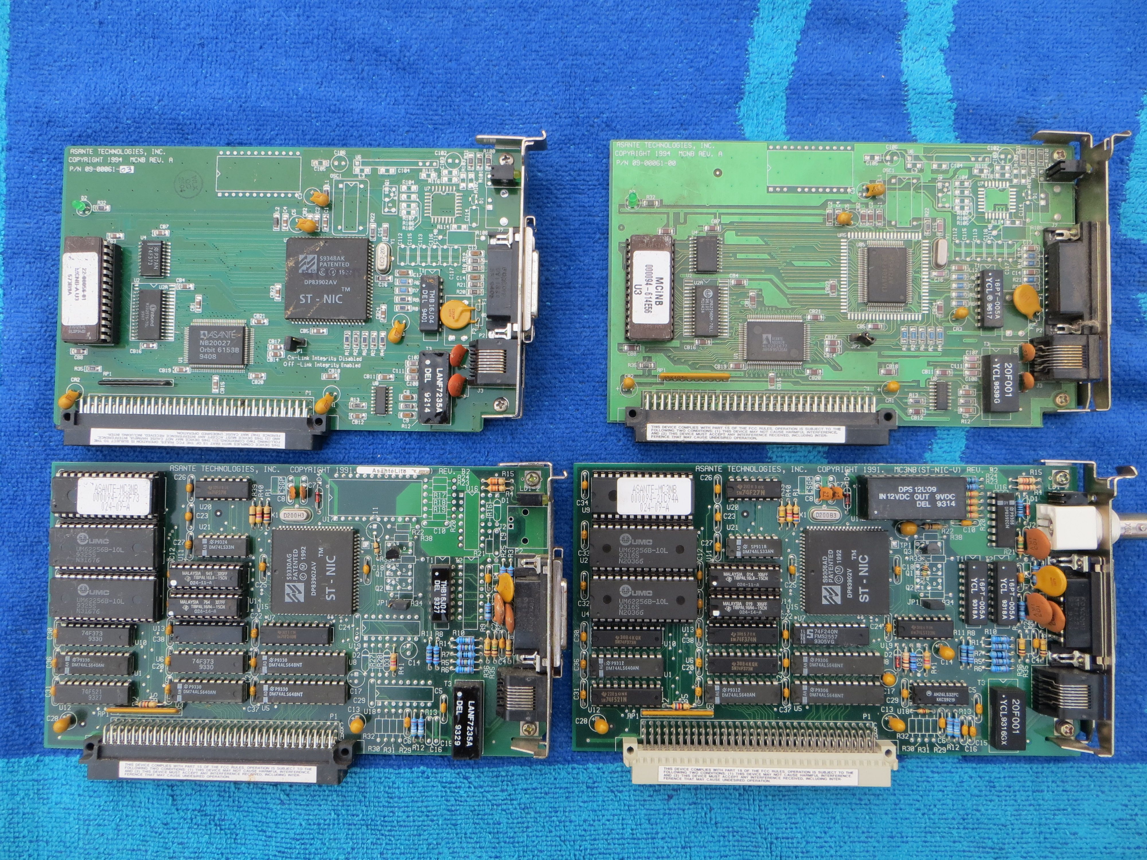

I got a box of Ethernet cards recently, some more interesting than others (not all shown here), but I thought you might find this at least mildly interesting. Bottom right is the Asante card with the swapped resistor that I've been using for awhile in the IIci. The others have been dormant for a...whle.
