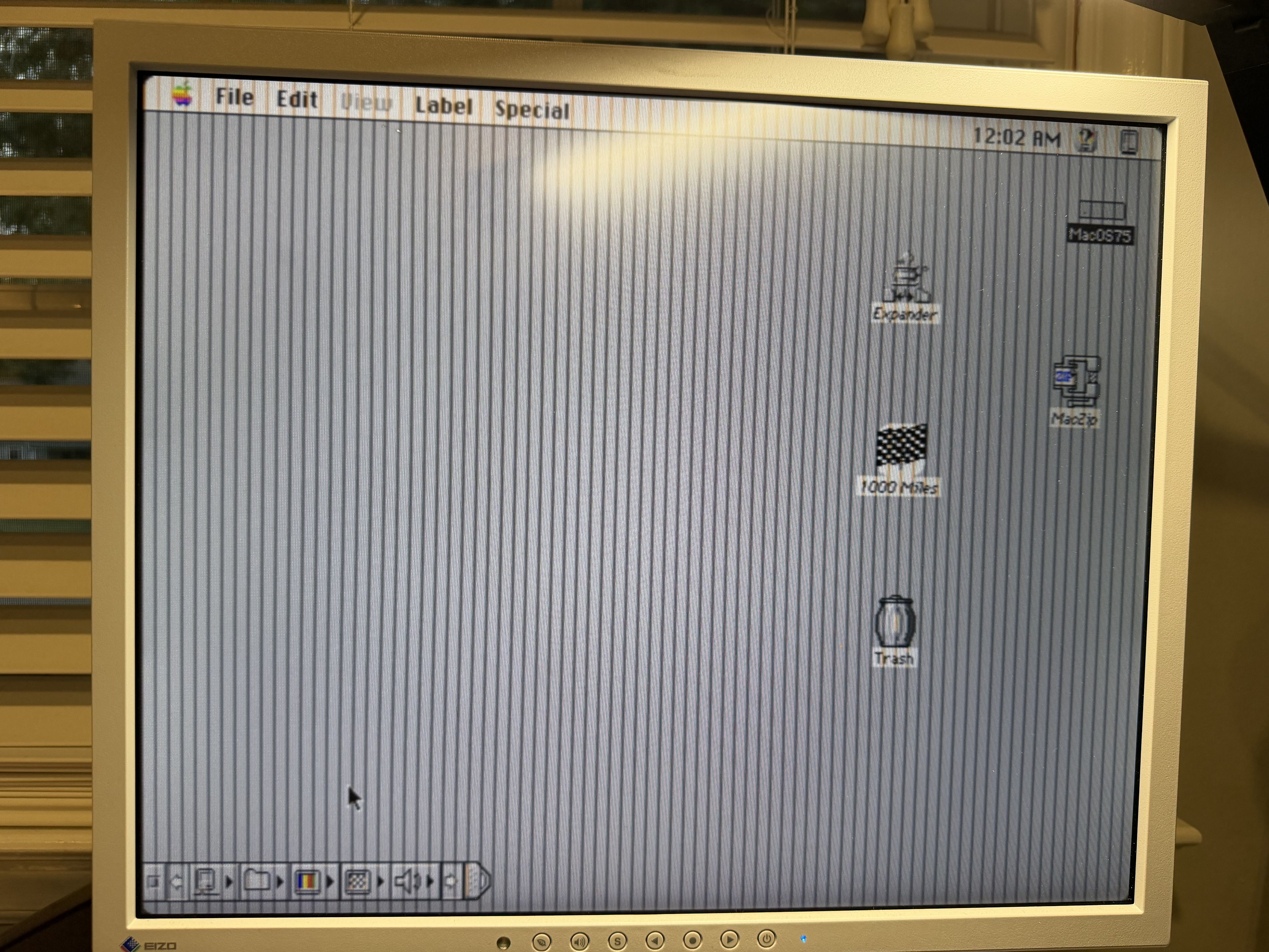

So, I’ve been working on a few of the last of the machines I picked up late last year. One of them was a battery bombed 650 that had a damaged SIMM slot. Unfortunately, I think I used too much heat and damaged some traces trying to remove that 72 pin socket. I did finally get it out, and ordered a new one from mouser.

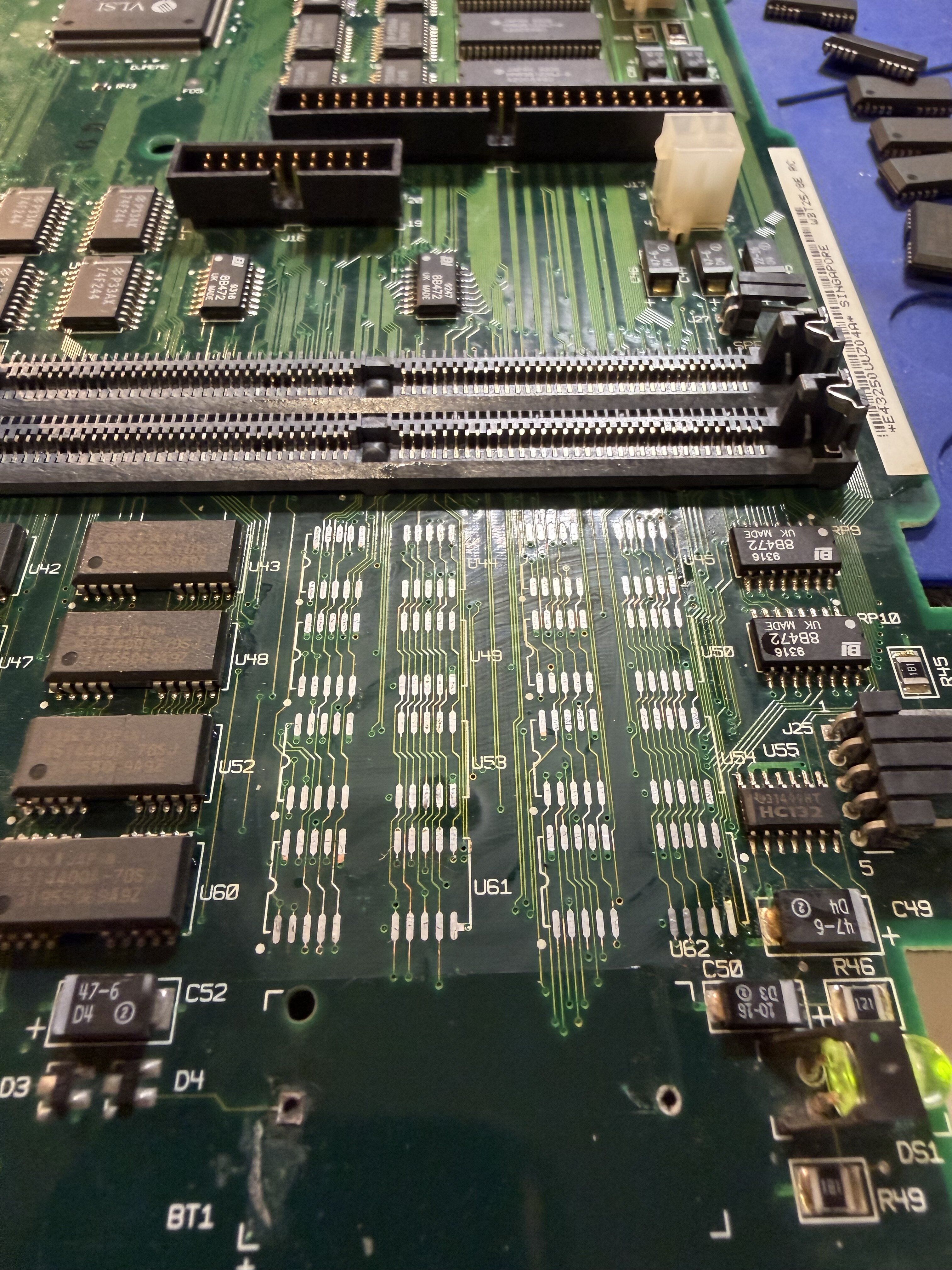

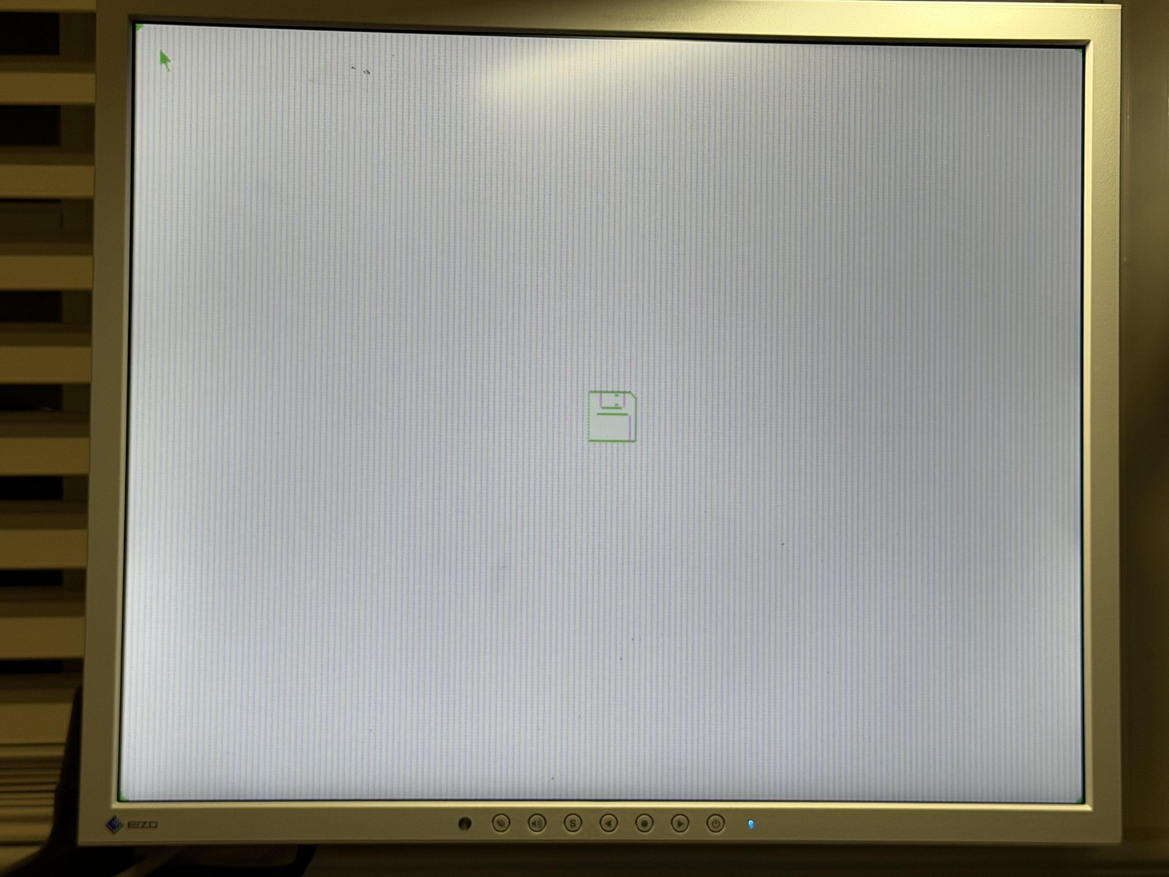

I got it reinstalled, and repairs two traces that were damaged, and still wasn’t able to get a boot chime. That’s when I realized the board was missing some chips that were there on my other Q650 / Q800 board. U18 and U22 were removed from the board. As was RP7. So I pulled the chips from another battery bombed board and was able to get a boot chime, followed by a sad Mac. Some of the memory chips near the battery looked a bit suspect, so I removed one of the banks of memory chips, U44, u45, U49, U50, U53, U54, U60, and U61. I cleaned and tested the traces I could see and they seemed good. And I got a boot chime and no sad Mac. I also got video out, but it was corrupt.

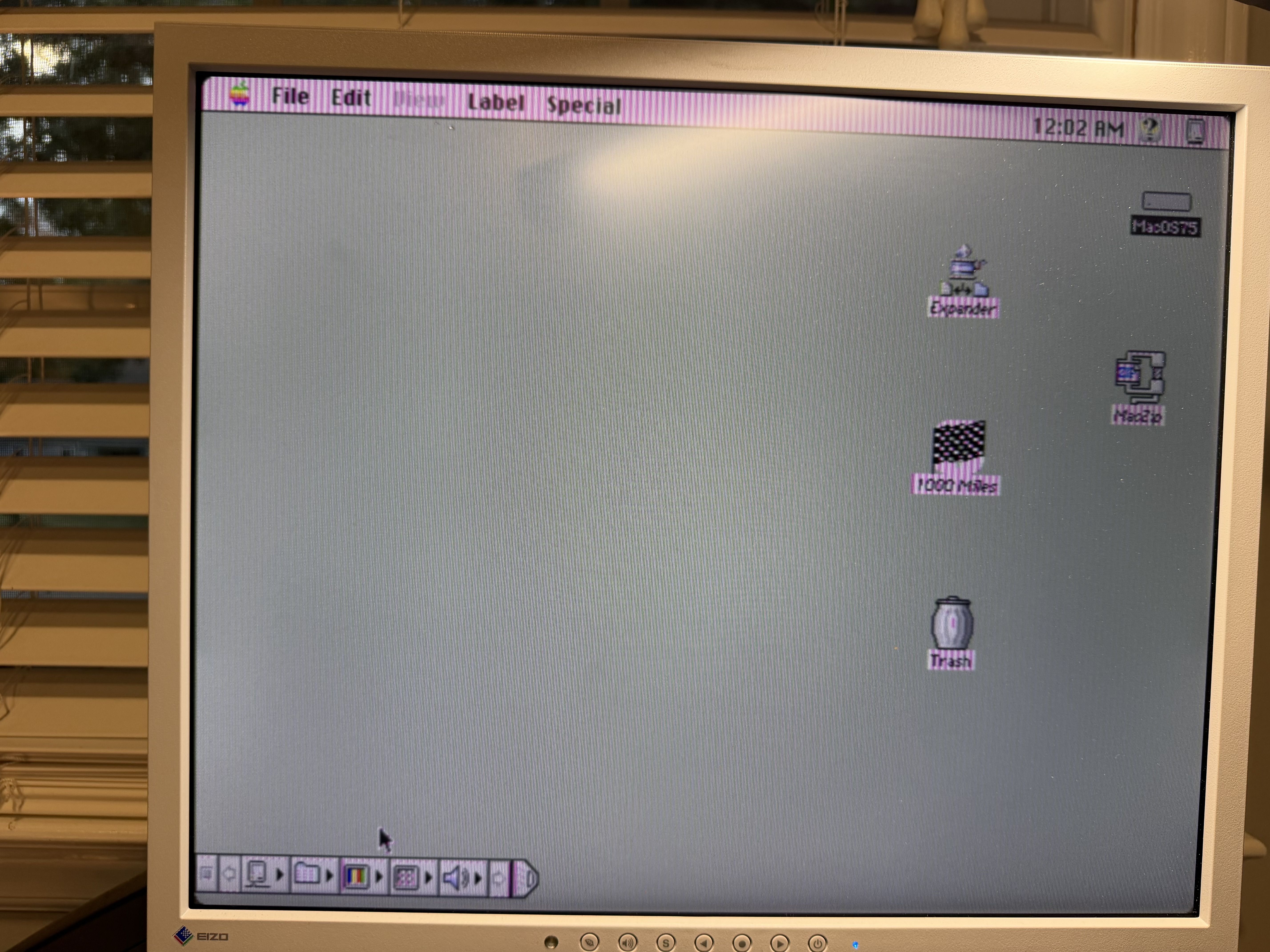

it seems like I’ve lost some colors, or the colors are scrambled. I have a green mouse, and vertical pink dotted lines down the screen. This doesn’t change with putting in known good vram chips installed or not
The other issue is that I obviously have half the built in memory with the chips I removed. I can out ram sticks in slots 1 and 3 and they work great. But if I RAM in slot 2 or 4, the sad Mac chime returns. Did I miss a damaged trace for slot 2/4 or will it not work with the on board RAM chips missing?
Other things seem to work fine. my ADB mouse works when plugged and I was able to boot from a BlueSCSI.

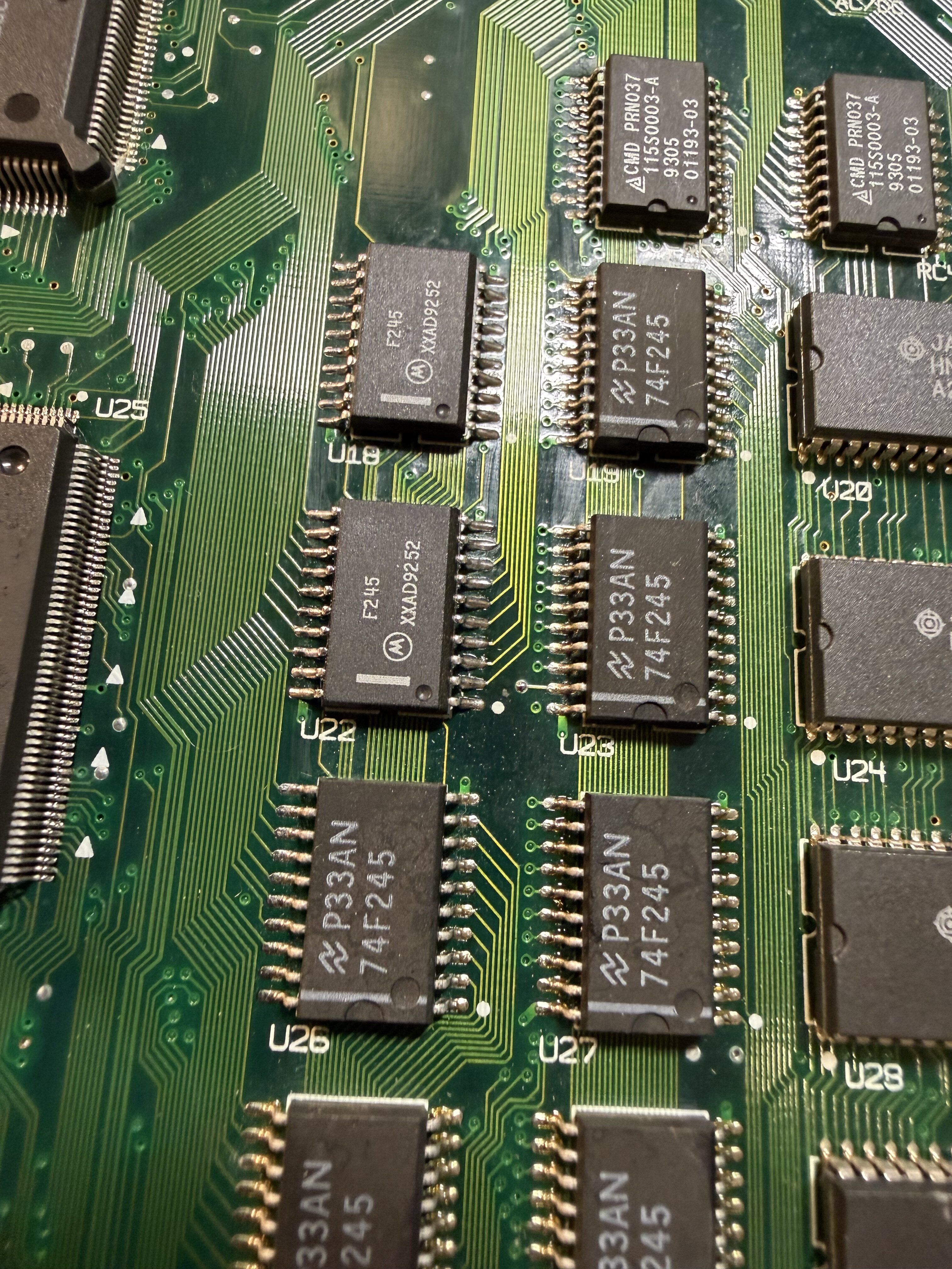

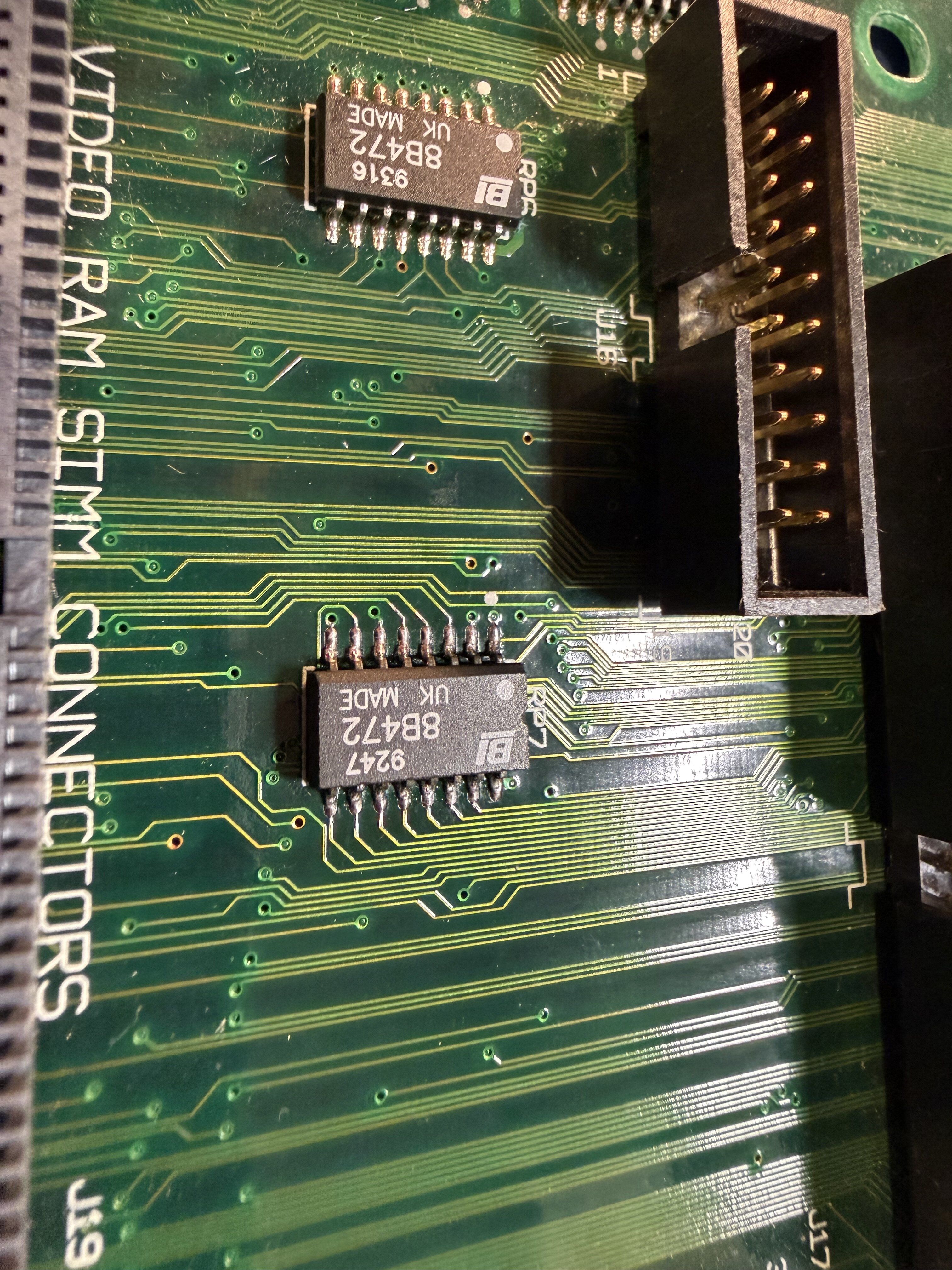

Where else do I need to look around for the corrupt video issue? Should I be concerned that the chips were slightly different for U18 / U22? They were still F245 chips. Just seemed to be Motorola branded. Also, the resistor pack at RP7 was a bit different, but I’m wondering if the 9247 vs 9316 markings were a date code? 1992 or 1993 would make sense for these, I think. All the chips that I believe are on board video ram (U20-U32) seem to be in good shape as do the traces nearby.
Appreciate any help or insight yall can provide!

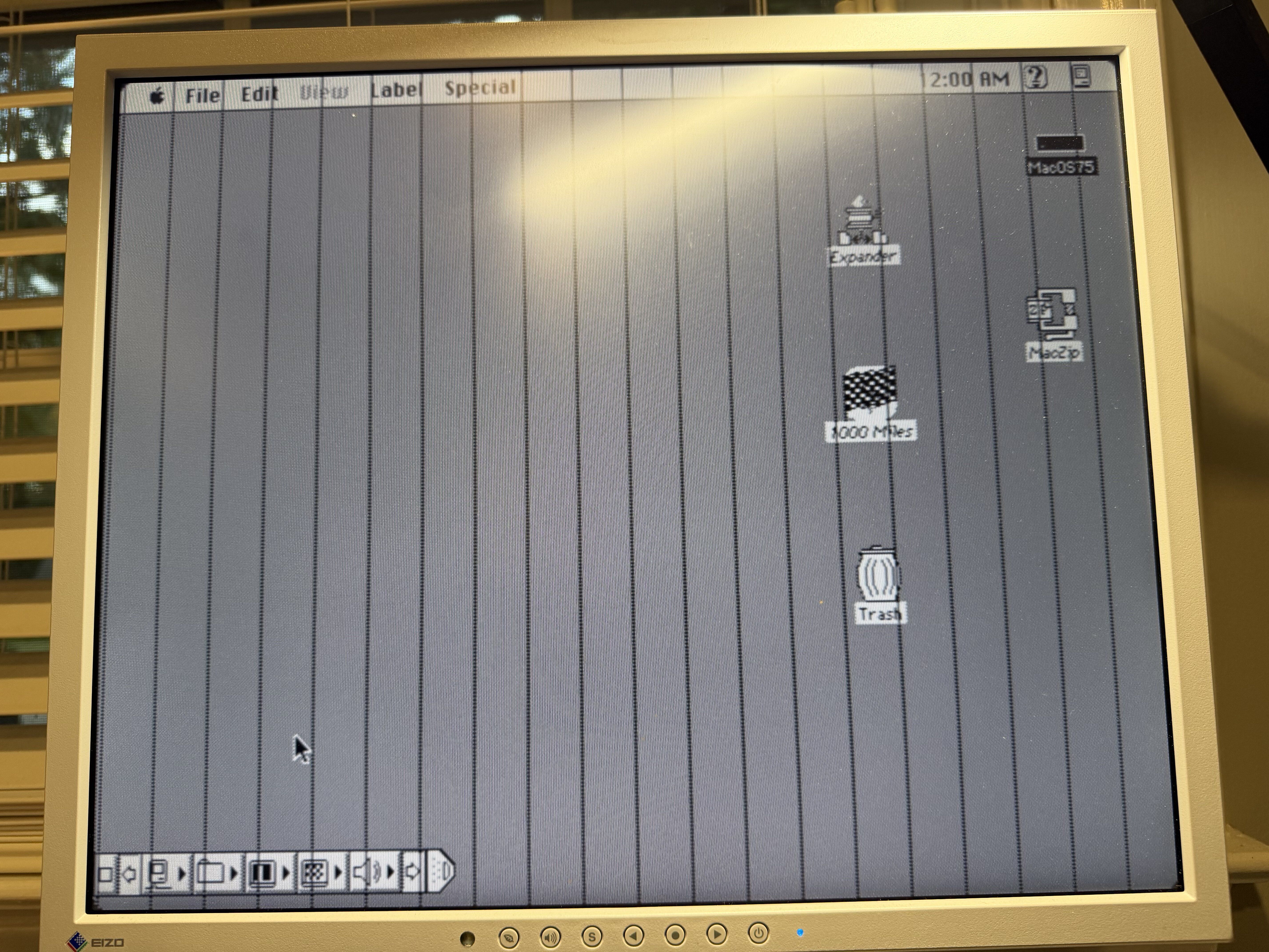

What color depth is being used in the photo? Change it to B&W so we can see which VRAM data lines are broken.
It was set to 256 colors. I did change it to thousands of colors and to grayscale to see it if got better, but it didn’t seem to. I didn’t think to change it to B&W, but I’ll do that tonight and see how it looks.

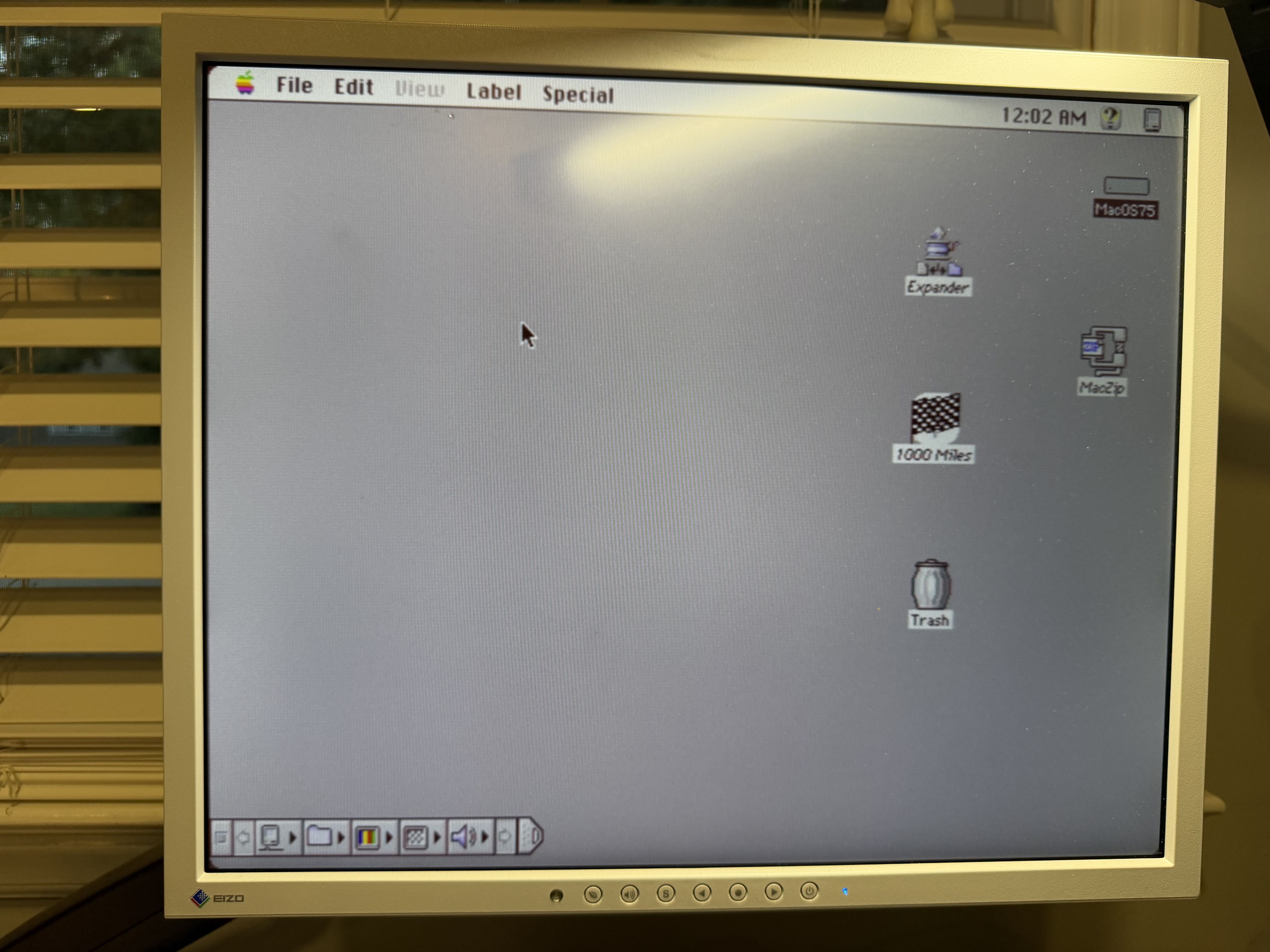

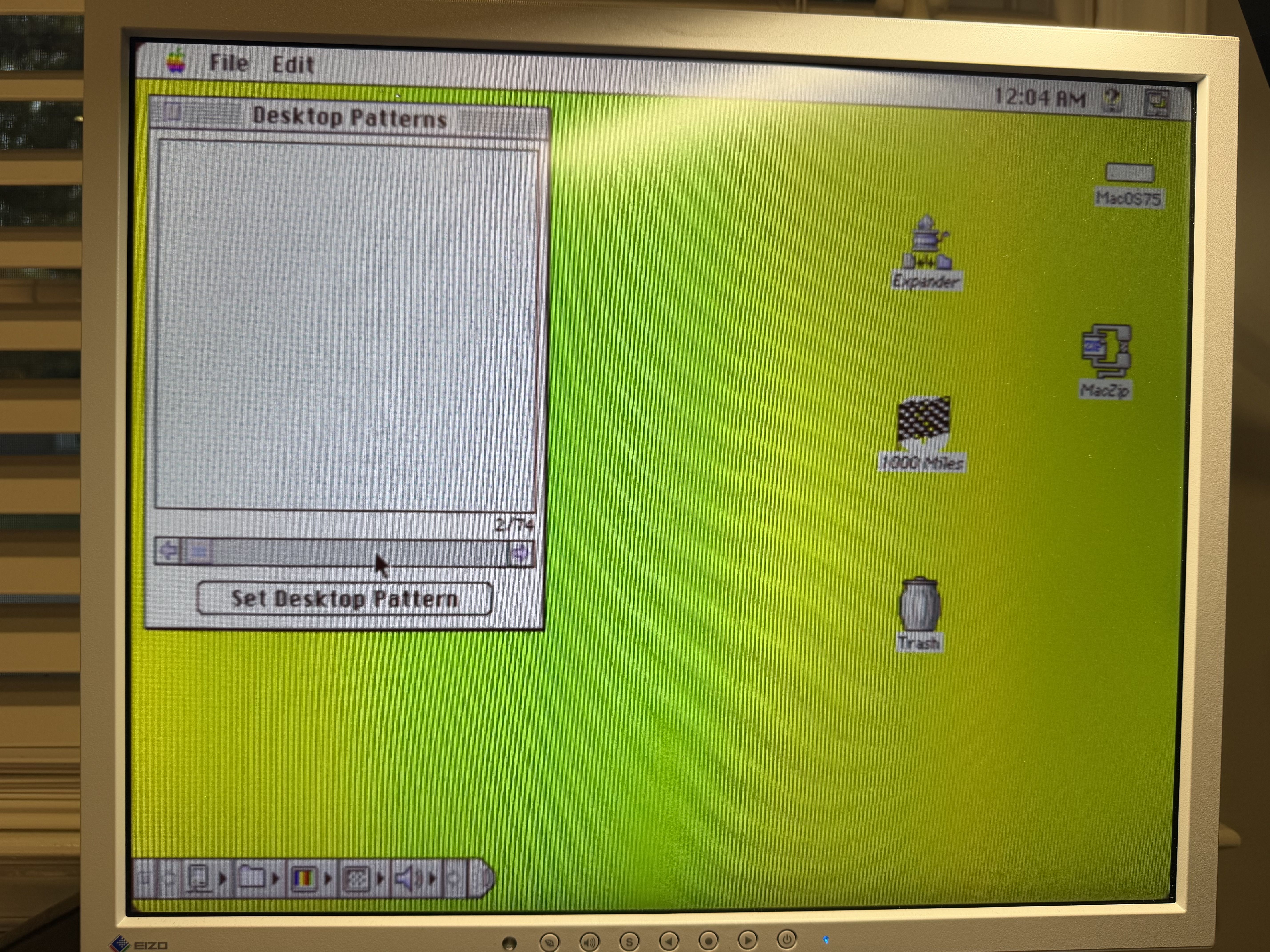

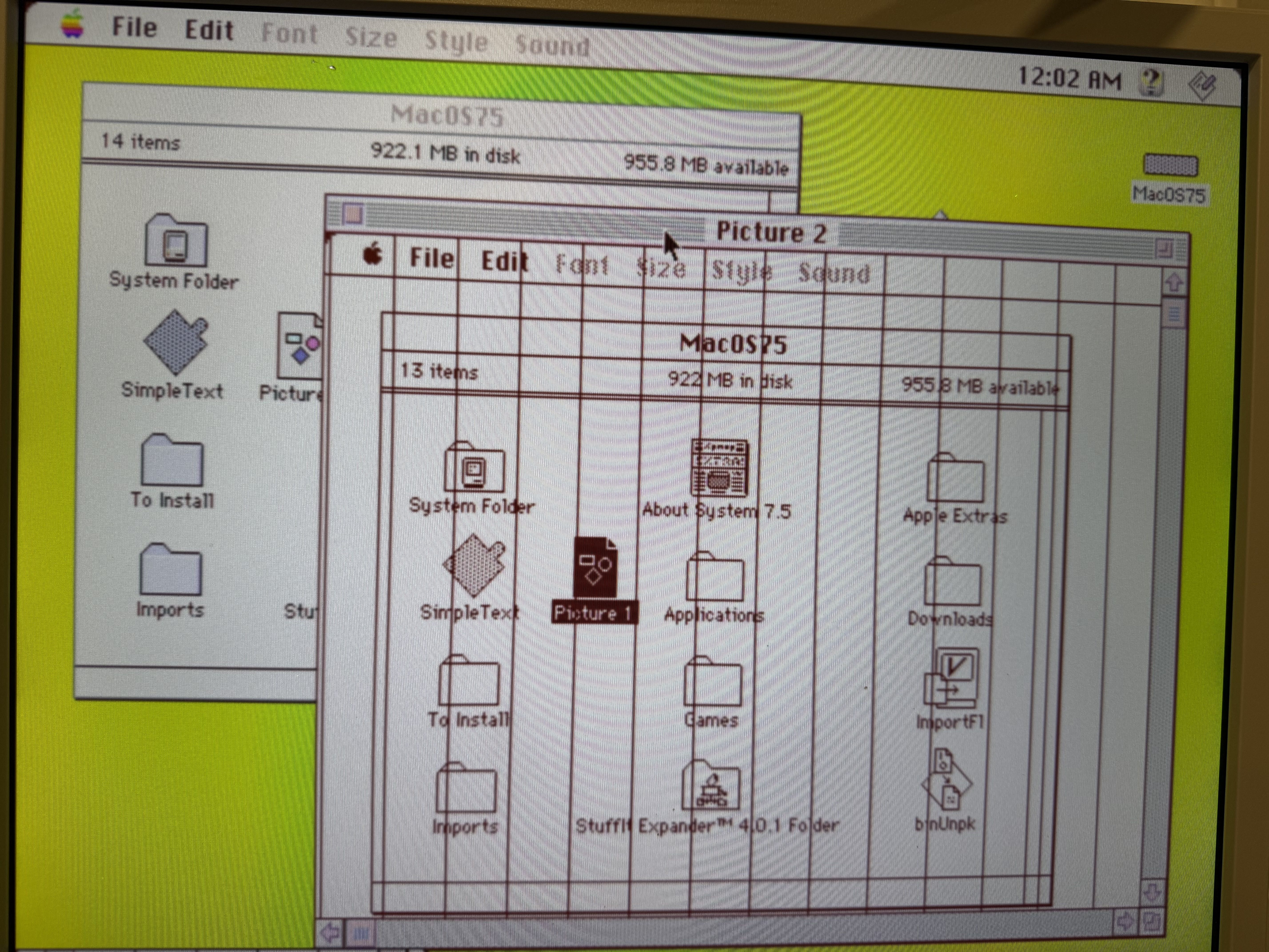

It seems like the corruption is closer spaced the more colors I have (which in my mind with little understanding of how this works seems like it points to some part of the memory being bad opposite. If a certain memory line was bad, e.g. every 8th bit was bad, the higher color depth mean the corruption would be more condensed?).
Anyway, when I have thousands of colors, the repetitive pattern is essentially gone.
black and white:
16 colors:
256 colors:
Thousands of colors:
Thousands of colors with a gradient background:

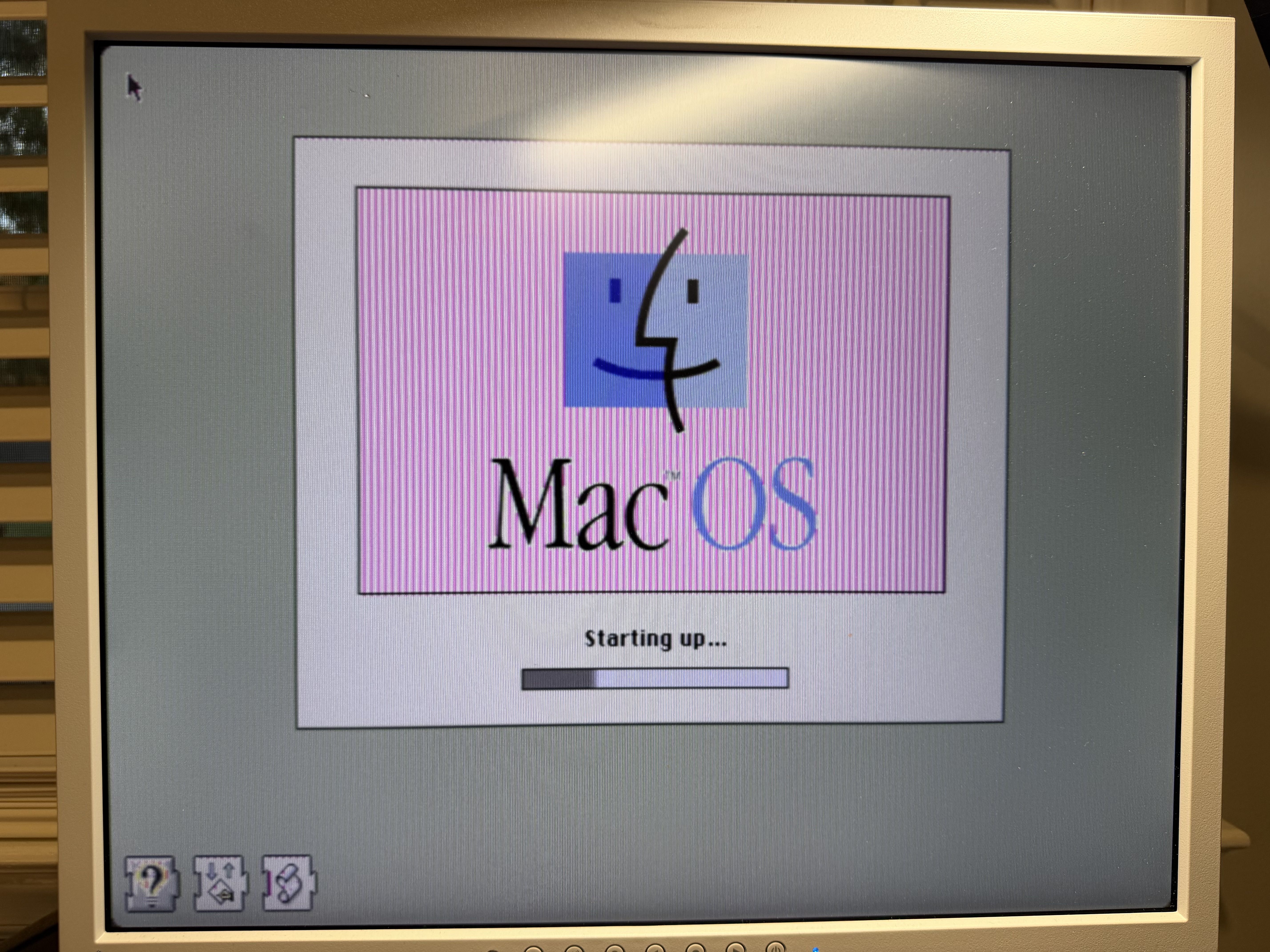

Another thing of note is that when the machine boots (256 colors), it seems like any white areas have pink pinstripes. But light gray areas do not.
I tried reading the schematic that was sent but either I am not reading it properly or the 650 is too different. It does also appear many of the lines from the 343S1091-A chip go to nearby RC3-RC6 chips. All those traces tested good.
Does this help narrow things down?
I forgot about the RC chips. You should be able to see continuity from the Antelope CLUT chip PD[0] - PD[31] pins over to an adjacent resistor chip, and then from the other side of the resistor chip to the VRAM slot. Or from CLUT to VRAM with some resistance.
For the pinout of the CLUT chip see PDF page 8/14 of the LC475 schematic.
For the pinout of the VRAM slot see PDF page 6/14 of the LC475 schematic.
For example PD[0] is pin 11 on the CLUT, and pin 71 on the VRAM. The VRAM SIMMS are 68 pins, so pin 71 is actually in the 2nd slot.
You might need a bodge from the VRAM over to the resitor chip next to the CLUT.

The B&W image indicates a 32-bit bus with D29 or D28 being stuck low.

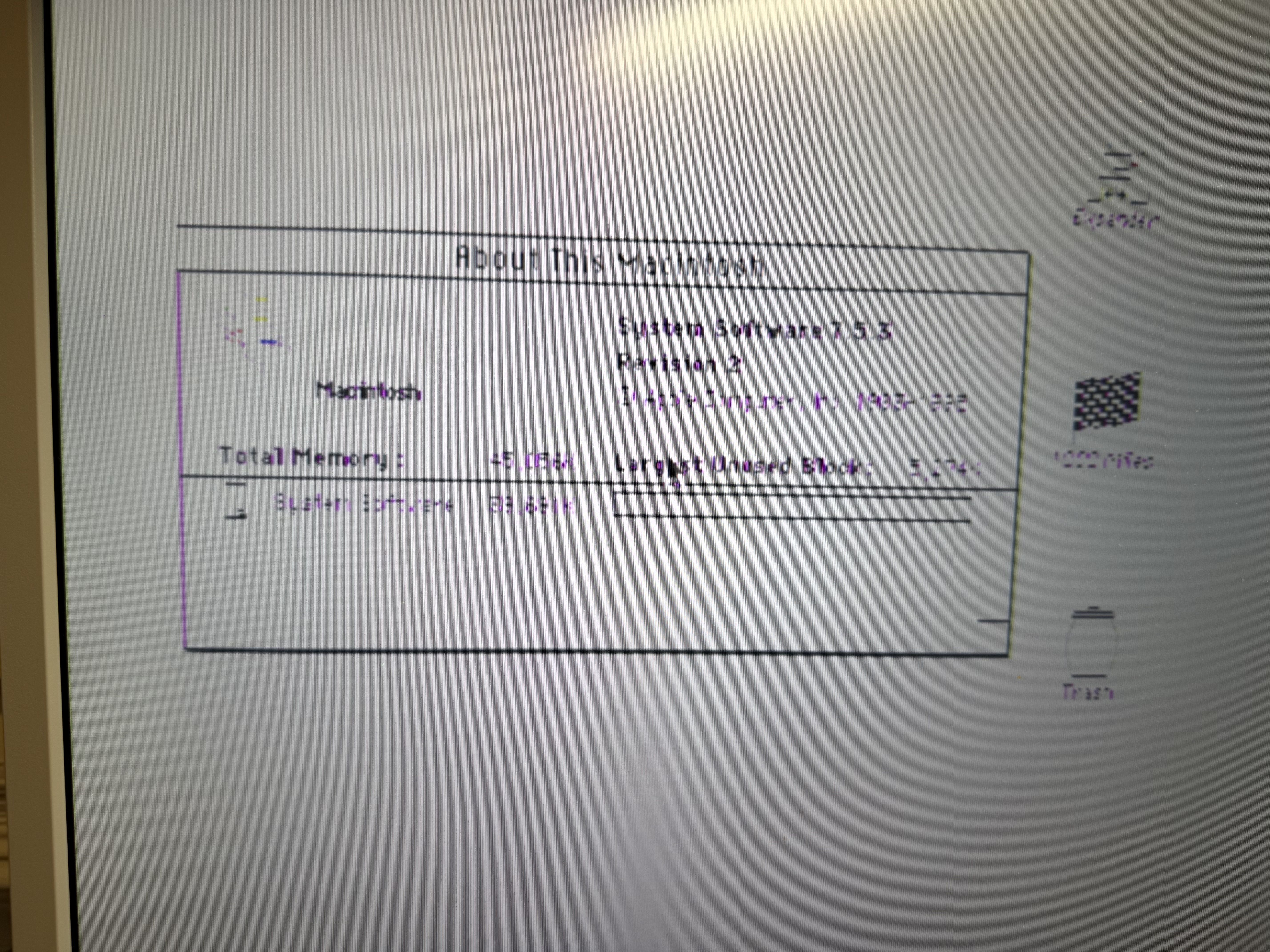

Can you take a screenshot? If the problem is not captured in the screen shot, then the problem is not between the CPU and the VRAM or in the VRAM - it is between the VRAM and the display output.
I would have to look at a schematic to know the actual names of the signals/traces.
I didn’t think about doing screenshot. I assumed it was something on the output side.
Since the lines show up in the screenshot, this means it’s between the CPU and the vram (or the vram itself)?
