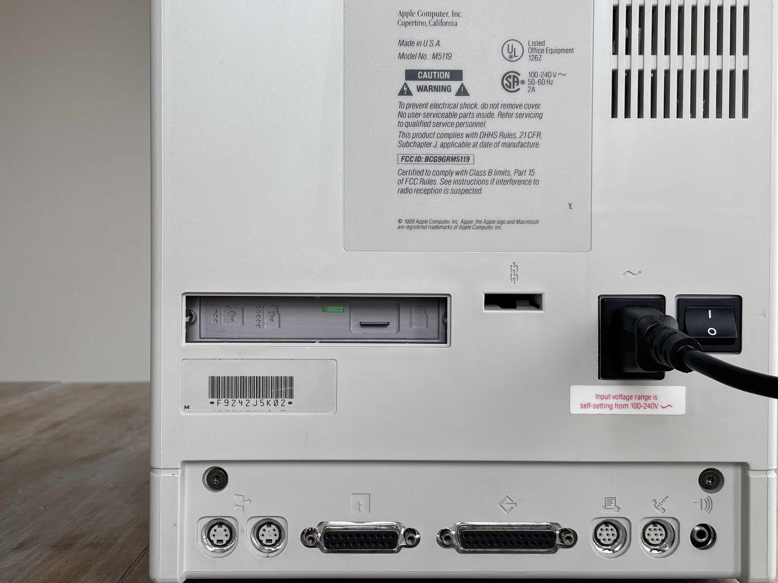

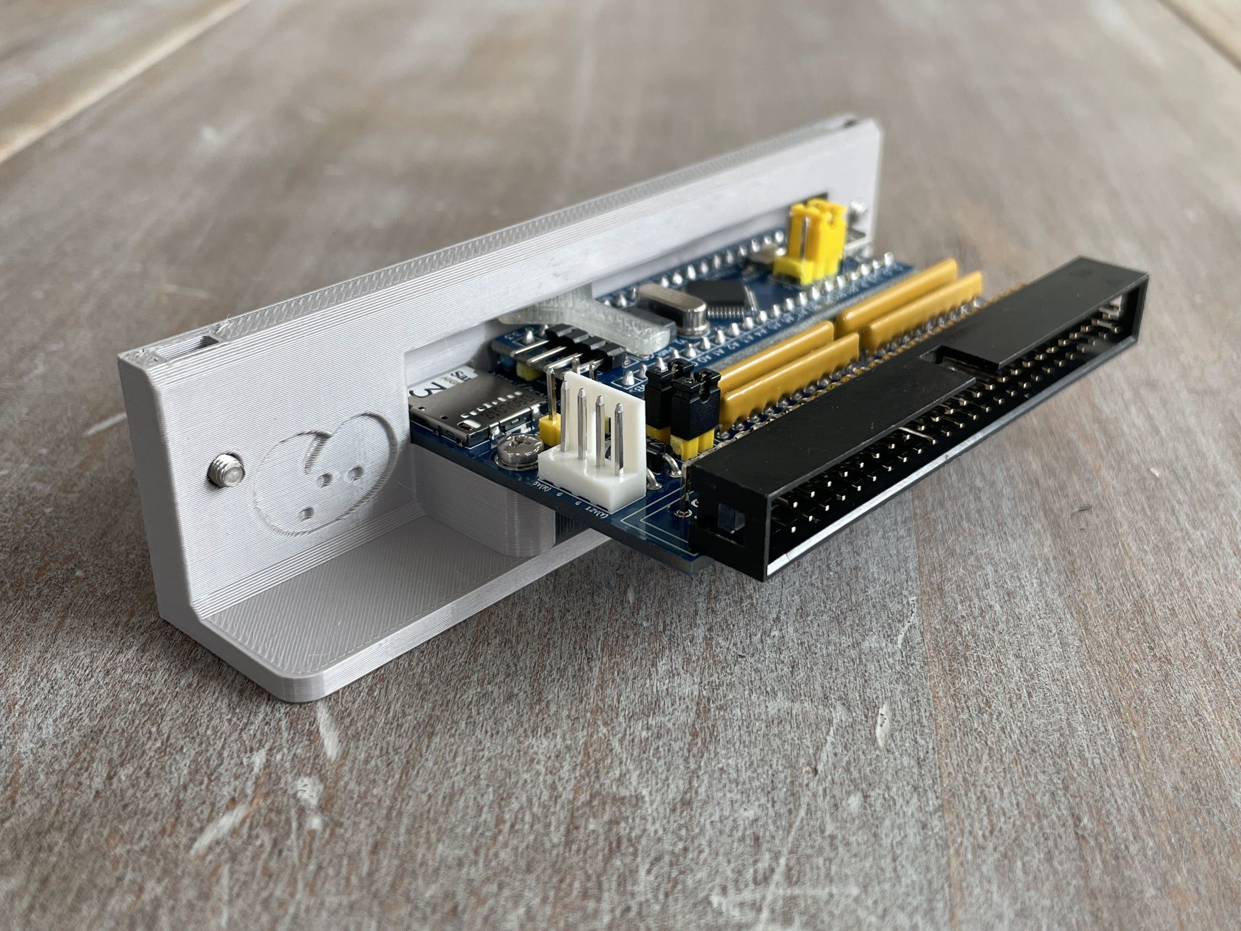

I'm very excited to finally release my latest printed bracket design, which mounts the BlueSCSI 1.1a in the Expansion Slot on a Macintosh SE or SE/30!
The main goal of this bracket is to make the microSD card as easily accessible as possible, while keeping your Mac fully "enclosed" (e.g. with no obvious holes in it). The microSD card "sticks out" as much as possible while maintaining a 0.8 mm wall (which is about the thinnest that you can go with a 0.4 mm nozzle). Because of the recess of the Macintosh SE bracket in the case, it's still not super easy to get the microSD card out. I can work it out with one finger on each side, but tweezers do make it a lot easier. Reinstalling it is a snap - I have no trouble installing the microSD card with my bare hands. An ejector-style microSD slot might help this, if you're building your own BlueSCSI for this application.
Also features:
Flush fit: This printed bracket sits flush with the face of the Macintosh SE bracket for a clean look.
LED Light pipe: Very useful for troubleshooting microSD card and image issues. The light pipe uses a simple press fit. In a well-lit room, the red LED is pretty dim, but the green LED is nice and bright. I also made the lens on the light pipe the exact same size as the activity LED lens on the front of the Macintosh SE. It's all about the details!
Blink code indicators: What does 3 blinks mean?! The glyphs on the bracket tell you what you need to know.
Extra hard drive screw storage: When you remove your old failing SCSI hard drive to replace it with a BlueSCSI, you can attach the screws to this bracket. That way, when you stumble on an Asante Maccon Ethernet card, or maybe a Micron Xceed videocard (heavy breathing), you'll have the original hard drive screws waiting and ready to move your BlueSCSI to the hard drive bay.
M3 nuts slotted into the bracket! M3 nuts inside the bracket mean you can snug the M3 screws down nice and snugly. Yeah... that's not going anywhere.
Potato: It has a potato on it.

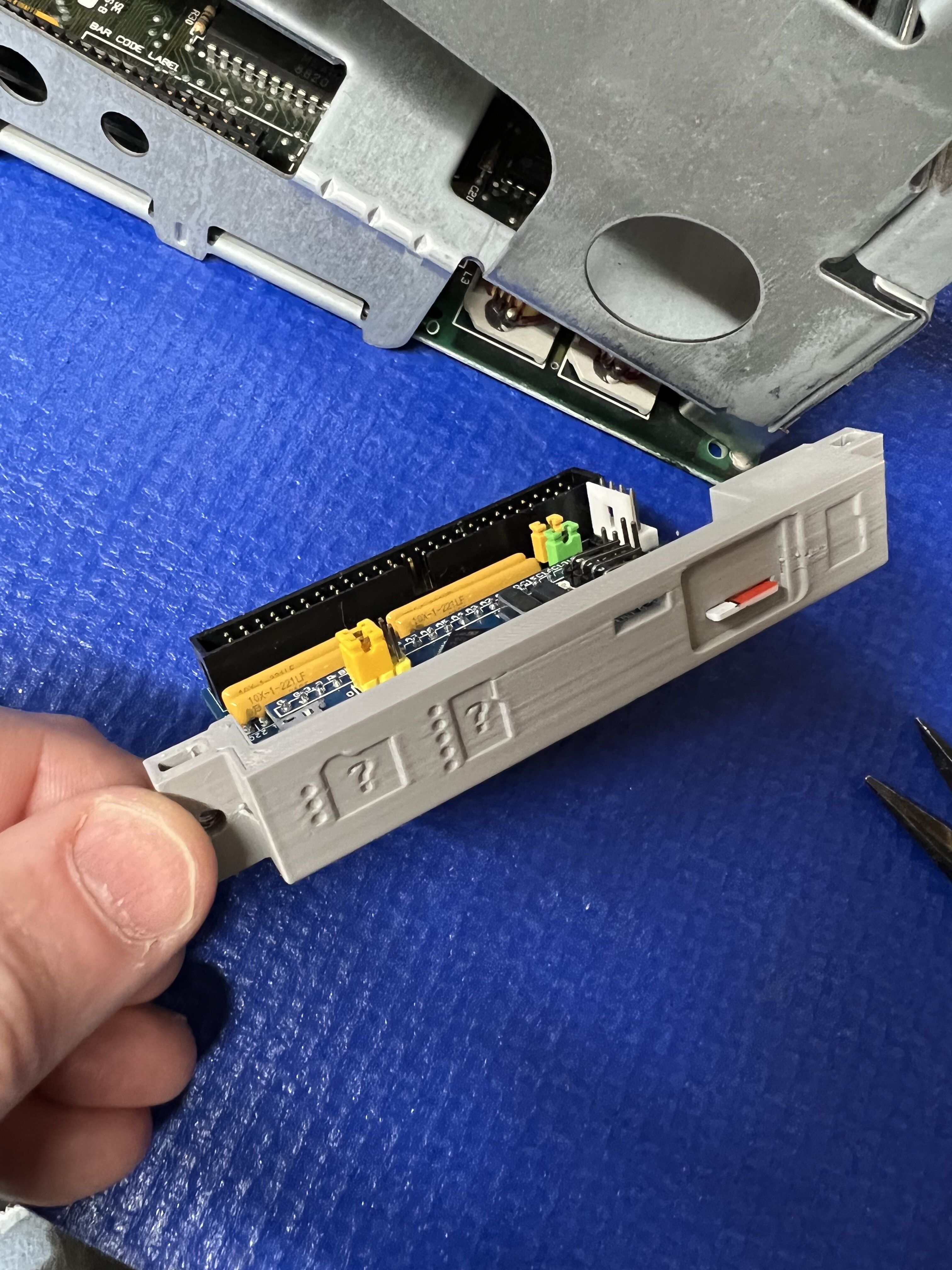

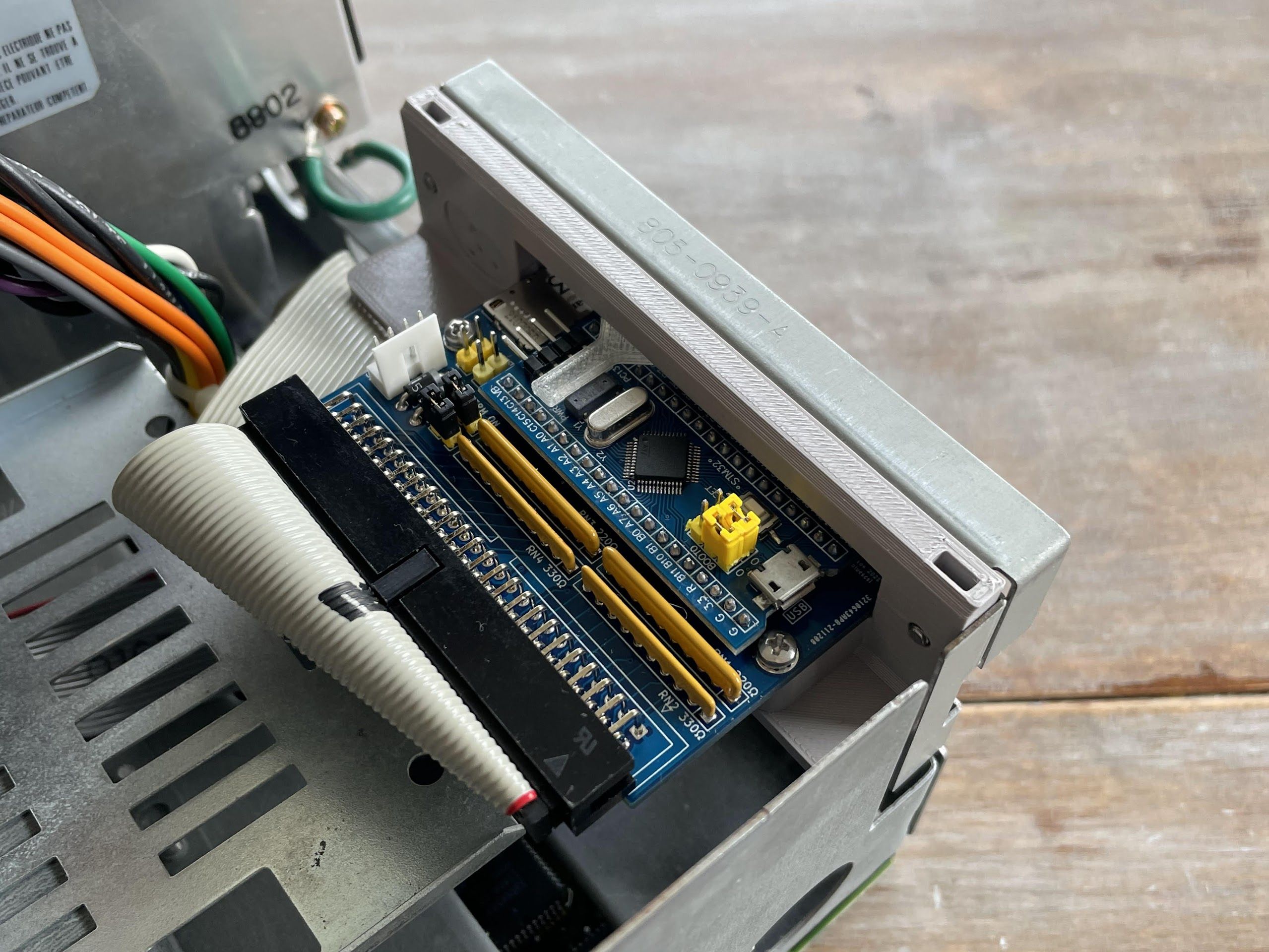

Hey @PotatoFi what do you think of this:
4C2F3F0C-5EF0-4265-B116-C77226C454A1.jpegB0FDF838-153A-4B15-AEBE-AFEF507BEFFF.jpegFFA6CAC0-5406-44BC-BE08-C61D30791574.jpeg0D7234AB-E1F9-4748-8934-A7D3D56486CF.jpeg

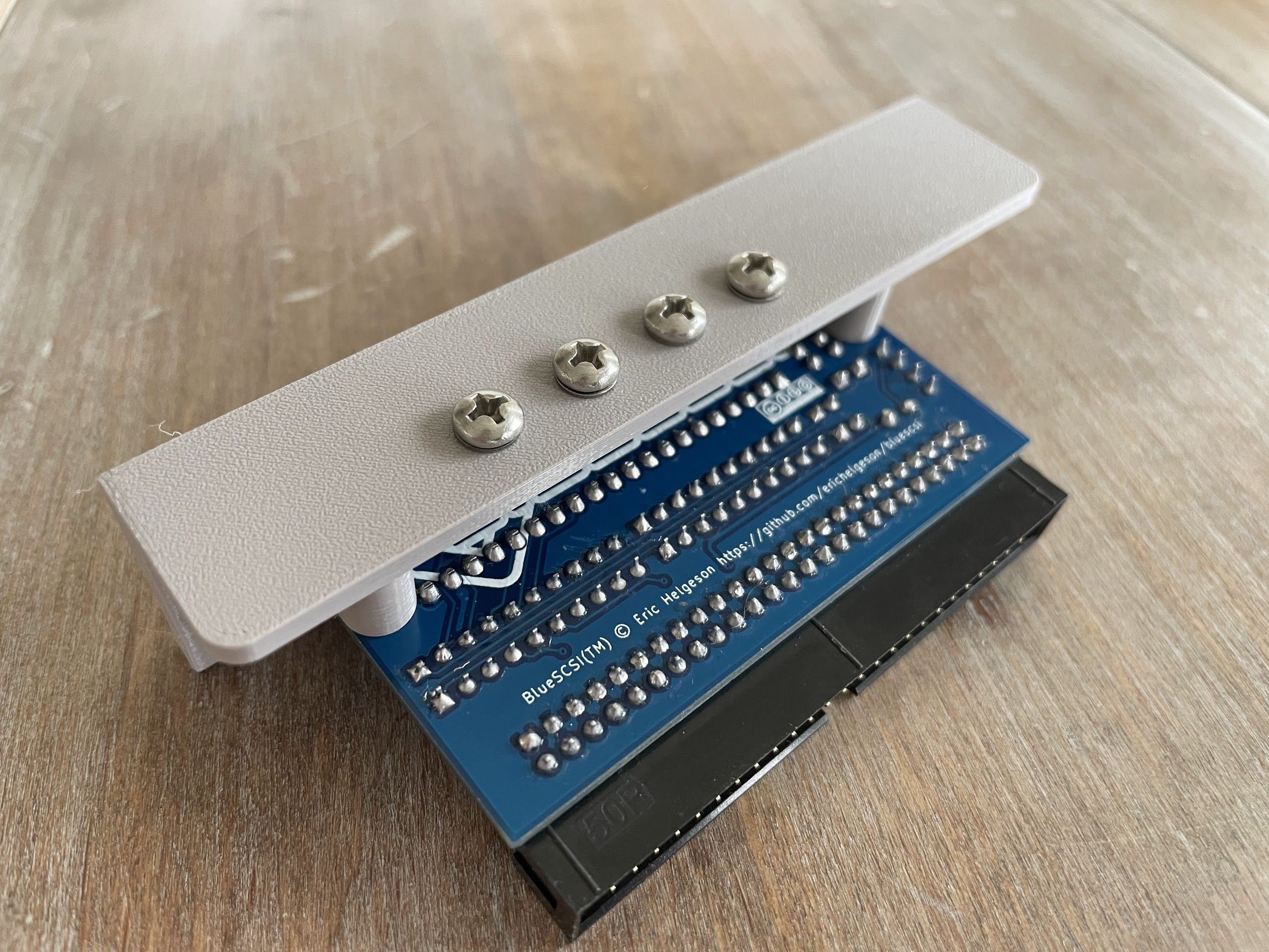

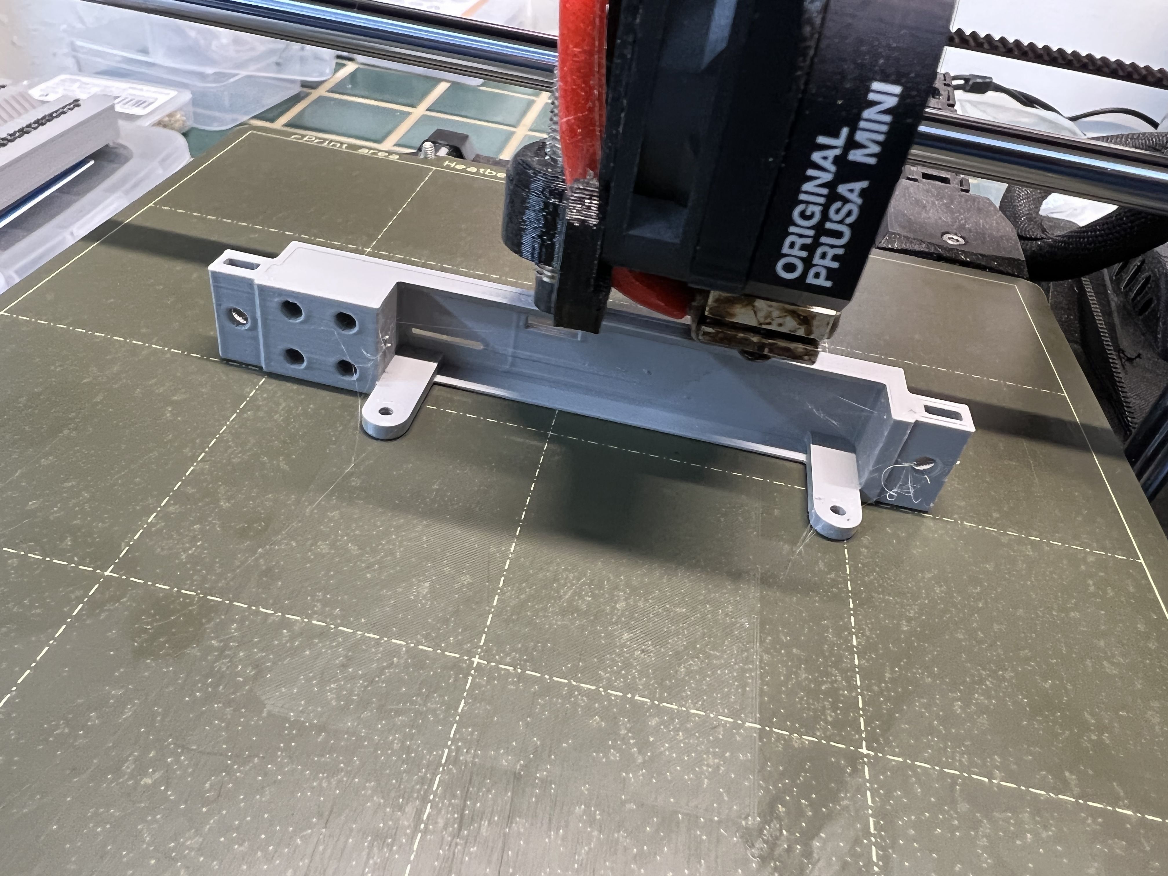

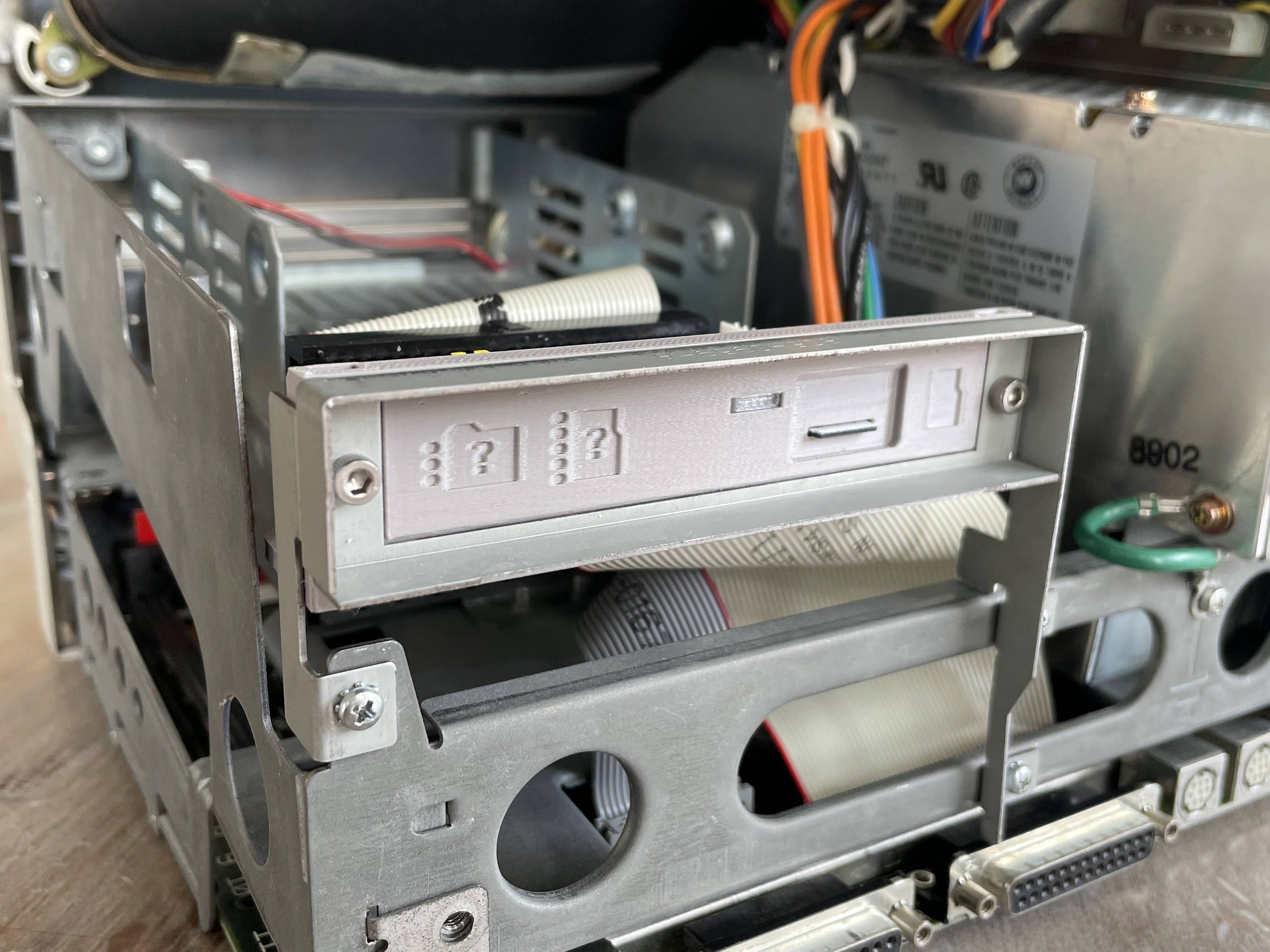

For a while now I have been playing with your designs, making adjustments for different versions etc. but I started thinking about reverse mounting. . . instead of securing it from the inside, I pushed this through from the back and the screws go in from behind!
Of course, this results in a flush-mount. My first iteration had plenty of horizontal tolerance so I tightened it up a bit. The card itself is still really hard to grab, but at least it is not recessed that extra half inch. I don’t have the light pipe installed yet.
If you are interested, I can share the STL file—I am just messing around in TinkerCAD. The main points are:
  • The face extends 13mm back from chassis expansion port screw holes (the metal box)
  • The whole thing is a mere 16mm high which clears the metal “box” around the expansion port
  • Trimmed left and right sides around the nut capture channels so it slides into the “box”
  • The existing thickness of the nut capture holes is fine mounted on the outside—as this clears the plastic back case no problem
  • There is a compromise with the bluepill jumpers—go much further out the back, and the jumpers may not clear the expansion “box”. They need to be on the inside of that.
  • The mounting screw holes/arms for the PCB have just enough depth to grip the screws
  • I needed to clip the protruding header pins (yellow header block) off the bottom of my BlueSCSI along the back edge. These are the pins that hold the microcontroller to the bluescsi board. I could have mounted them in reverse, but then they would stick up. In any case, clearance is tight under the board both to fit the bracket and not ground out on the chassis
  • I mounted the BlueSCSI to the bracket before attaching the bracket to the chassis. the outside M3 screw is tough to reach from the inside, but removing the expansion bracket itself (just the one philips screw directly below) lets you swing it up a bit
  • <edit> OH ALSO, I kept the four HDD screw holders and moved them to the side (see the four holes on the printing photo)
  • <edit> And of course, I love what you are doing with the little icons to be consistent with SCSI, ADB, Serial etc.
Thoughts?
