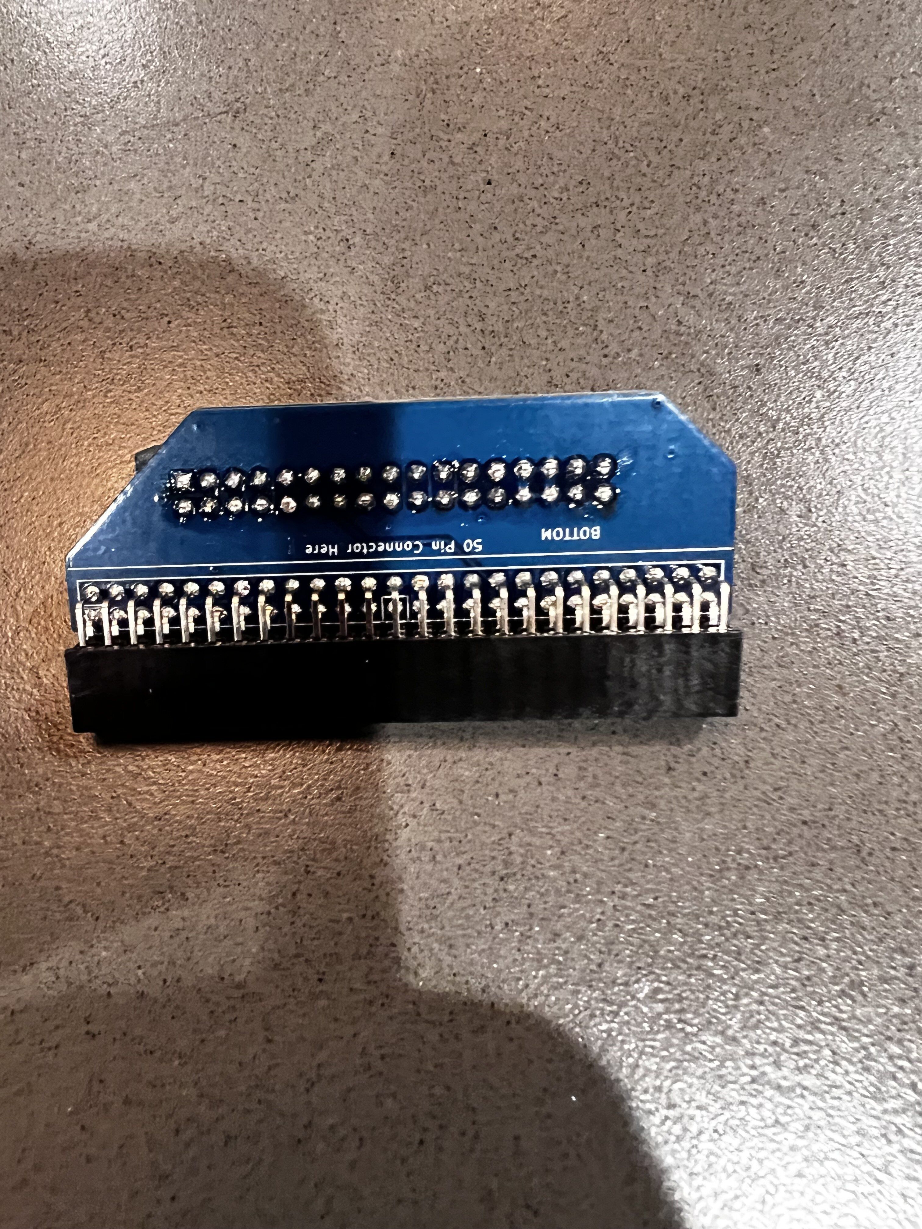

I am using no special configuration (Mac Plus) and a self made adapter (some pics in the Resources section of the forum).

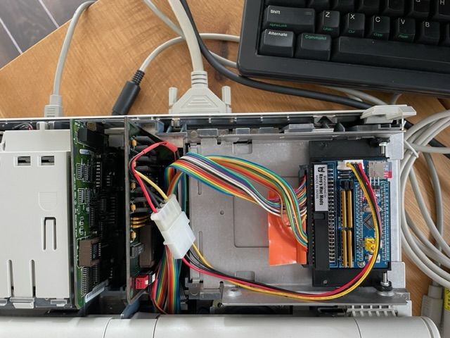

I have BlueSCSI first series installed in my non back lit machine with 5 Mb of RAM. Running 7.5.3.
Before I had a SCSI2SD 5.1 and the machine would systematically crash upon waking up from sleep.
With the BluesSCSI things are much better, still it occasionally crashes. Can’t observe any pattern, though.

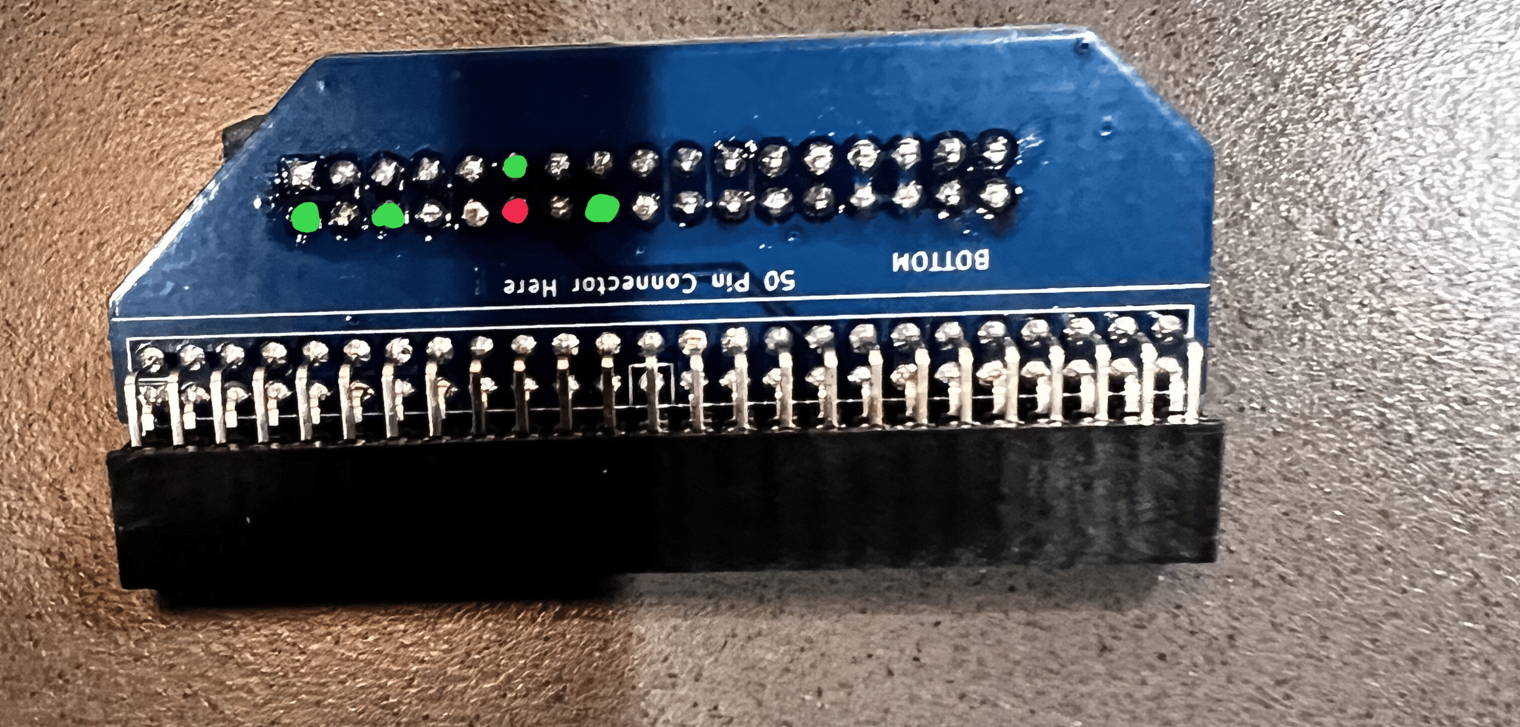

Well, I hooked up my SCSI debug board in between the Portable and the SCSI emulator and somehow just having that connected makes the issue go away. Now I just need to see which component on there is doing it, because the only things connected are a diode, power LEDs, and passive termination that shouldn't be enabled.

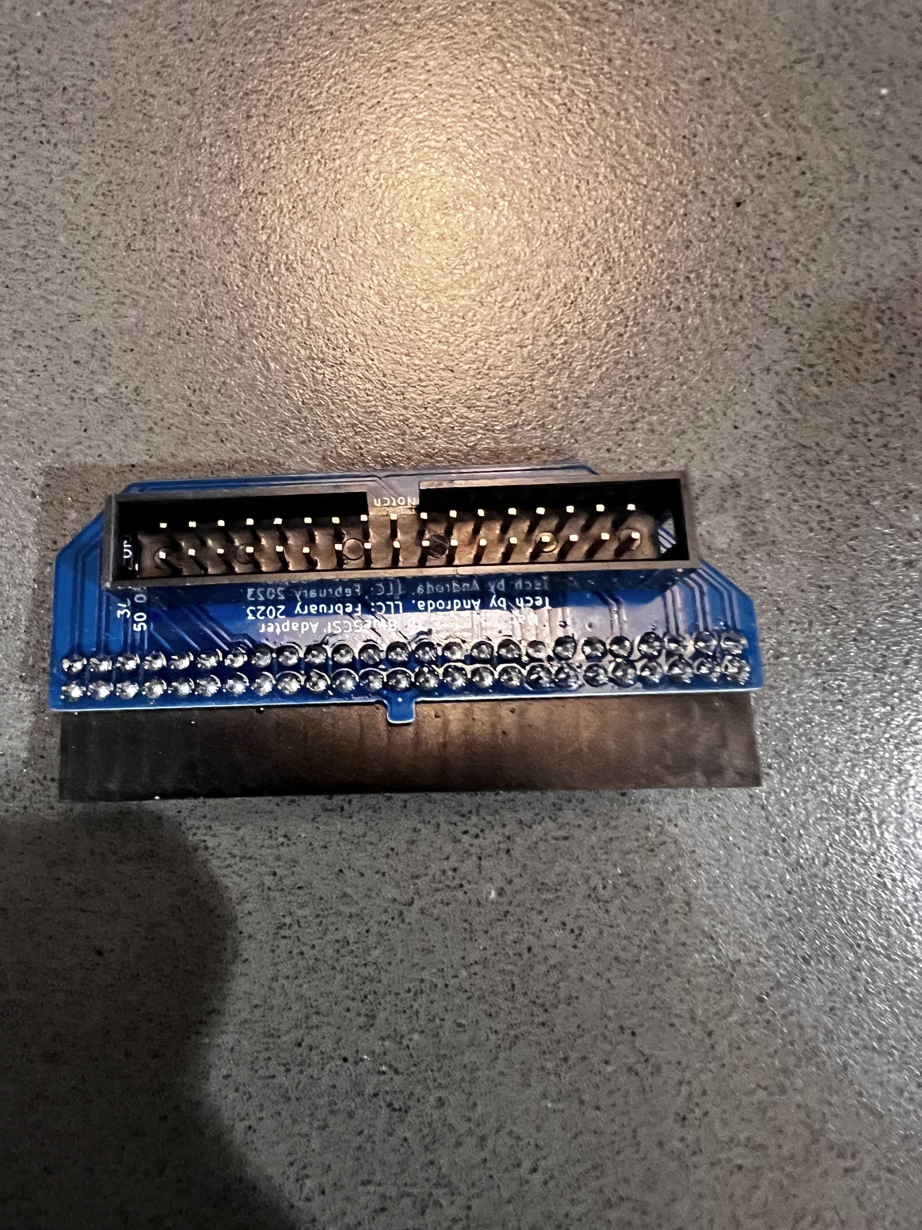

ok I can try. I need to know which pin to add the cap (select pin) and find a gnd pin to connect to. This is the one I have: https://androda.work/product/bluescsi-v2-desktop/
