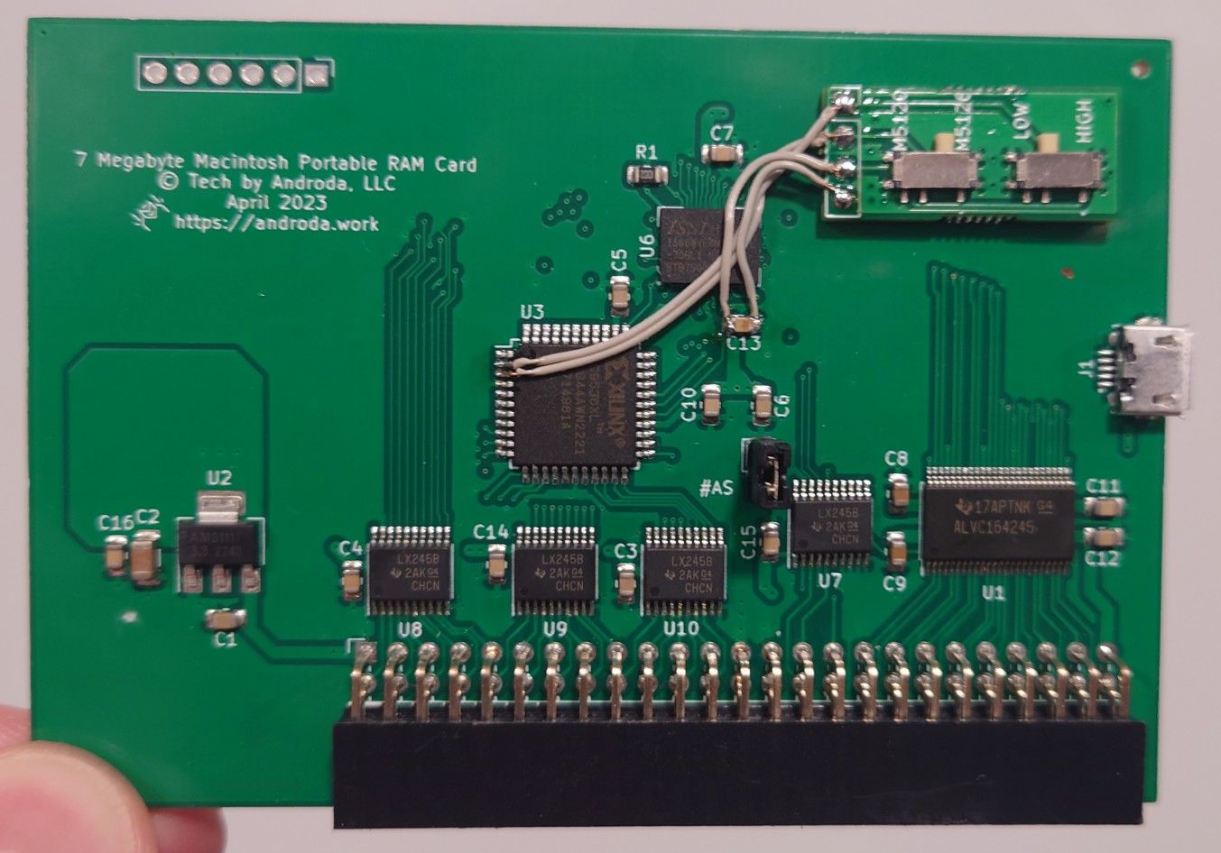

OK, the mod boards arrived and they look pretty nice. 4 wires to points on the card and it presents the four RAM size modes listed before.
Reactions: Sideburn and alxlab
The RAM card listing in my shop has been updated with a dropdown.
Basic: No switches, always 7 megs of RAM (Except M5126, that one sees 3 without a jumper wire)
Switchable: Reworked boards similar to the above picture, until I run out of these and then all in the future will have the switches by default.
ReworkService: If you want to send your card back to have the firmware updated and switches installed, this is the option for you.

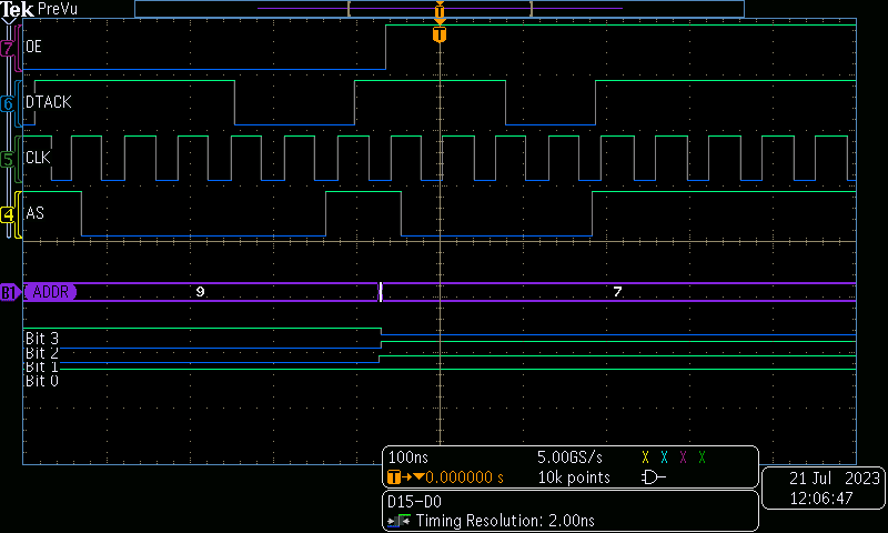

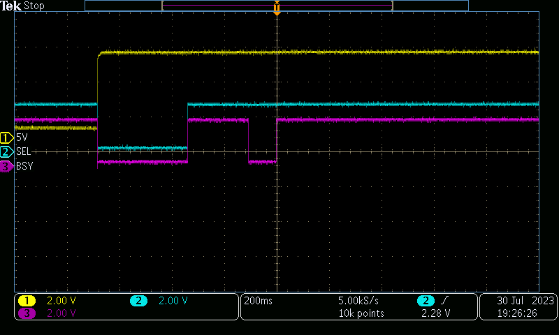

Just got my test boards in, still need to do some more experimenting but:
Here's the 7MB card after sleep with manually generated /DTACK:

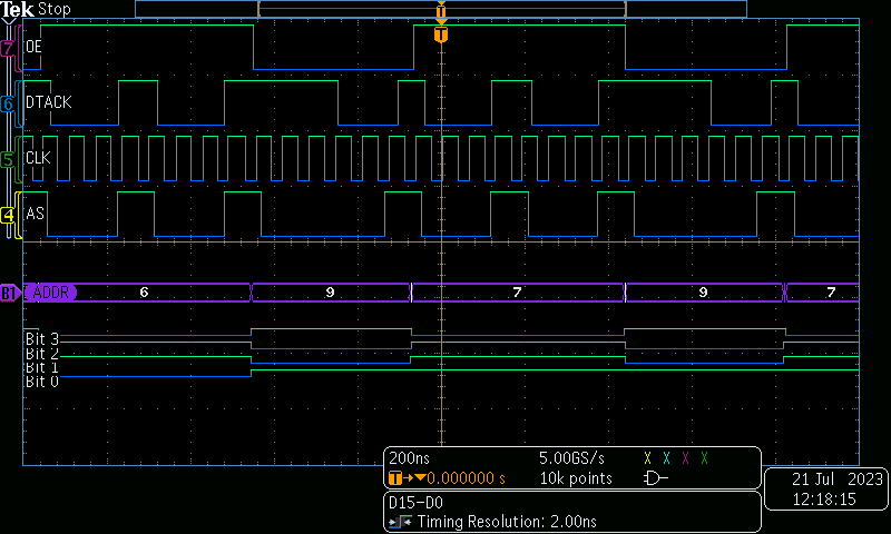

You can actually push it even further since the RAM is fast enough by generating /DTACK even sooner:
Still need to get around to doing some testing with the BlueSCSI.

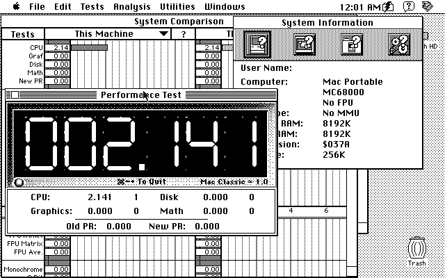

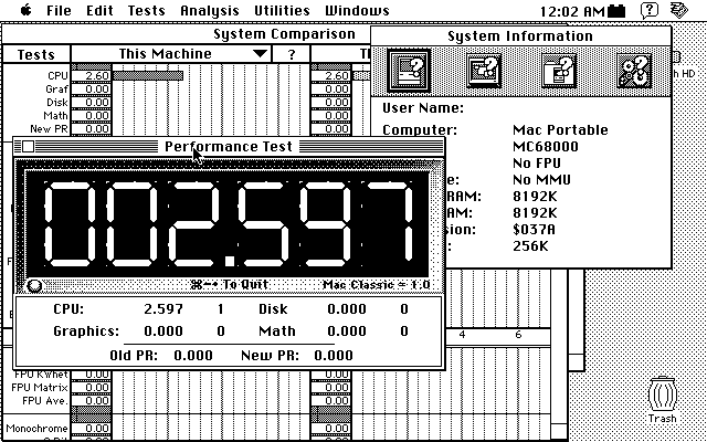

That's pretty cool, free CPU accelerator from simply running the expansion RAM faster. Maybe I can stick that into the CPLD somehow, another pin for great acceleration...

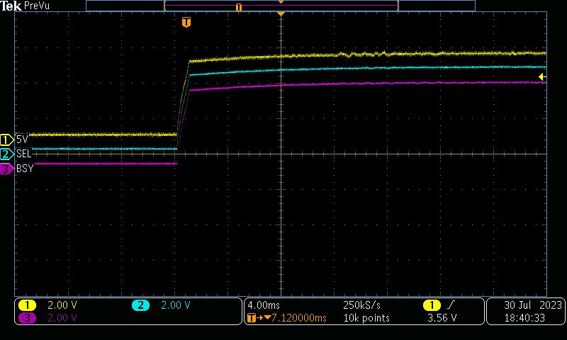

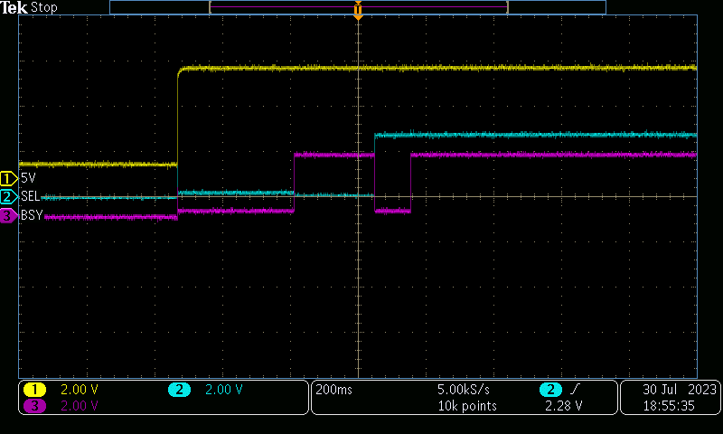

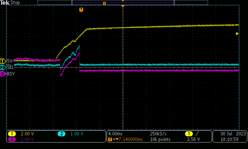

So I did some more testing with the BlueSCSI v2, and I believe the issue is the transceivers or buffers are asserting control lines as the SCSI controller initializes, because the SCSI controller initialization is happening before the RP2040 finishes initialization.
Here's the BlueSCSI v2 startup:
Here's the original Conner drive for comparison:
Zooming out a little on the BlueSCSI from wake:
It's around 330ms until BSY de-asserts. I believe that's around 5 million clock cycles at 16MHz, or maybe 200,000 CPU instructions.
Here's what happens with another device on the chain providing termination externally:
The moment the BlueSCSI gets power, the transceivers assert the control lines.

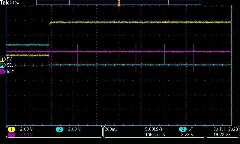

And for another test, here's what happens when you have another device on the chain, put the Portable to sleep, disconnect the BlueSCSI then wake from sleep:
If you reconnect the BlueSCSI at this time, everything works as normal.
I'm guessing if you could just keep the transceivers/buffers from asserting SCSI lines until the RP2040 is ready or delay their power up, it would likely resolve the issue.
This is basically what I expected. The RP2040 microcontroller designers made the rather strange design decision to put all IO pins into "pull down" mode at chip startup. This means that the control line (not data) transceivers pull lines low until execution enters our userland code out of the RP2040 framework.
