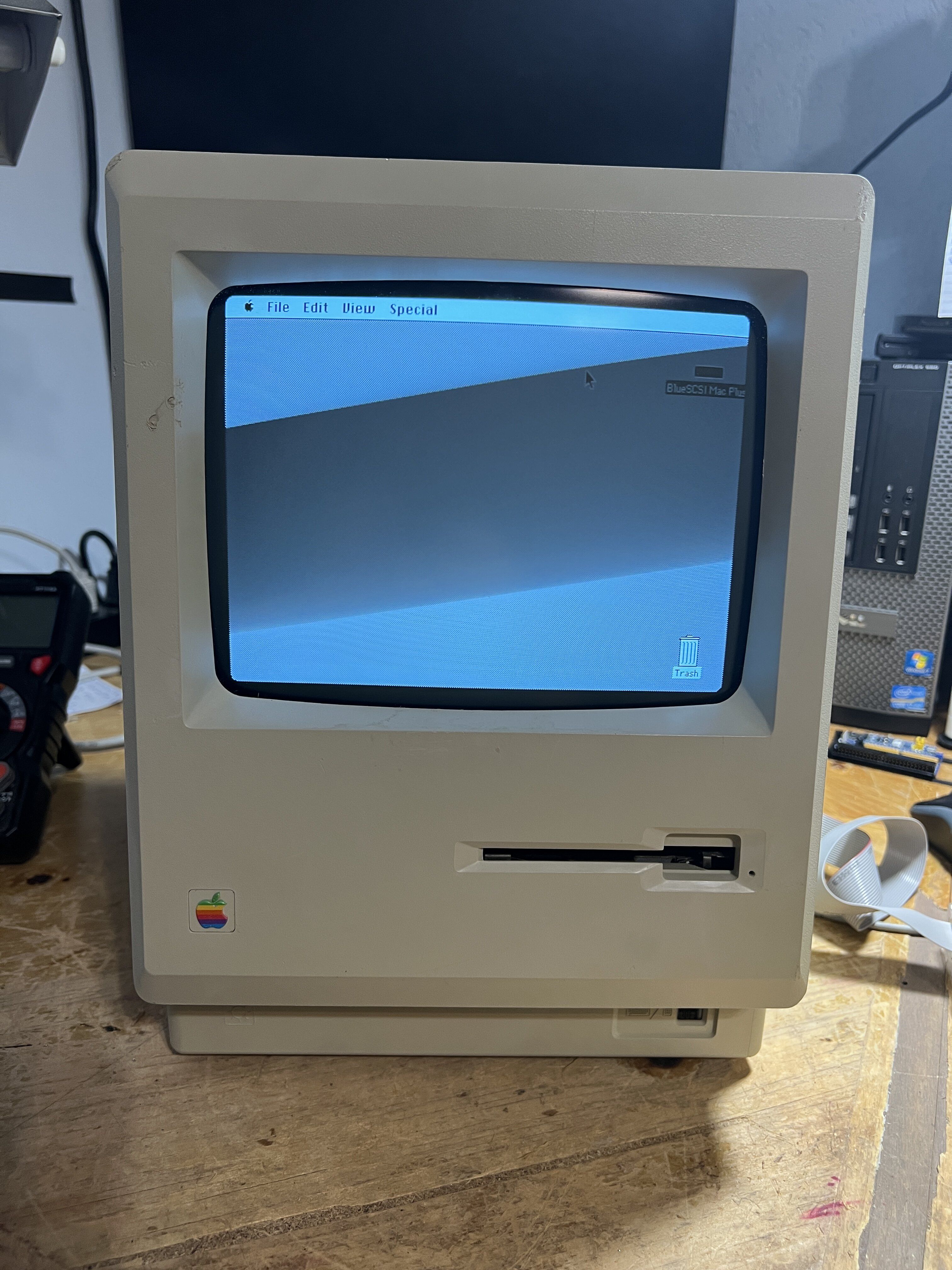

Eric does the blueSCSI work with MacSnap scsi? I got a 512K unit today with this in it with the Plus ROMS as needed. Tried it but it would not boot up. All I got was the red light on the blue active.
thanks
So I tested blueSCSI with the MaSnap scsi and at first, would not work. Added an external usb power to the blue pill and it now boots up fine. Will need to try some more things with it. So I have a 512Ke with MacSnap, Plus 128K ROMs V2 1mb Ram and a 400/800K floppy in it. Nice. I have another logic board 512Ke with the plus ROMs on it but the flyback on that analog is bad so can’t use till I get the analog board fixed.
That is correct. The Mac 128k, 512k, and Plus do not provide the 5v termination power through SCSI. That is why you need to use USB to power the external BlueSCSI. :geek:
On the Mac Plus, there is a way to add a small part so that it will provide the 5v termination power through SCSI. Let us know if you need more information on that.

On my plus I added the resistor for it to work.
I have recapped the analog board but it’s the flyback had that bad smell of dryer or ozone after a few minutes on and I get no picture. I get the chime but screen black and no current comes out of the flyback. There is no discharge spark after it being on.

Here some pics.
The flyback transformer, aka that big black thingy on the analog board, right? IIRC, @Kai Robinson did order a new one from Dalbani. I will try to find the right part number.

@Willj, this should be the right one:
Here is information from Mac GUI on replacing the Flyback Transformer.
Thanks. I found them also and they are close to me in Miami so will be easy to get and ship to Cayman Islands. Just need bunch other items also like the 1N4150 and the BU406.
