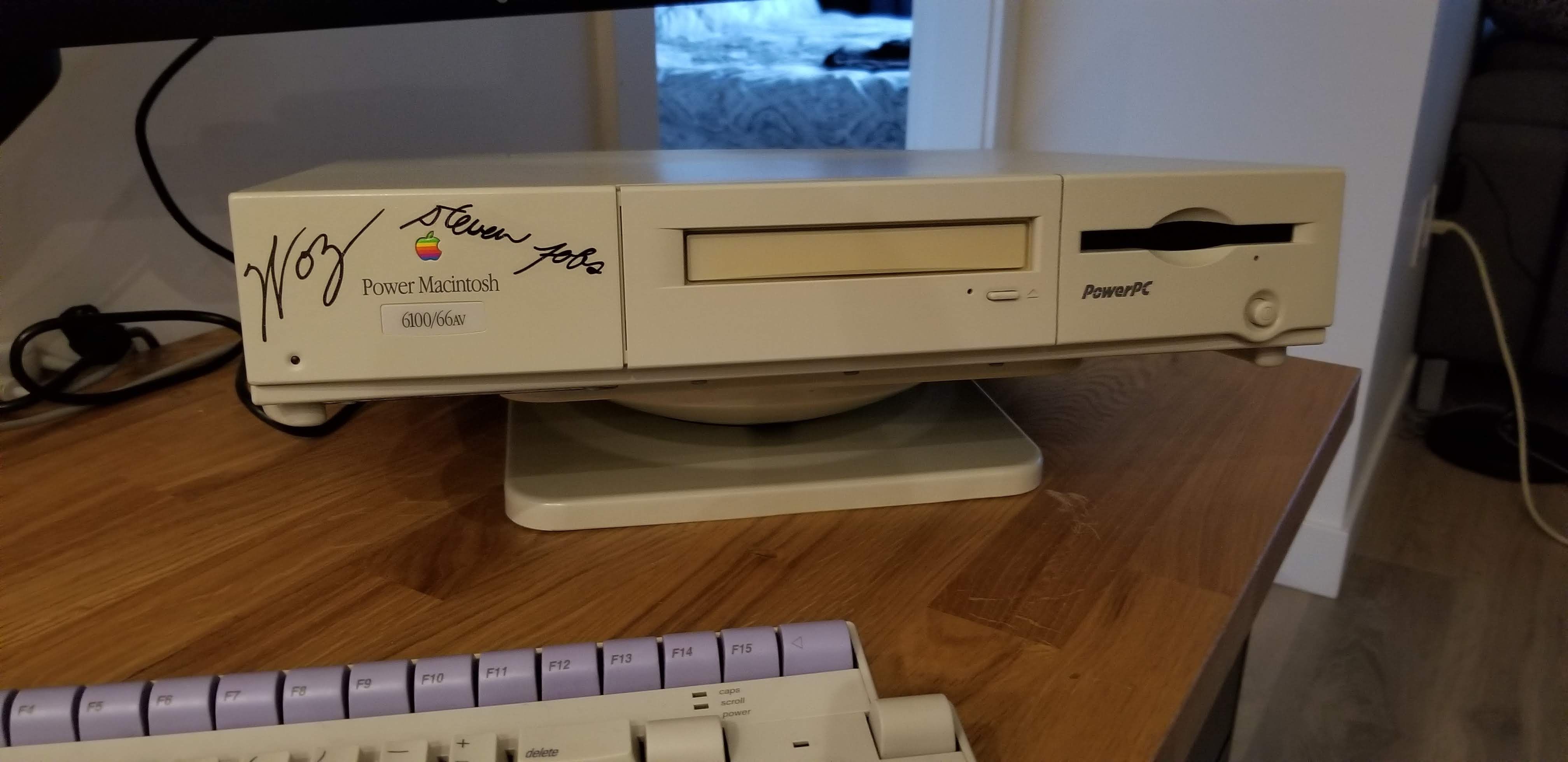

Powered only by SCSI cable and totally legit signatures!
