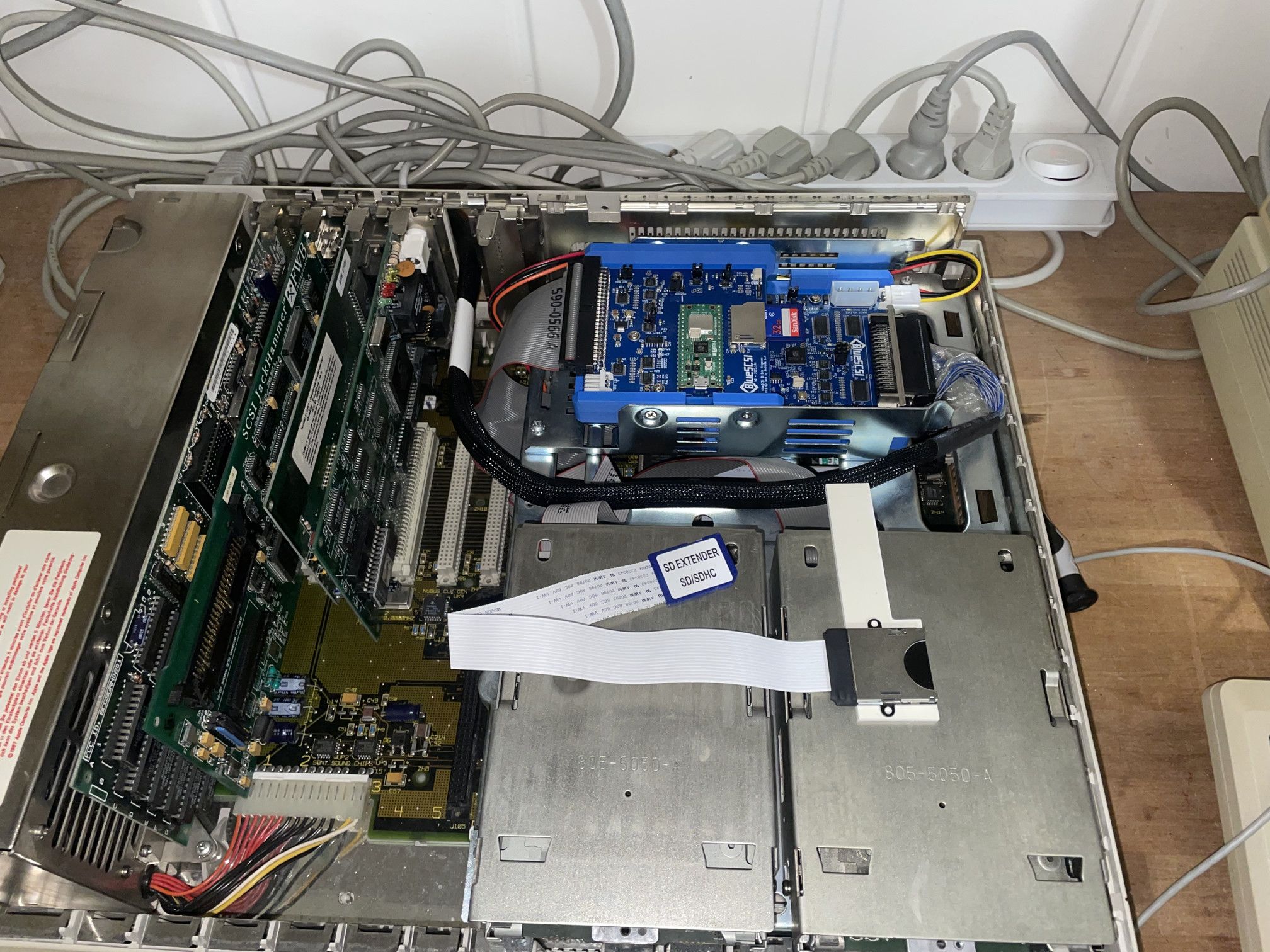

The only "problem" with that is that I have to screw the BlueSCSI UW lose to reach the SD card. With switching the both cards, the internal SCSI cable is too short to reach the BlueSCSI V2W. To fit both cards in the IIfx, I clued two Heavy-Duty Trays together in a way it fits nice in a slightly modified drive rack.
I do use a USB extender in my SE/30, but that one is shorter (30 cm) and connected to a BlueSCSI V2W. No problems with that. But a longer one on the BlueSCSI UW is not a recommendation.

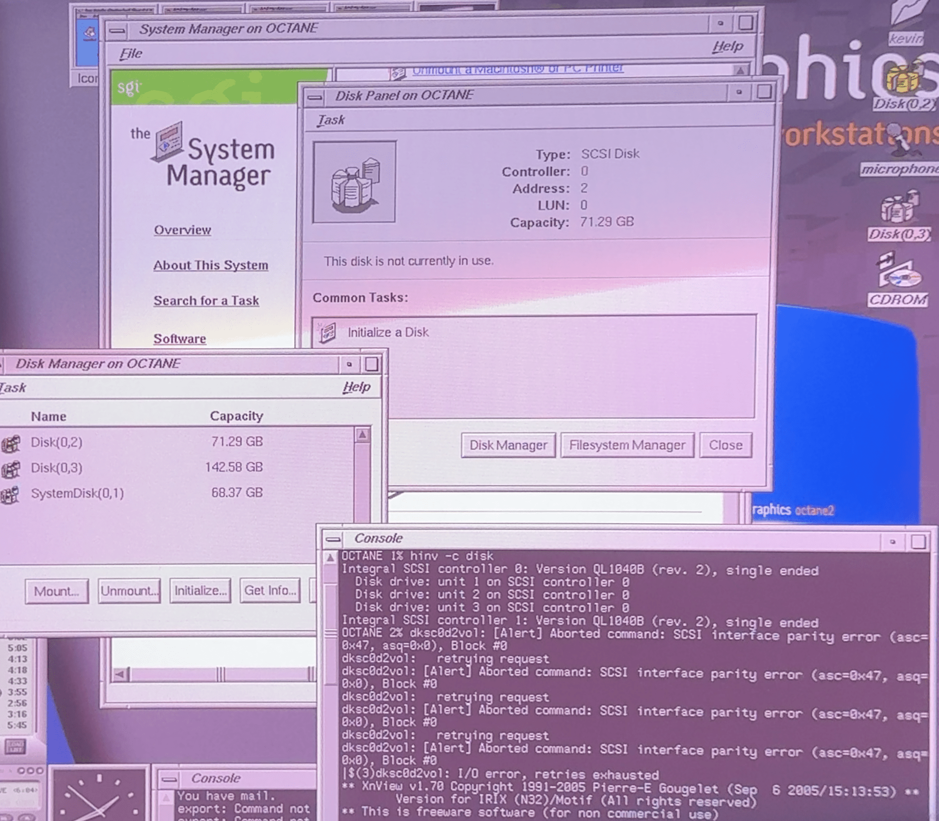

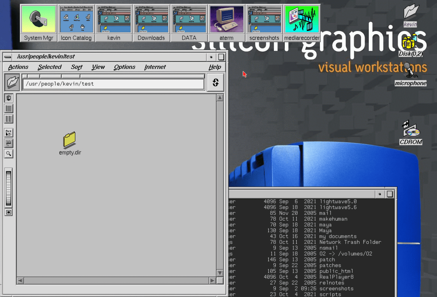

As indicated in my last post, I am now attempting to convert my SGI systems to BlueSCSI Ultra-Wide.
Now it's time to tackle my SGI O2 and Octane 2 systems... they are still running old spinning rust, so I'll have to start from scratch on how to do that.
I am starting with the Octane 2. It is currently configured with three 72GB drives, the root drive and a striped set mounted as /Data.
The Octane has three internal drive bays, and the SCSI ID is associated with the bay number (1-3).
I created two .hda files, a 73GB for the root, and a 146GB for Data.
I removed all the SCSI disks from the Octane, installed the BlueSCSI in drive bay 2 and booted to the PROM command monitor, where I was able to successfully use fx to label the images: drive 2 was configured for root (bootable) and drive 3 as a option drive (non-bootable).
These operations succeeded. Everything after failed with various SCSI parity errors.

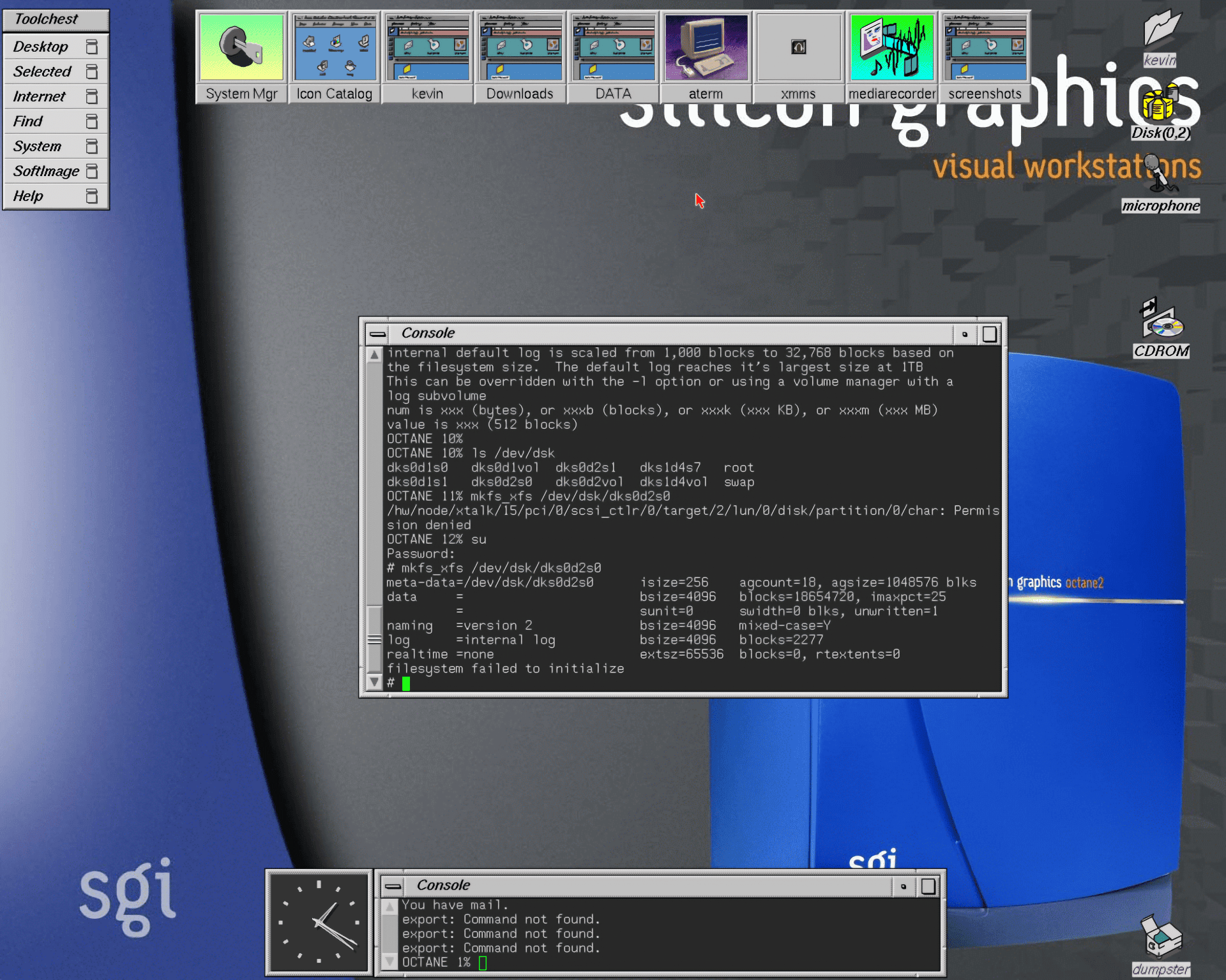

First I tried mkfs to create an xfs file system on the drives. SCSI parity error.
I then went through several permutations of attempting to dd disk1 to disk2, all of which failed with parity errors.
Finally, I booted from the original root disk with the BlueSCSI in drive bay 2 to attempt to get some info about the virtual drives and perhaps init them from within Irix.

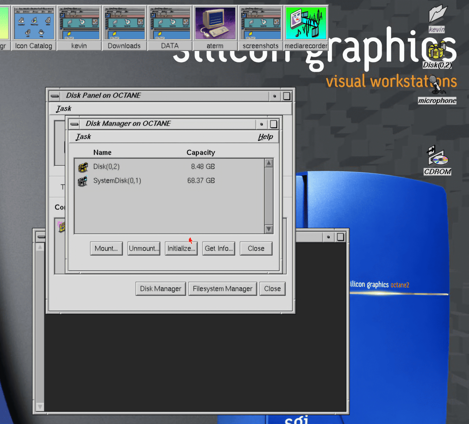

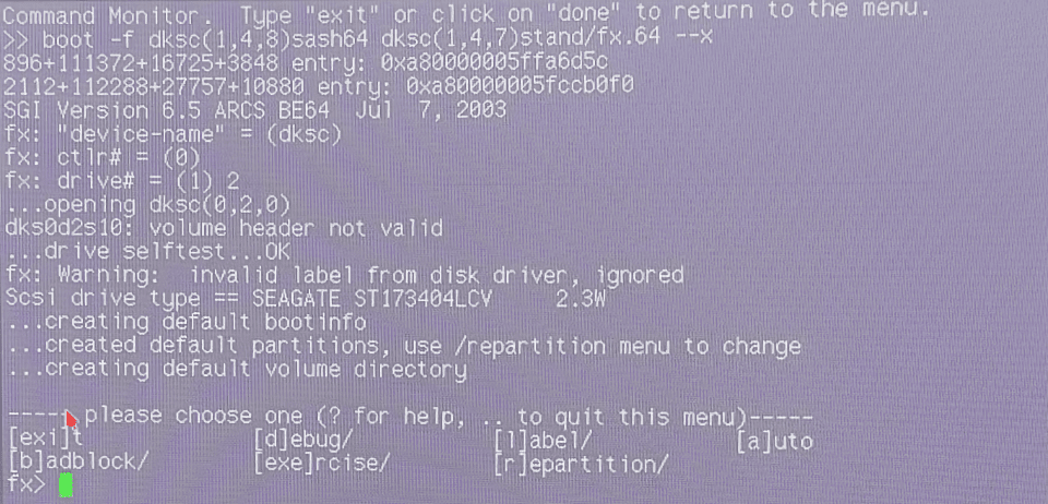

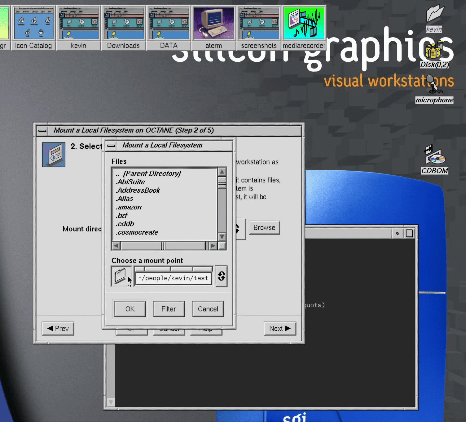

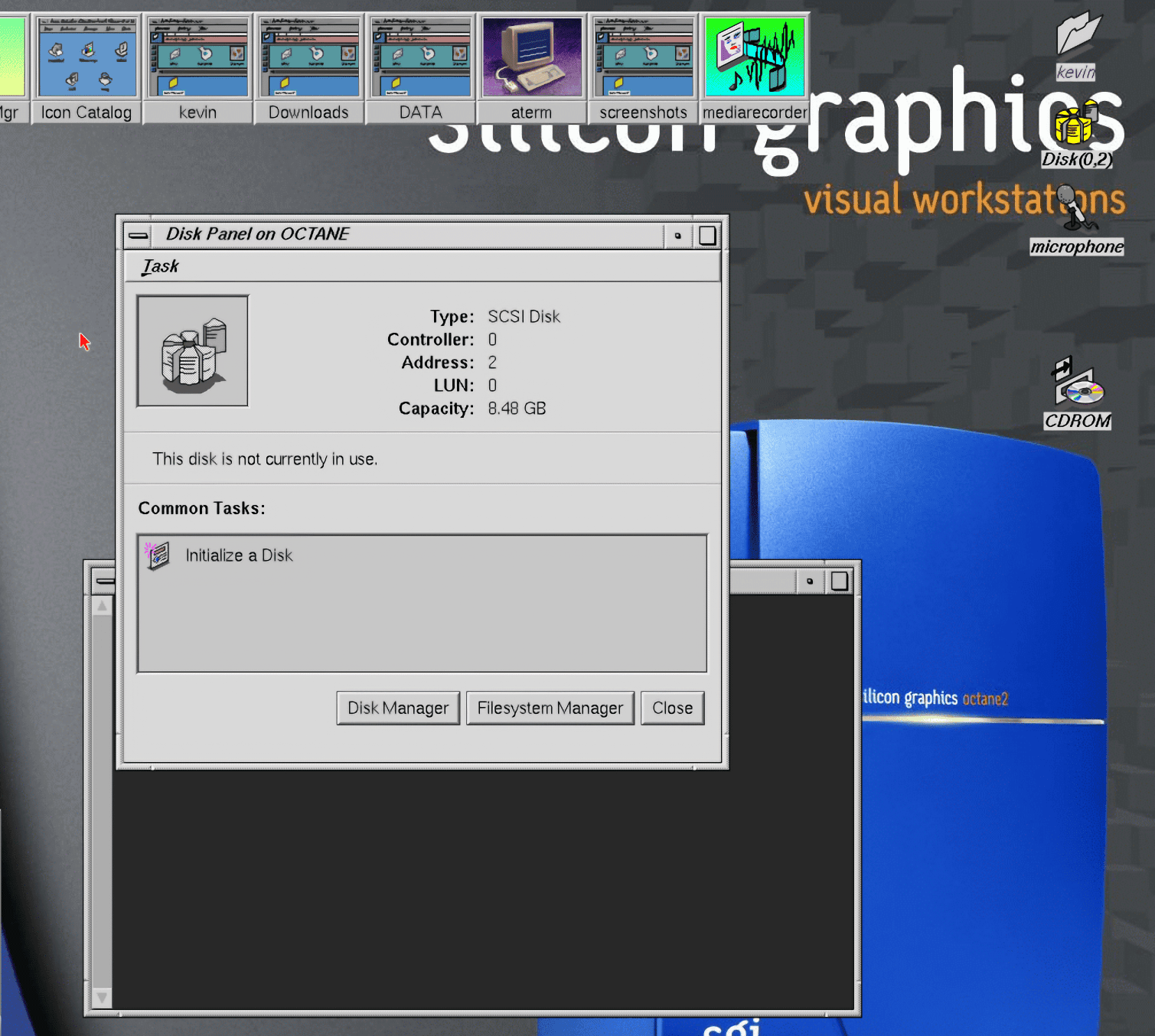

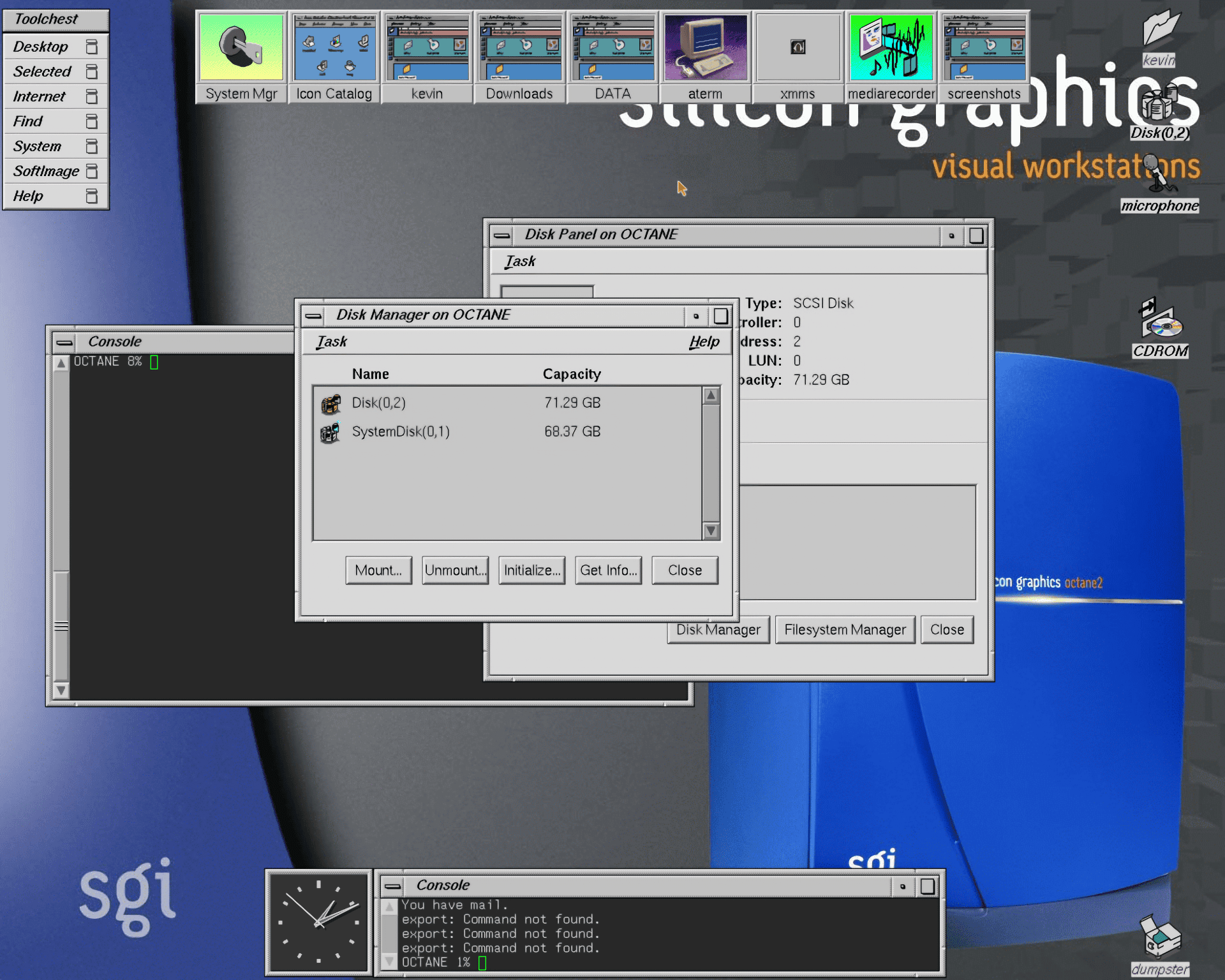

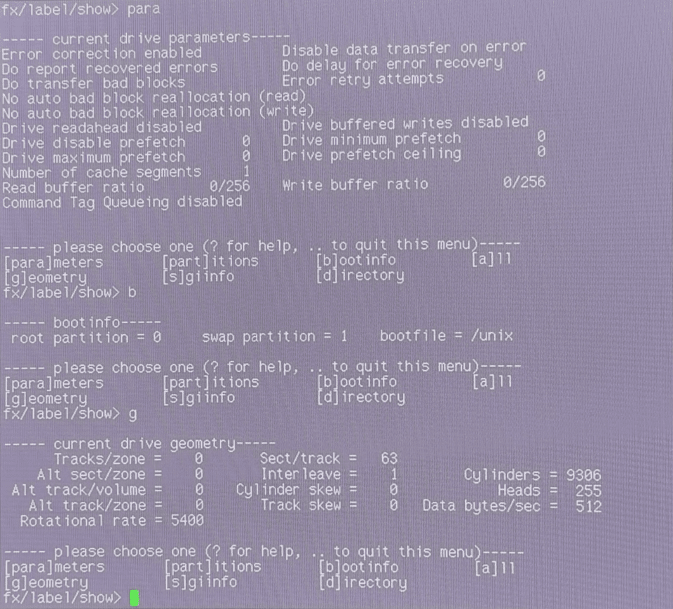

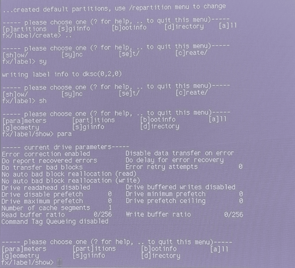

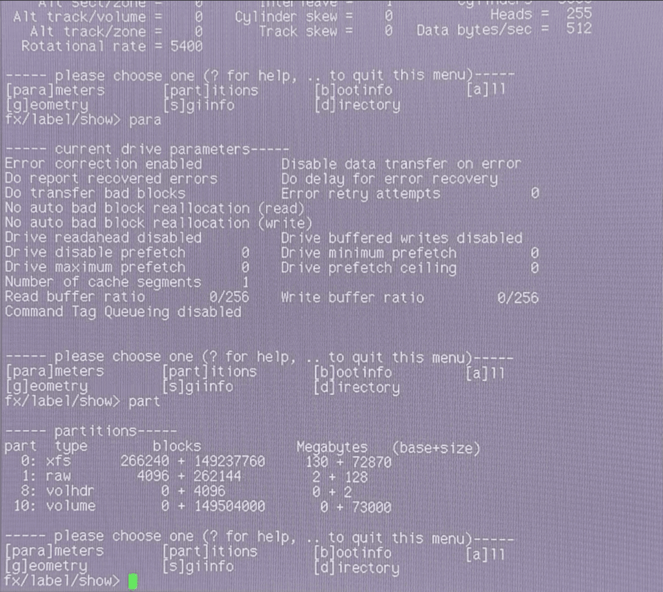

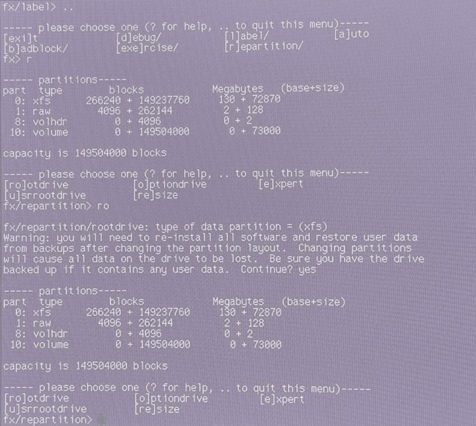

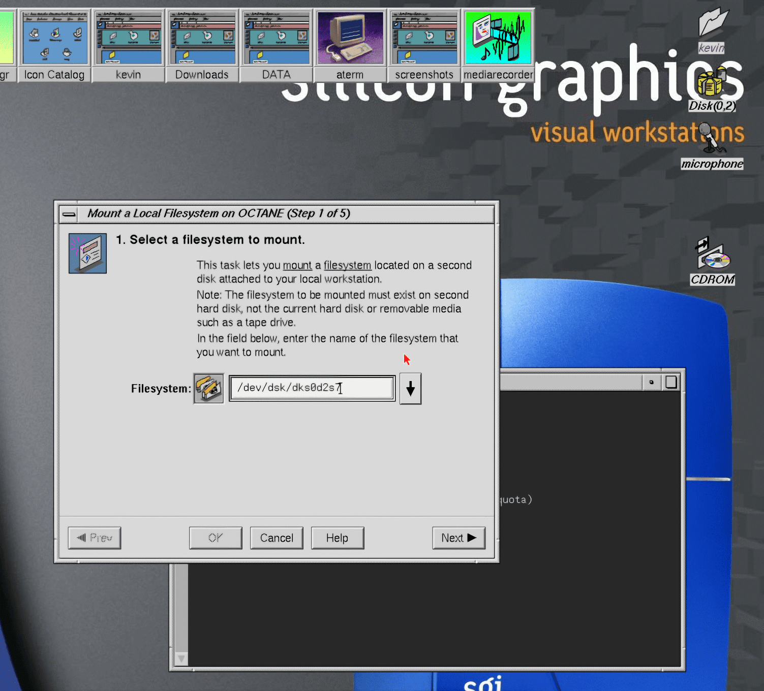

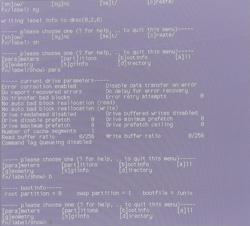

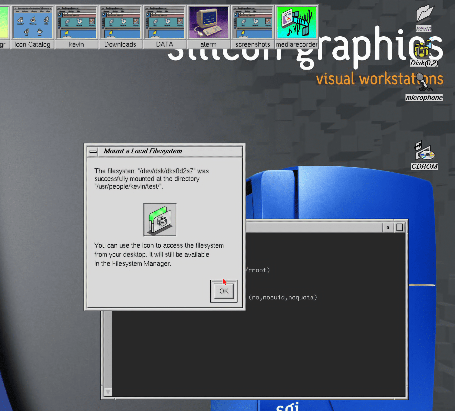

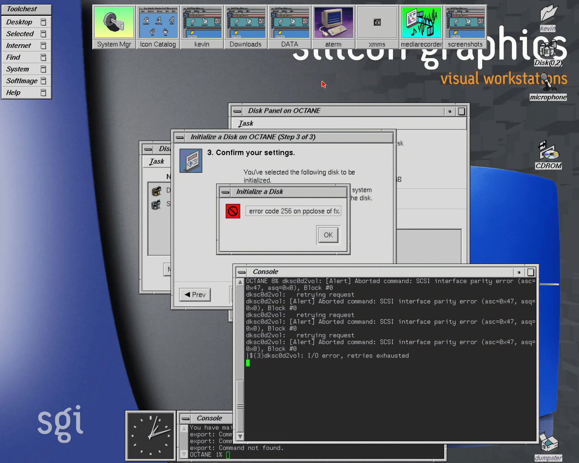

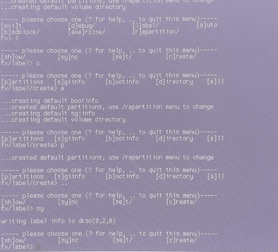

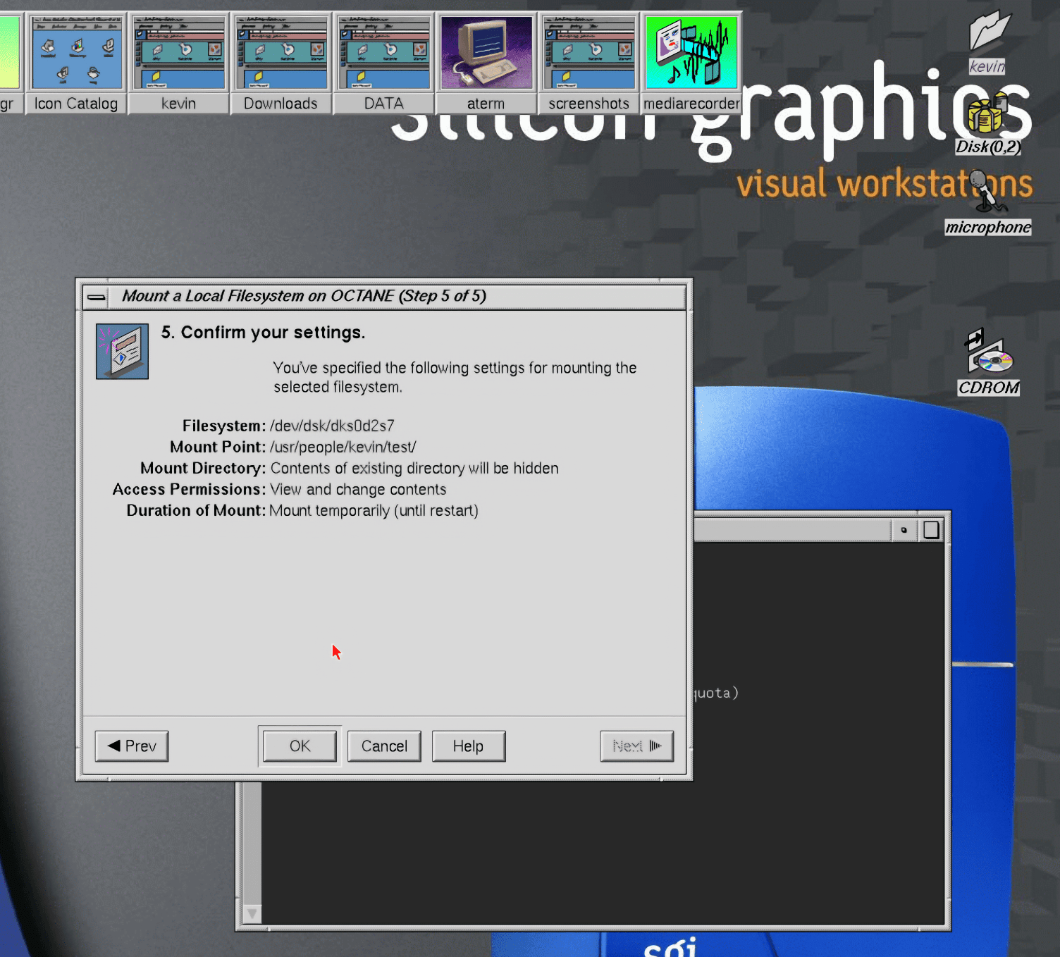

These pics will save a lot of typing:
What is of note is that the disks appear on the desktop as uninitialized (this is expected), they appear in Disk Manager, and I can attempt to initialize them from Disk Panel.

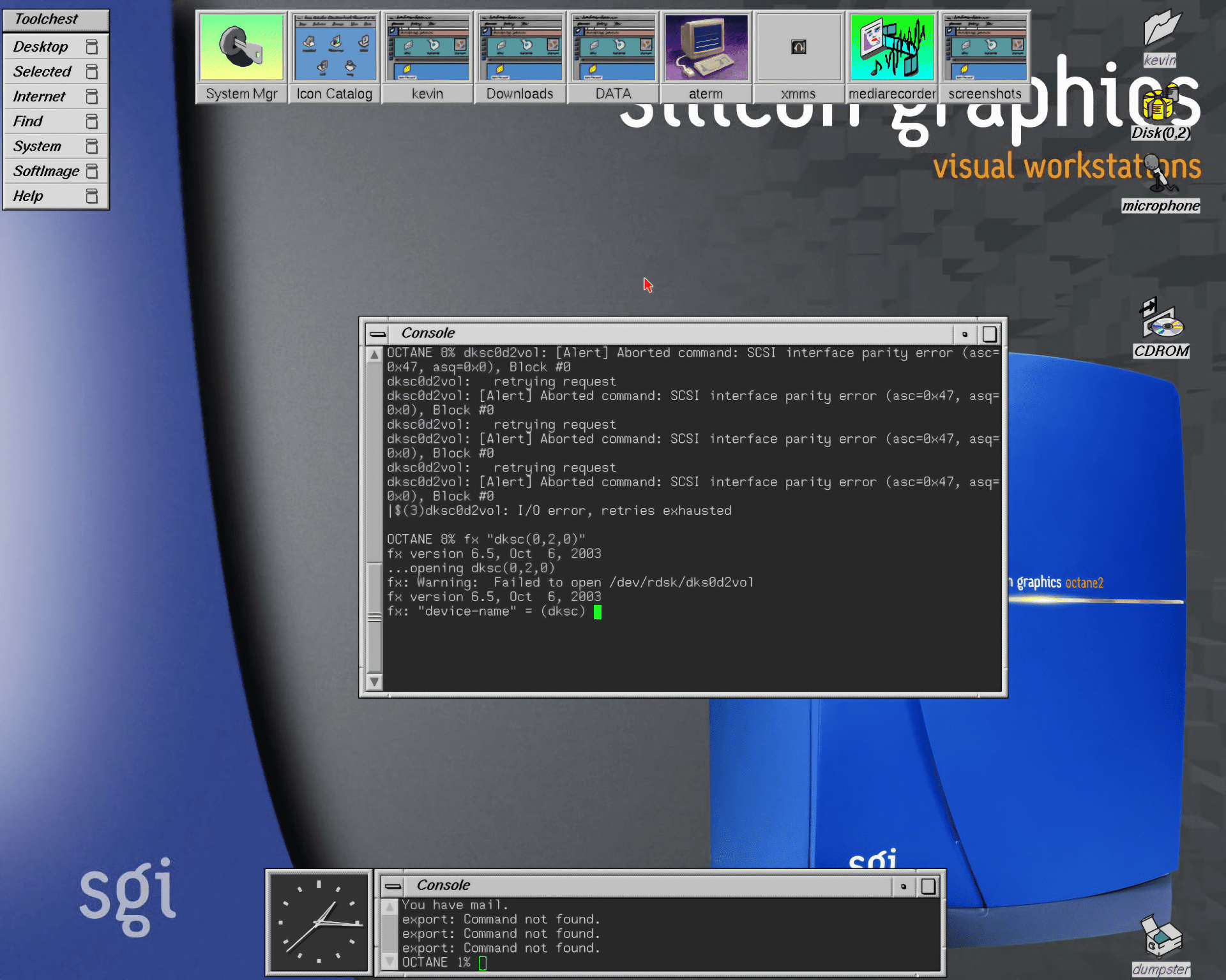

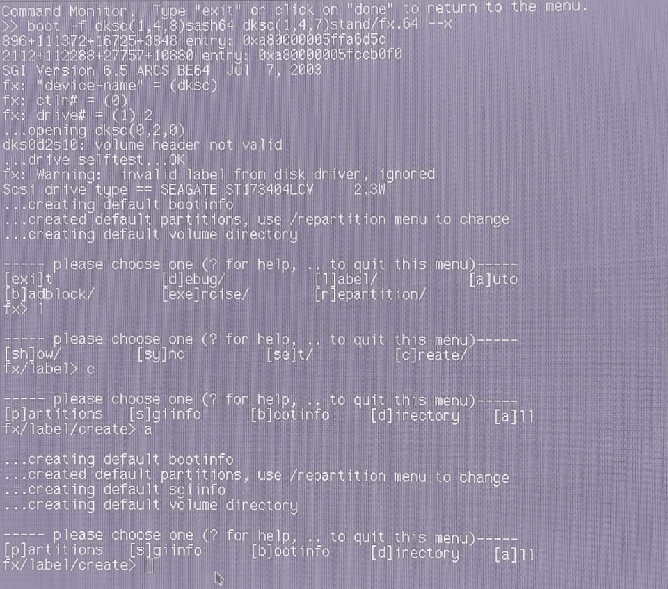

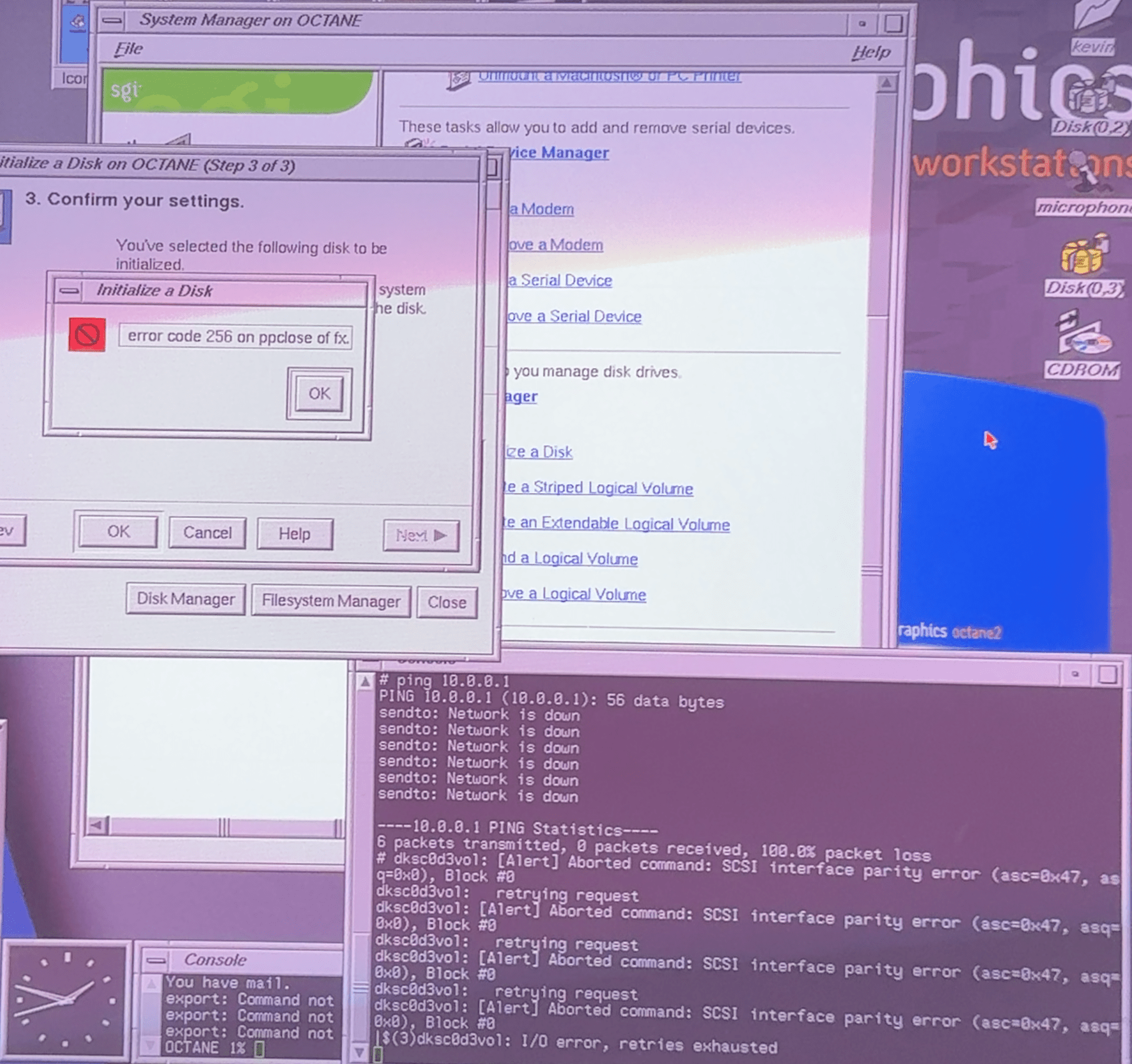

This pic shows error code 256 :
Error code 256 basically means fx exited with a non-0 exit code (failure).
The console shows the following:
Code:
%hinv -c disk
Integral SCSI controller 0: Version QL1840B (rev. 2), single ended
Disk drive: unit 1 on SCSI controller 0
Disk drive: unit 2 on SCSI controller 0
Disk drive: unit 3 on SCSI controller 0
% dksc0d2vol: [Alert] Aborted command: SCSI interface parity error (asc=0x47, asq=0x0), Block #0
dksc8d2vol: retrying request
dksc8d2vol: [Alert] Aborted command: SCSI interface parity error (asc=0x47, asq=0x0), Block #0
|$(3)dksc0d2vol: I/O error, retries exhausted

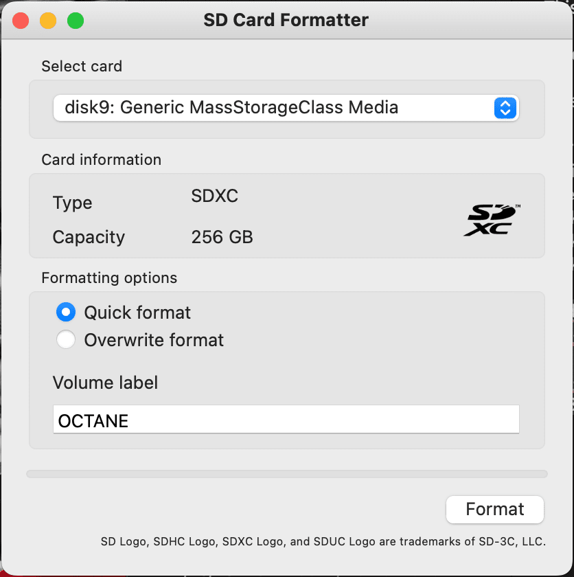

Lastly do a format of the sd card with the sd card formatter utility in our docs - fixes a lot of weird sd issues.

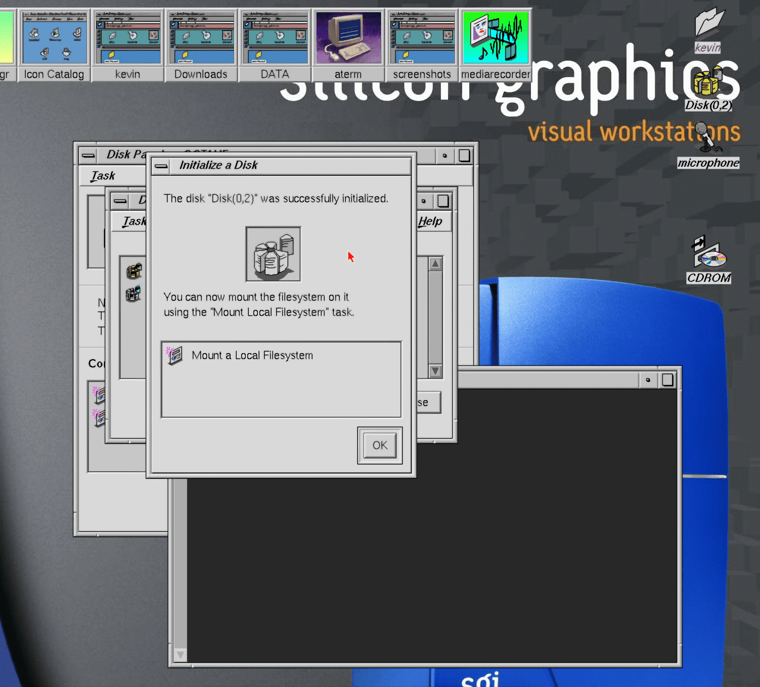

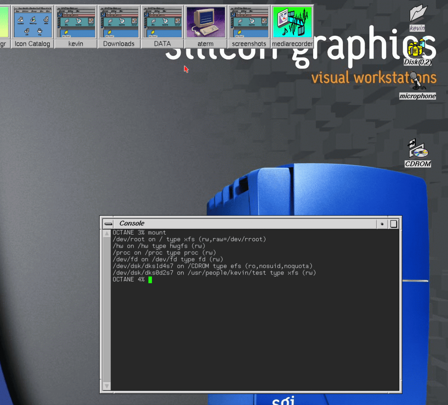

I upgraded the fw, removed the quotes and extraneous settings, shortened the image file names (just in case), and here is the log (note red text):
Rich (BB code):
Platform: BlueSCSI Ultra (Wide)
FW Version: 2026.08.17-rel Aug 17 2026 16:08:59
Flash chip size: 16384 kB
SCA Model Detected, Assigned SCSI ID: 2
=== Bootloader Log ===
s] DBG Writing flash at offset 0x0005A000 data 0x28 0x46 0xF0 0xF7
[3369ms] DBG Writing flash at offset 0x0005B000 data 0x1B 0xB1 0x91 0x46

Same error as before, but block #2 this time instead of #0 - I don't know what the distinction is or if it matters. Maybe it made it slightly further in the process?
Code:
% dksc0d2vol: [Alert] Aborted command: SCSI interface parity error (asc=0x47, asq=0x0), Block #2
dksc8d2vol: [Alert] Aborted command: SCSI interface parity error (asc=0x47, asq=0x0), Block #2
Thx,
-k

2. Formatted SD card:

6. Booted Octane into the command console, partitioned and labelled drive (and captured other useful info):
So far, everything looks good.
7. Booted into Irix, Disk2 on desktop as expected and uninitialized. Attempted to init:
Same failure as before:
Launched fx to check status of volume (failed to open):
Attempted mkfs_xfs on drive (failed):
Anything else I can try?
Thx,
-k

Same error:
Code:
dksc0d2vol: retrying request
See attached debug.txt file.

I was wondering if my SD might be bad, so I grabbed a 32GB SD, created a 1GB .hda file, and copied that and the ini file over.
Booted into the command monitor, ran fx and created a new partition and label. This worked as before.
Booted into Irix and attempted to initialize the new volume, but it failed with the same parity error issue as before.
I then wondered if something was wrong with my BlueSCSI.
So, I swapped in a known good BlueSCSI and tried the same experiment. SCSI parity error just as before.
So, the original SD and BlueSCSI are fine.
I then wondered if there was something wrong with my Octane SCSI controller...
I grabbed a Quantum 9GB SCA drive and plugged it into bay 2 on the Octane.
Booted to the command monitor and partitioned and labelled the drive as before.
Booted into Irix and attempted to initialize the drive:
All was successful, and I was able to mount the new vol and create a directory.
Maybe I am creating the image file incorrectly?
This is how I created the 73GB file:
Code:
dd if=/dev/zero of=HD20_512_root_73GB.hda bs=1m count=73000
Thoughts?
Thx,
-k
