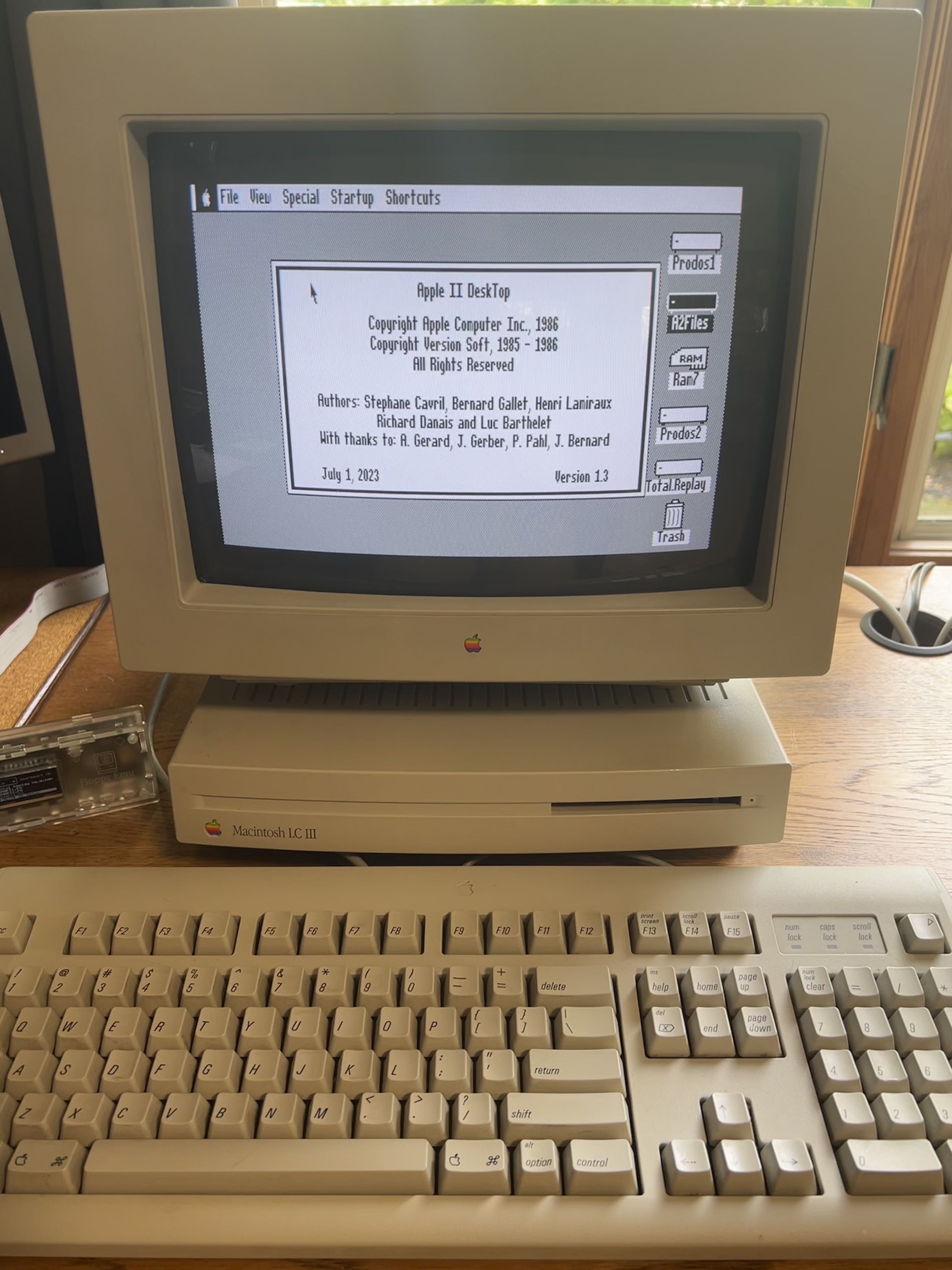

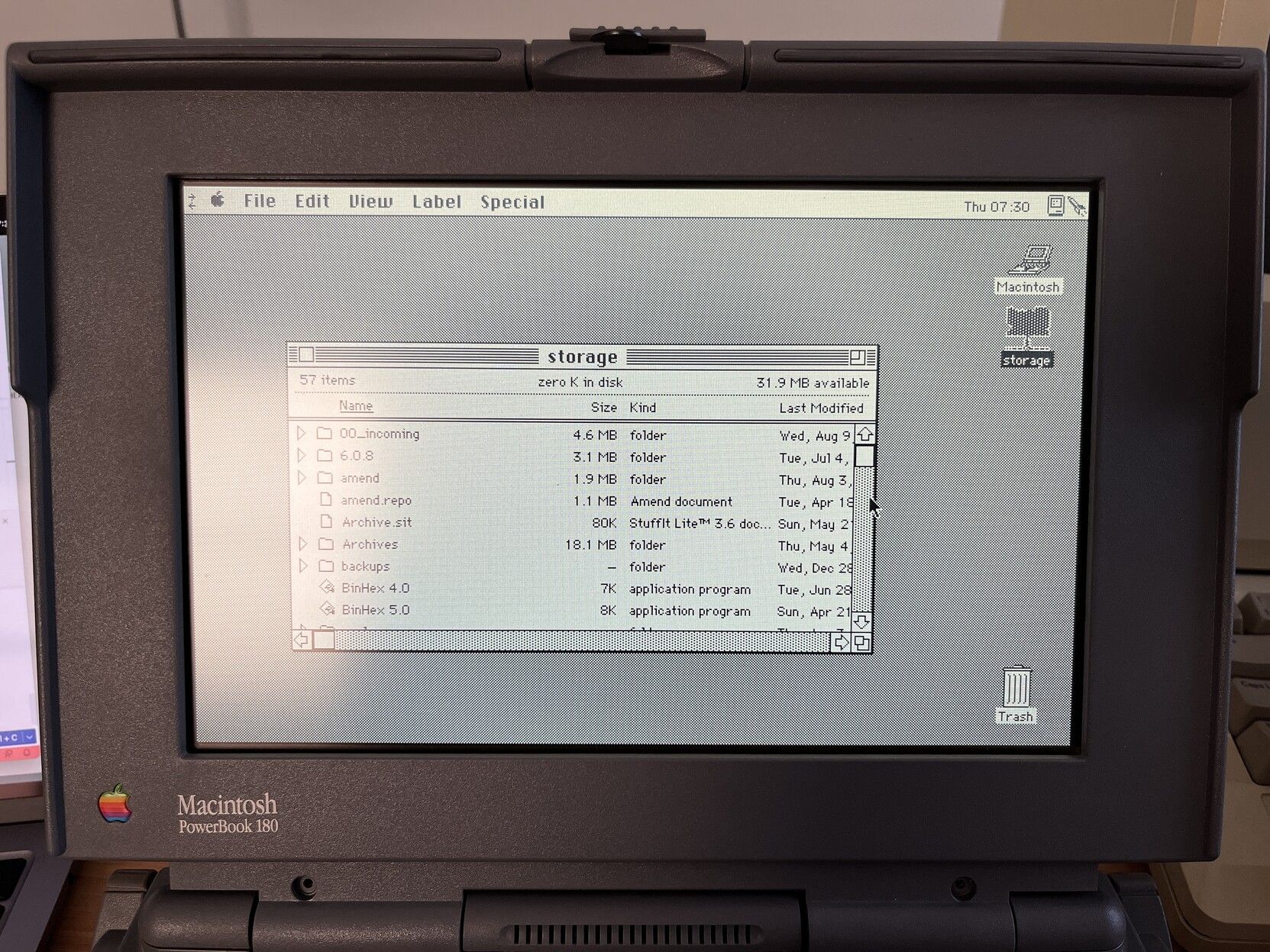

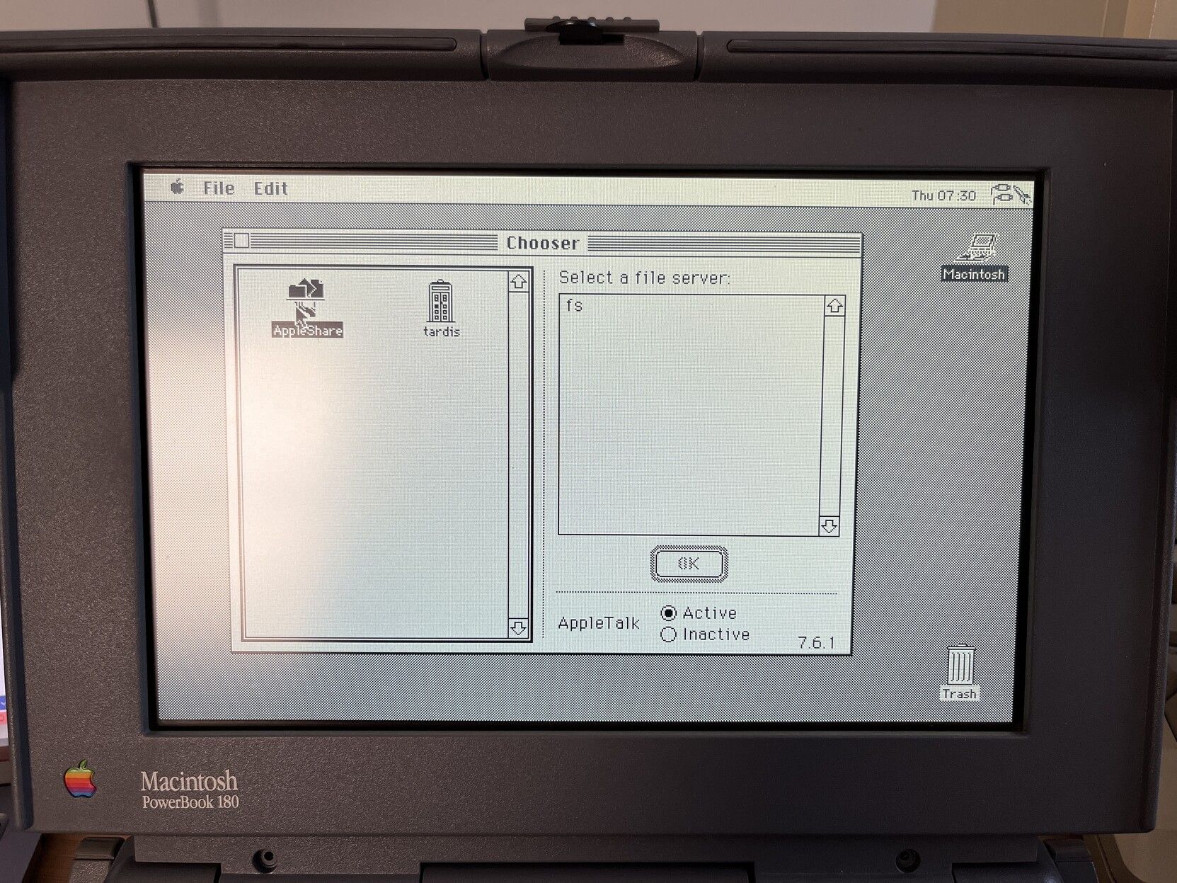

AppleTalk/EtherTalk over Wi-Fi works now
Awesome! Confirmed working for me on the latest build. On an SE/30 it takes me about a minute and a half to pull down a 1.4 MB floppy image from a share.

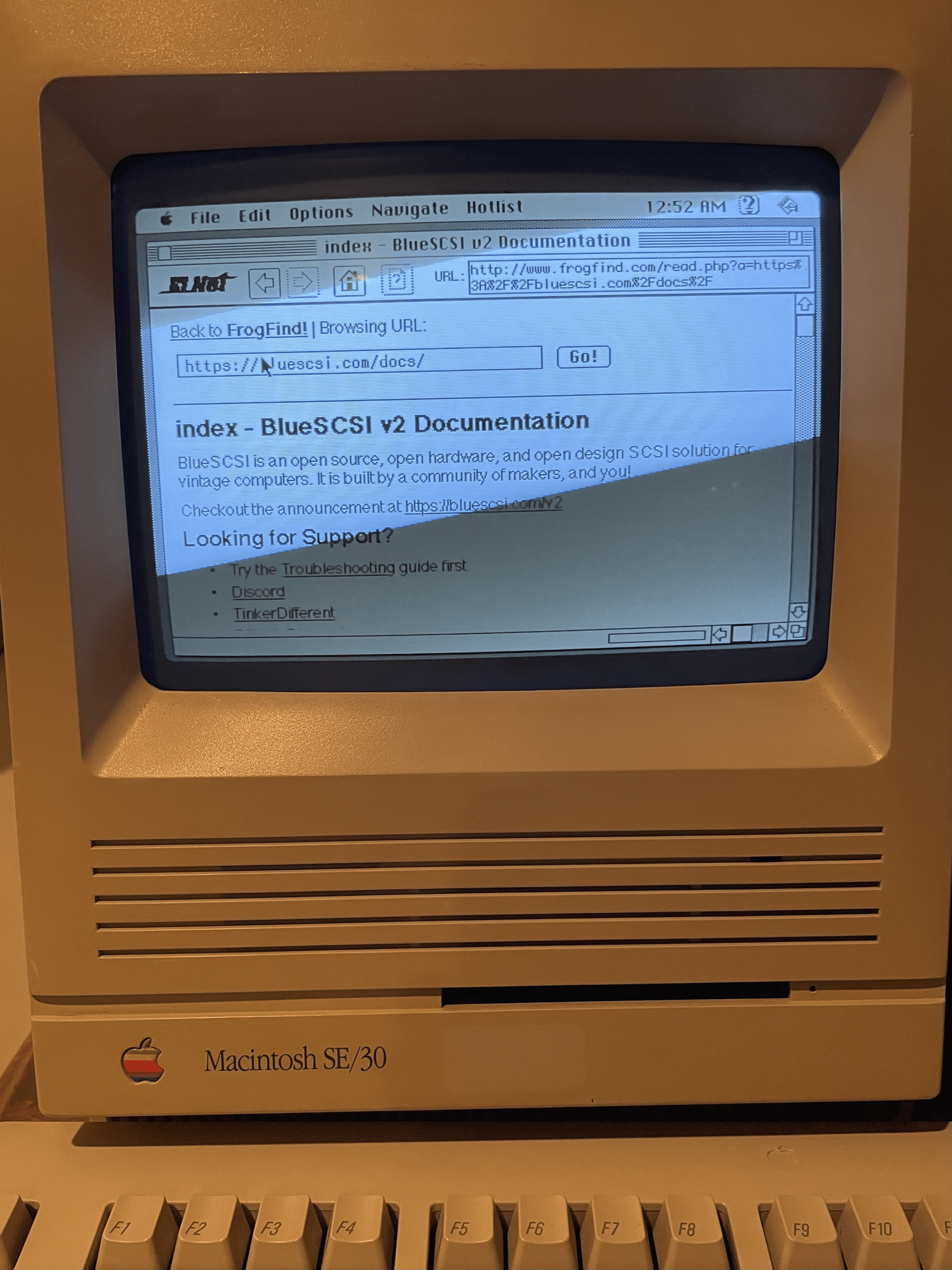

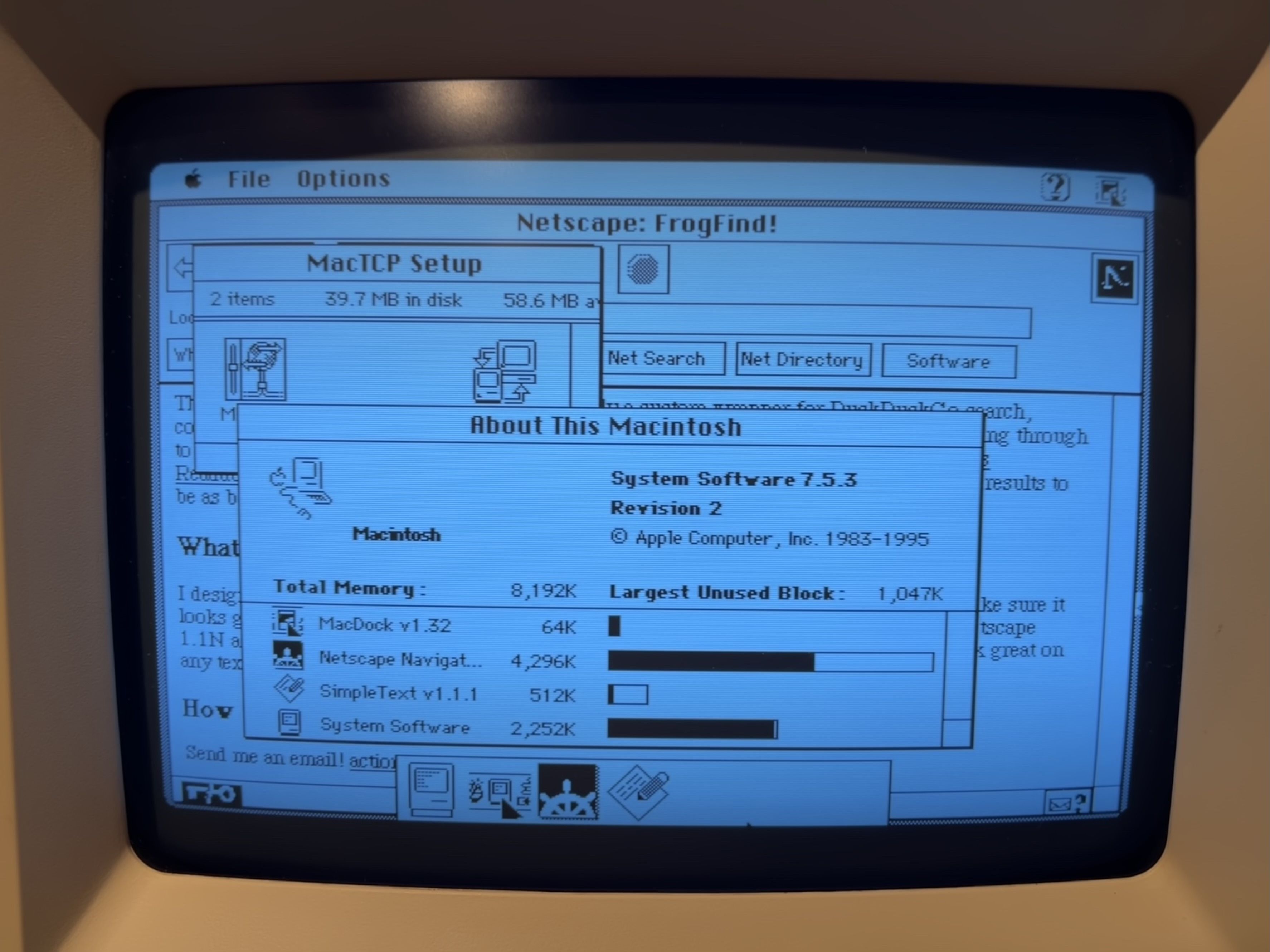

Holy smokes this thing zips on my se/30 (using frogfind to access wikipedia pages) with 7.5.3
Netscape asks for 4+ MB of ram but man does it pay off for web browsing over the leaner MacWeb!!
