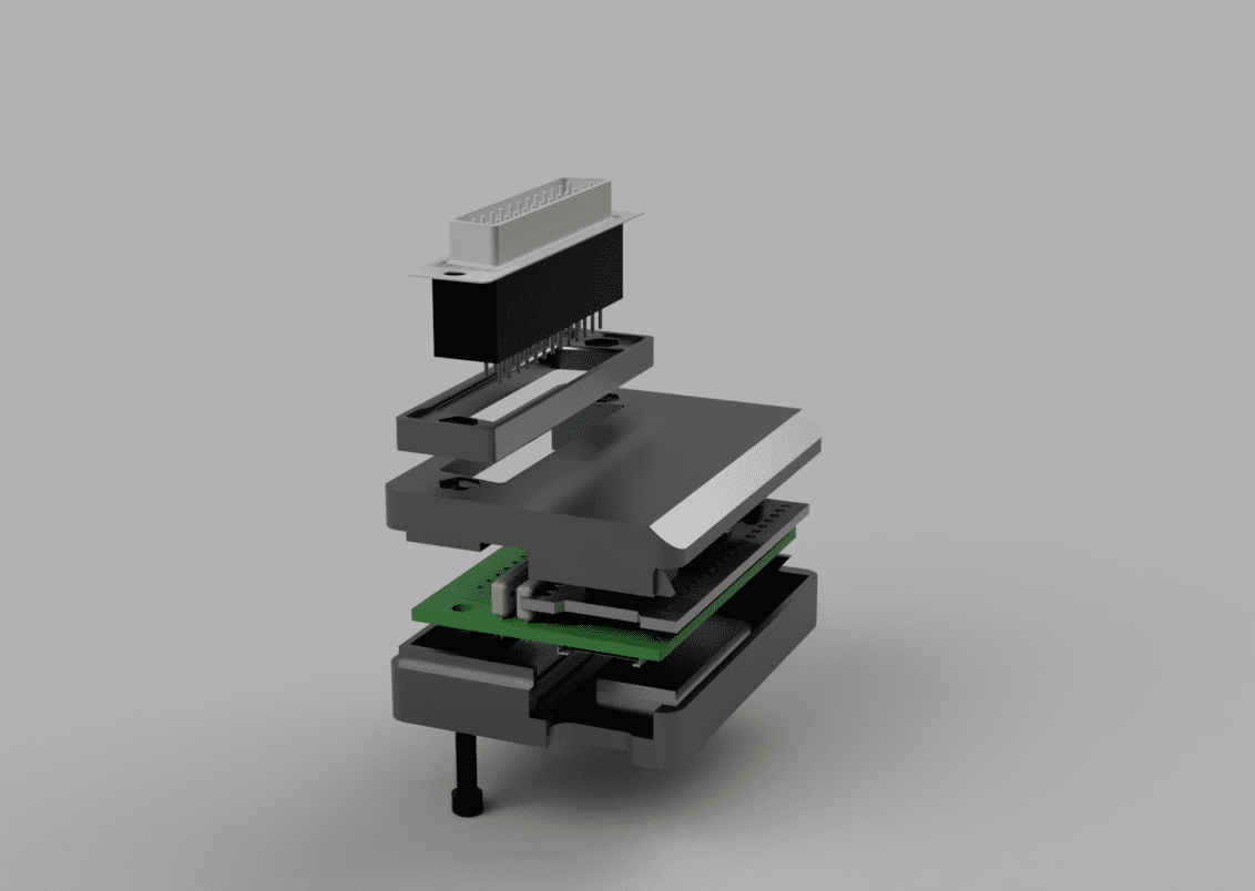

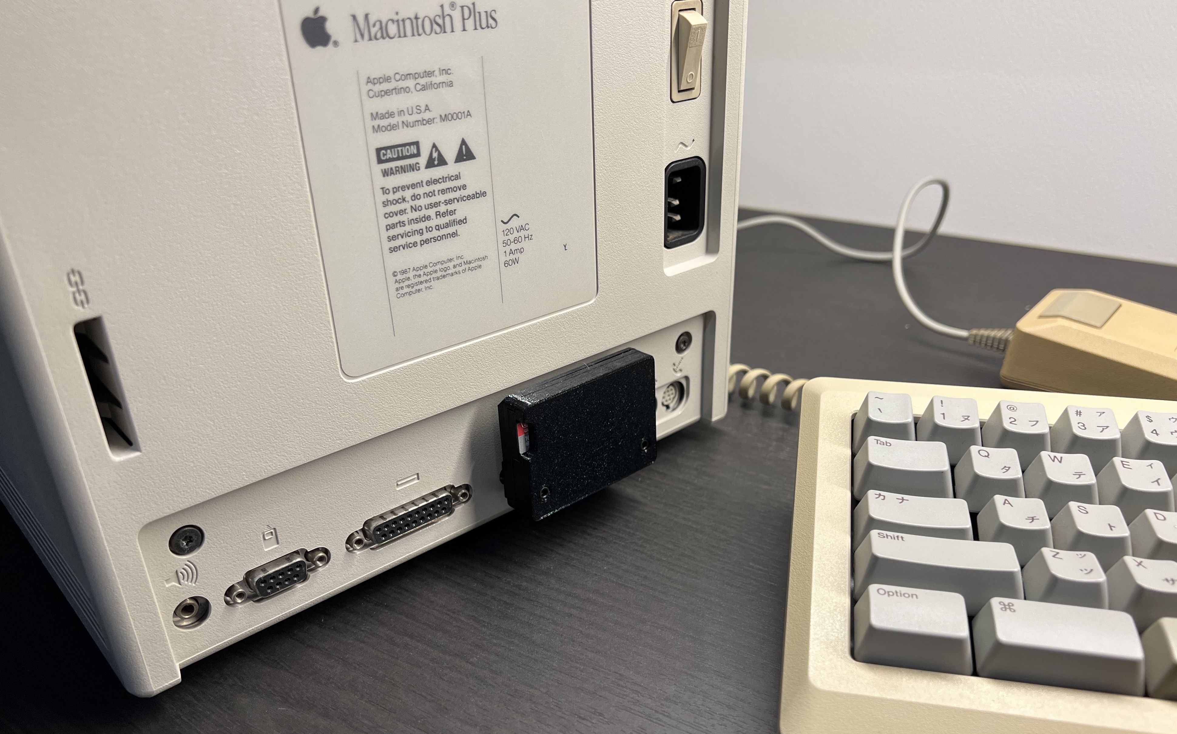

I've created a 3d printed case for a 90 degree angled BlueSCSI. This allows for a clean look.

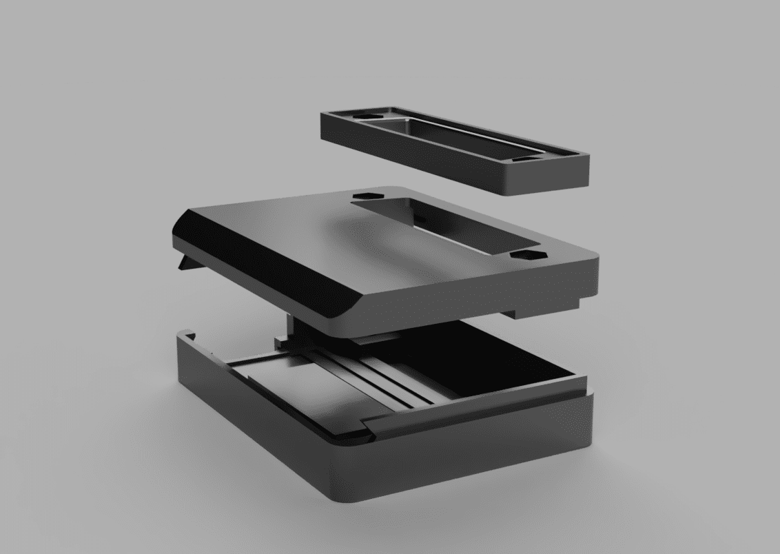

It will fit all compact Macs. It's made from 3 printed pieces so that both sides of the case can have a smooth matte finish. It has a simple design with only an opening for the SD card slot.
Materials Needed:
2 x Screws (4-40 5/8")
1 x DB25 Connector (Part DB25-PE-1-SL)
Assembly is straight forward. For the blue pill to fit, the jumper and update port pins on it will need to be trimmed down.
Note: The pins for updating the BluePill will be covered by the case, so be sure to install the firmware before assembly. For future updates, if any, the BluePill can be updated via the UART pins.
