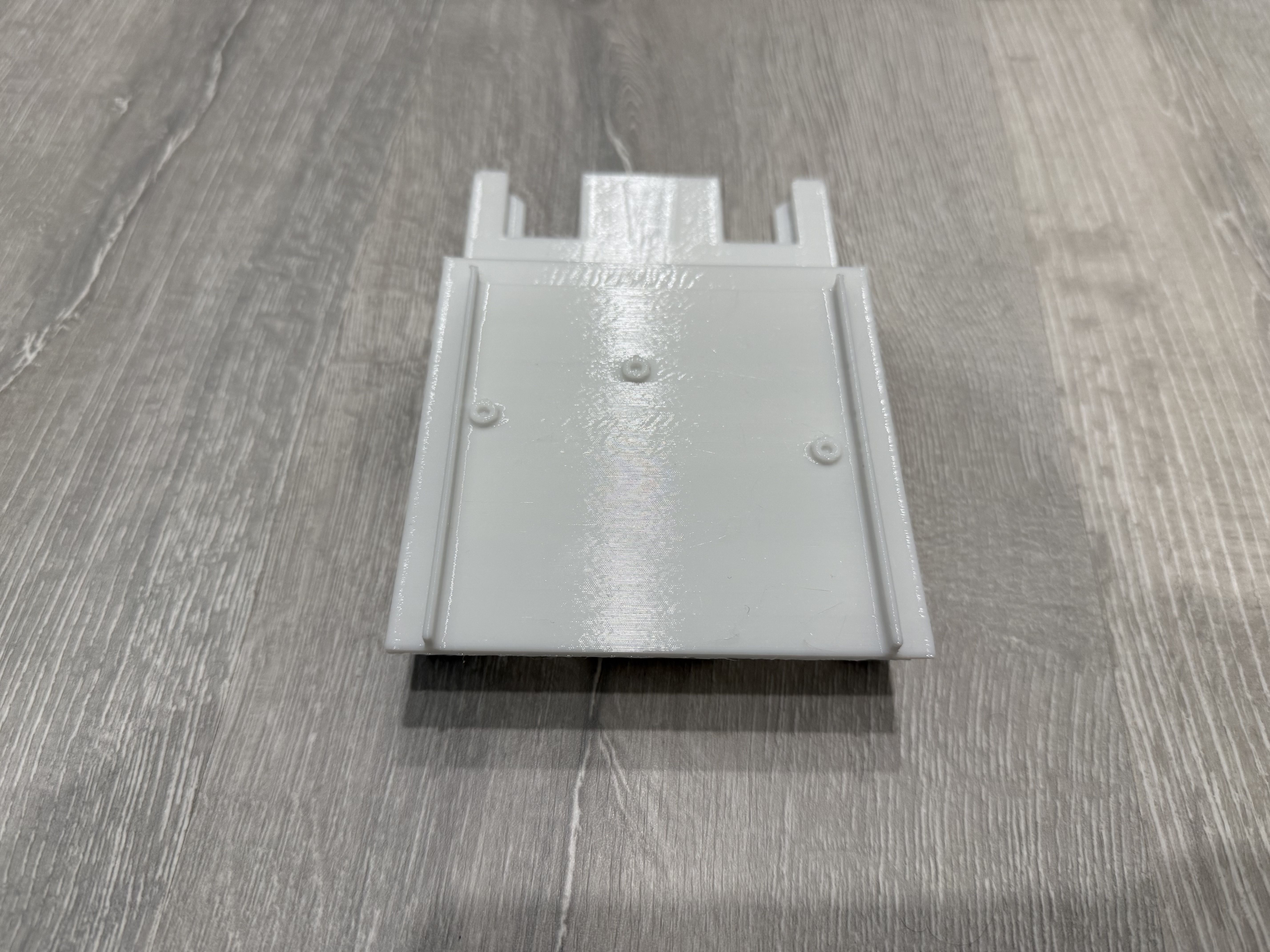

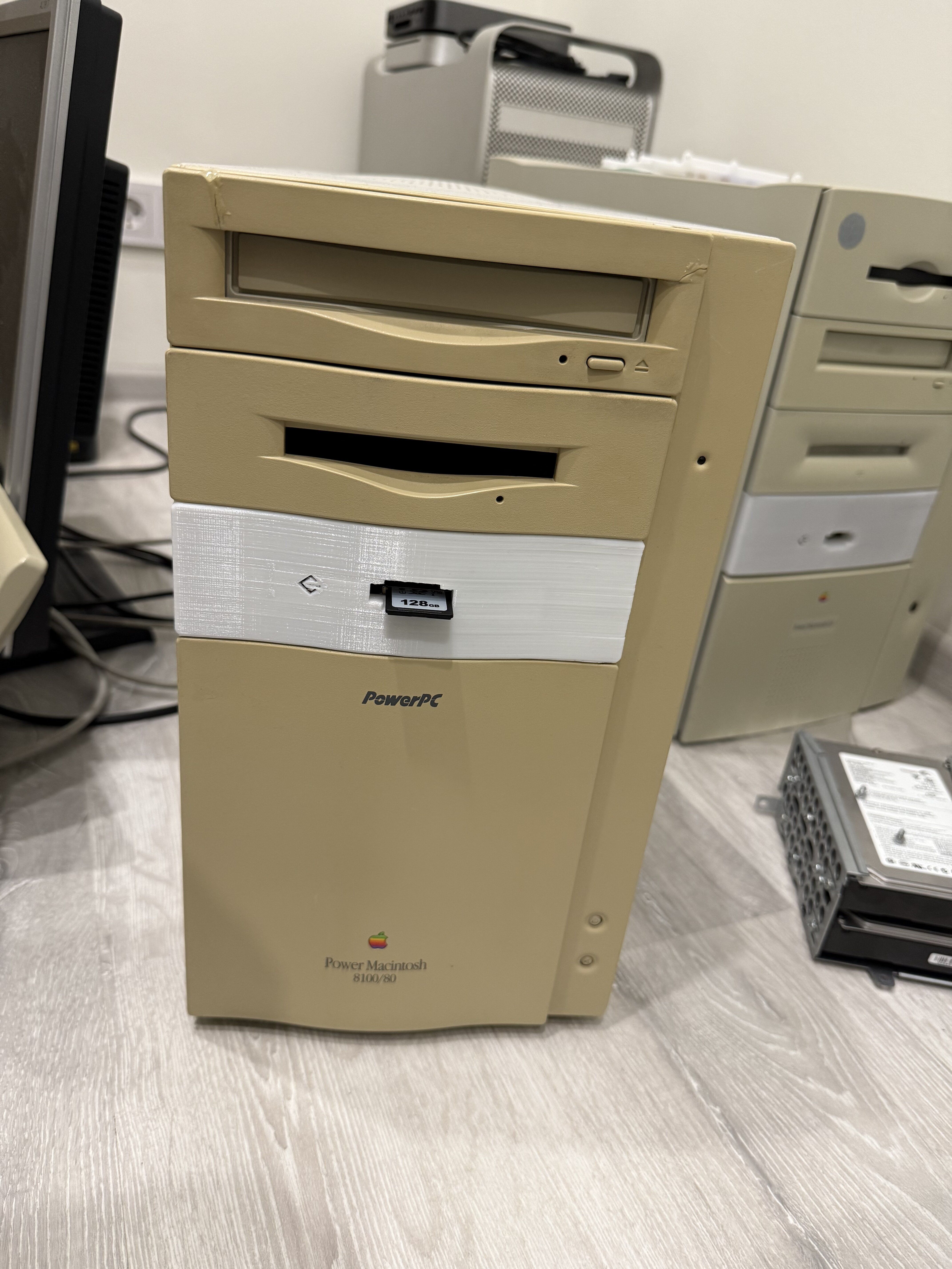

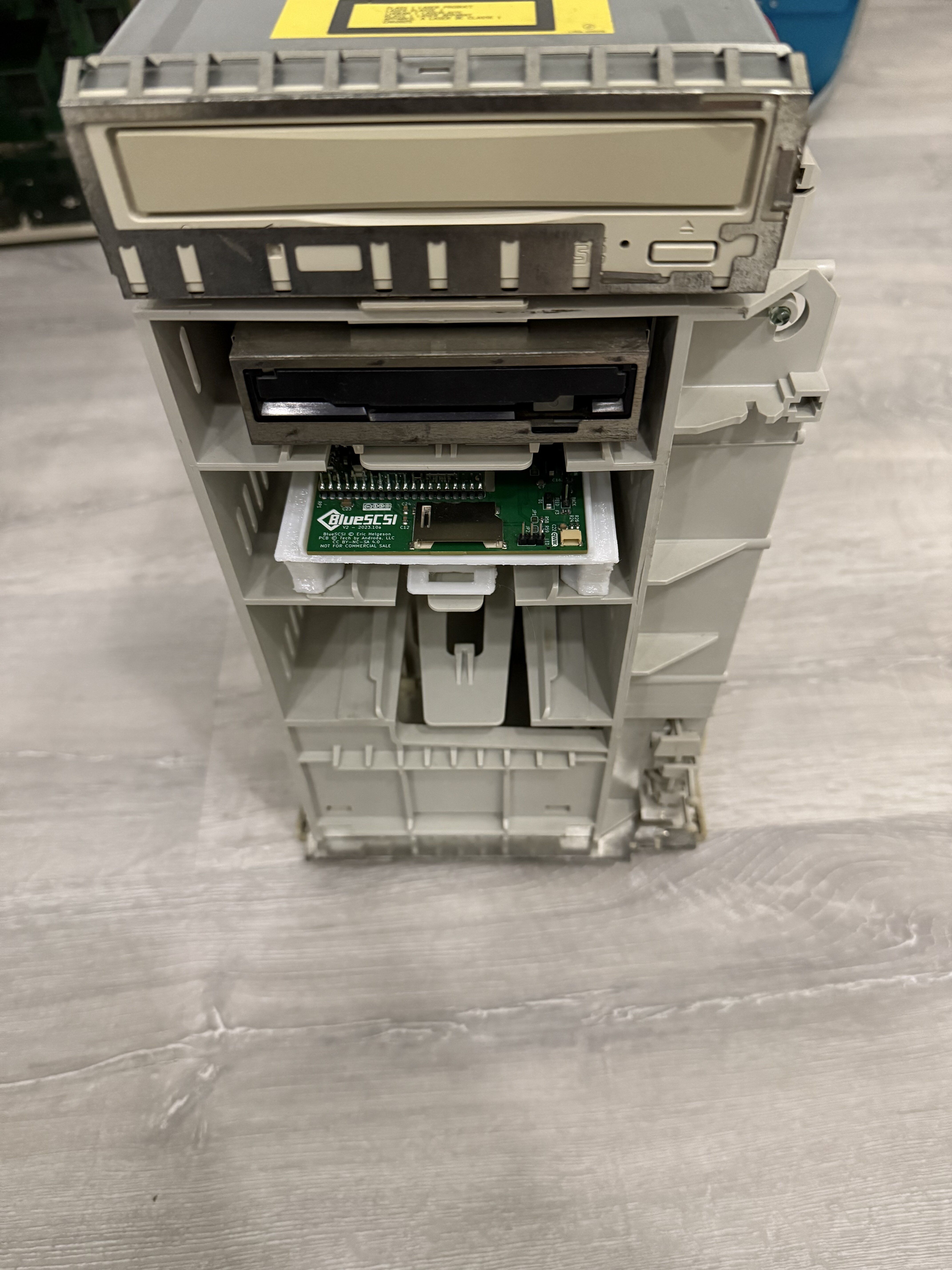

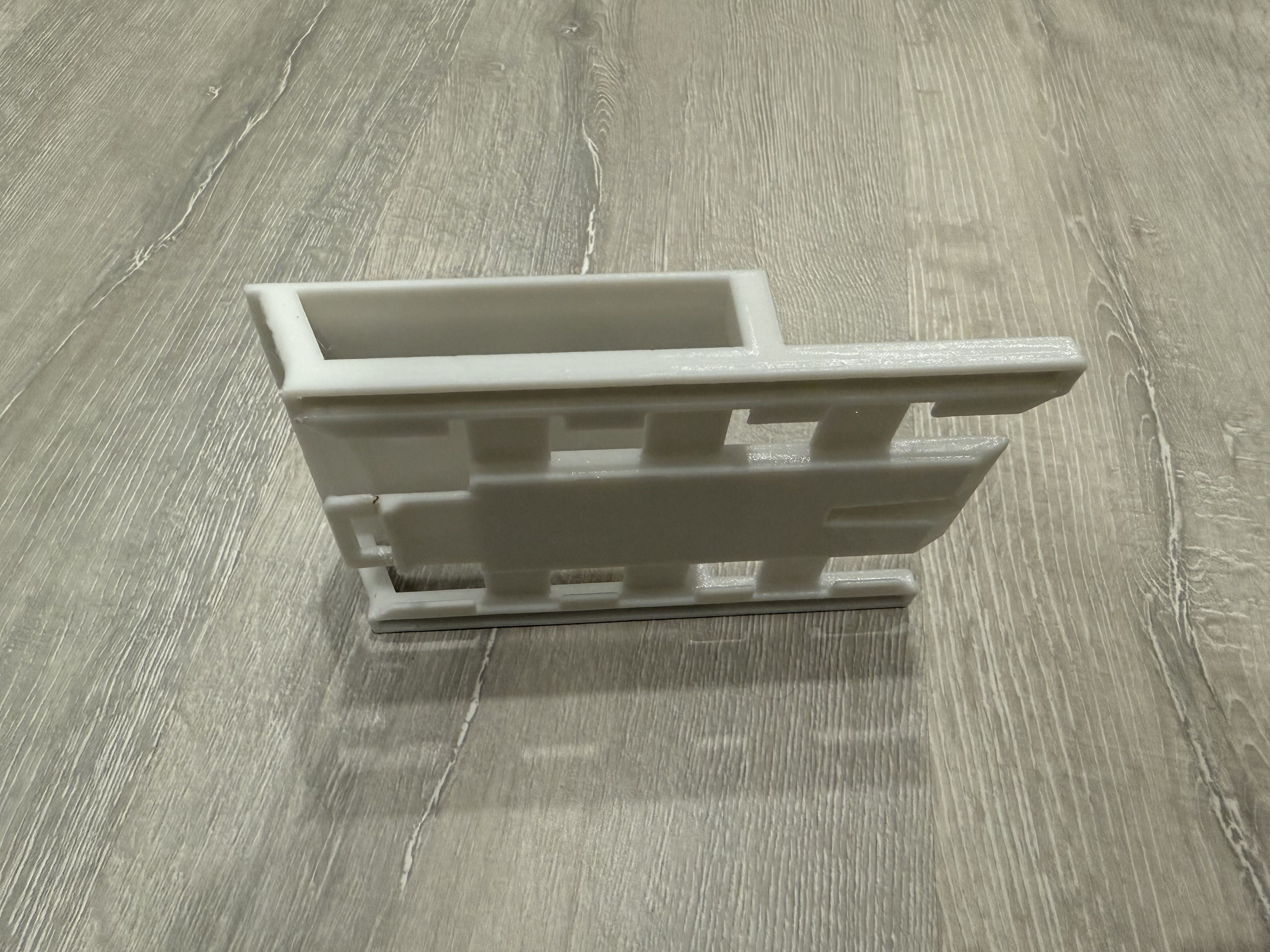

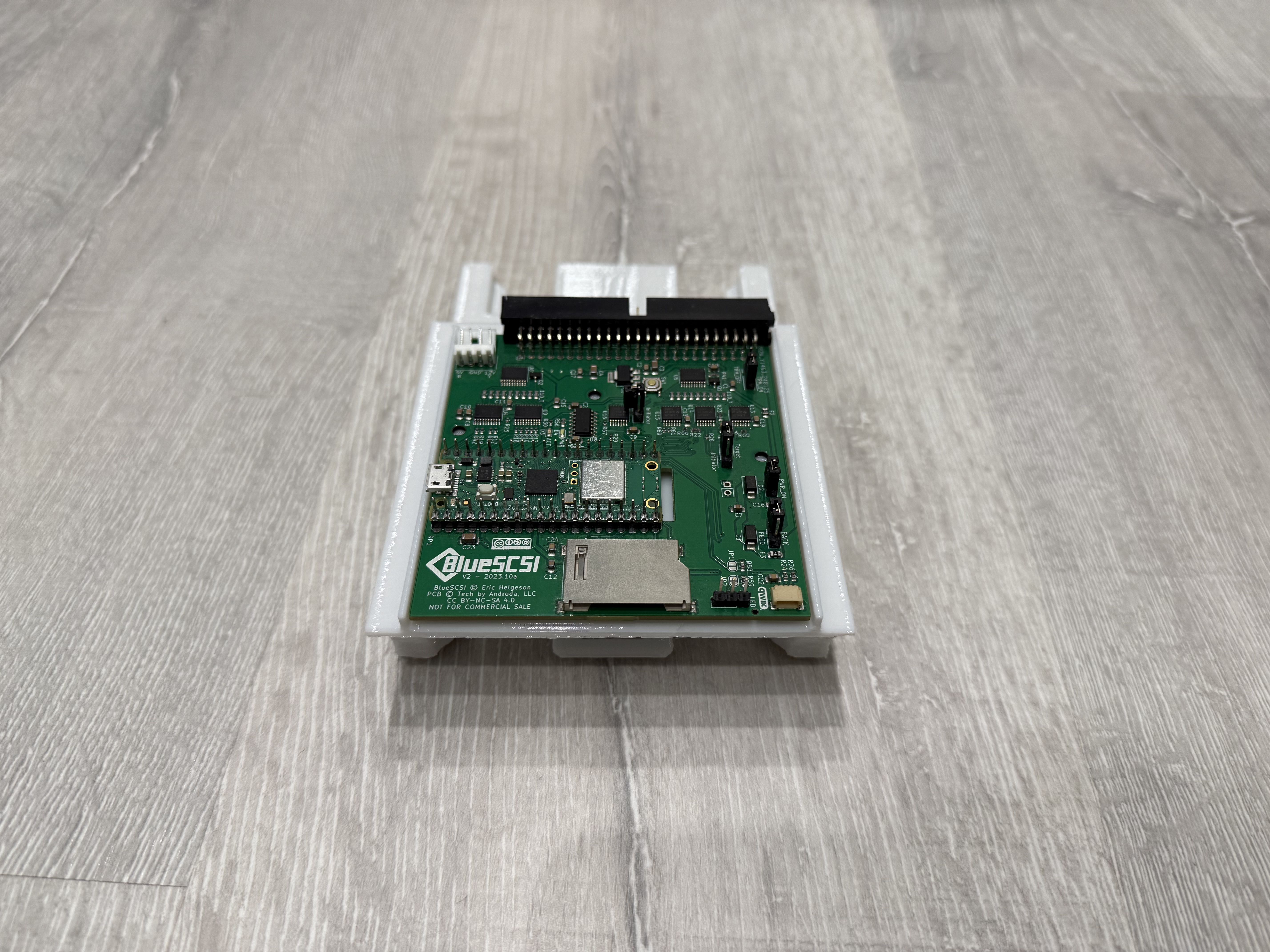

I want to share with you the bracket and bezel for BlueSCSIv2 in PM8100.
The location for screws for the new version 2023.10a, I hope it won't change in the new versions of board. :)
I like this option of using Desktop more than DB25 in this Mac.
The photo shows that the memory card is inserted much crooked, in the new version attached to the archive it should be corrected, the hole is shifted 3 mm to the right, but I have not yet printed the this version.
