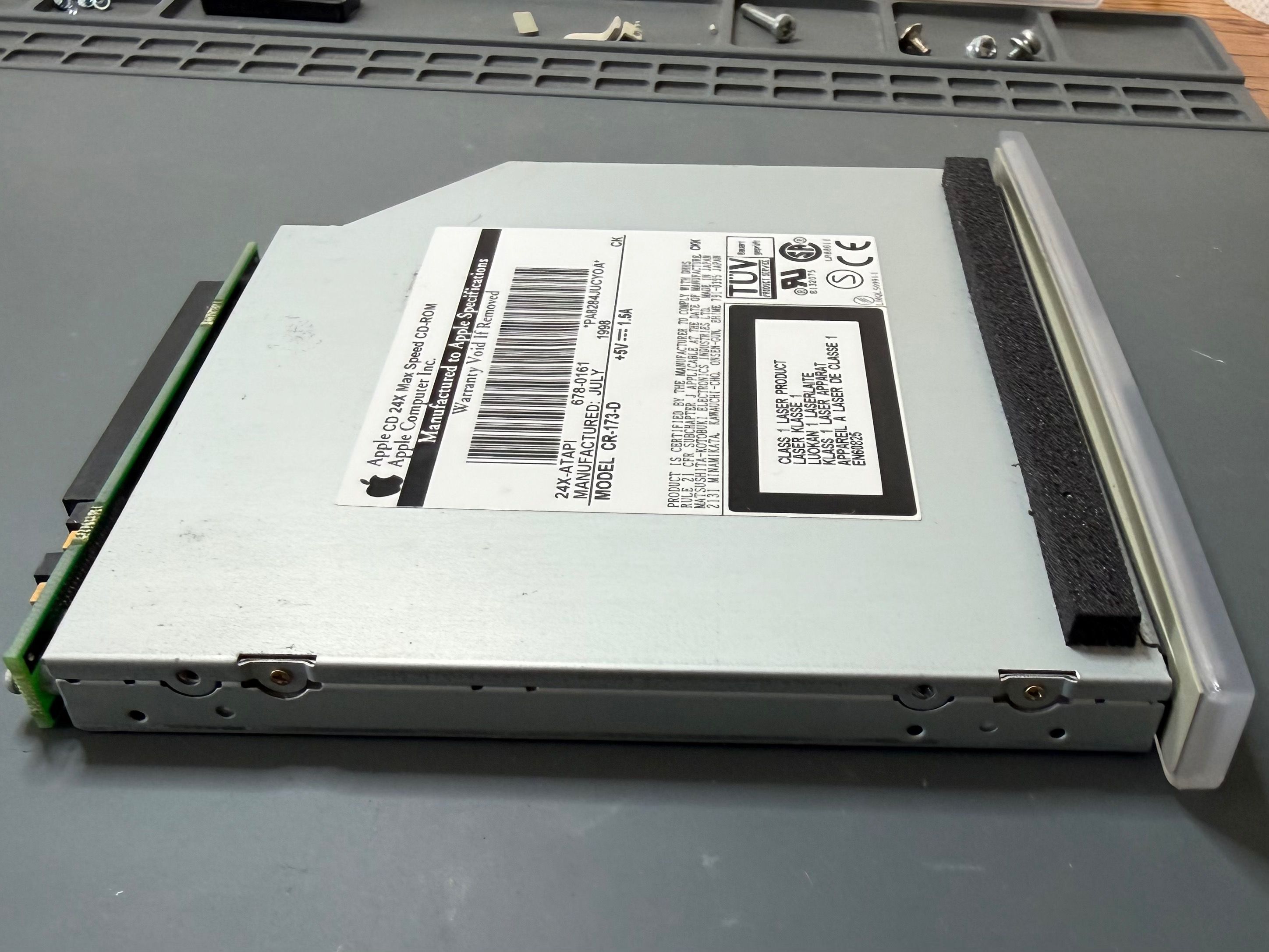

The original CD-ROM drive (Matsushita CR-173-D) didn’t work and a thorough cleaning failed to bring it back to life. The OpenFirmware (v3.0.2f) sadly won’t boot from USB although external USB storage is supported - so some software installation was possible. The network could also used to load stuff or to network boot from.
ACA4DD86-BDCC-4F74-B5DB-A0B5E05C33EF_1_201_a.heic
I couldn’t find any direct replacement drive on eBay or anywhere. One or two sites claimed to have reconditioned stock but orders got bounced. I tried a later TEAC slim 24x drive which was physically compatible but evidently the firmware was too different.
I eventually managed to find a CR-176-B drive. This is a later revision and it wasn’t clear how the -B designation differed from the -D, but it was worth a shot. Luckily the drive worked fine. In fact, it was happy reading CD-Rs which I suspect the original drive would have balked at.
I’d taken the bezel off the original unit although two of the locating posts had broken off .. typical old ABS plastic. However, the locating points were identical on the CR-176-B so I used acetone to weld them back together. In fact, it took 2 attempts because the posts broke yet again and I needed to transplant posts from the replacement unit.

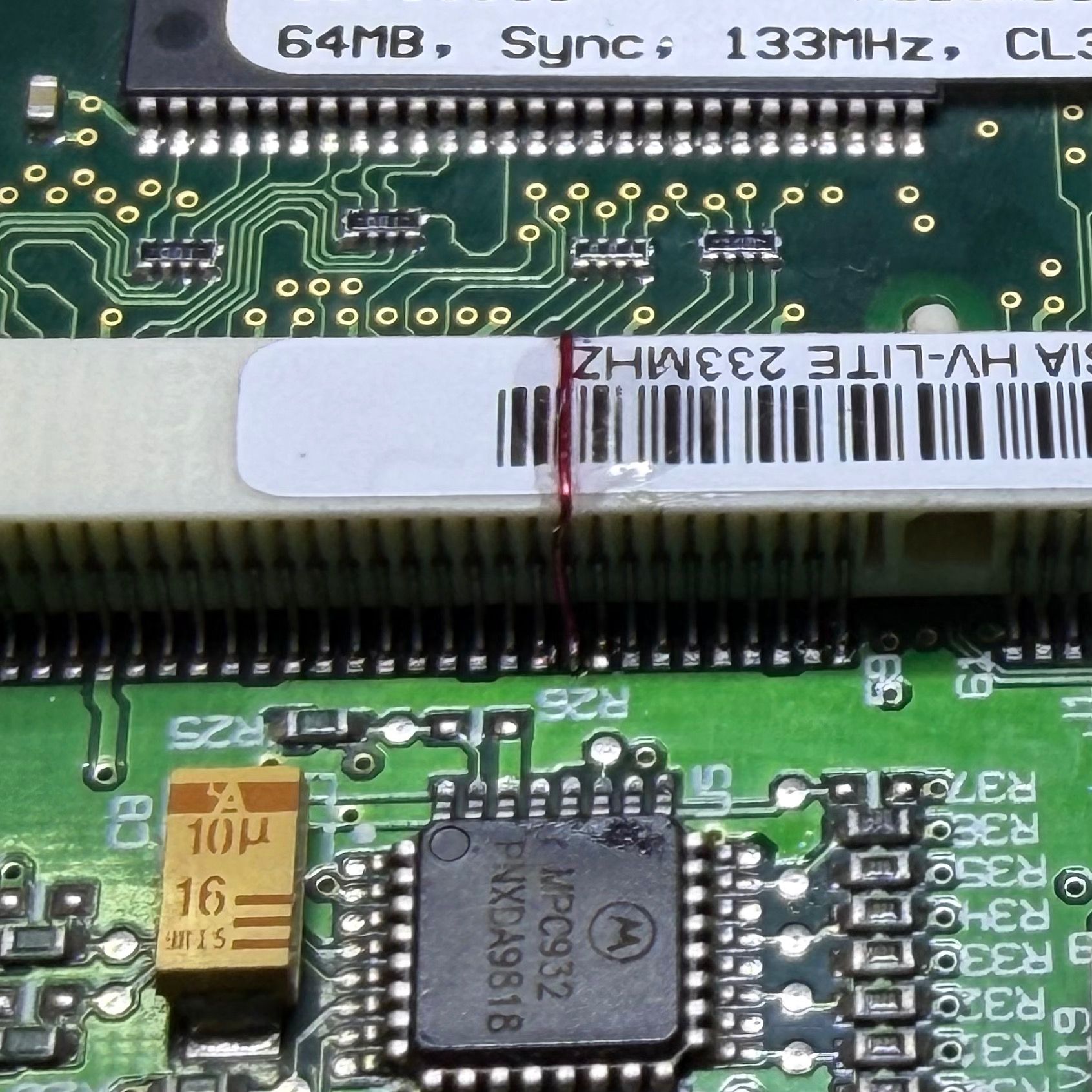

64MB RAM is OK for Classic MacOS, but barely adequate for *nix. The Rev A iMac should support 128MB+128MB in its 2 144-pin SO-DIMM slots. But reports noted pickiness and differed as to whether PC66 or PC100 is needed. I wasn’t having much luck trying assorted sizes and latency DIMMS to work .. and then I examined the expansion socket under a microscope: there were about 3 dodgy pins - d’oh!! One pin was a redundant ground line, one bent back into place OK, but another broke off completely. I’ve replaced 66-pin SIMM sockets but I was hesitant to replace the SO-DIMM socket wholesale on this dense CPU daughtercard. I wound up running a bodge wire up the side of the socket and down into the broken pin. It worked .. although I don’t intend to switch DIMMS ever again. 256MB is fine. I found one 128MB PC66 stick in the base slot and a 128MB PC100 stick in the expansion slot worked.

At this point, I started getting video artifacts, and the MacProTest VRAM tests failed for the expansion slot. Maybe the SGRAM socket was dodgy also? But no .. the socket looked good. I used contact cleaner and deoxit to sort this out.

This is awesome. I just picked up a Rev A iMac in remarkably good condition and am planning to do some maintenance/upgrades on it. First up is the CD drive, as I just keep getting "This disk is unreadable by this Computer" errors, no matter what disc I pop in there. Hoping that I have the same luck with the CR-176-B drive that I found on eBay...
Do you have any recommendations about replacing the drive bezel? Anything to do/avoid to prevent breaking those posts?
Just be careful .. 30 year old ABS is dicey!
Apart from what I reported, I'd suggest not refitting the bezel until after the whole motherboard module the drive has been re-installed. I found that slotting the cpu module into the machine with the correct alignment risked breaking the bezel off - especially if the bezel posts are weak.
Yeah, that makes sense. The silly drive bezel is the #1 thing I'm most concerned about with this retrofit! I'll try to remember to post some updates after I get the new drive in.
