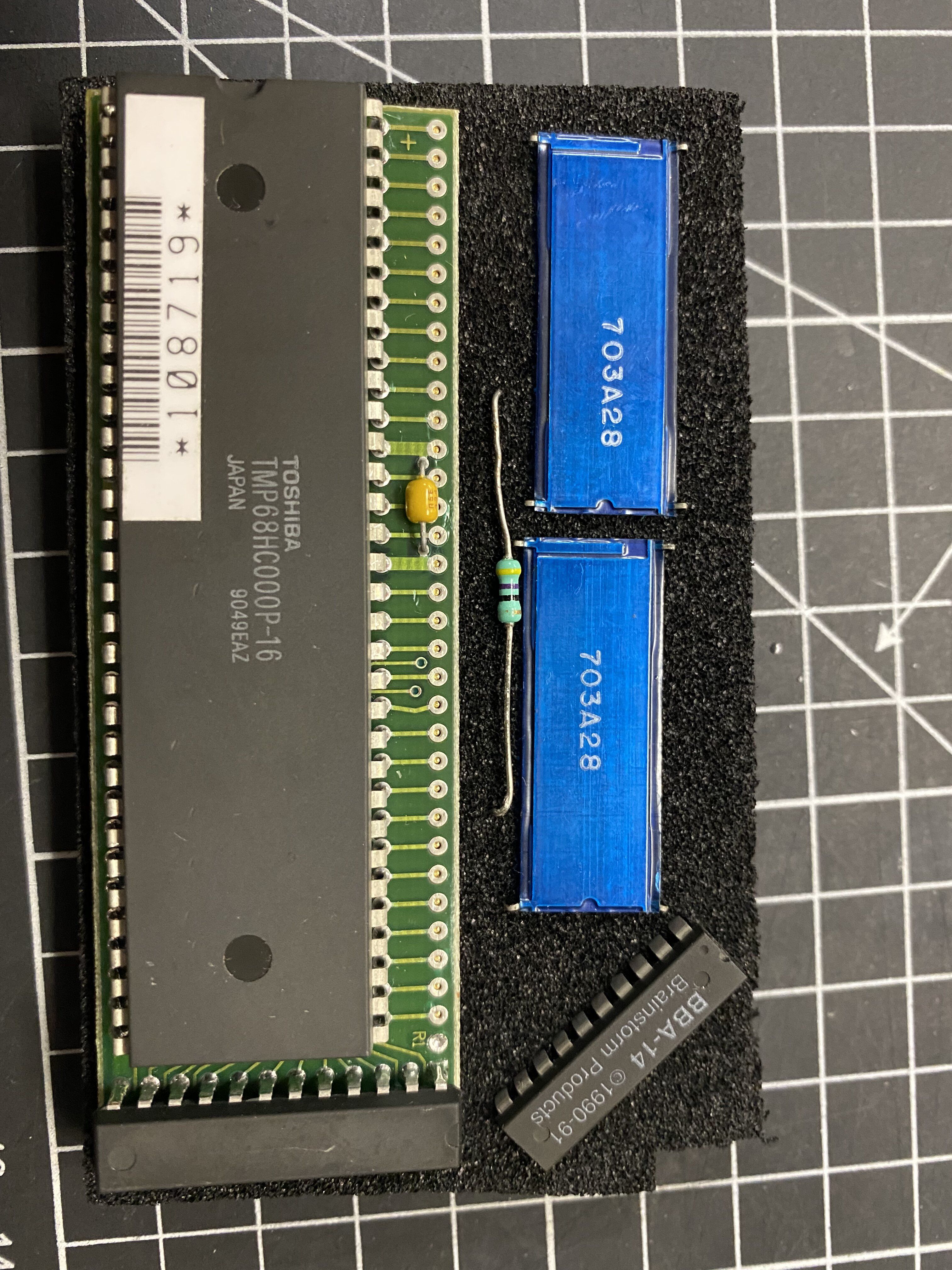

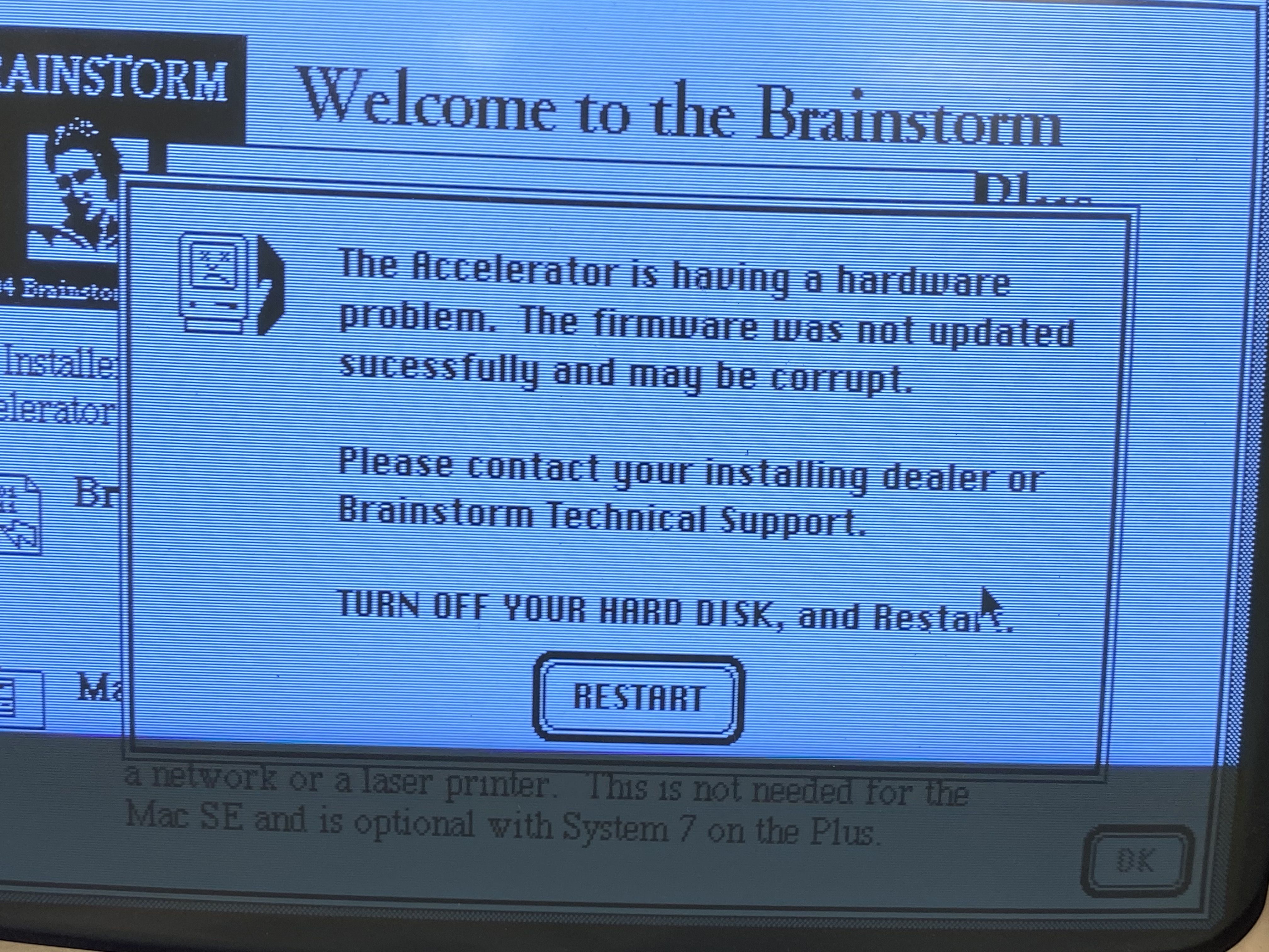

I actually have a board with BrainStorm installed.
However, it doesn't have a BrainStorm screen at startup, and after booting, the BrainStorm software gives an error when updating the firmware. Possibly the GAL seems to be broken. If you know what GAL chips they are, I may be able to flash to the farmware with an update from an empty GAL, but that's just my imagination.
And there is a blue plate under the genuine ROM (HI / LO), but if I remove this, it will be a SadMac. The blue plate has terminals at all four corners, each with no continuity.
I can sacrifice this board if reverse engineering is successful. Of course, I would be most happy if I could get a GAL chip. However, the board as it is is just garbage😂

I just removed the broken Brianstorm from my board. If anyone reverse engineers, I would like to offer this for free. However, there is a premise that you will definitely challenge it. I would like to give it to someone who can get started immediately without procrastination.

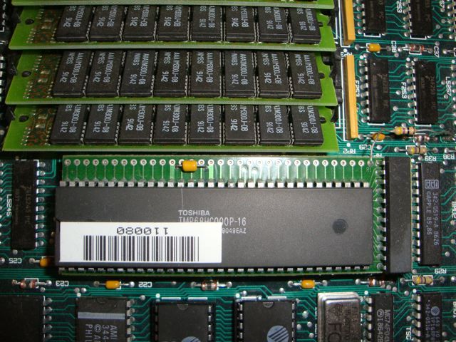

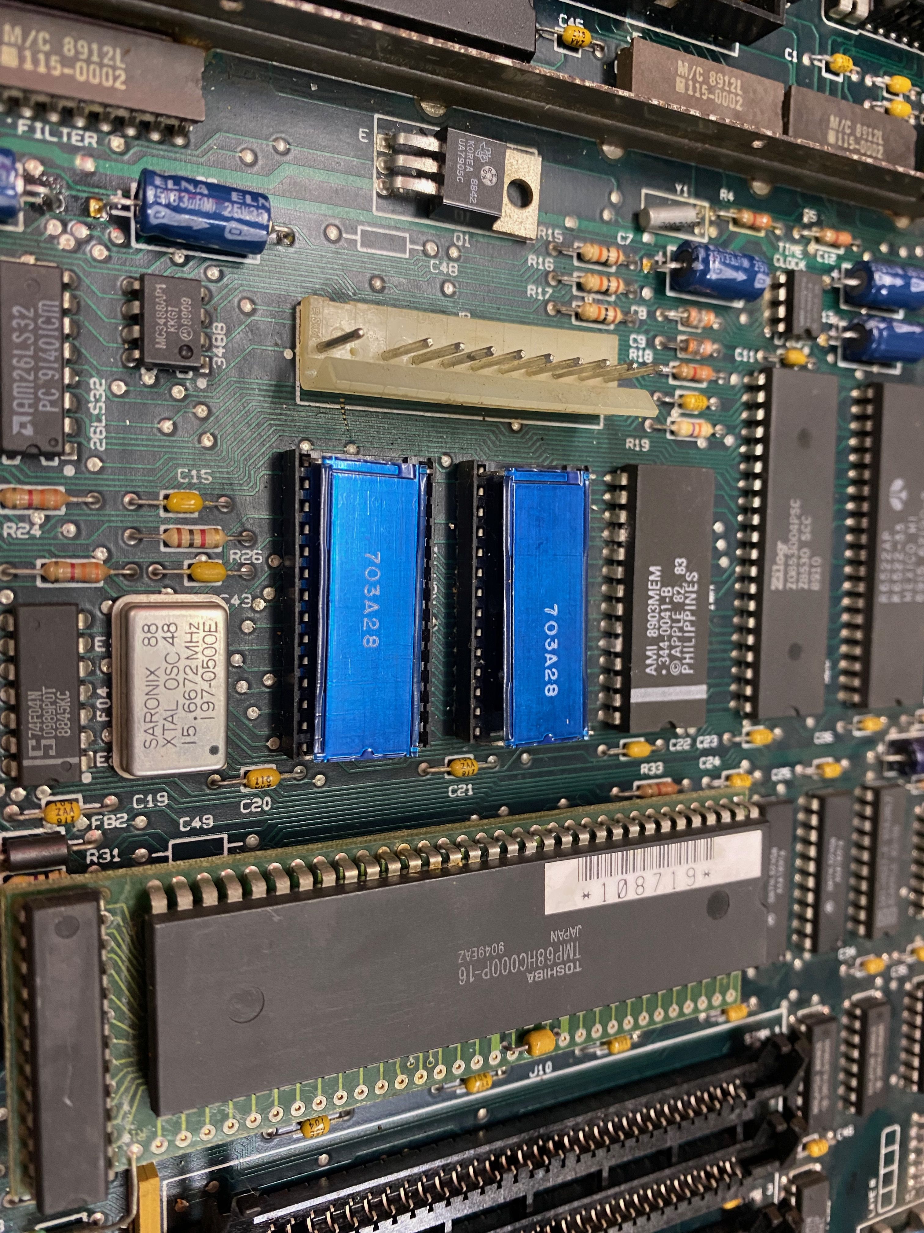

I have a mac plus with the brainstorm. I was able to update the firmware and it did help with the sound.
Its also kinda interesting because it accelerates via upping the bus. So you need to make sure you have fast ram for it also.
My computer is unstable. I'm not sure if its the brainstorm or if its something else.....
The Brainstorm is clipped over the existing 68000 so it could be a contact issue.
