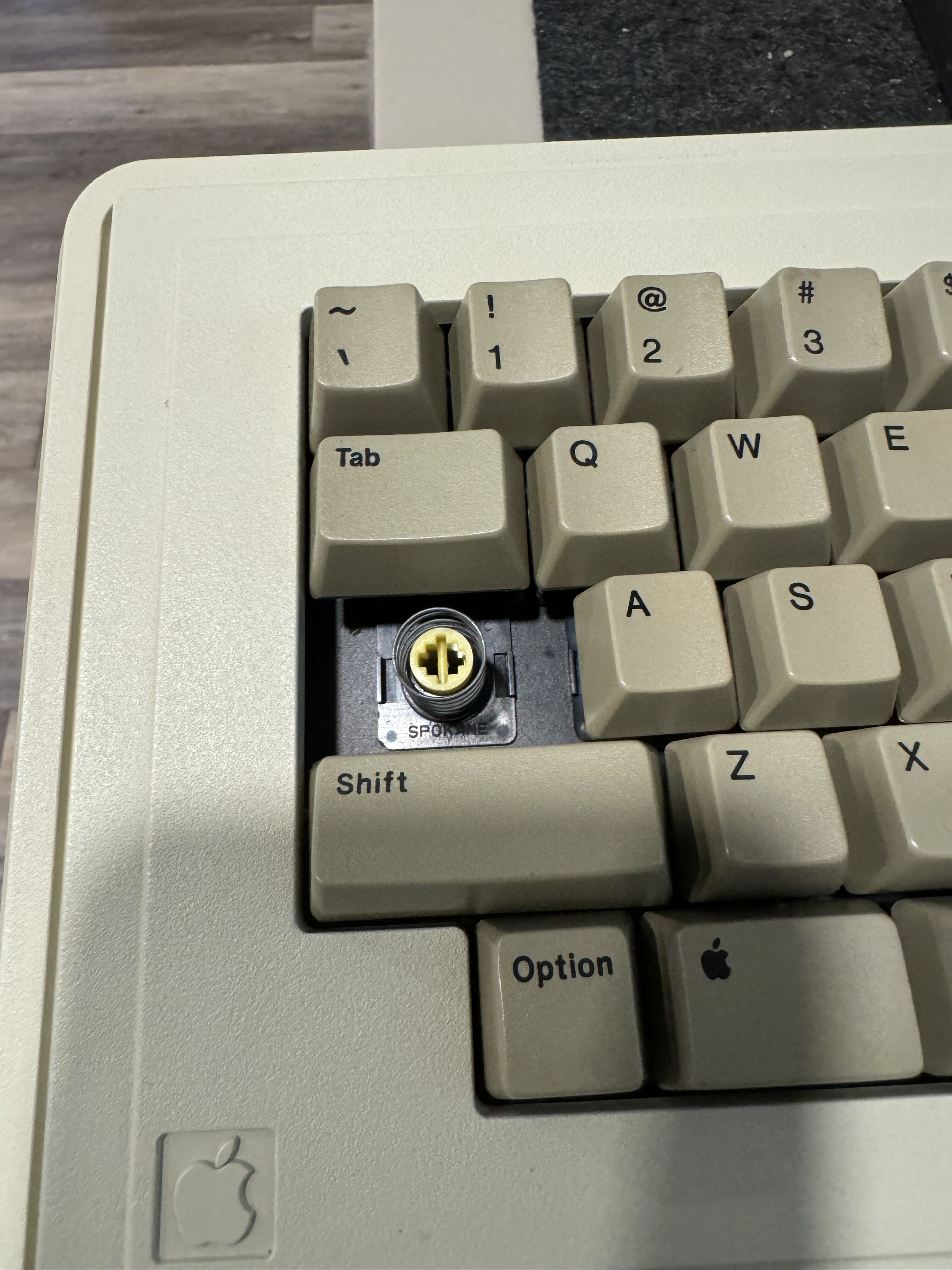

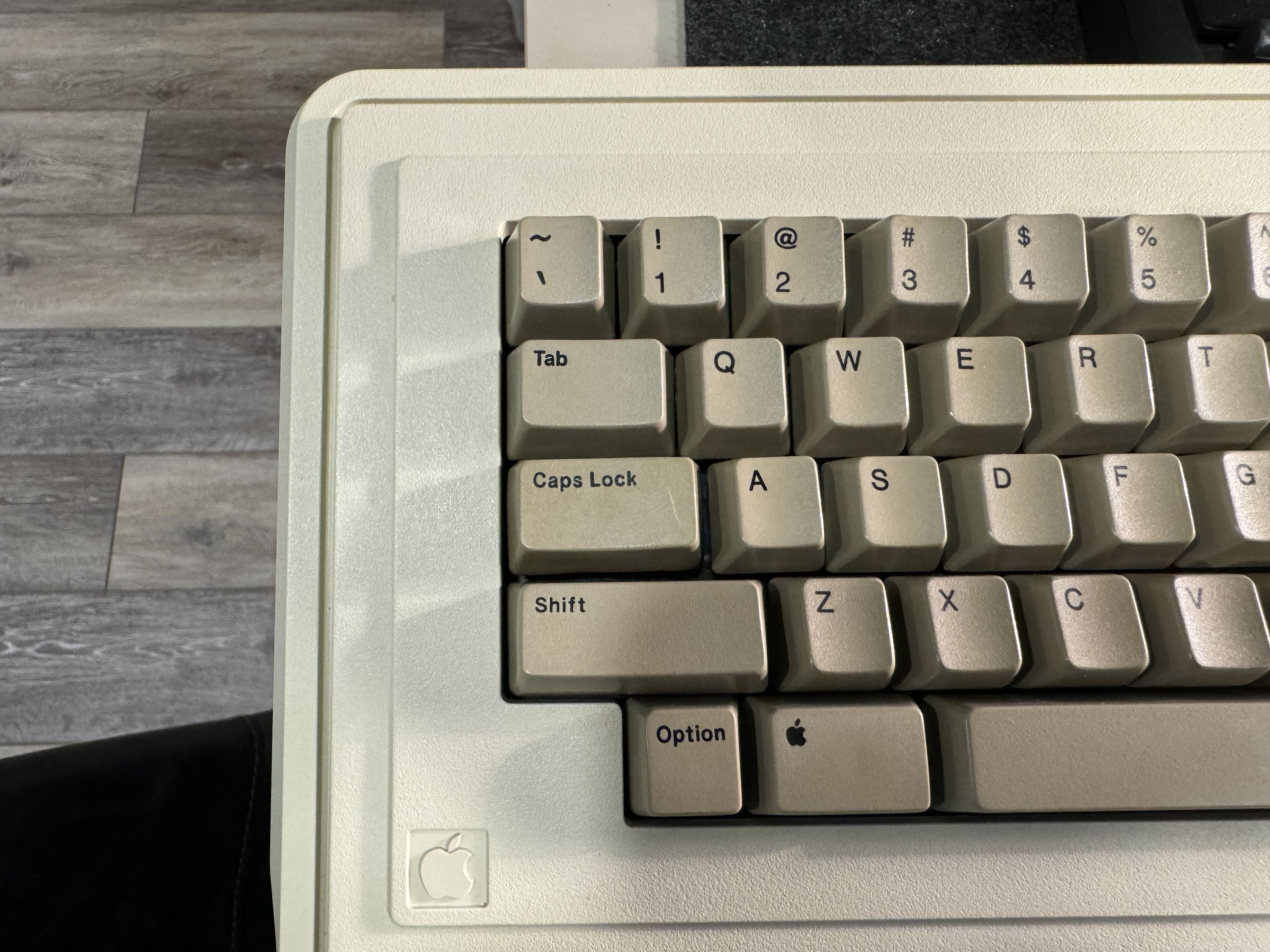

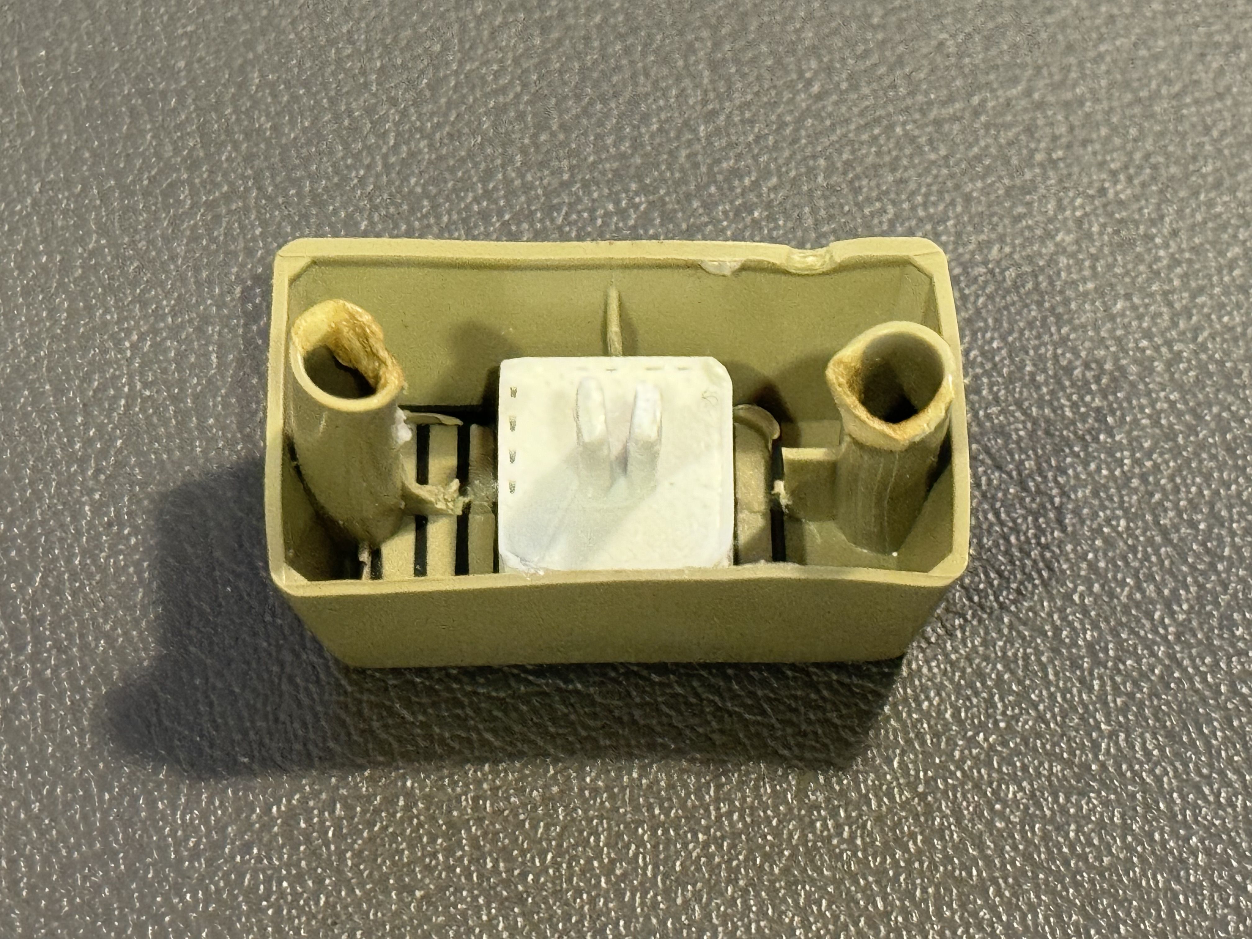

So, I had picked up a Lisa 2/10 a while back. and while removing the key caps for cleaning, the kegs on the Caps Lock key broke. I tried various methods to re-attach the existing legs, but was unsuccessful at getting them attached, at the correct height, and the correct angle. I even tried using heat to correct the angle and ended up melting some of the bottom of the key cap (don't use a heat gun!).

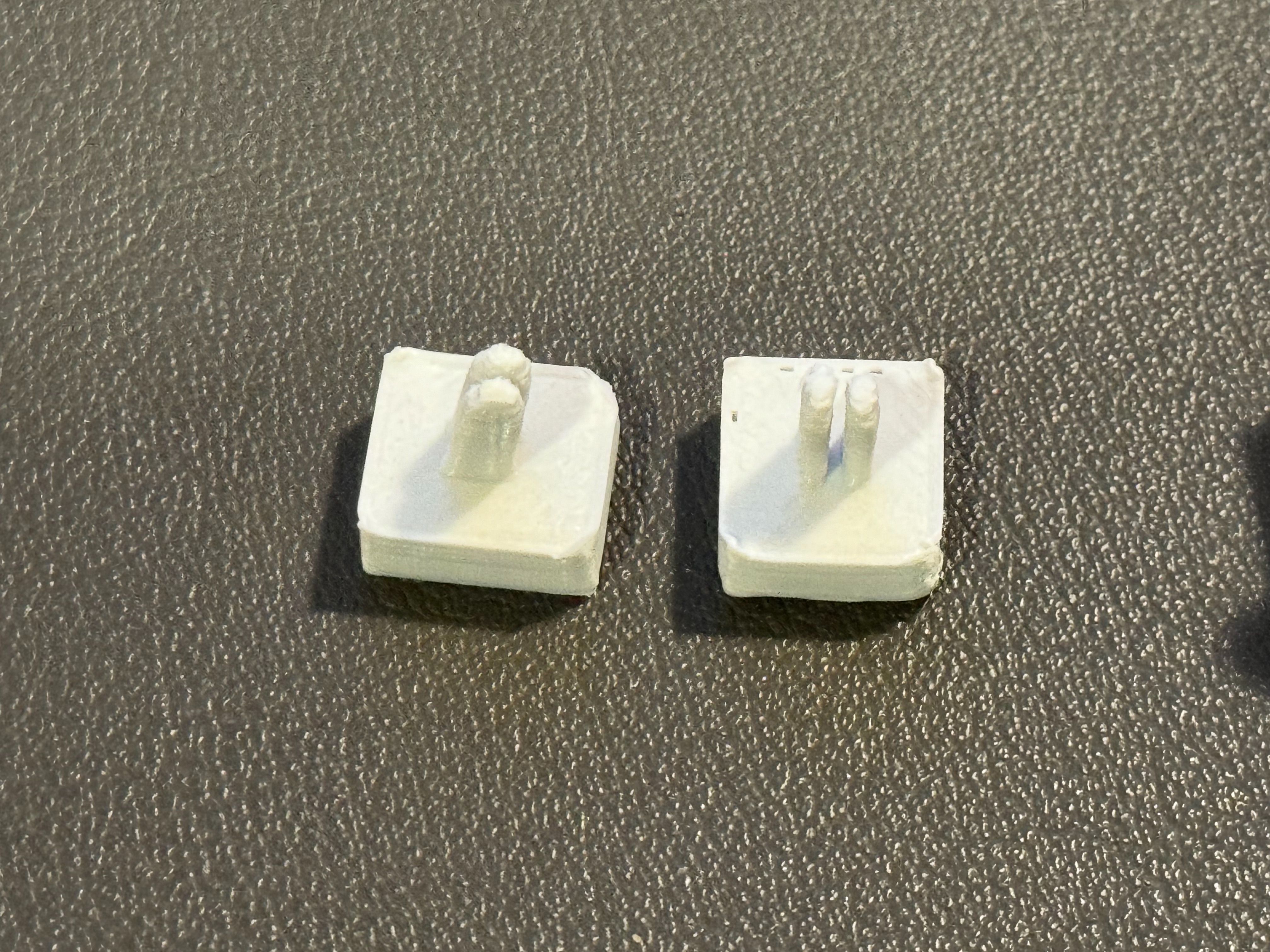

I have a 3d printer and almost no knowledge of 3d modeling, so what better idea is there than to try to replicate the legs and support section of the key caps!

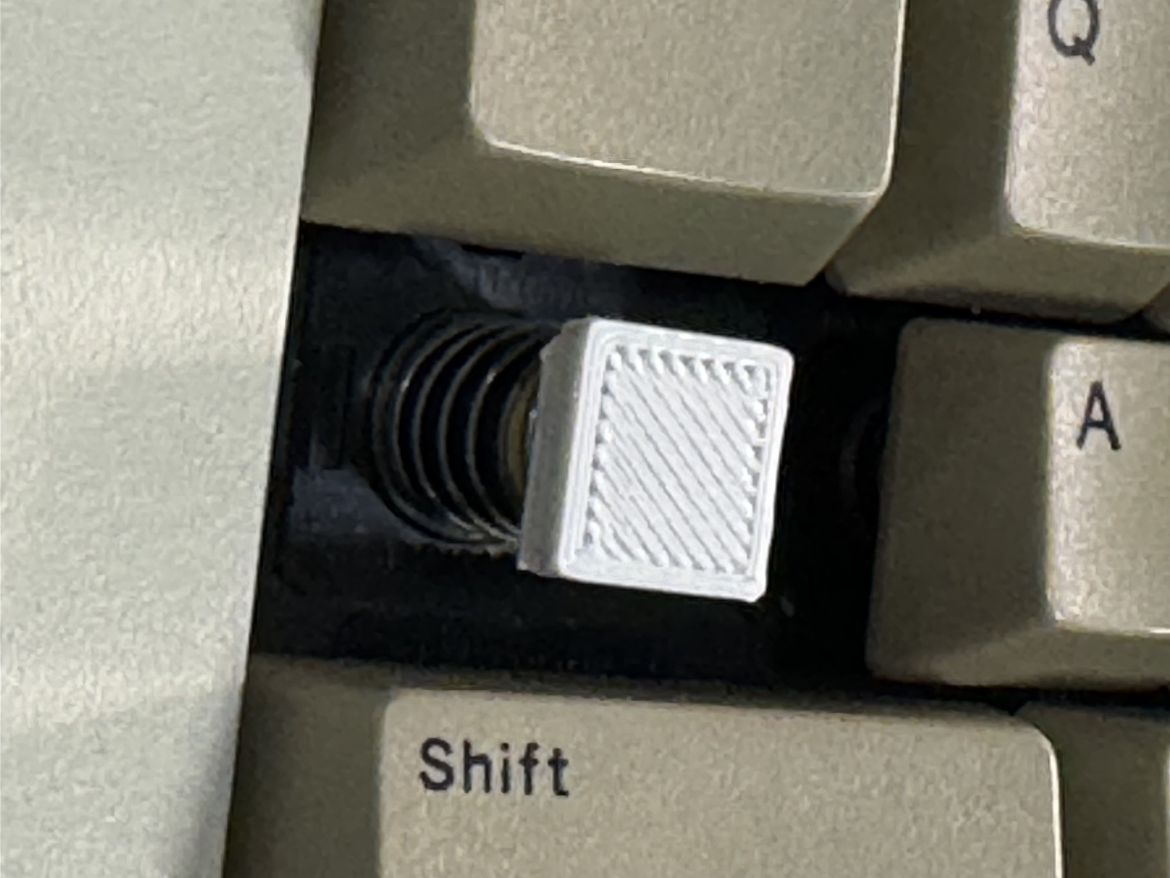

I had a general idea of the sizes I was dealing with from other, intact key caps, so I modeled up 3 different variants at slightly different angles. I then hollowed out the underside of the key cap, put the 3 different leg replacements on my keyboard, and picked the one that fit the best and gave me the matching angle. I am actually not sure, but I think I used the 10 degree version for my Caps Lock key. Either way, I'd print multiple since they are quick to print. I then used plastic epoxy to secure the key to the leg replacement, making sure it was centered in the space with the surrounding keys.
