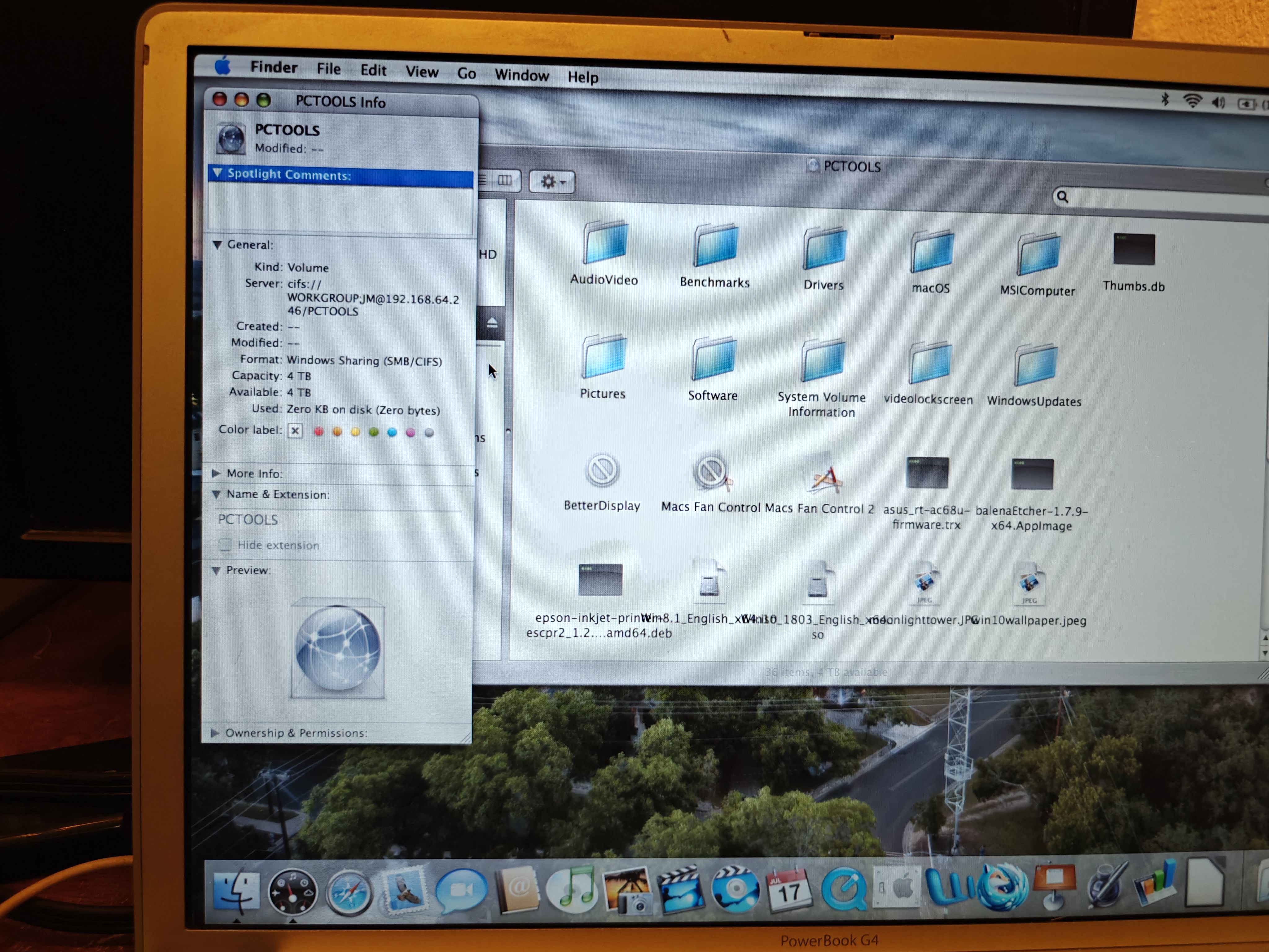

Maybe Mac OS doesn't like something about the size of the share? I noticed on Tiger (the only version that half-works) it only shows 4TB, even though I have 14TB in the NAS:
Tiger only supports up to 2.2T so while it might see a larger drive, it’s going to have problems accessing it. I have a 2T share for my old PPC macs and they see & connect to it without issue.

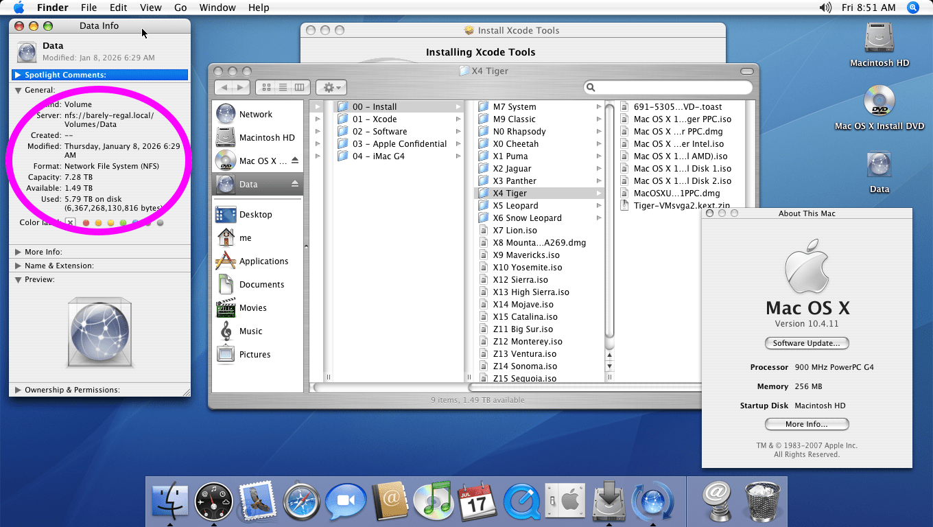

Sorry, I don't have experience with true nas. But I do have experience with file sharing on these versions of osx... even back in the day when they were up to date. I think I am safe in saying their SMB support was never good. It was truly an afterthought by Apple to check the windows compatibility checkbox. In the modern day, the only way I find to reliably file share with them is with NFS (because modern macOS no longer has an AFP server). I do this for all of my real and virtual machine Macs and it's super reliable once you get it set up. I even share an 8TB USB hard drive from my server this way. It even works in OpenStep (Mac OS X predecessor).
I did a quick google for truenas NFS. Is it possible you could explore this? https://www.truenas.com/docs/core/13.0/coretutorials/sharing/nfsshare/

From the old OS, you connect by using connect to server and then typing: nfs://my-server.local/Path/To/Mount
I will provide the exports file from a modern Mac that allows these old systems to connect (but sorry I do not know how this is translated into truenas)
Also see attached screenshot that shows Tiger can easily see a network volume that is 8TB
Code:
me@Barely-Regal ~ % cat /etc/exports
/Users/me/Developer -mapall=me:staff -network 192.168.0.0 -mask 255.255.255.0
/Volumes/Data -mapall=me:staff -network 192.168.0.0 -mask 255.255.255.0
