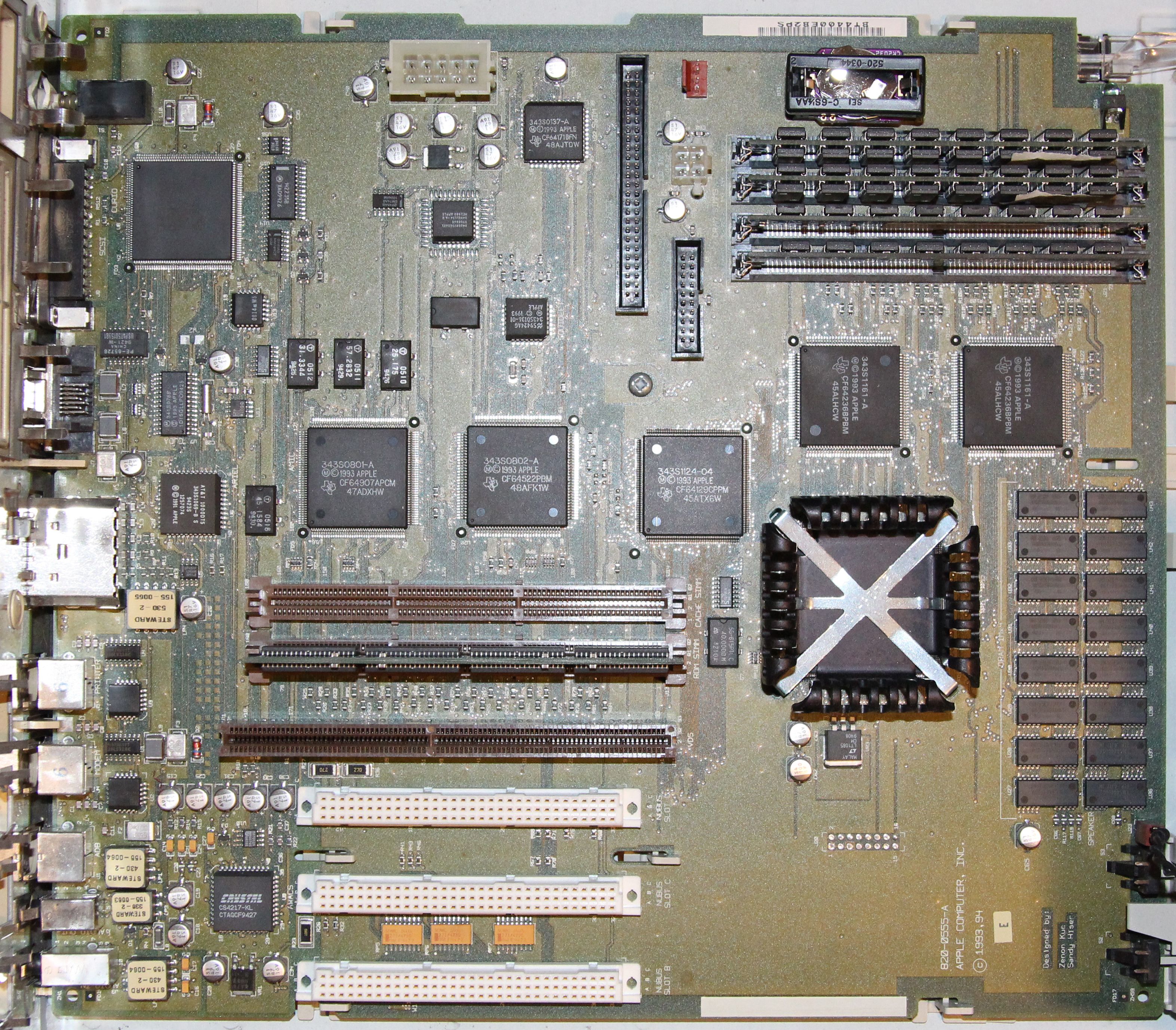

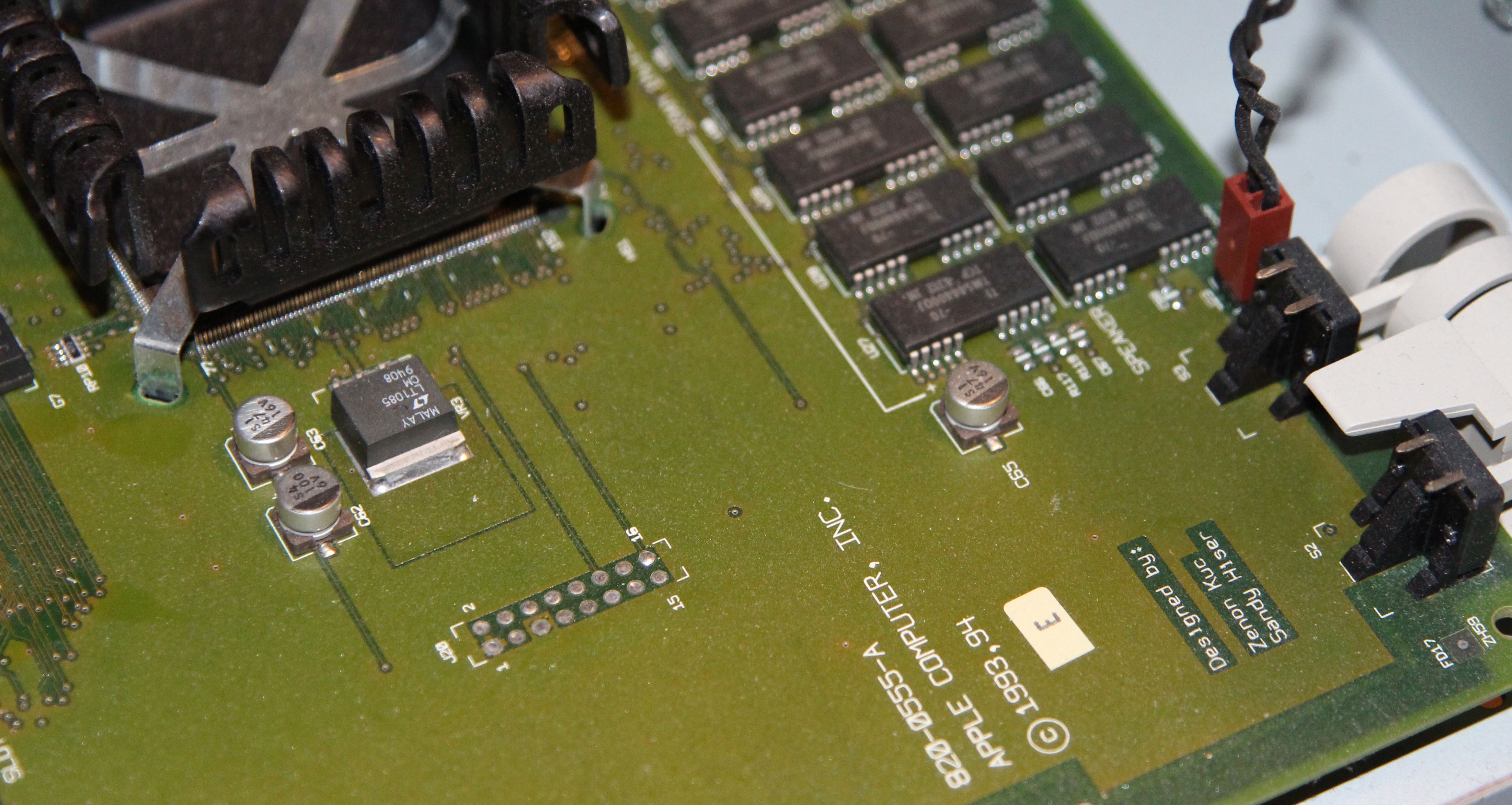

While no component will work forever once you start getting into the early power mac's like the 6100/7100/8100 I haven't seen them leaking much yet. That said you should visually inspect them and look if there is a wet looking substance around your caps. I don't have a 7100 motherboard in front of me but I'd guess the majority of them are 47uf 16v which can be purchased from mouser/digikey in the US fairly cheap.
If you could share a few photos we might be able to help identify and give a recommendation.
Also consider your skill level - if this is your first recap and you've not soldered before you can cause more issues with preventative maintenance. But if you want to learn too you shouldn't stop yourself from trying either, just learn on a few other scrap things first.
RE: PSU's - that starts to get even more tricky the later you go with different manufacturers of PSU's in the same models of machines. Usually you'll have to create the cap list yourself, measuring spacing, etc. Again if it's working well (voltages stable) and no visible leaking, it may be better to leave it.

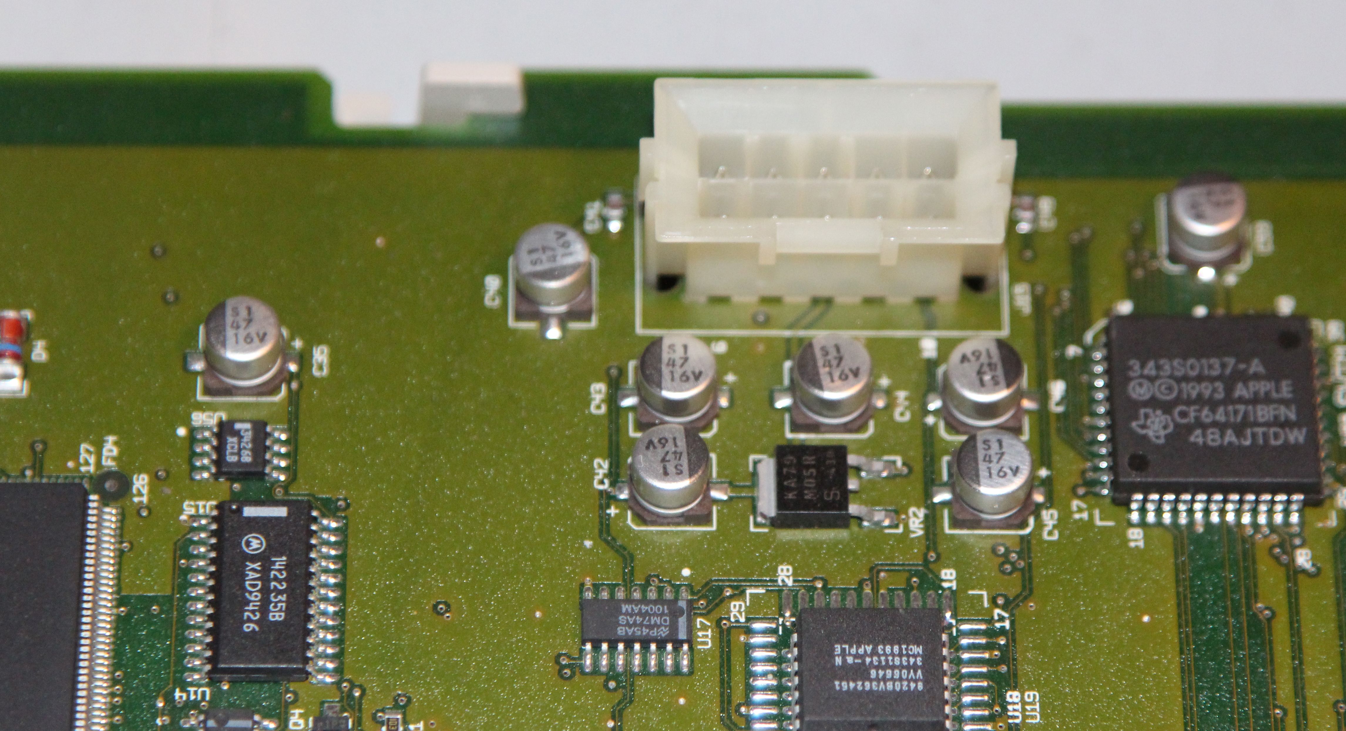

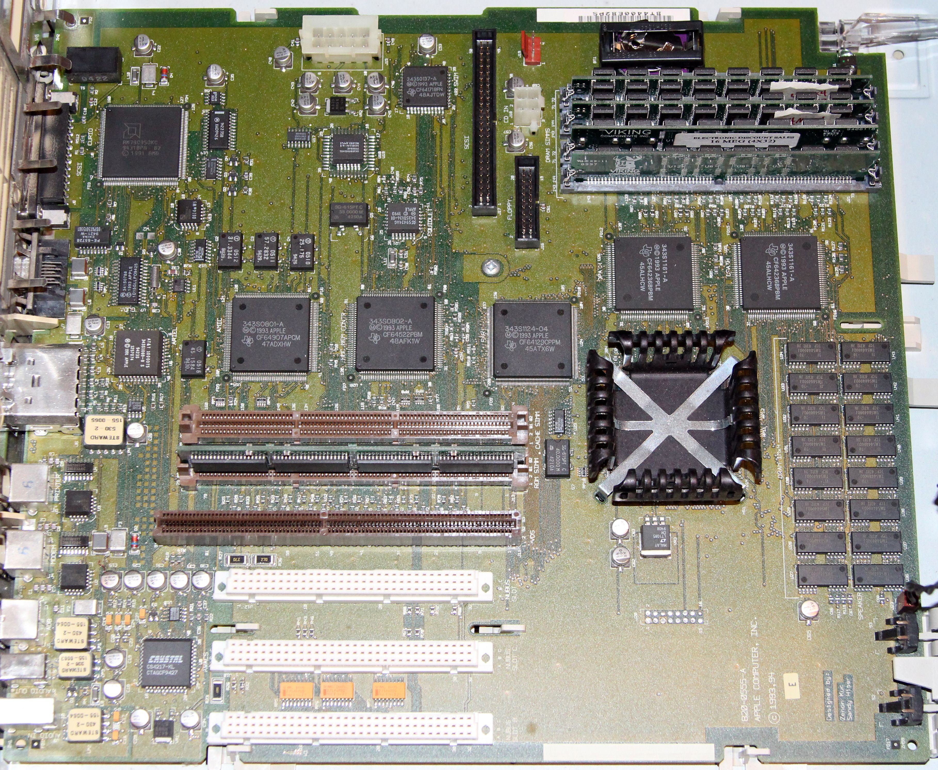

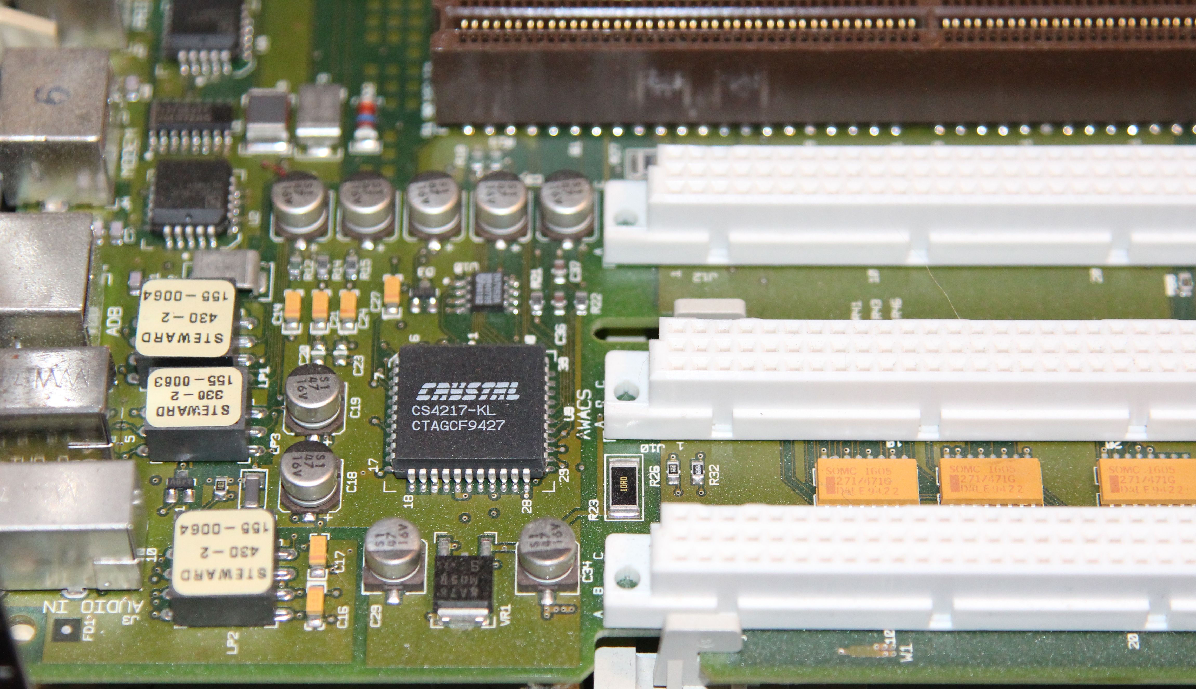

Since my 7100/66 was accessible, I pulled the cover and power/drives and took some photos for you.

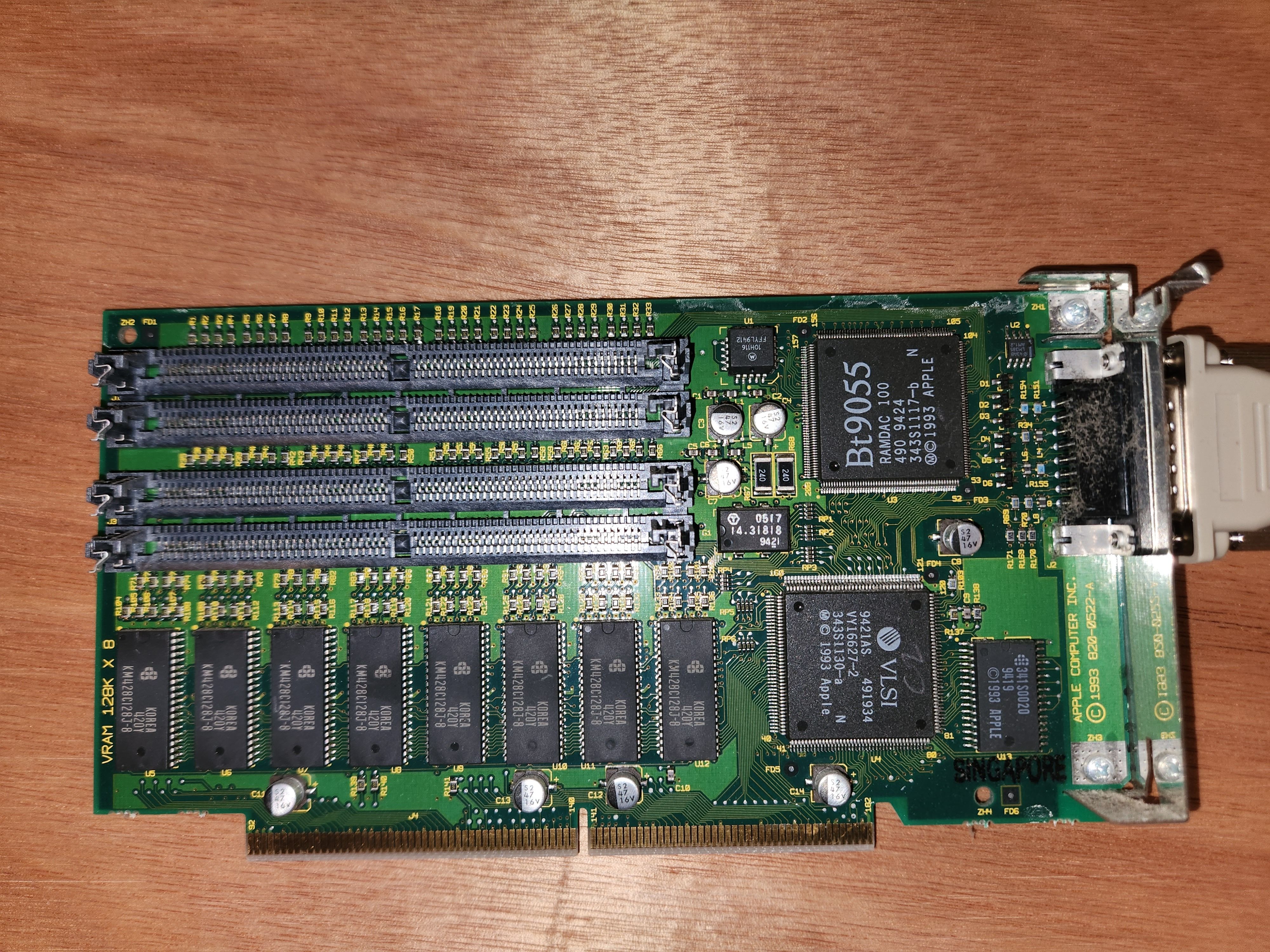

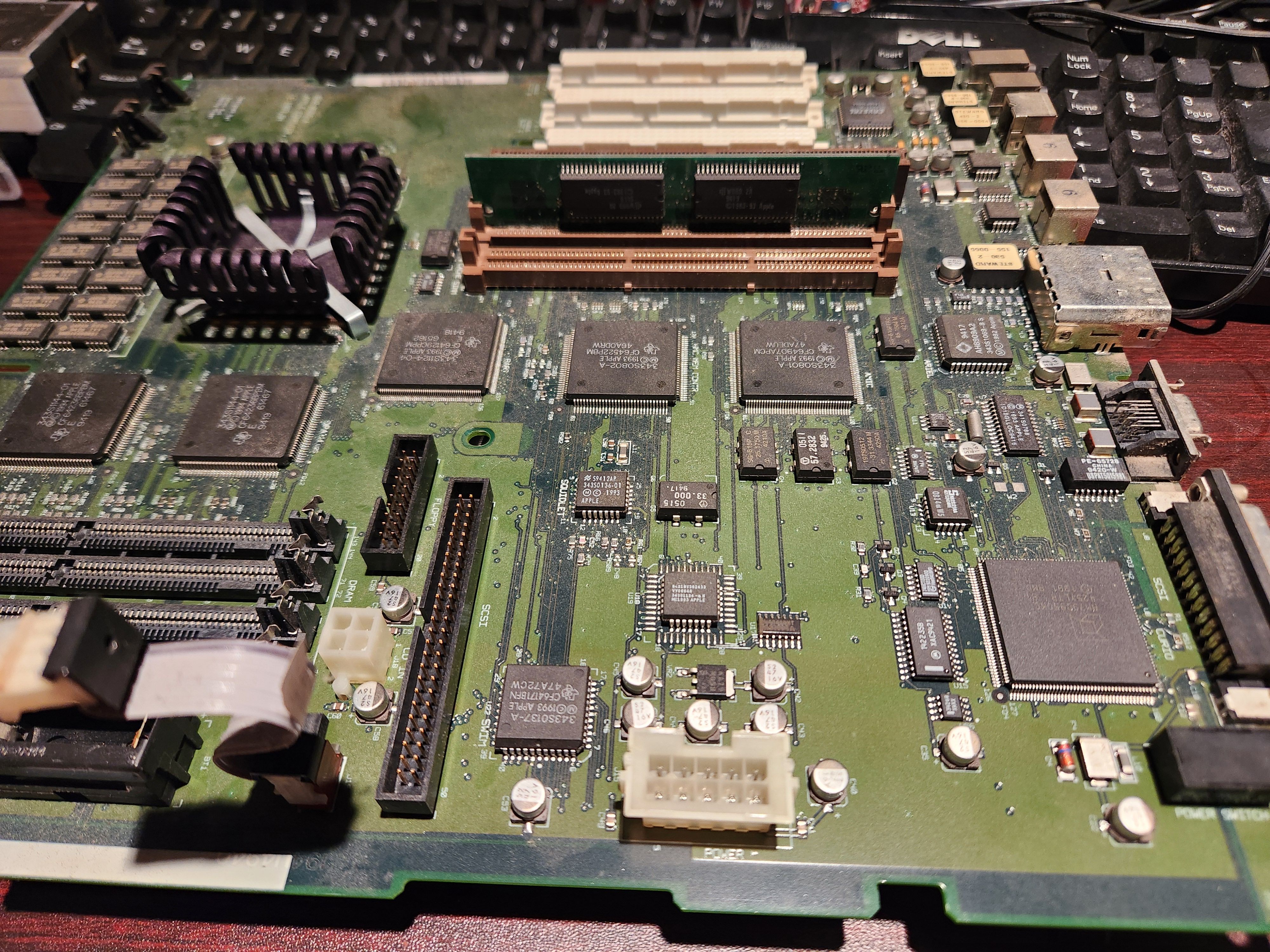

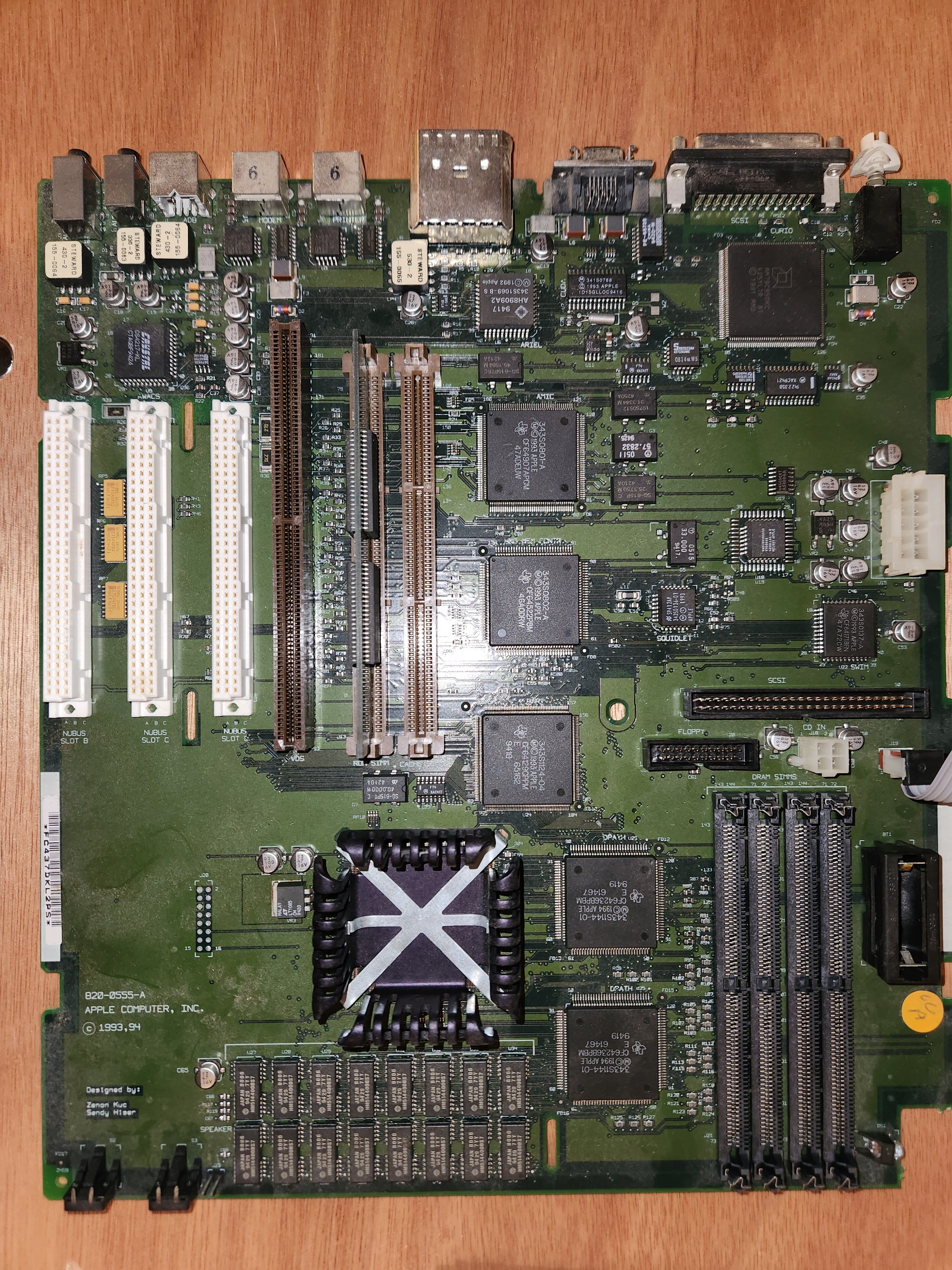

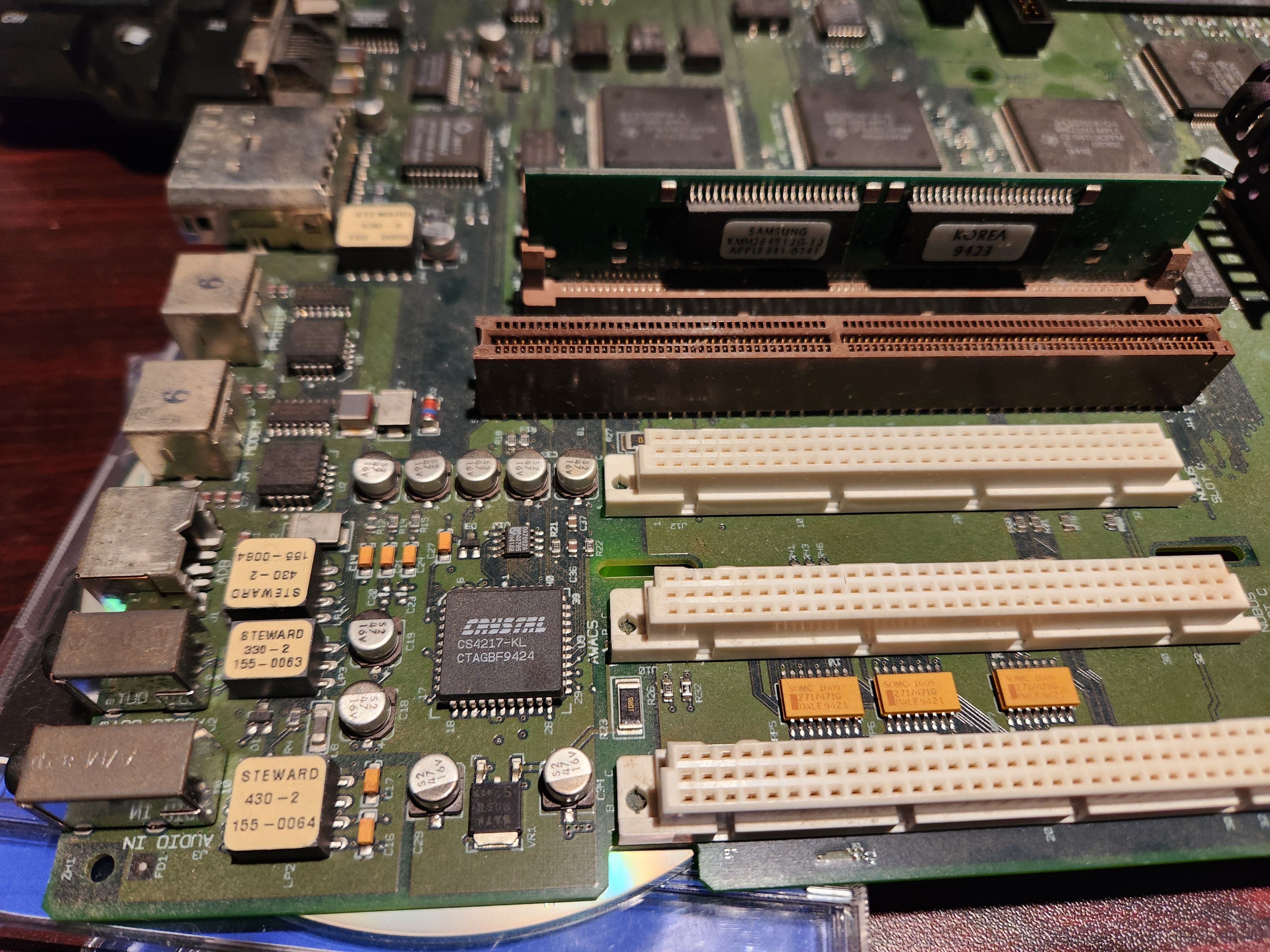

Here's some photos of mine.
Mine looks quite similar to yours. So, not bad, it seems.
I see that Colin (TDNC) often performs an alcohol bath. Would that be good here? I used some canned air to blow off dust, but there's still room for improvement.
Any suggestions would be appreciated.
Thank you!
