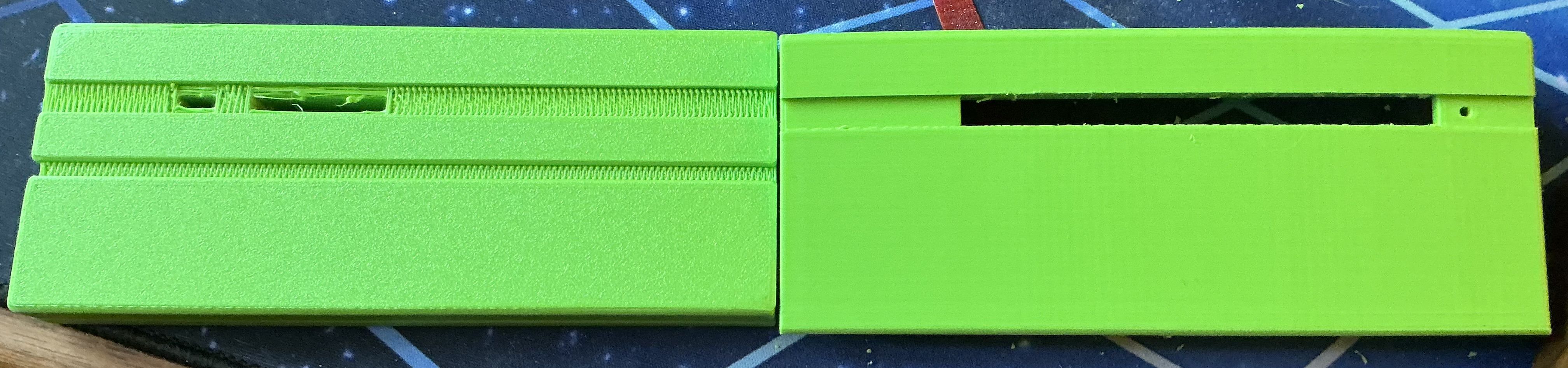

When it comes to the case parts though, I'm wondering how folks are setting up supports to print these properly. With the Polar PLA filament, I'm having a heck of a time with supports both fusing to the tabs, and the SD card slot. I've already had to turn down the temps used with the Polar PLA because it does like to ooze more than the usual PLAs I use, and I've tried both tree and snug supports, both with similar results. I feel like I'm missing something obvious, but I'm wondering if anyone has tips for these.

I have a partial solution to the issues I was having with the supports: print in PETG instead. Being softer, it's easier to get an exacto knife into the SD card slot and slice away the supports, and less likely to result in me injuring myself than with PLA supports. The result is pretty clean, too. The tabs still give me grief, but this is probably the project that makes me jump up to a larger printer, which I've been putting off since I sold my previous large printer (a Voron). Since Polar has PETG in Retro Platinum now, I have that on the way which I'll use for this project.
I've also been playing with a modification to the case design to specifically account for the taller SE/30 ROM SIMM. The first attempt was to just split and "extend" the whole bottom piece. Only to find that once I brought up the whole assembly, it looks rather silly. Second version extends just the posts, and then extends the top shell to keep everything aligned. I think it looks better, but not yet sure if I should go with option C, which is to extend the bottom a little, and the top a little. Since I'm going to be waiting for upwards of a week before it's time to print the final parts, I've got some time to iterate.

I've continued to play around with a few different tweaks. I've reduced some of the need for supports in the lid model. Comparing to the less-altered tall version, it cuts total print time by around 10% (1hr) and uses a hair less material (20g). I can probably get a bit more aggressive with it, but not much benefit there.
I also played around with splitting up the top lid into two parts. A faceplate in the Macintosh IIx style, and a lid that screws into it. The thinking was that the faceplate could be printed face down and reduce the need for supports further. Eliminating the need for supports entirely if the faceplate takes on the duty of the lower lip as well. Unfortunately, because the LED and SD Card slot need to bridge across a bridge to get the size right, it didn't turn out all that well. Would need more work before it's remotely acceptable. Not sure it's worth it here, and not completely sold on the look of an "SE/30 with a IIx body" yet either.
