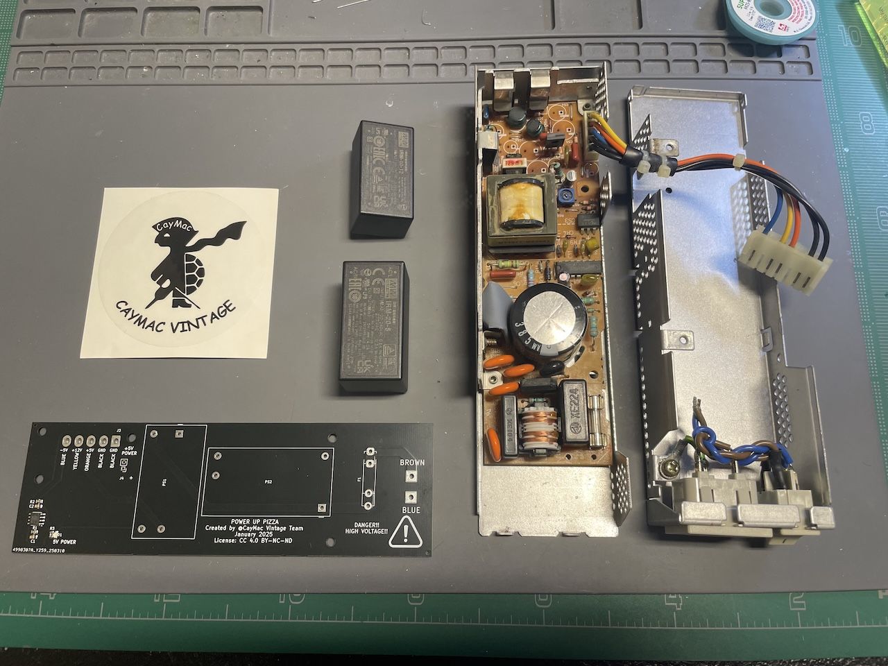

I purchased a couple of these PCB only boards from CayMac Vintage a while back and wanted to post my build experience.
I ordered the required Mean Well power supplies from Mouser:
IRM-10-12 (12V 0.850A)
IRM-20-5 (5V 4A)

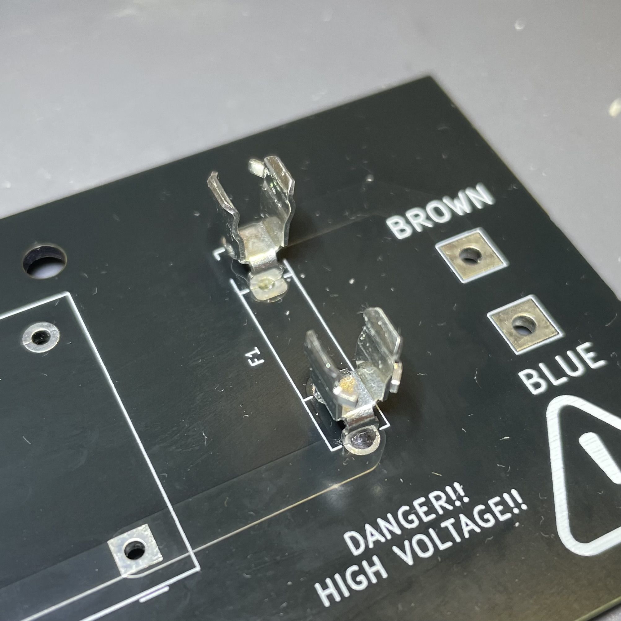

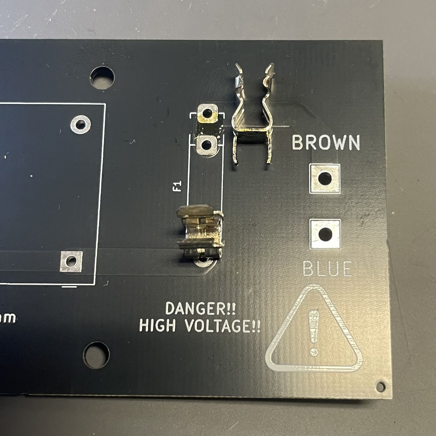

And planned to make use of a dead TDK power supply (from an original LC) for the case, logic board connector, mains power/switch and fuse holder. All good except for the fuse holder, the TDK 699-0153 power supply's fuse holders have through hole connectors 90 degrees different from what the replacement board needs.
Decided on these, which also seem higher quality than the originals:
Littelfuse Fuse Clips ACS PC 5MM CLIP BRASS/TIN-PLTD

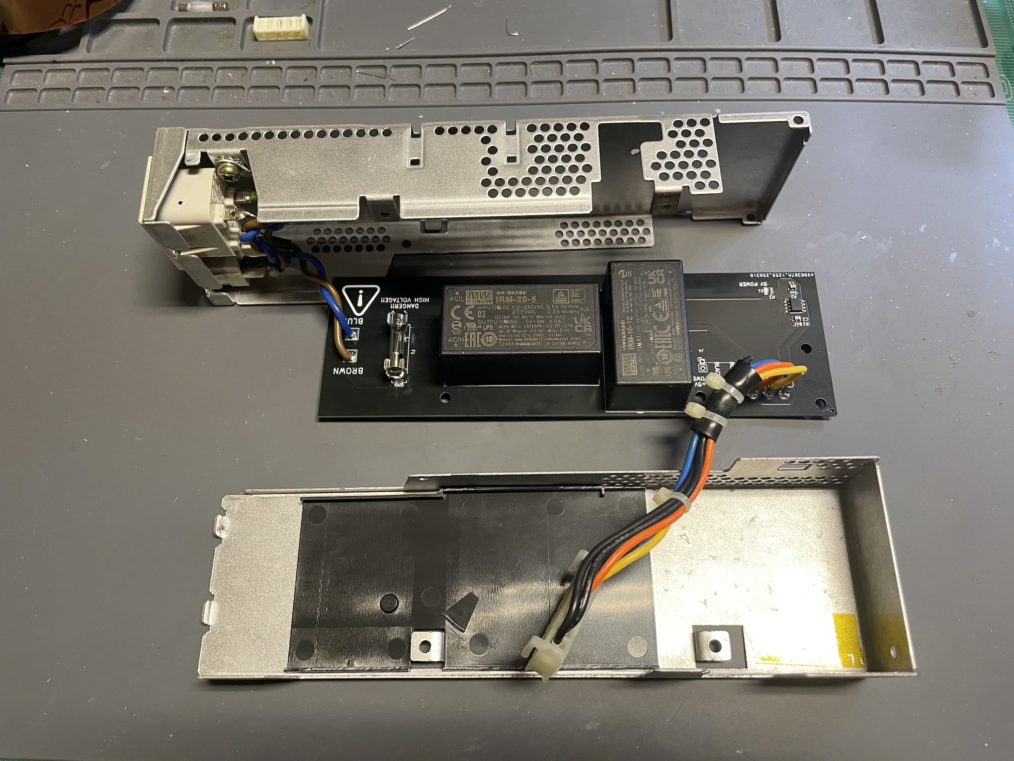

Putting it all together I decided to use the bottom black plastic piece from the original PS, just had to snip off a "fin" that went through the original board next to the largest capacitor. I also put some Kapton tape under where the logic board connector would come close to the metal case but after it was all buttoned up that wasn't really necessary.
I had a little fun making a "POWER UP PIZZA" label with the CayMac logo (@Willj please don't sue!):
Works like a charm, tested in LC, LCIII and Q605!
