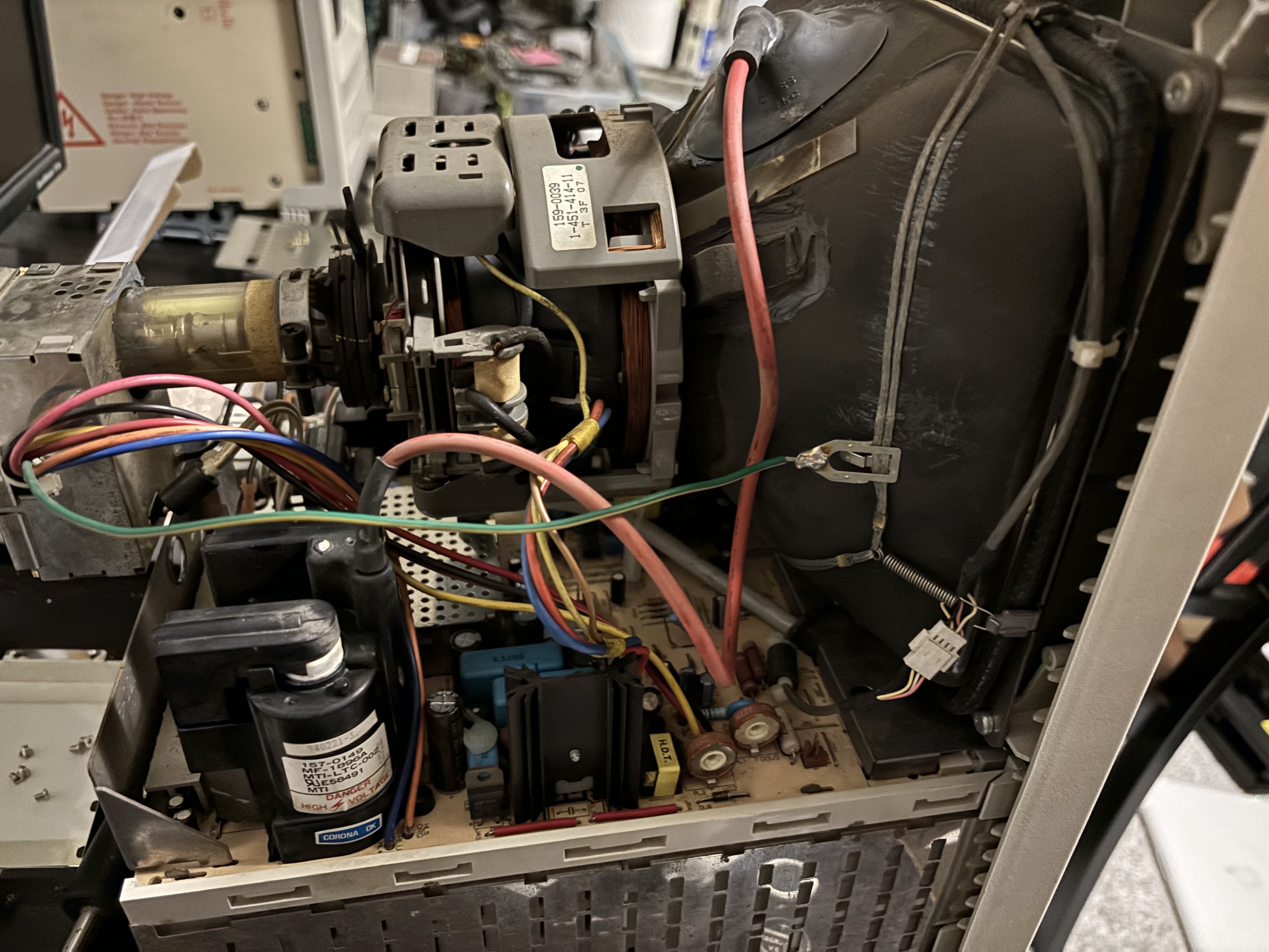

Yesterday I decided to open up a Color Classic I’ve had on the bench for a while. My Post-It note said that the analog board was inside, but the caps were removed… cool! I opened it up and got to replacing them. Strangely, I noticed some flux residue and fresh solder on the leads of the flyback (part 157-0146). Strange, not something I remember doing.
After the recap, I was delighted to have a crisp display with near-perfect geometry. But wait, was that a click I just heard? Oh yeah. Now I know what someone was trying to do with the reflow.
A few years back I bought a couple of spare analog boards for the 5xx series all-in-ones, and still hadn’t done anything with them. Decided to take the plunge and remove a flyback from that analog board (Part 157-0149) and solder it to the recapped CC analog board. Went in just fine, although the lead is much longer and the flyback is slightly taller than the stock part.
Upon doing a smoke test, I found that the picture was extremely dim, and the image size was reduced maybe 25%. Adjusting the pots got me a little closer to the correct image size, but obviously that’s not the right way to go about things. I don’t really understand how flybacks work. My thinking was that a flyback from a larger trinitron should have no problem with a smaller trinitron, but it seems I’m mistaken.
Just wanted to share these results in case anyone has thought of a similar thing but been afraid to try it. It works, kind of. Now you know.

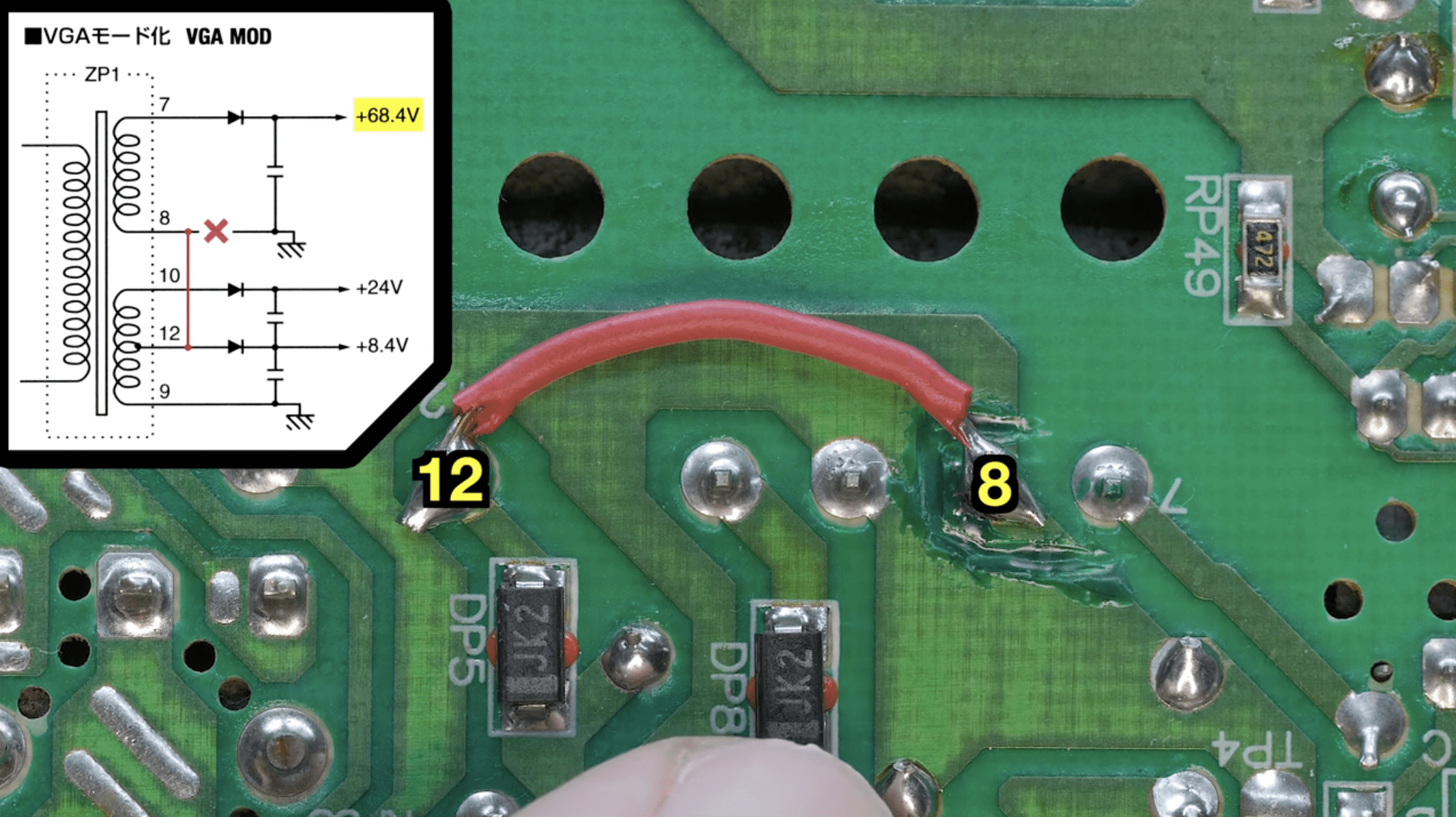

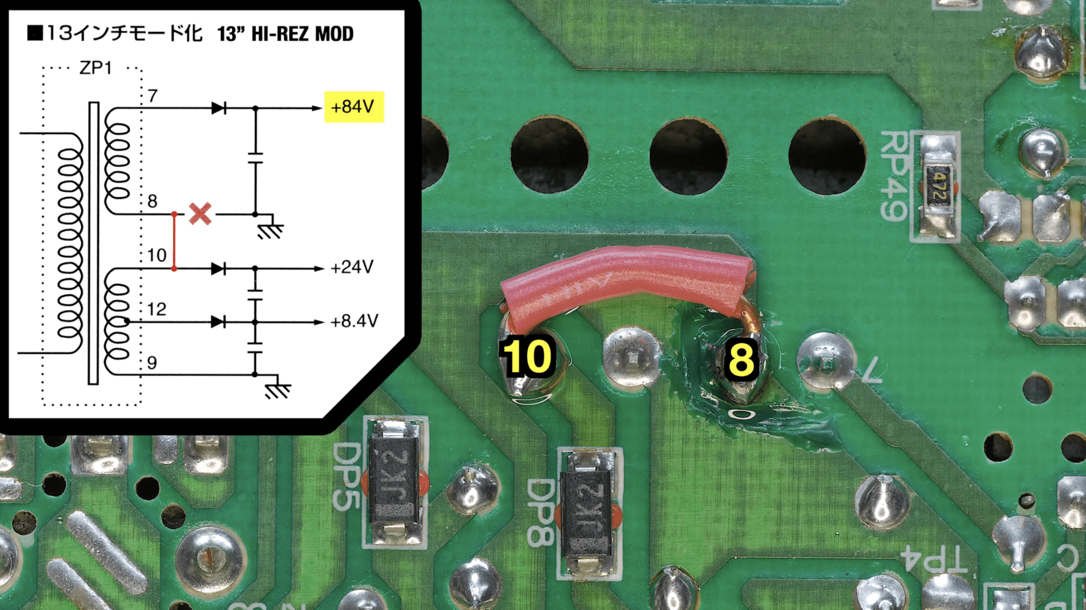

So, it seems you tried the 84V 13" High Resolution mod but later switched to the 68.4V VGA mod, which would involve not only the change in the Horizontal Deflection Voltage (aka "B+") as shown below, but also changing the Sense Lines too (not shown below) in order to bump the resolution to VGA.
Changes to B+ and Sense Lines are most often done together, but there is nothing that prevents you from using one or the other. However, it is not practical to do only the SENSE LINE CHANGE (which changes resolution) because there would not be enough B+ voltage in that case for you to properly adjust the screen. But it is possible to perform only the B+ change without touching the sense lines (keeping your stock CC resolution). That would require you to use the POTs on back to adjust your screen width and height, but the increased B+ would give you more freedom to adjust the display area on your CRT to be taller or wider (in theory). Increasing B+ would put no more strain on your Analog Board than if you had also changed the sense lines.
If you are worried about "strain" on the Analog Board (or even if you're not), I recommend doing the BEEFY COMPONENT UPGRADE.
Do either of the B+ boost mods affect "Flyback longevity"? No one has definitively proven the increased B+ voltage has shortened the life of their flyback. My videos of both B+ mods merely show no increased heat in the flyback itself for either voltage mod.
