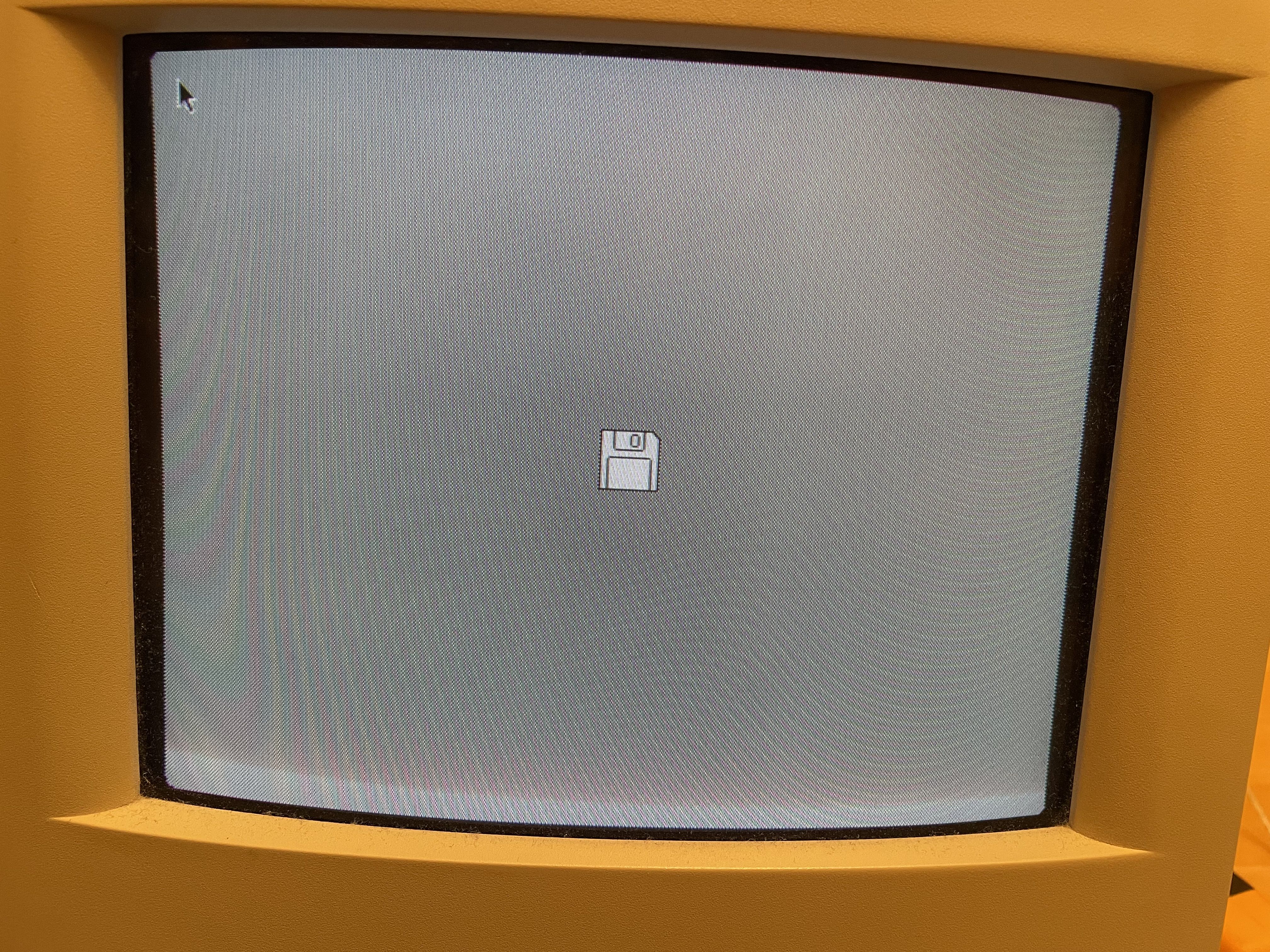

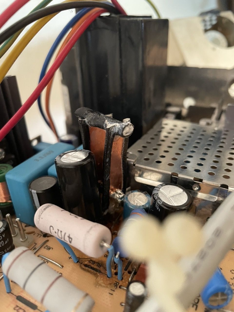

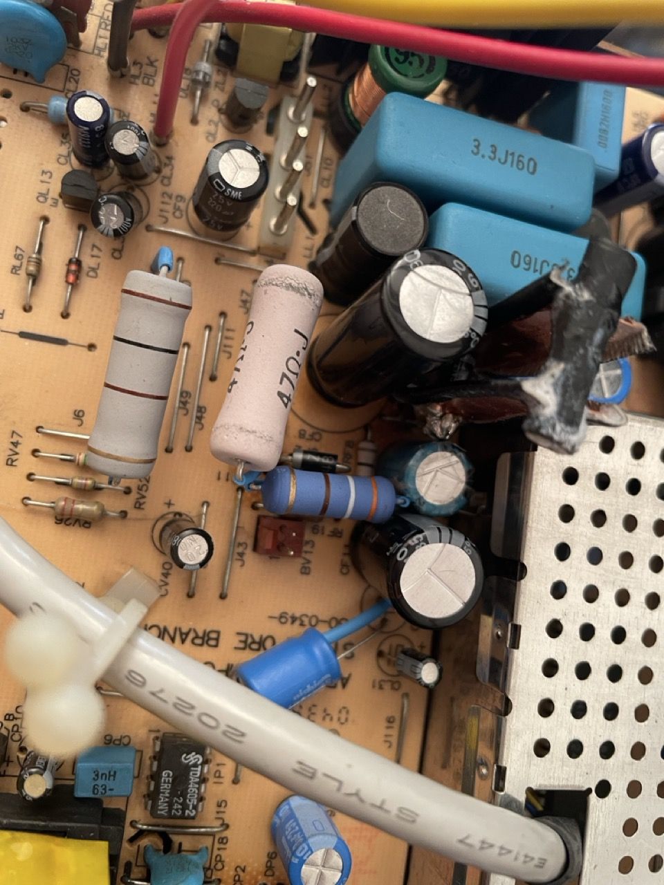

Hi everyone! A few years ago I got a Color Classic that didn't work properly (can't recall the exact symptoms at that point - again, it has been a while...). So I performed the obvious operations: Recapping the logic board with Tantalum capacitors and the more "error prone" caps from the analog board as lined out by @Branchus. At that point I got the CC to boot up to the boot-media-question-mark (original HDD tested & declared dead, no replacement yet). However, the machine didn't seem to make any attempts at reading a floppy when inserted. The question mark kept flashing, the cursor did move but no noise whatsoever from the floppy drive (already did a service on that, tested it and works). Also in some cases, nothing happened at all, no life after switching on power and pressing the boot button from the keyboard (tried different keyboards, all work on other machines). That is where I left the project some time ago.
A week ago or so I stumbled upon the component upgrade video by @JDW and the tip for using an even cooler running diode. Inspecting the diodes on my CC's AB showed the same discoloration on the board, so I replaced the two diodes DL21/22 with a DOI-201 packaged 1N5355B + a copper heatsink (looks a bit weird, I admit, but should get the job done. The two copper plates are held together at the top so that they don't vibrate using a bit of heat shrink that is additionally hardened with a bit of super glue), RL22, RL62, RF11, DF2 and the surrounding electrolytic capacitors that haven't been replaced yet (just in case they were affected by the heat - I know, not really necessary, but if I am already working on that area...).
Unfortunately this is not enough: There is a picture (although with a strong blue tint that doesn't really come across on the video I uploaded and a bit of a geometric distortion at the top and bottom, though I suspect that is more of an adjustment issue) and the CC tries to boot but shuts down/looses power after less than a minute (see video). Sometimes it gets to the boot-media-question-mark, but not always. Putting in a floppy doesn't seem to make a difference, no audible attempt at trying to read anything from that. With a bit of help from my dad we were able to read the voltages on the HDD power connector (as there isn't a disk in there) in the short time it powers on but nothing out of the ordinary there either (just shy of 12V and 5V).
This is where I'm currently stuck and need help/advice on what to take a look at next. I still suspect that the analog board is the (main) culprit here as the CC gets to the point where I can see and move the cursor, so I don't think its the logic board (also, the blue tint of the image) - on the other hand, the floppy drive showing no signs of life could either be a power issue there or a failure of the floppy controller on the LB? But then, why would this cause the machine to suddenly lose power? Any help or advice is greatly appreciated! Please feel free to ask me for any additional information required to troubleshoot this in case I missed something!

@TechnikTobi
Welcome to TinkerDifferent!
Congrats on doing the Beefy Component Upgrade and for heat sinking your DO-201 Zener Diode! I enjoyed looking at your photos. Should be interesting to see how long the superglue holds that heatshrink atop those heatsinks.
Anyway, I'm glad you used an insulator (heat shrink tubing) and not a piece of metal. :-) I don't think people will solder a deal short across their Zener, but you never know what people will do at times.

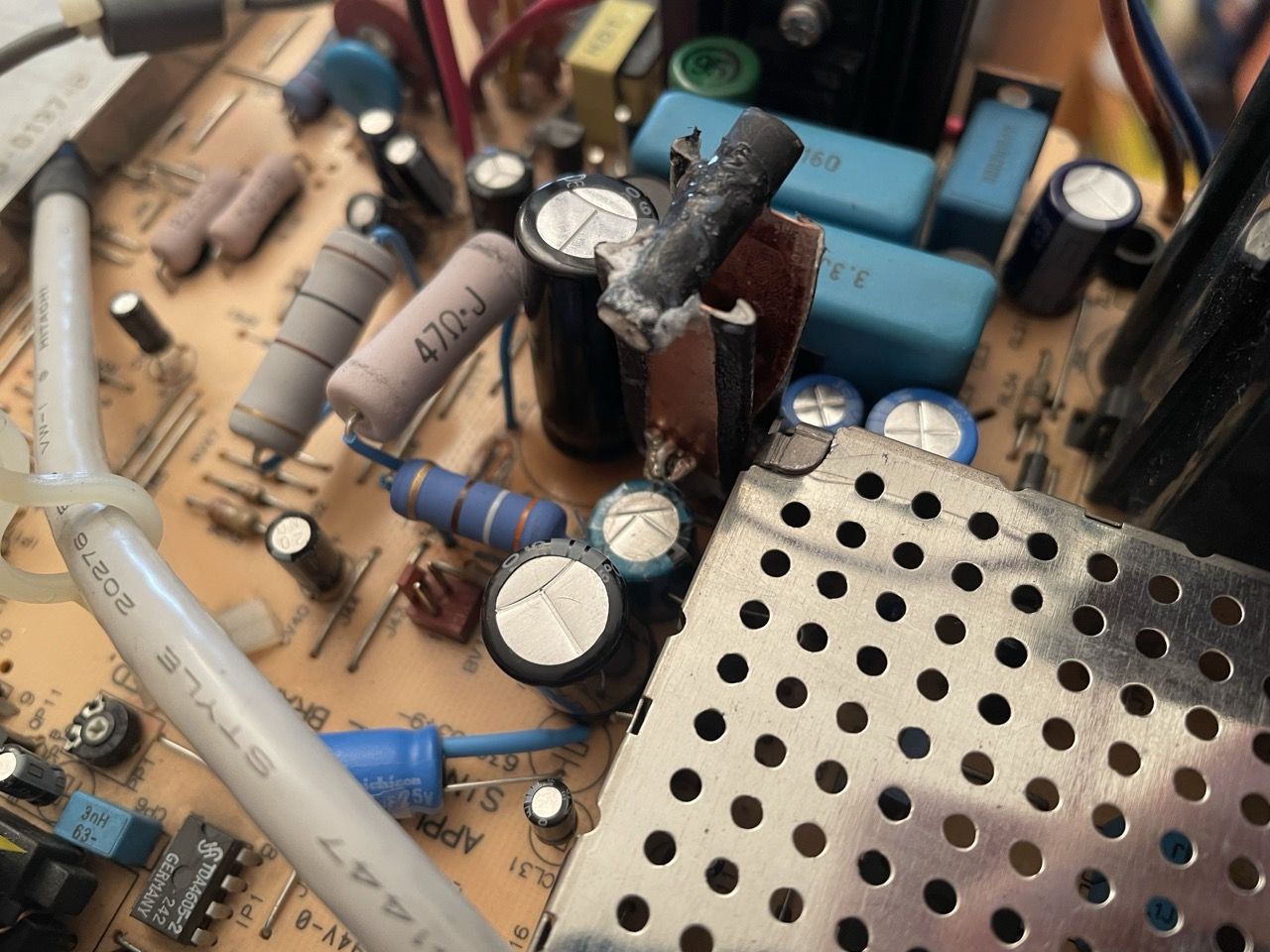

In regards to your power instability, it's important to know that no fluid-filled electrolytic capacitor has eternal life. Any such cap more than 25 years old and especially those used in hot conditions like the CC Analog Board needs to be replaced. Yes, even the largest cap on that board too. They ALL must be replaced with 105°C rated capacitors to ensure you get a reasonable life from them.
I also suggest making sure the LEAD SPACING is correct for replacement caps too, especially for the big ones, because you don't want those sitting up on their legs. The caps surrounding the DL21/DL22 diode area absolutely must be replaced because they have had the hottest heat exposure over the years. Doing that alone may resolve the sudden shutdown problem. And if it doesn't, then it's time to take a closer look with a magnifying glass at traces on the solder side and any burned components, especially transistors on the component side.
All connectors and the flyback and power switch need to have their solder reflowed. This is an absolute must. Could be that alone is the main problem, and as the machine heats up, a cracked solder joint comes apart enough that the machine loses power. Go over all solder joins with a magnifying glass. I did that on my Analog Board. Yes, it is time consuming but necessary.
Once your machine remains on without issue, you can then do the CRT Adjustments at back, in accordance with my video on that here...
I look forward to hearing how it goes!

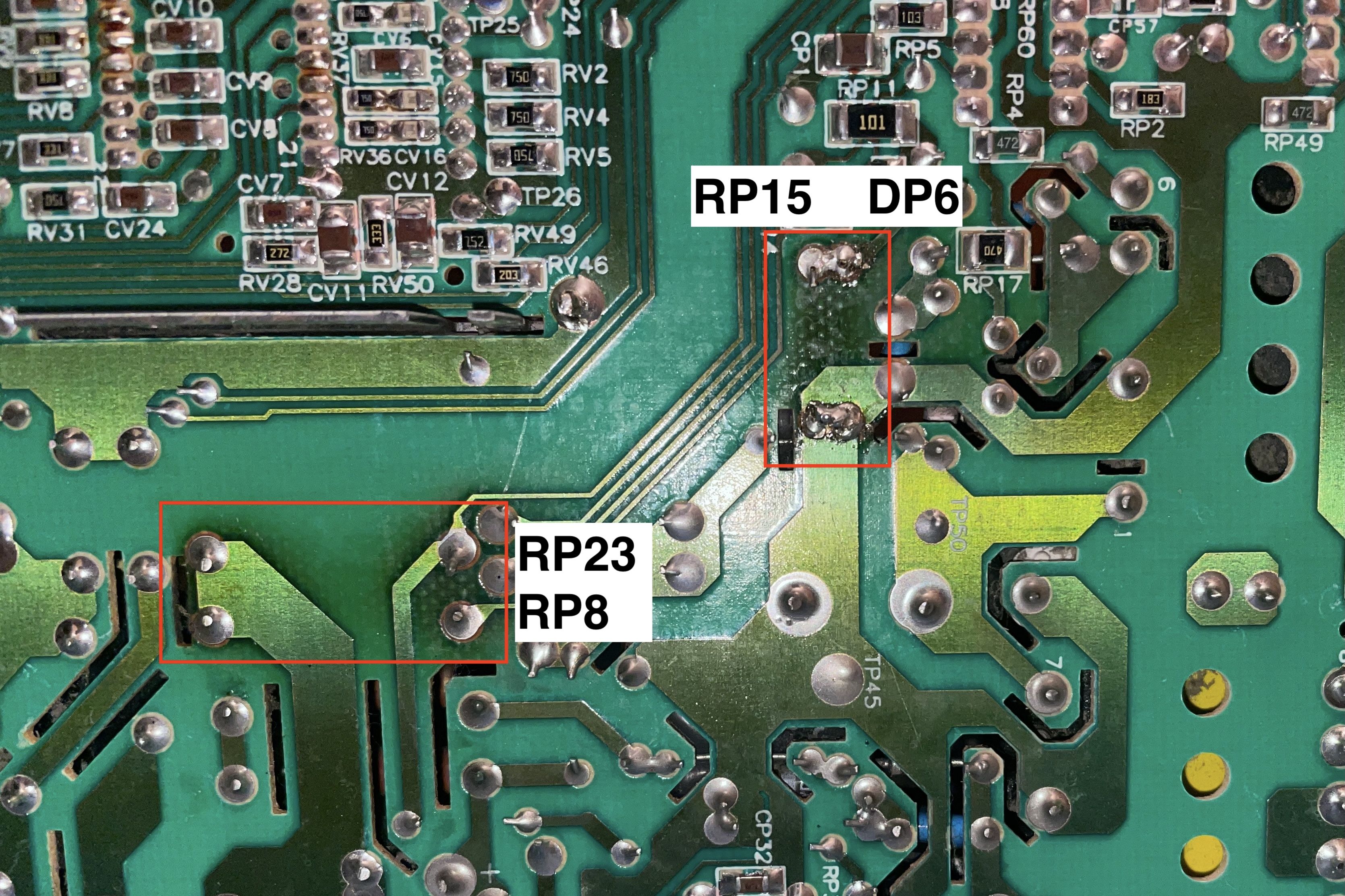

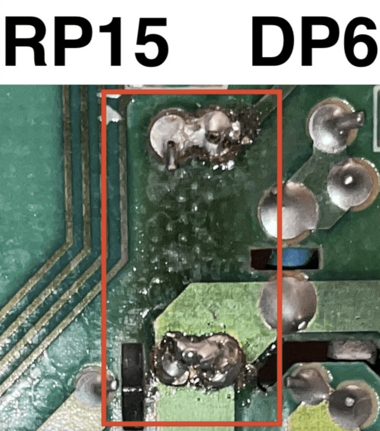

I noticed some similar heat-related discoloration of the board around DP6 & RP15 (next to the big 330µF/400V capacitor CP30) and RP8 & RP23 (also adjacent to CP30). Any experience on replacing those?
I've never touched those on my board. Maybe if you could share some clear photos of that area, I could better comment about them. Maybe they are just dirty and not burned. Put some IPA on a tissue and wipe them to see if the grime comes off. If it doesn't wipe off, they may have burned. But typically those components in that area don't burn.

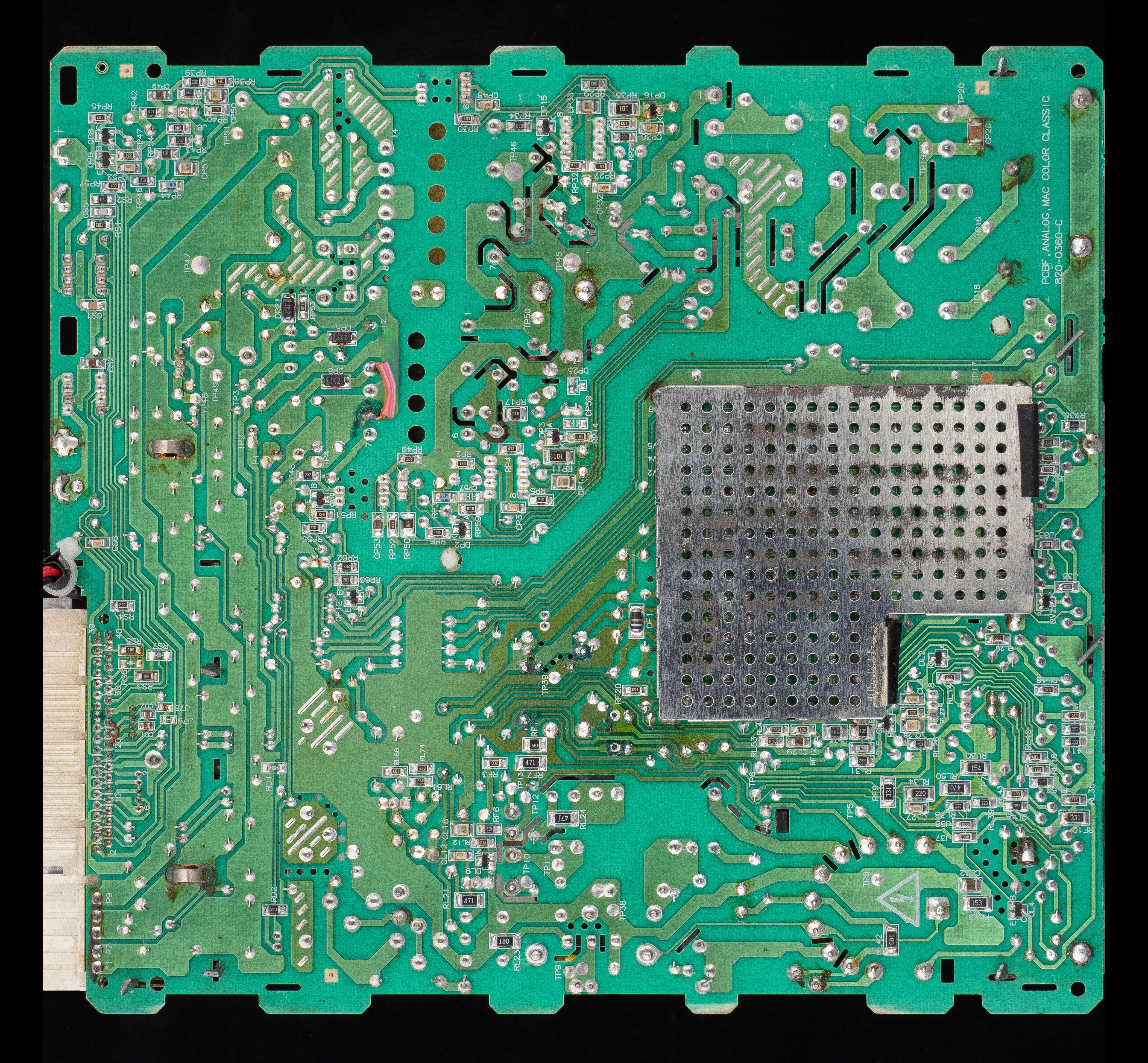

Here's a high resolution photo of my board prior to my Beefy Component Upgrade...
And here's a hi-rez photo of the bottom of the board, after the beefy component upgrade, but only part way through the 84V 13" Hi Resolution Mod...
Thanks for the high-res images! Comparing them to images I took a few days ago prior to the component upgrade there is definitely some discoloration on both sides of the board and not just some dirt (though you are right that I should also go over the entire board with some cotton swabs and IPA).

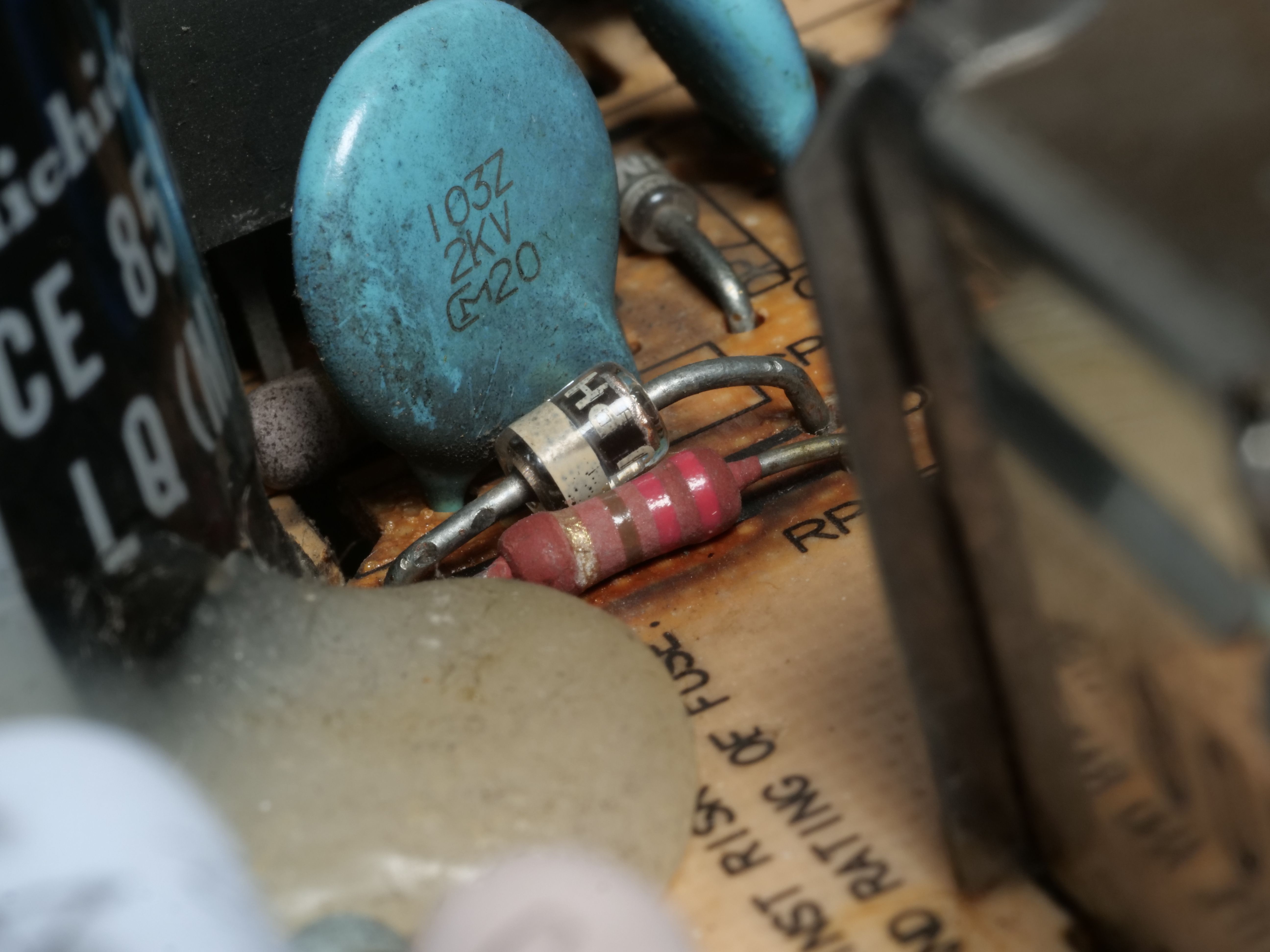

Very interesting. Thank you for the photos. Certainly looks like DP6 and RP15 have been compromised due to heat. But resistors RP23 and RP8 are raised up off the board, and yet the board directly under them is charred. Very odd.
Not sure if he'll reply, but I'd like to ask @techknight if he's seen charring in that area before. He has lots of experience repair these boards, so it could be something he has seen. I will tag @Kay K.M.Mods as well. I myself only have the one Color Classic, so I am only experienced on the board I have in front of me. Also, @Paolo B , would you happen to have any thoughts?

You seem to have some corrosion on the lead of DP6, looks like a dent in the photo.

Solder joins for these two components look "factory" done...
But these solder joints look either compromised or someone desoldered them and resoldered without flux...
The problem is that there is no Schematic for the CC Analog Board, so problem (burned) components need to be traced by hand to see where the current is coming from and where it is going.
In other words, it's more than the aforementioned 4 components possibly being bad. Something caused them to burn.
In the case of DP21 and DP22, we know the reason. It's bad to use two Zeners in parallel, because one could heat more than the other. And they both were only rated for about 1.25W, originally. And they were clearly shunting more current to ground than they could handle without being heatsinked. Even so, the AMOUNT OF CURRENT running through them was the issue. Had there been less current flow shunted through D21 and D22, they wouldn't be charring boards.
In like manner, the reason for excessive current flow through the 4 aforementioned components needs to be determined. And the mystery of why the board is charred beneath two very large resistors (RP23 and RP8) which are lifted up and off the board needs to be determine. Is it really possible for those two huge resistors to get hot enough that high up off the board to char the board beneath them? That is really odd!

These boards all need fully resoldered, and fully recapped now. The solder joints have gotten atrocious on these boards. Also de-oxit the middle cable that goes between the front and the middle, which carry the video signals. As well as resoldering all of that.
That usually takes care of most problems, the rest need adjusted out on the rear.
Lastly, the opto-couplers are a common failure point on these causing intermittent power/shutoff scenarios.

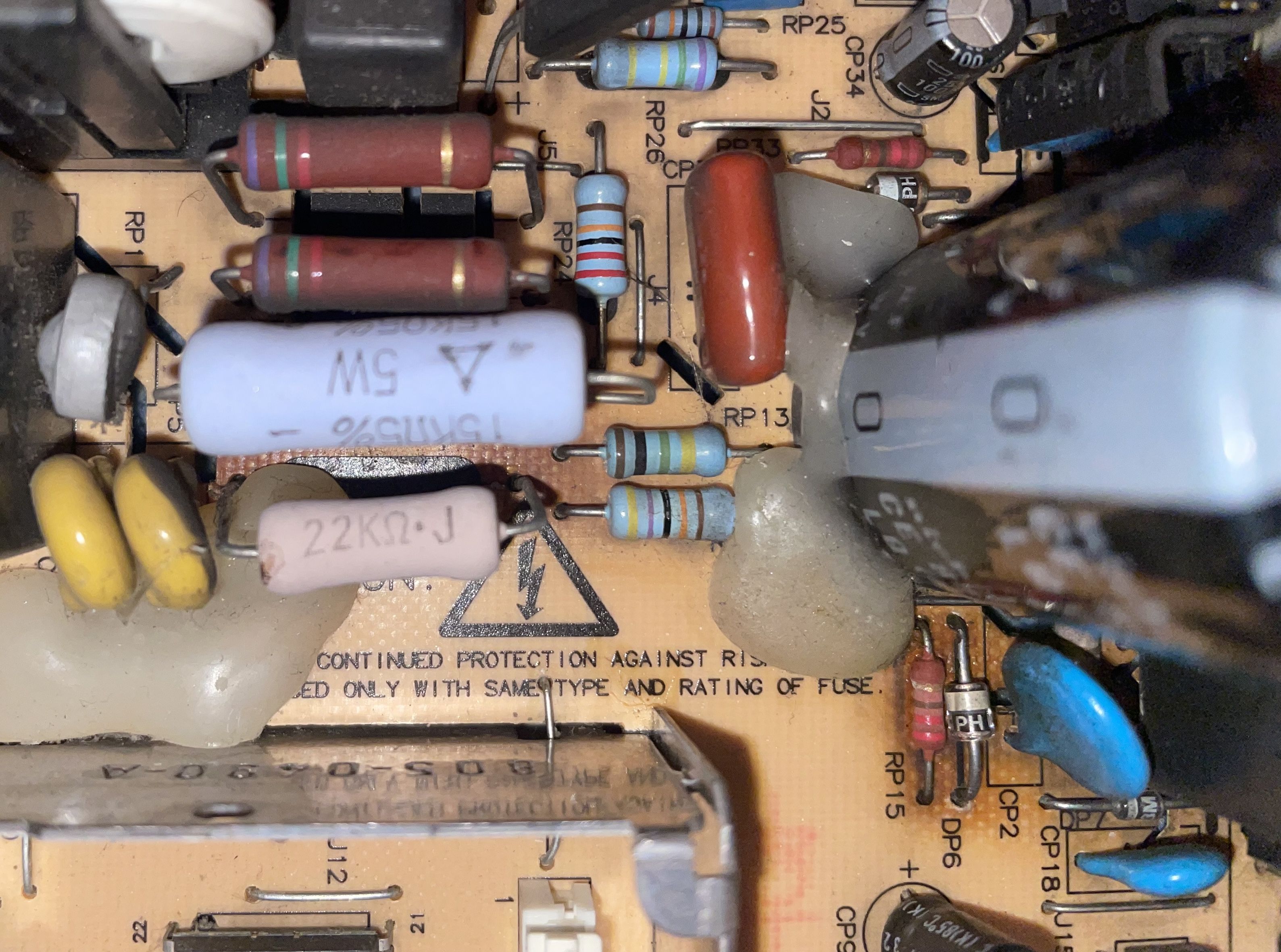

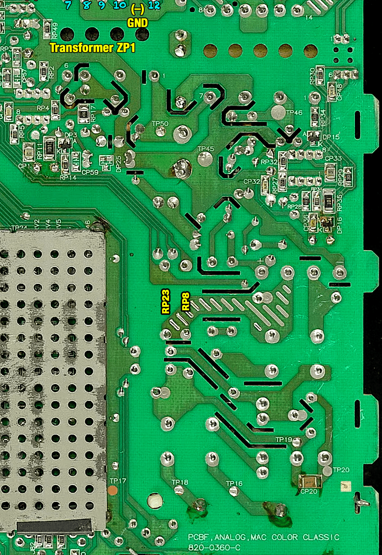

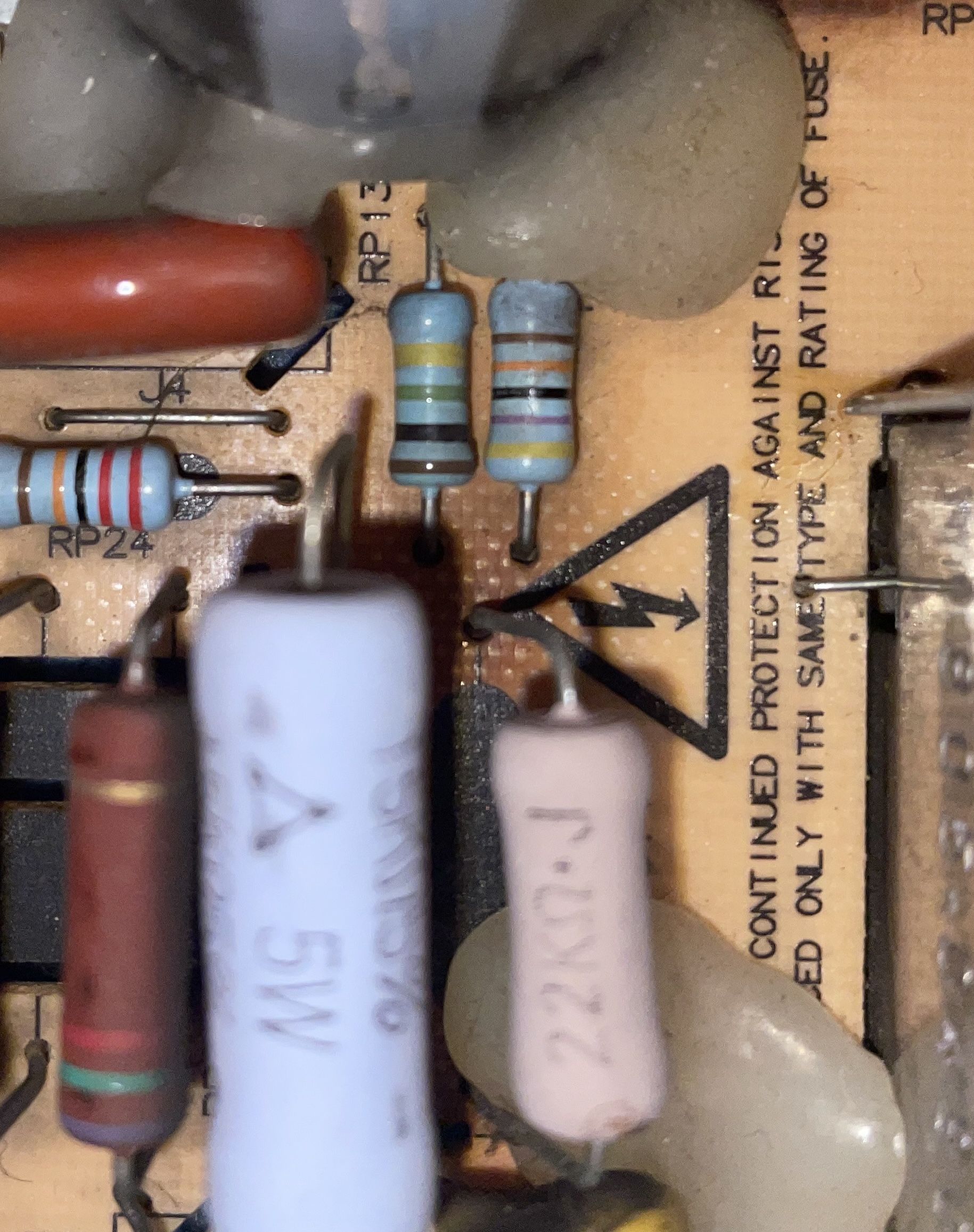

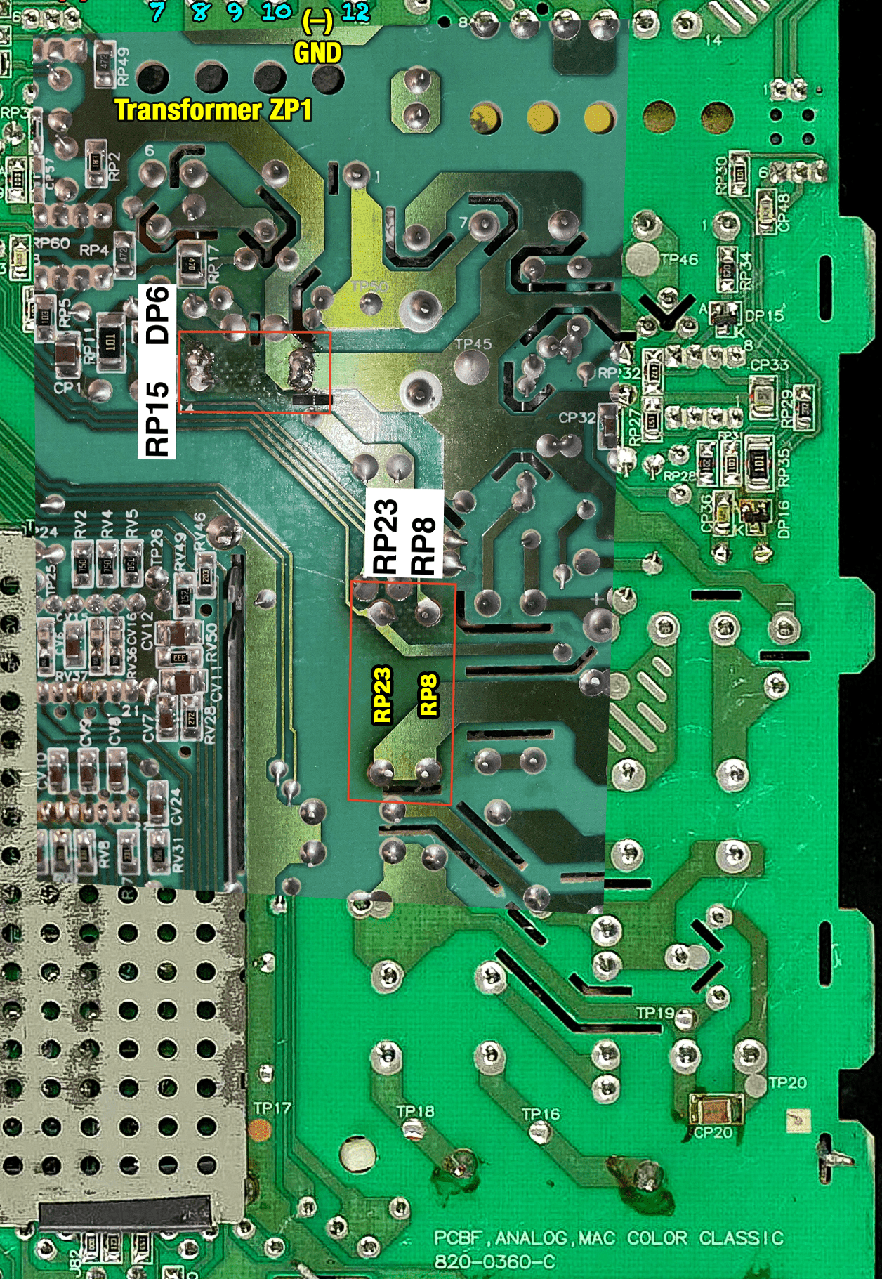

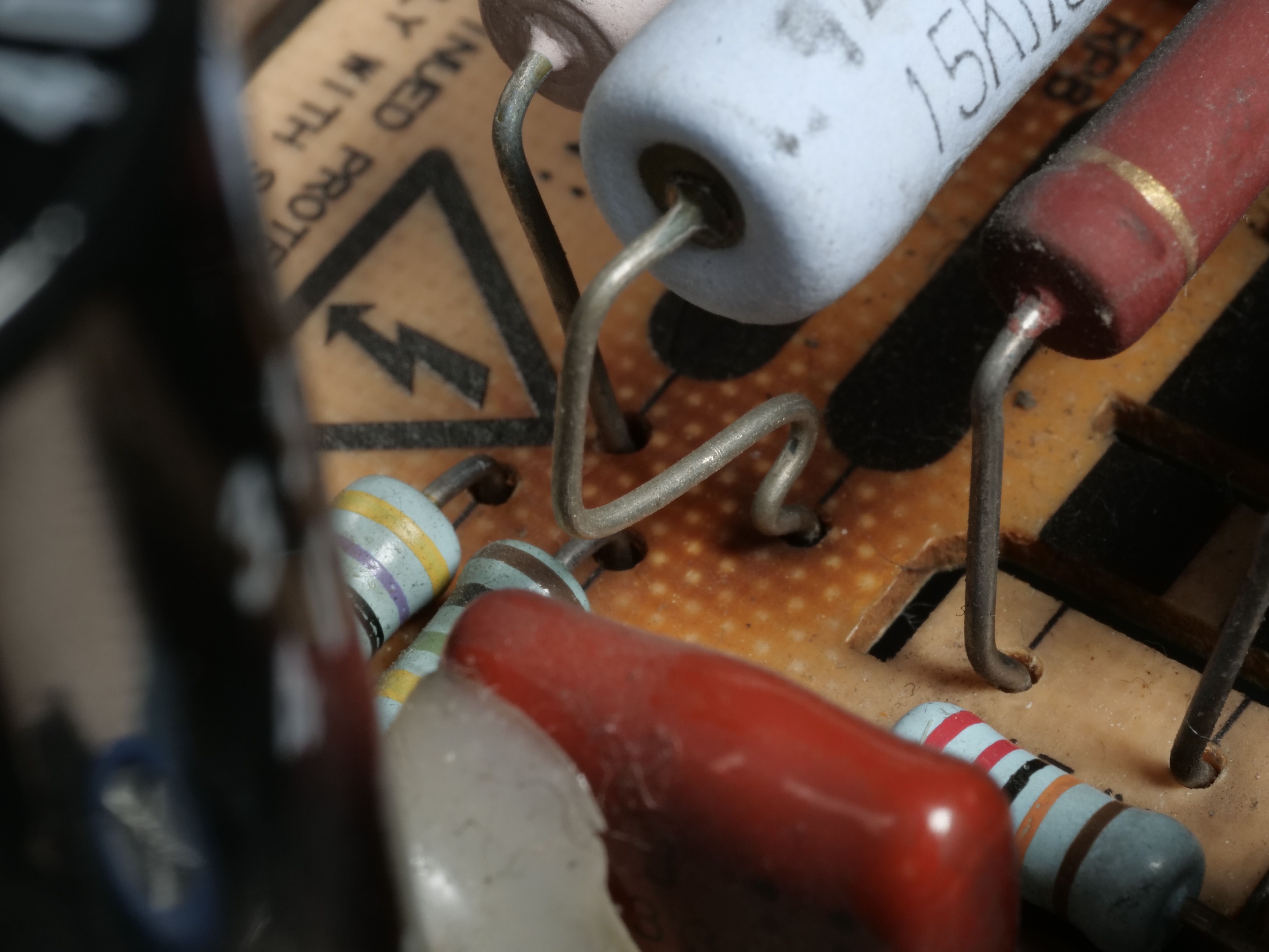

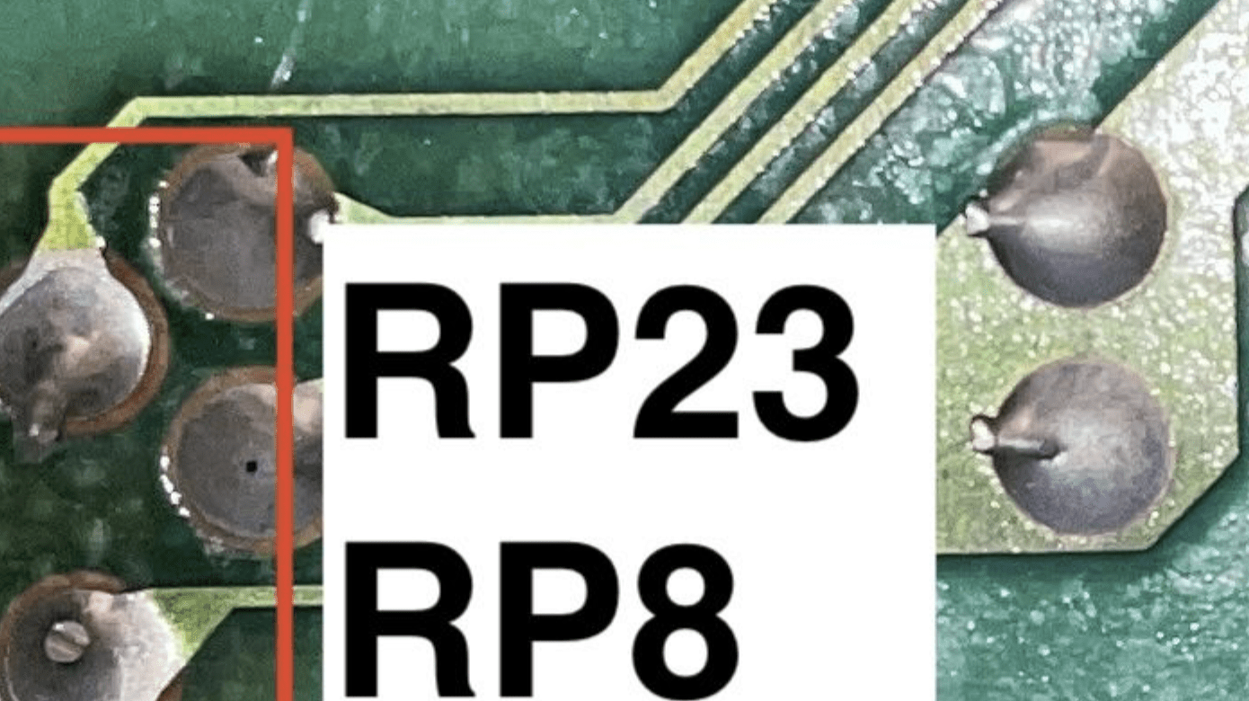

Regarding the heat produced by RP23 & RP8: As mentioned, the board shown on the recapping guide by Branchus also has similar burn marks. I guess the heat is primarily dissipated by their legs?
Not "primarily," no. The larger the body, the higher the wattage and more heat that is dissipated via the sheer side of the body, not the legs. Of course, if the resistor body glows red hot, that heat would flow down the legs, but it's hard to imagine those components are getting THAT hot. Too bad you don't have a thermal camera because that's one tool which would help you identify overheating components right away.
Separately from that, I modified your photo so it would perfectly overlay might photo, and you can see the board revision differences below...
Note the fat trace at the bottom of RP23 and RP8. My board must be newer than yours because mine has extra solder applied to that trace, either for better currently handling or better cooling or both.
Reactions: Paolo B
Some progress: I now went basically over all solder joints (except for SMD stuff) and now the image is "stable" in the sense that it now longer flickers between perfect gray and purple and has no longer the geometric distortion at the top and bottom 🥳
However, the loss-of-power-problem after around a minute or two still persists. I removed the floppy drive as suggested by @Paolo B but that didn't change anything (still have to test that in my non-color classic). Also, it seems to me that if I power it on with the switch on the back for a few minutes and then try to boot, it stays alive longer than booting immediately after switching on power - but perhaps I'm imagining things. Similarly, there is this weird noise when the CC is switched on (see video - though it is quiet), I guess from a coil that's vibrating? I forgot what this thing/CRTs in general without any fans or anything are supposed to sound like...).

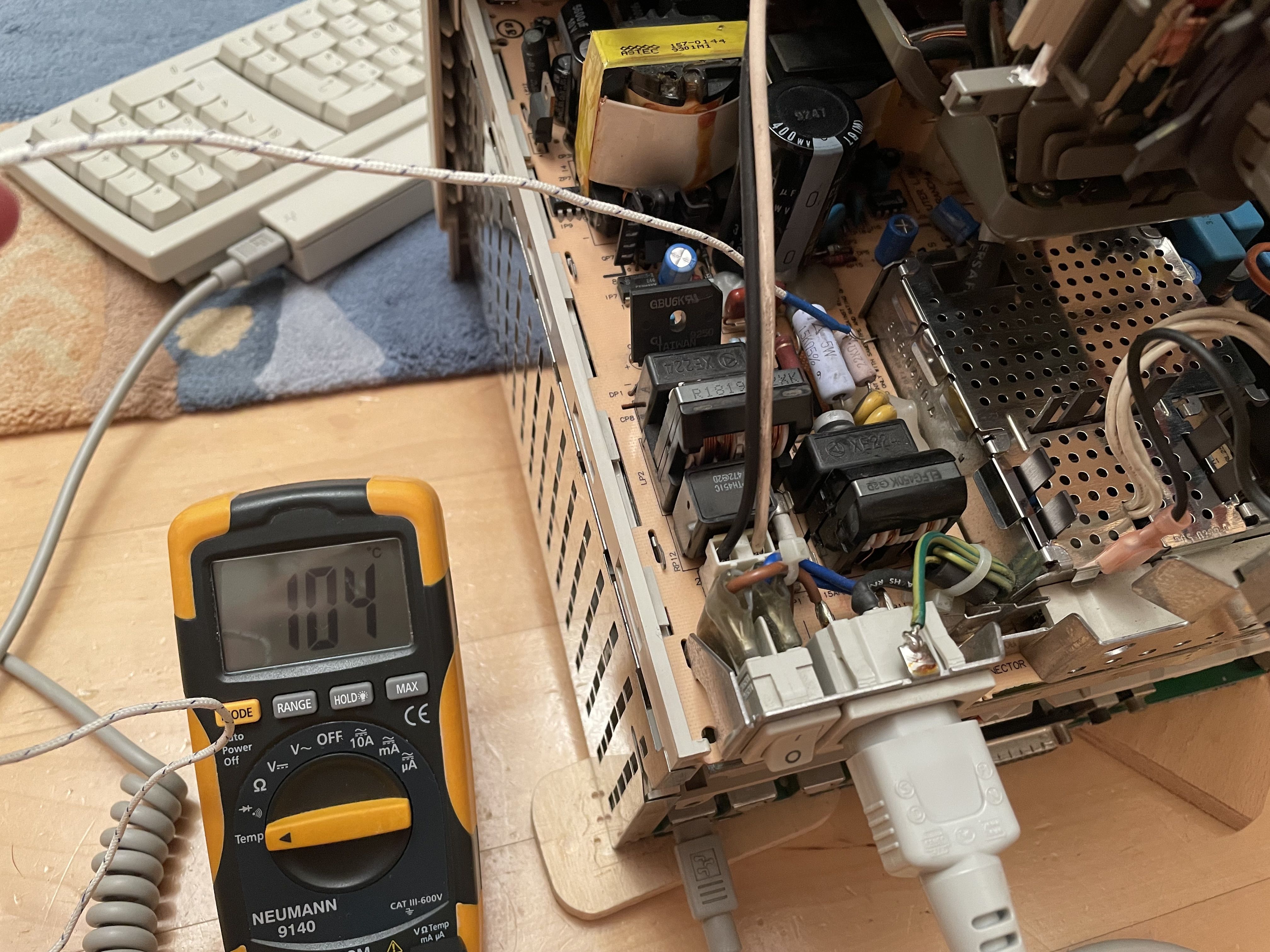

I see. Well, I don't have a thermal camera, but I do have a multimeter that is able to measure temperature! I did some basic measurements, with the power on the backside switch turned on but not having booted or anything. And what I get is this:
- RP8 (15k) gets to ca. 75-85°C
- RP23 (22k) gets to ca. 95-105°C (see image)
- Ambient temperature ca. 26°C
both are coolest at the center of their body and get warmer towards the edges where the legs come out. I didn't want to touch them with my probe (as that is also made out of metal) but my guess is that the legs will have a similar temperature. The resistor right next to both of them (RP37) stays cool at ca. 40°C. Do you have measurements with your thermal camera to compare that to?
Yeah, mine is a rev. B board. I did add some additional wire (without insolation) along that trace between RP8+23 and LP2 for additional current handling and head dissipation. Don't know if that is going to make any difference but it couldn't hurt either.
Anyway, I still don't know what to do about RP15+DP6. For RP8+23 my next step is to desolder one of their legs to measure them and if they are within tolerances leave them as they are for now despite the heat marks. Replacing them won't solve the root cause of why they get so hot in the first place, same with RP15. And, without knowing what DP6 actually is, I'll have to leave that also as it is and hope that replacing the remaining caps (and the optocouplers) solves my power issue...
You can see all the hot areas of the Analog Board and some temps from one of those resistors here:
But honestly, even at 105°C, those resistors are not super hot. The 3W and 5W resistors are made to get hot. They can get upwards of 200°C actually, in accordance with their datasheets, which is hotter than diodes are allowed to get (usually 150°C max.).

I'm going to tag @Kay K.M.Mods because he, like TechKnight, has touched a lot of Analog Boards and should know the right and wrong sounds. Hopefully he will add his thoughts to this thread at some point.
RP signifies Resistor, so removing and measuring them is all you need to do. If your measured resistance falls outside the resistors +/- 5% tolerance, replace them with the same or higher wattage.
But that DP6... Man, I'm really sorry but I have no idea. Is it a Zener? Schottky? Silicon Diode? Not sure what it is. Again, I need to defer to TechKnight and Kay, as one of them may know.
So I desoldered DP6 to get a closer look and the packaging says: PH BYD34J. Good news: Googling that name gives me a data sheet. Bad news: it is no longer available - though I want to replace it with something more capable anyway, similar to the DL21/22 mod. However, I'm not sure on how to pick a proper replacement part. What are okay-ish deviations for what properties? Is it for example okay to use a replacement with a higher IF value? Lower? Does it have to be an exact match like a capacitor's capacitance?
The way I do it is look at the datasheet and see the recovery raitings, the voltage/current raitings and i use those details as filters to pick a new one on Mouser/Digikey.
It is a fast recovery rectifier, aka shottky diode. According to the datasheet, its a 600V 1.8A Shottky. you can probably get away with a 600V 2A.
