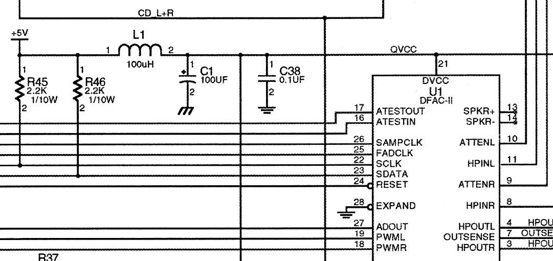

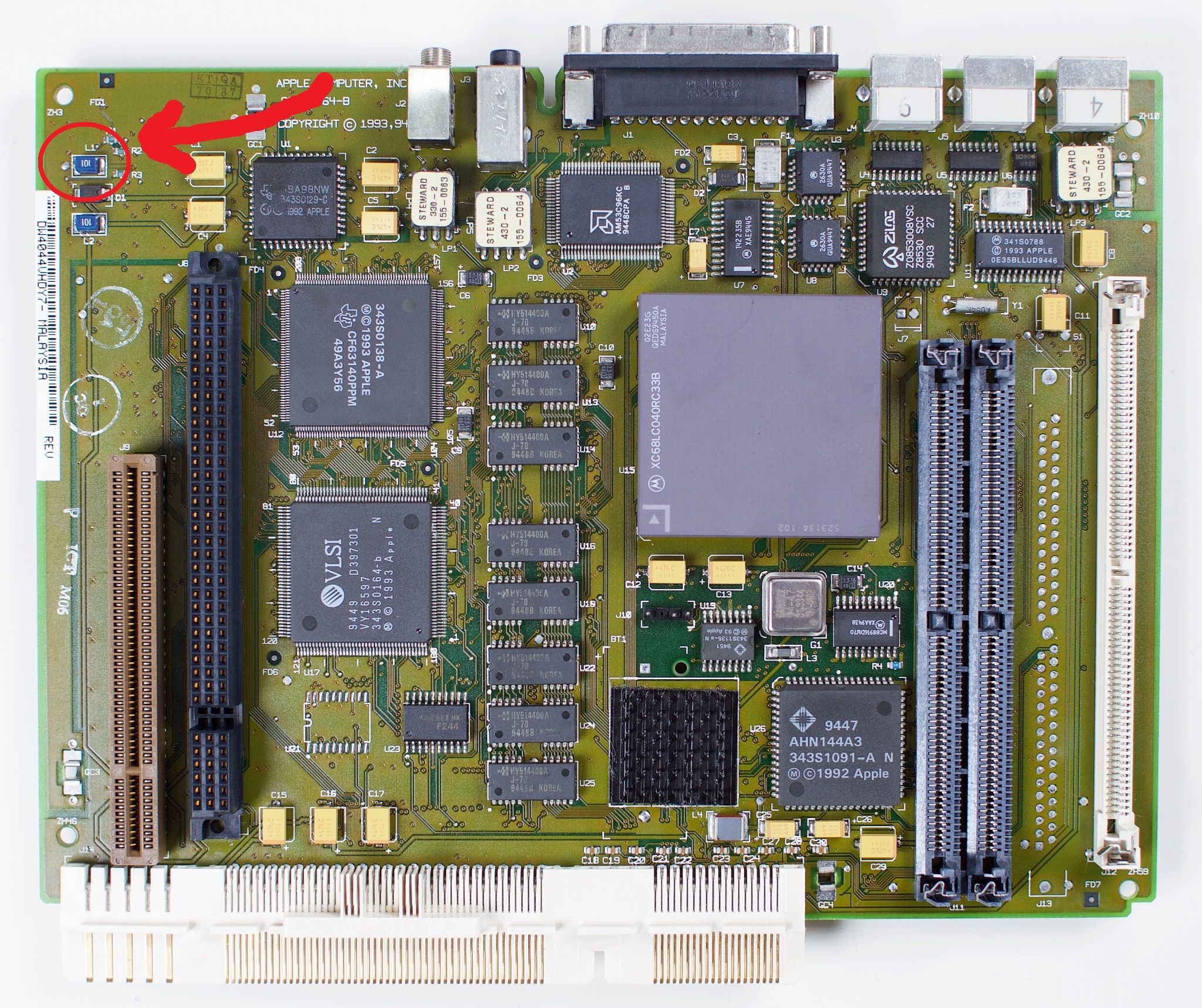

I am also looking for some advice on a small component that's detached on an LC 575 board. It is labeled L1 and need a replacement recommendation if possible:
Hopefully I can get some direction from someone more knowledgeable than I, thanks in advance.

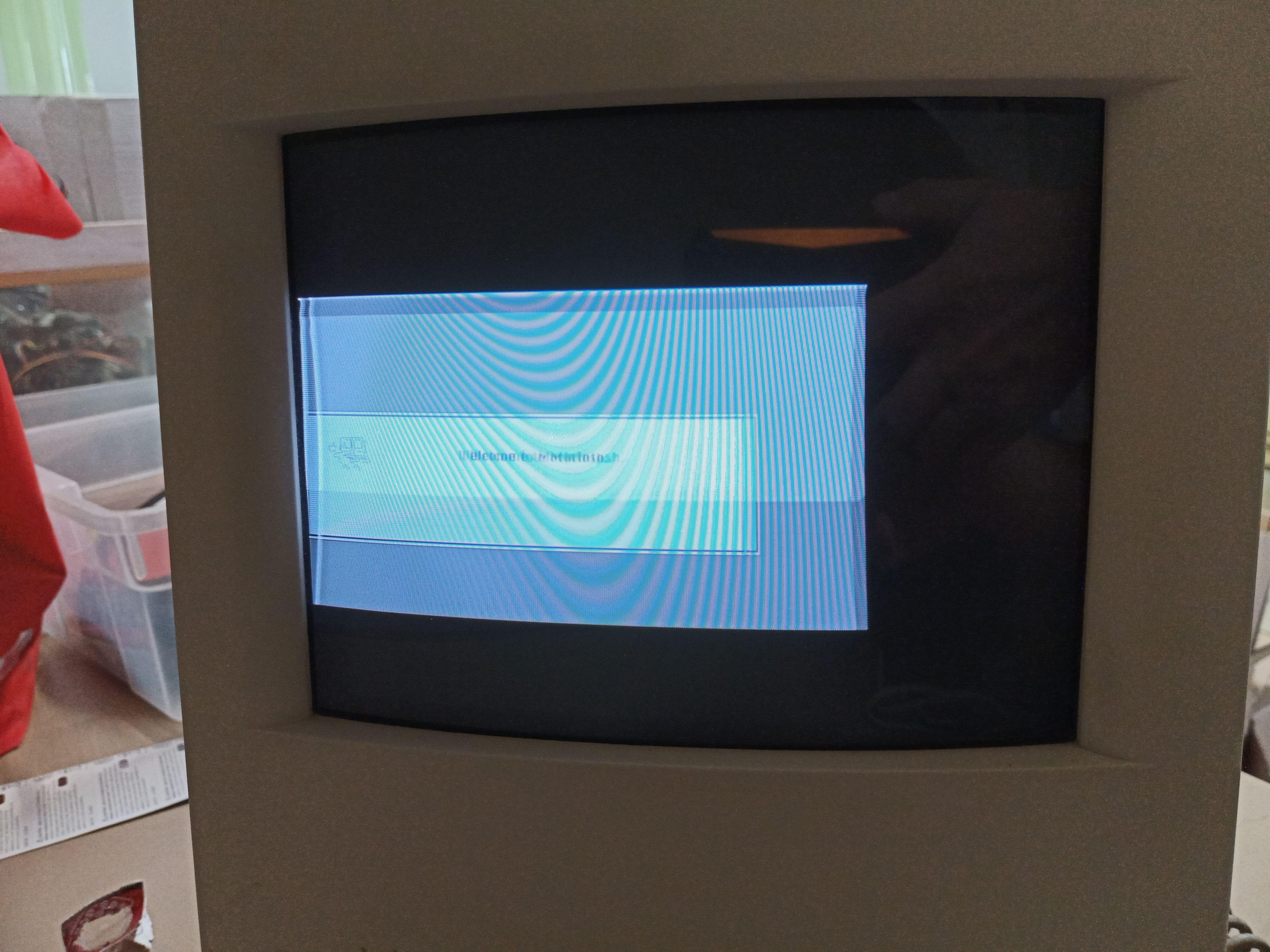

The screen geometry and color are both way off which is a good hint that something's wrong with secondary voltage outputs from CRT transformer.Start with checking all voltages on CRT side, make sure 24V, 8.4V from transformer output are normal, as well as regulated 18V, 8.2V from zener diodes.

As for the LC575 board, L1 is a 100uH filter inductor for sound chip's 5V voltage supply. You can get replacements from any scrap board that uses DFAC-II chip, or just bridge it
Thank you so much, I was able to spend a little bit of time tonight trying out these suggestions. I'm not overly familiar with reading electrical schematics so bear with me please. My results as best I can describe them:
On the LB:
DL21/DL22(zeners) = 18v
DF2 (zener) = 11v
On the CRT neck board:
Not sure what to label these as so, on the connector that attaches to the tube itself, moving clockwise starting from bottom left I tested each pad of the connector as follows:
0v, 40v, 39v, 0v, 89v, 88v, 88v, 0v, 260v, 0v
The four solder points at the bottom of the neck board with wires leading to the shielded cage on the LB, left to right:
88v, 89v, 89v, 0v
I will add some pictures with labels tomorrow to aid I'm my description.
I also measured the leads coming off the LB leading directly to the CRT but realized after I must have wrote the wrong IDs down for them after referencing a high res picture of the board. I will remeasure and post tomorrow, but here is what I noted:
HL 2: 183v
HL 3: 0v
HL 4/HL 5: 40v
If any of this is useful off hand to anyone in coming up with a diagnoses please let me know, and thanks again! I will keep trying in the meantime.
DL21/22 voltage is ok, but DF2 voltage is much higher than it should be (8.2V). Did you install the correct zener diode? Also double check those power resistors and caps nearby, make sure you didn't install anything wrong.
Yeah I agree, the DF2 voltage is suspiciously high. Do you have the correct value for RF11, which biases DF2? I think it should be 370 Ohms.
Reactions: Doctorkillbydeath87
Wow, I indeed did not! When I was making up my digikey cart I must have accidently replaced the 8.2v zener with an additional 18v!

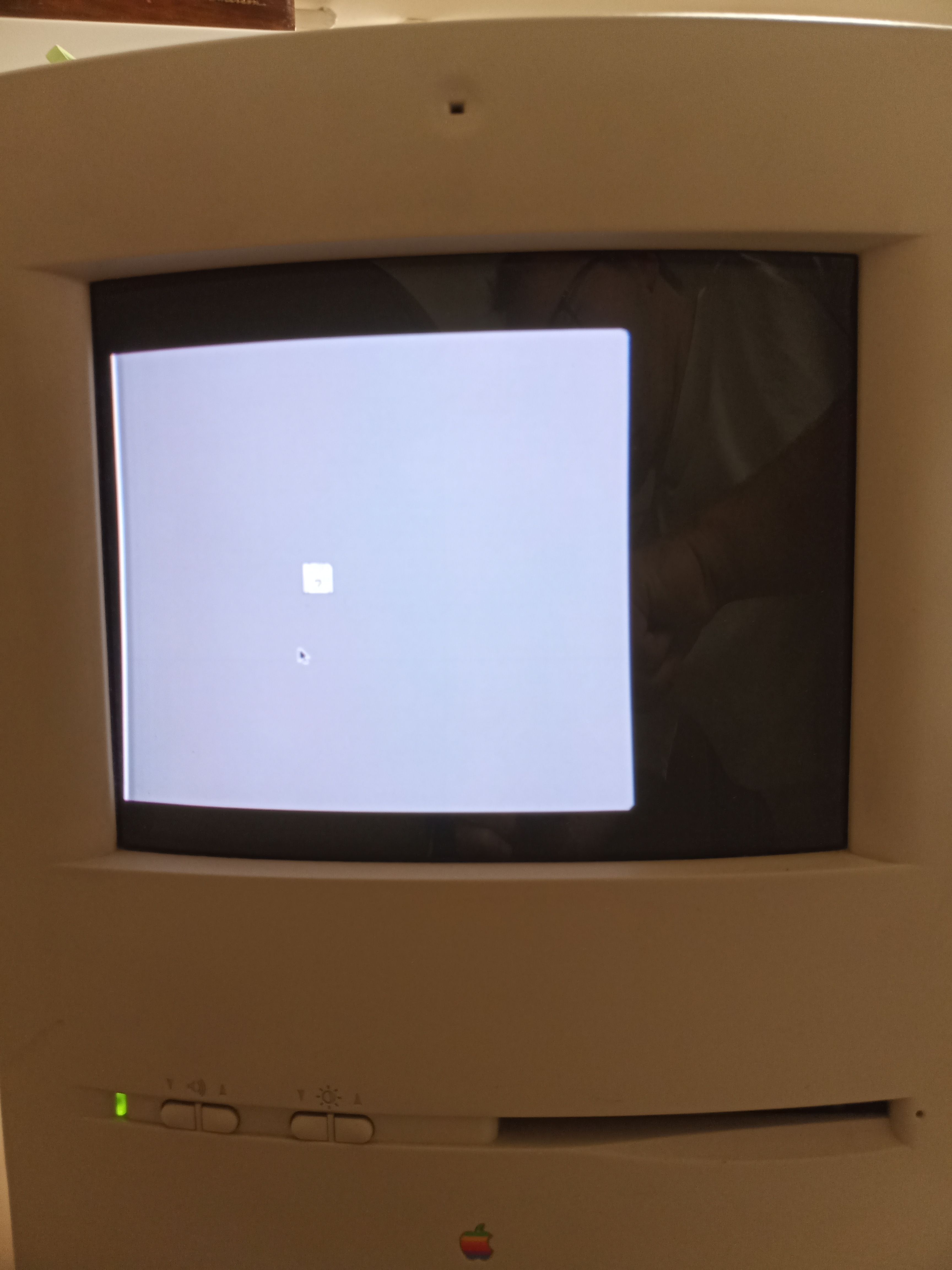

I put in the original 8.2v zener and was met with a much better picture upon boot. Can't believe it was something so simple but I'm glad.
Pardon the picture quality, the colour in reality is the expected grey, black and white. And very stable. Just need to figure out the positioning issue now.
575 board is also booting just fine with L1 bridged. Thanks so much for the advice, you guys really are Lifesavers.

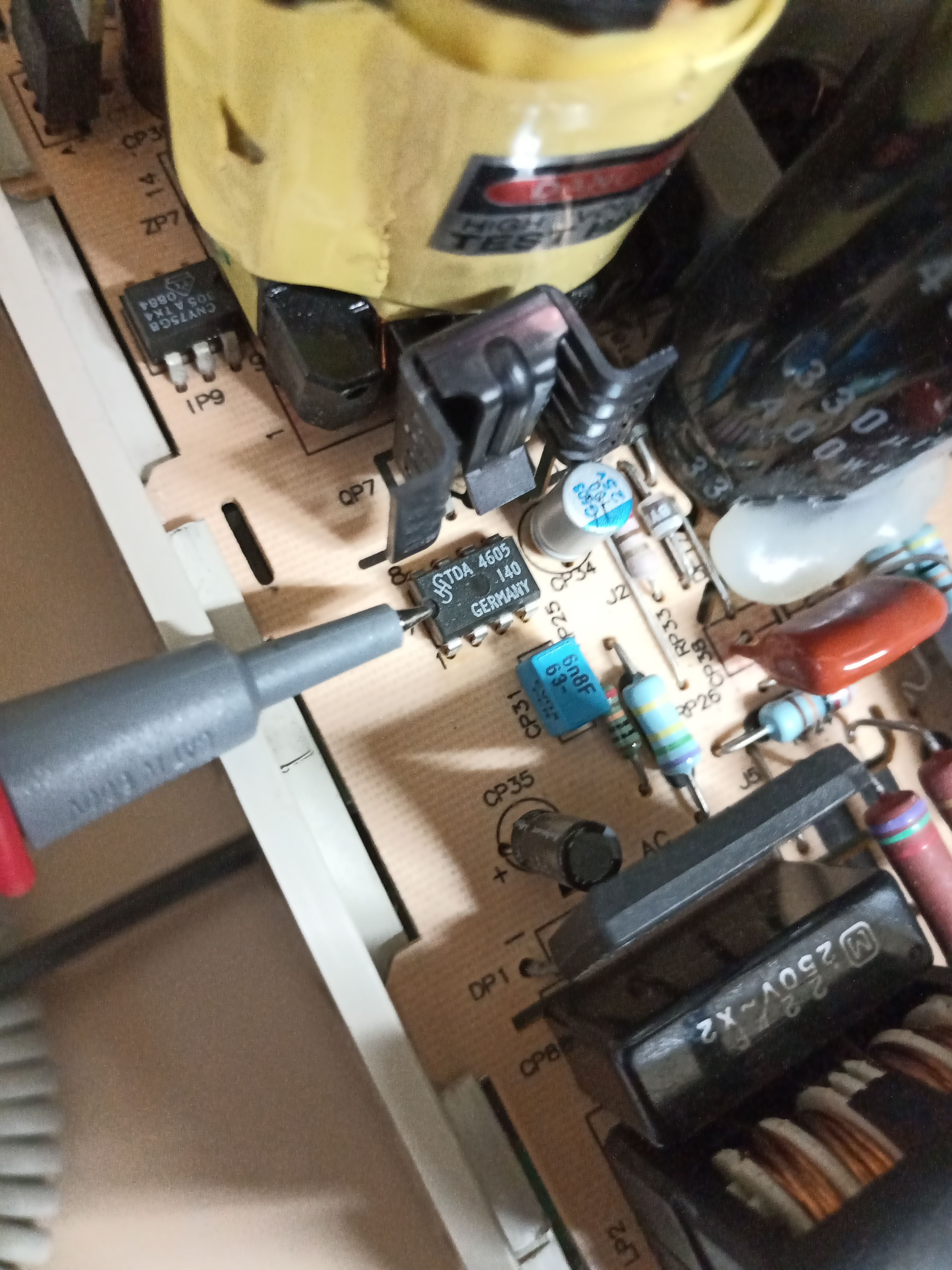

After testing voltages around the board, IP7 (TDA 4605-2 chip) gave off a small spark when tested, and now the CC doesn't respond to the power key at all. Tried replacing with a TDA 4605 off a Classic II AB but no change in behaviour.
That's a good sign because it means the AC section and the CRT supply section are working. The logic board supply side could still have a problem. Which TDA4605 did you have discharge on? There are two, one for each of the switching supply transformers. In any case, I think the CRT side (which definitely runs continuously if the hard power switch is on) also supplies 5V standby power. You can check this at pin 1 of BD11, a 2-pin header in the front-left corner, but I suspect this will be OK. Similarly, you should see the 5V on the lower-left pin of the logic board ADB connector (you'll have to stick a piece of wire into it to probe). If that's not reading right, it could point to a problem with the board connector, but one step at a time.

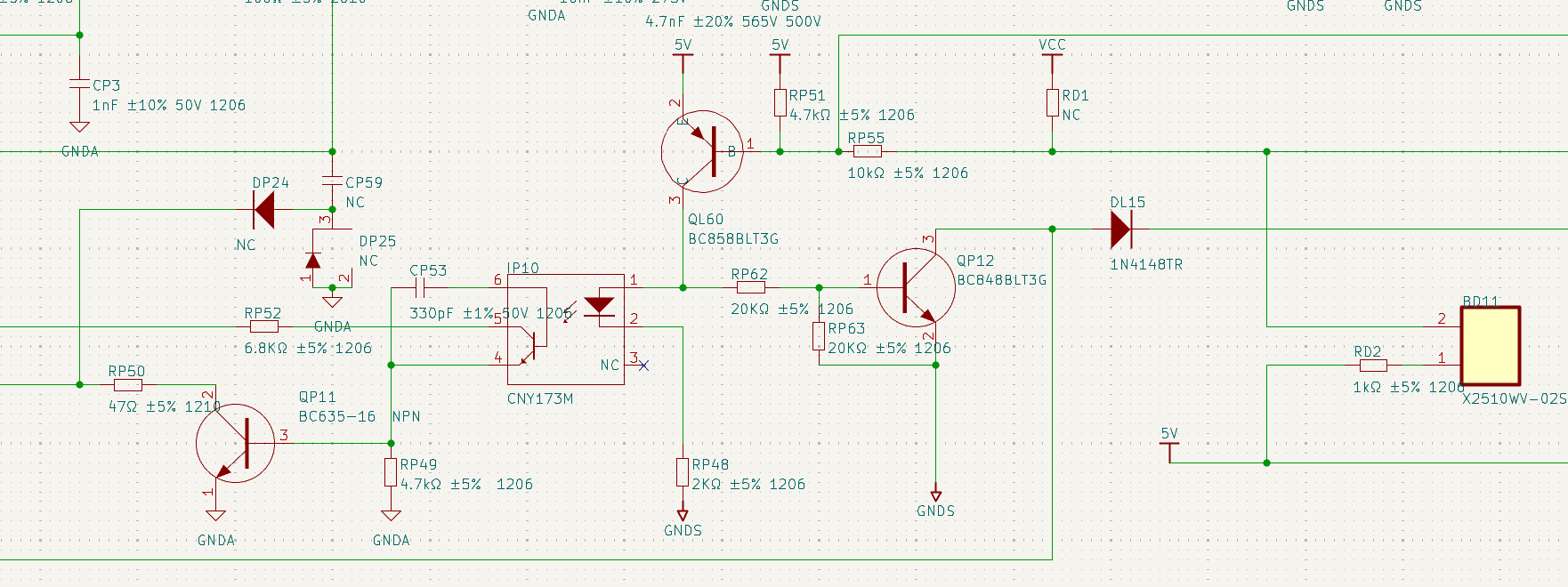

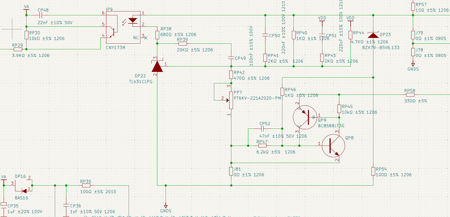

You can jump start the logic board power supply by shorting BD11 with a jumper. If soft power part is working, QP11 should turn off and CP34 will charge up from mains power through RP23 till it reaches TDA4605's power on threshold, after which the switching mosfet should start working and CP34 will be charged by auxiliary winding from the transformer and you should have voltage outputs from secondary. If you don't see voltage on TDA4605's pin 6 then something's wrong with soft power control, check the surrounding circuit near optocoupler IP10:
If you see voltage on pin 6 of IP7 then the issue is with the switching power supply itself. First of all replace TDA4605, optocoupler CNY17-3 and switching mosfet IRFBC40. From my experience they should be replaced at the same time, one blown mosfet usually takes out the other 2 components, also the optocoupler's gain drops over time as ir led gets dimmer.
With all mentioned components replaced it should rule out any issue on the primary side, if you still don't get voltage output then something's wrong with voltage feedback control circuit around IP9:
I had a very stubborn analog board before, replaced everything I suspected and it still won't work, logic board power supply keeps entering protection mode. Eventually I just nuked everything on the logic board power supply section and added an extra 5V/12V/-12V power supply in place, plus a relay controlled by soft power signal. If you have to go down this route you can check my previous post for details
I've inspected the board thoroughly and found one detached pad @ cv19, bridged with wire to the nearest connection (DV4). Confirmed all my caps are the correct orientation and am pretty certain I'm not shorting out on any solder joints
Shorted BD11 but that failed to start up the LB.
I've got 53.8v off pin 6 of IP7 so my next step will be ordering the replacement components as recommended.
Thanks for all the advice and expertise, I really appreciate it. Will provide an update once I've made some progress.
I measured pin six with my meter set to DCv & ground lead contacting the shroud surrounding the main supply plug socket. Attached a picture just to make sure I'm contacting the correct locations. Double checked and I'm receiving 53.8v still.

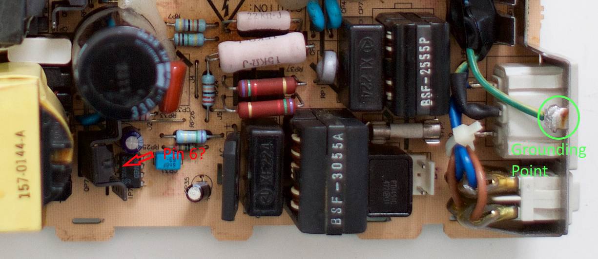

I think that whole section is floating relative to ground because it’s effectively on the AC side. The AC side and the secondary sides are fully isolated by the switch mode transformers (hence the use of optocouplers to send supply signals from the secondary back to the primary). It’s the secondary side’s ground that’s connected to all the chassis components and ground traces. So I think it’s possible to measure a range a weird values on IP7 if you’re referencing chassis ground. Measuring relative to the negative output of the bridge rectifier would be more appropriate, but I’d had to check what to expect in that case.
