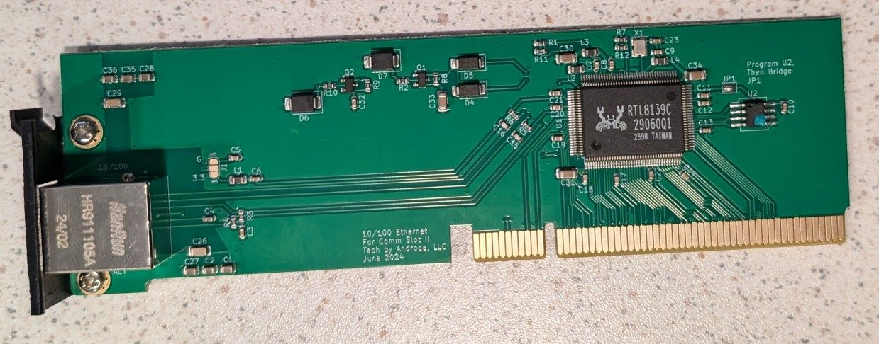

EDIT: Now that I'm thinking about this, I did a quick refresh on LEM's page on CommSlot ethernet / modem cards. Why not just make it compatible with CommSlot I and II? While making it compatible with 100BASE-T networks is viable, I checked ebay quickly (oh hey there's two iPrint LTs for 68$ for the pair...not bad if you can source your own power brick, which is pretty easy tbh) and there's one CommSlot I card up there. LEM does say the 100BASE-T CSII cards had compatiblity issues, but maybe they didn't have the same ethernet chip as yours does.
CommSlot I and II compatible modems are making use of the common modem port serial lines they share on the connector. For Ethernet they are very different data buses on the connector, CommSlot I has an 030 ”PDS” bus while CommSlot II has a PCI bus. Seems like that would be pretty hard to have a device support both, but we can dream!

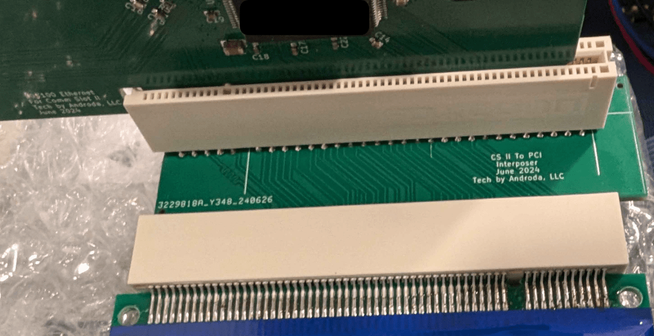

My latest experimental PCB arrived, a CS II to PCI interposer/converter. Note that Comm Slot II is not a direct pin to pin mapping of PCI, so this does change pin assignments. But it really is just PCI. Works fine with my Ethernet CS II card. Yes, I'm using a PCI slot for where the CS II card plugs in. Turns out it's the same pin spacing and the notch fits perfectly.
(That other PCI slot at the bottom is a generic PCI extender cable)
Very nice! Almost two(?) decades ago I played with going the other way, a CSII Slot edge card to PCI Slot Riser test setup. Wanted to see if any PCI cards might be hoodwinked into running off CSII.
Got one of those on the way as well? :D
No, I made this adapter for ease of testing these comm slot cards during production. Overall though, I figure most PCI cards would work in the comm slot since it seems to just be "PCI Slot E1".
I was hoping the same thing in the back when, but IIRC I ran into some snag or other in mapping the signals. So never got around to it after putting it on the back shelf. I'll check the files, been starting to sort them out anyway.
edit: just wondered if a PCI adapter might enable the use of a gigabit NIC?
Realistically I don't think they could leave many lines off. The Tulip in the CSII Ethernet card is an off-the-shelf part and it would likely have made it more expensive to synthesize any missing signals, which would have defeated the purpose.

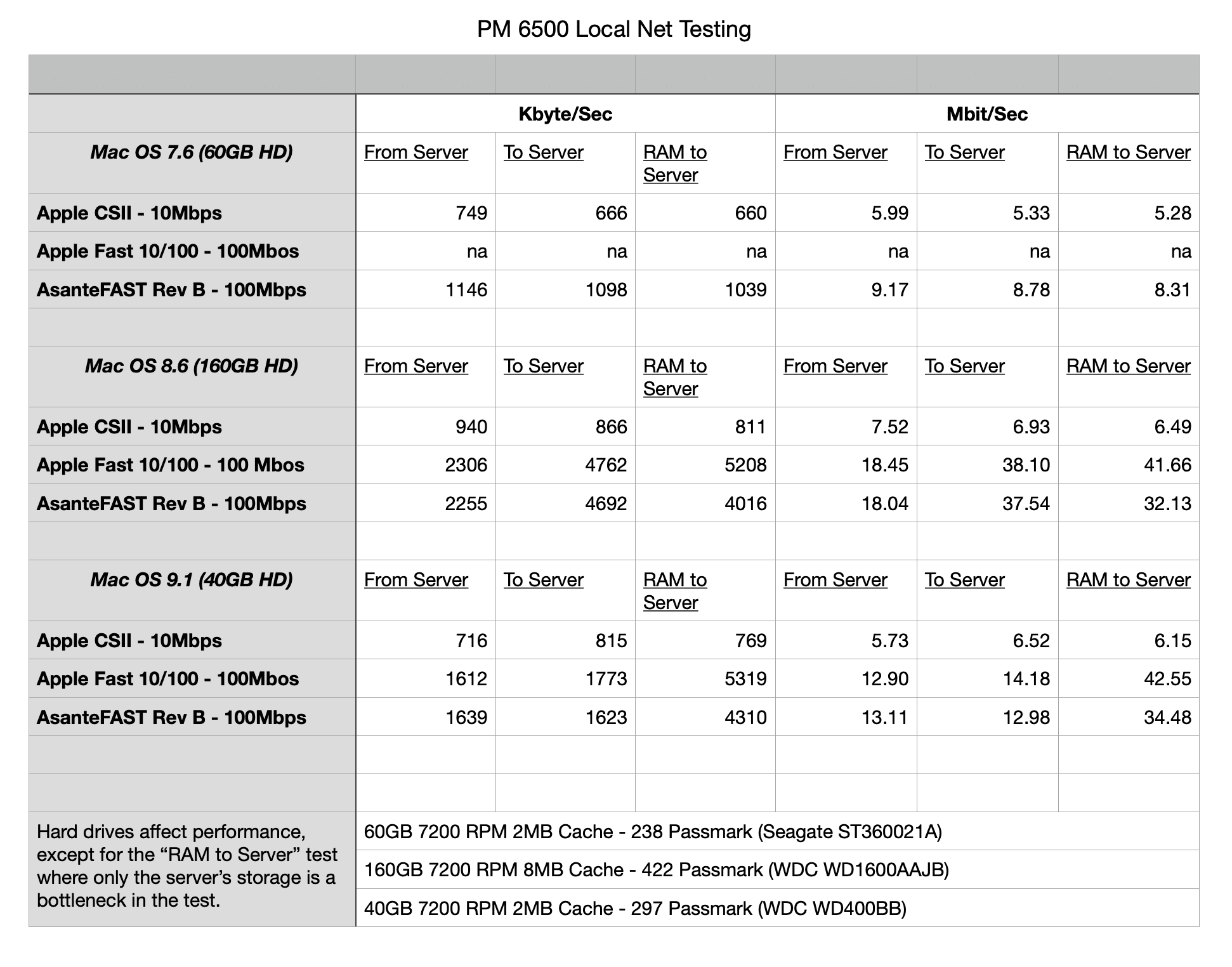

Local network testing seems like it might be better able to reveal the upper bounds of a NIC's performance, to that end I did track down the AppleShare network speed testing tool I remembered stumbling across a while back, likely when getting a Duo Ethernet micro dock working. (Note local FTP via TCP/IP testing, as suggested, would also be neat complimentary idea...):
Its "Performance" v1.3 which is included with the Newer Tech EtherTech 1.5 installer:
I wouldn't be surprised if there is some better classic Mac OS network benchmarking tool I don't know about but think this one is pretty simple/neat.
I ran tests between my PowerBook 540c (10Mbps Ethernet) and PowerBook G3/333 Lombard (100Mbps Ethernet) from/to my Raspberry Pi 4 "retro home server" running MacIPRpi (1Gbps Ethernet) all connected via an Apple Airport Extreme 6th Generation's Gigabit capable Ethernet ports. Results converted from Performance's Kbyte/S output to Mbps to align with Ethernet speed measurement:
PowerBook 540c (7.5.3)
3.48Mbps from Server​
4.22Mbps to Server​
PowerBook G3/333 (8.6)
29.33Mbps from Server​
30.56Mbps to Server​
Classic Mac OS, at least in the PPC G3 era can definitely do more that 10Mbps... Perhaps more applicable to your new card I plan to try this from a Power Macintosh 6500 via CSII 10Mbps and a 100Mbps PCI card. I have several of those kicking around.
Reactions: Androda
So some interesting results I think!
The driver I used ("Apple Enet" extension, v2.4.2) for the "Apple Fast Ethernet 10/100BaseT Card" didn't work under Mac OS 7.6. For the "AsanteFast 10/100 PCI Ethernet Adapter Rev. B" I used this driver from Macintosh Garden.
The hard drives I used for the different OS tests were different which makes the tests not directly comparable but I was testing with what I had on hand and as much as it bothers me that I didn't take the time to get a disk configured with partitions for each OS and run the tests from there I think it does help illustrate the impact of drive performance on network data transfers.
My take aways:
Mac OS 7.6, and likely earlier versions, aren't really able to take advantage of 100Mbps Fast Ethernet. Not sure about 8/8.1 but by 8.5/8.6 it seems Apple made OS changes which allow the same hardware and driver (the Asante card/driver being the proof) to take advantage of 100Mbps Fast Ethernet.
In testing and real world you need to have source and destination disks able to sustain more than 10Mbps (1.25MBps) reads and writes to make use of 100Mbps Fast Ethernet. The "RAM to Server" tests may likely show some SD card storage bottlenecks on my Raspberry Pi server.
I'm curious to see what the mystery Fast Ethernet controller chip @Androda is using and what the driver is, from its shape it doesn't look like it will be the Digital 21140 that my Asante and Apple Fast Ethernet cards use. Excited for this project!
