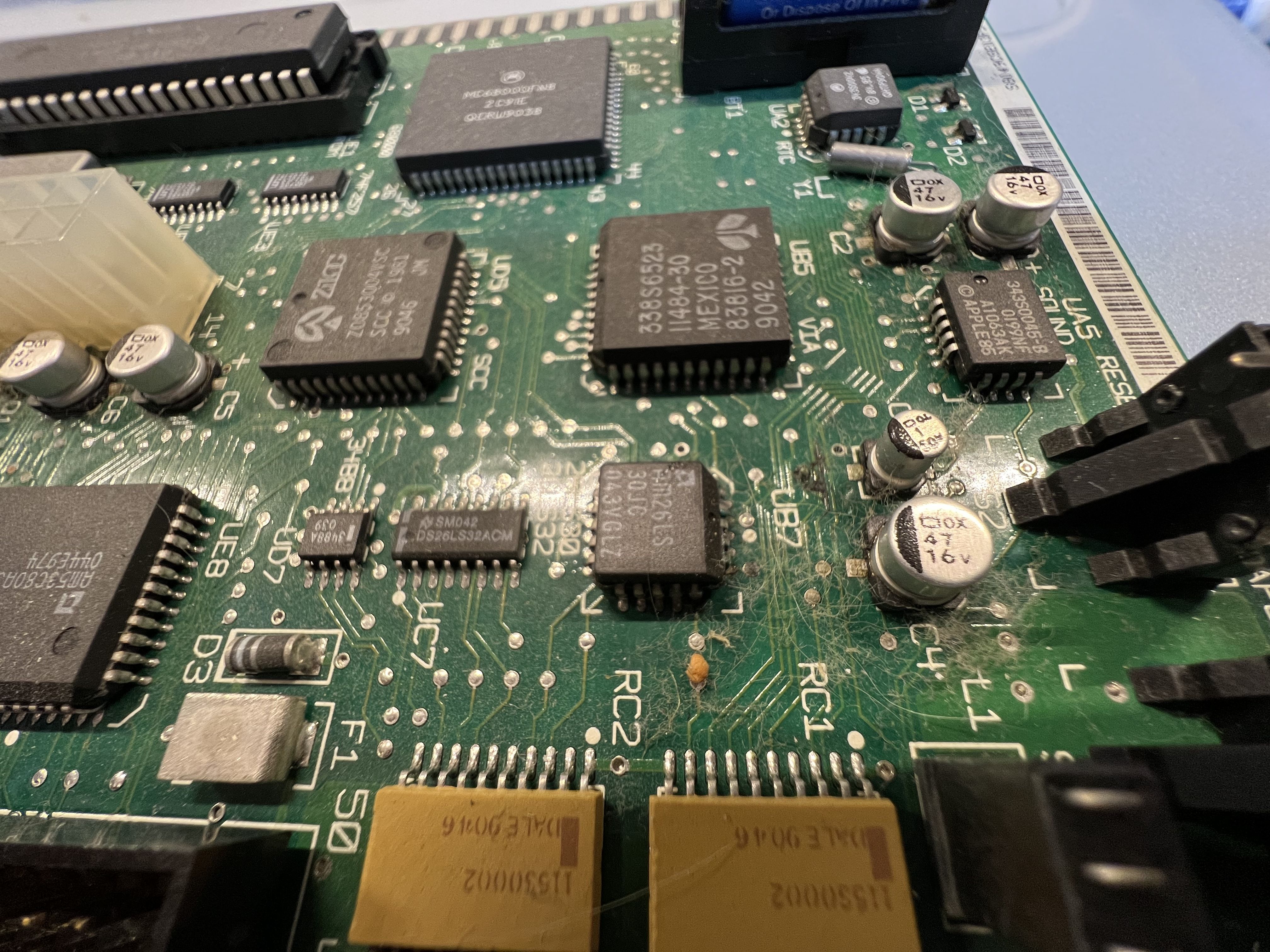

Hello! I just got a Macintosh SE, and I want to recap. I do have the list for it from RecapAMac. 1µf - 50V x 1 and 10µf - 16V x 10.
I'm new to electronics; I've only soldered some mods to consoles and used breadboards. I don't know what I should look for. Can we add it to the list?
Or can someone help me with some direction on which axial capacitors to buy? I would greatly appreciate it.
You can use the Console5 link above to order the kit that has the correct caps that you need. Make sure it's the one with tantalum caps.
