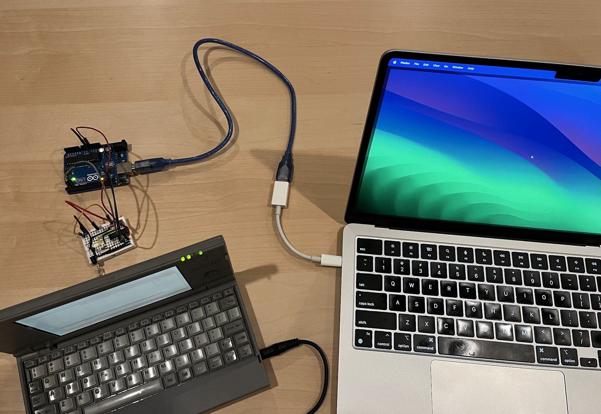

1. For now, I have selected IrDA as the method to get serial data into the laptop. I would like to do this with an ESP32 with a small battery that you could pair a Bluetooth mouse to.

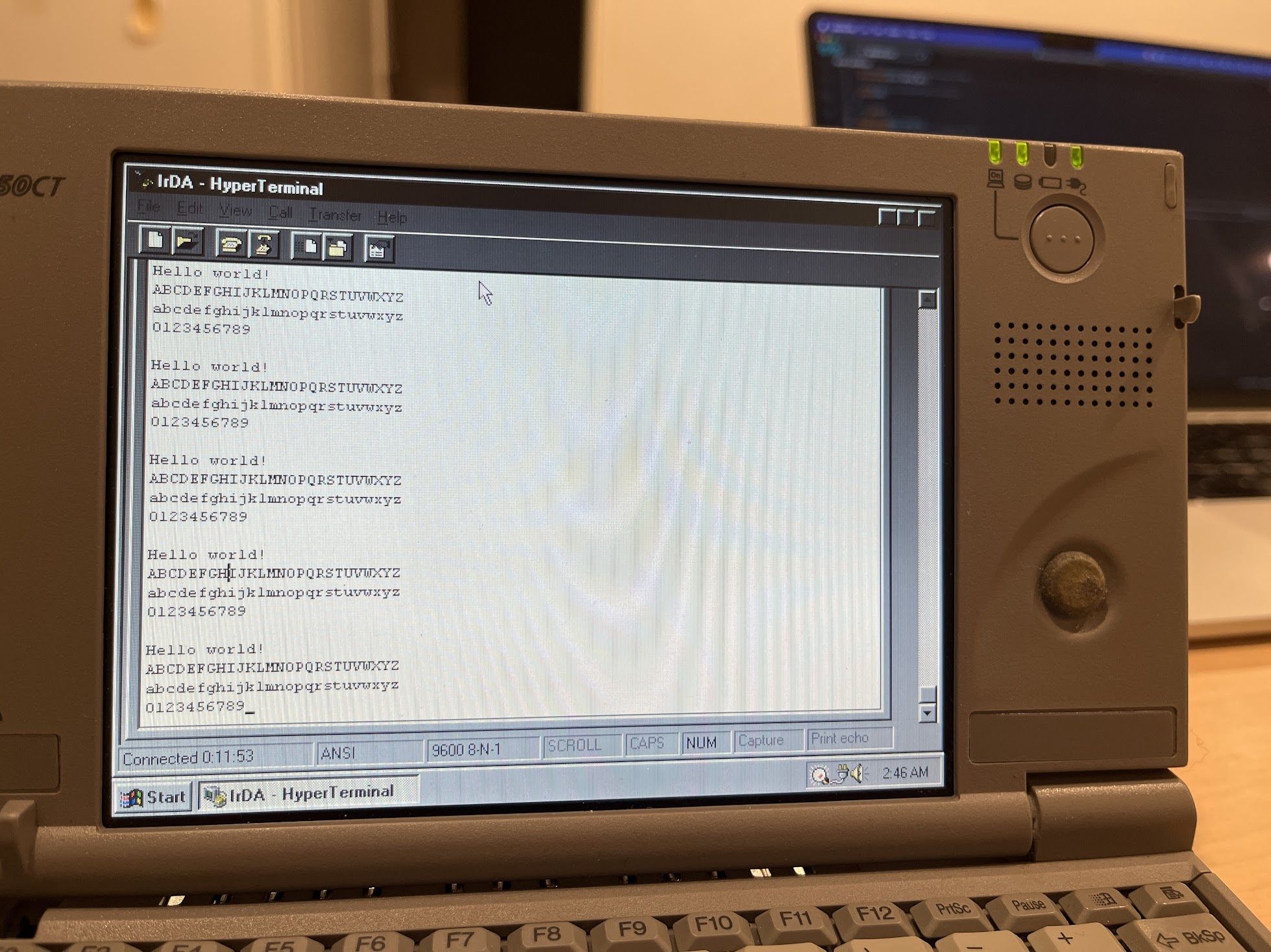

2. After some trial and error, I managed to use an Ardunio Uno, an IrDA encoder/decoder IC, and cheap IR LED to enable uni-directional communication from the Ardunio to the Libretto via HyperTerminal. It took a long time to get to this point!
3. Next, I was able to get bi-directional communication working as well using the same IrDA encoder/decoder IC. It basically takes serial input, and turns it into IrDA, and vice-versa. Support hardware is very simple: just the IC, a clock crystal, a cheap IrDA LED, and a cheap IR photodiode that came in my Ardunio kit. It's all cheap, accessible, and repeatable.

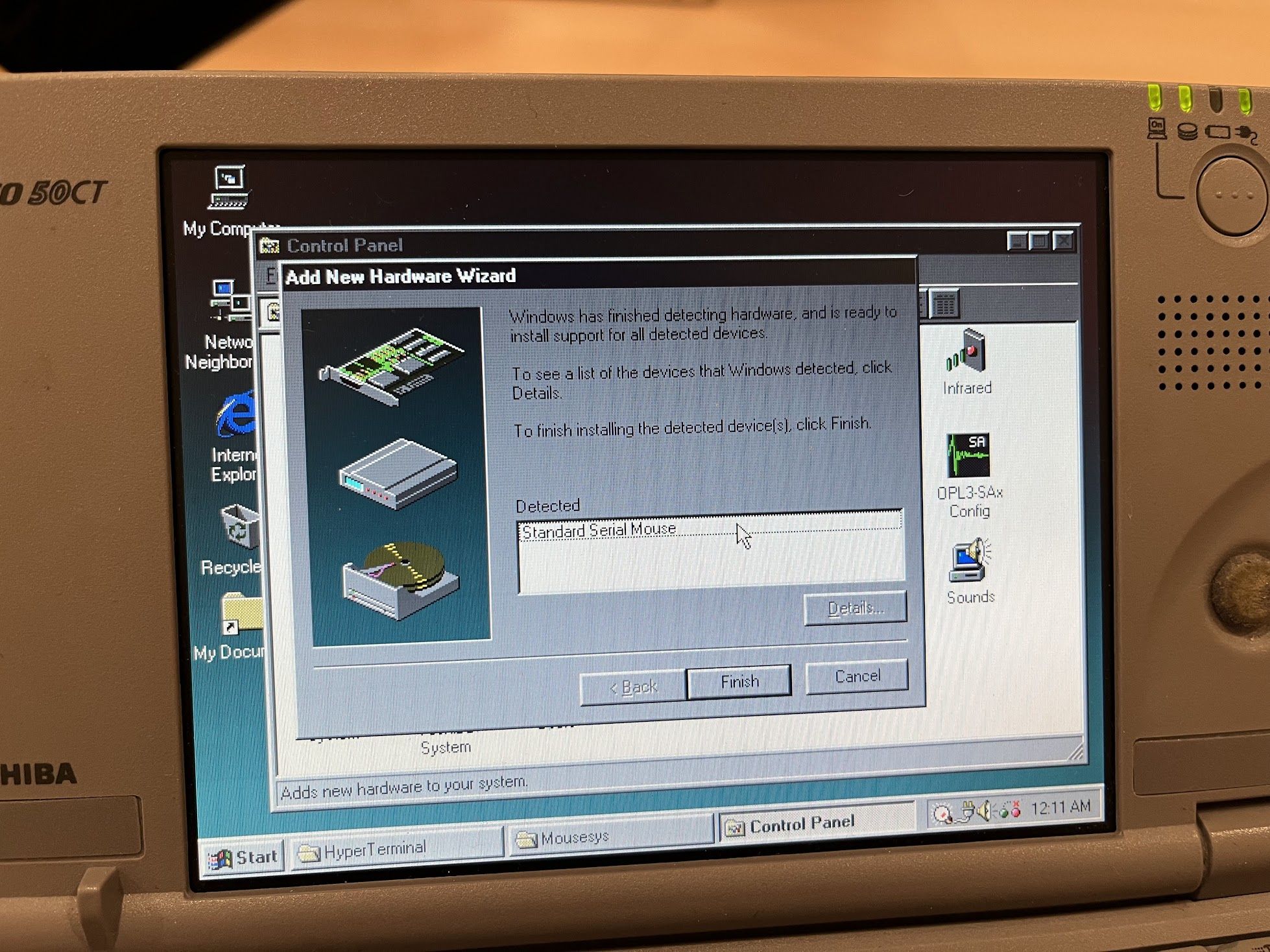

4. Next, I shotgunned Arduino sketches with Claude.ai, asking it to generate fake serial mouse data for me. Windows didn't seem to notice the "mouse", so I started looking into how Windows discovers mice, and found that it toggles the DTR (data terminal reset) line, and expects to hear something specific back from the mouse in a tight timespan. It doesn't look like the concept of DTR exists in IrDA, so this didn't go anywhere. I tried shotgunning a few sketches that would spam the response from the mouse while the machine booted, but that didn't work either. Finally, I shotgunned an Arduino sketch with Claude.ai that would advertise a Plug and Play device, and that got some movement - Device Manager picked it up as a mouse! That tells me that the serial data is making it to where Windows 95 can see it. Sadly, I couldn't get any fake mouse movement to work - just a "dead mouse" in Device Manager.
