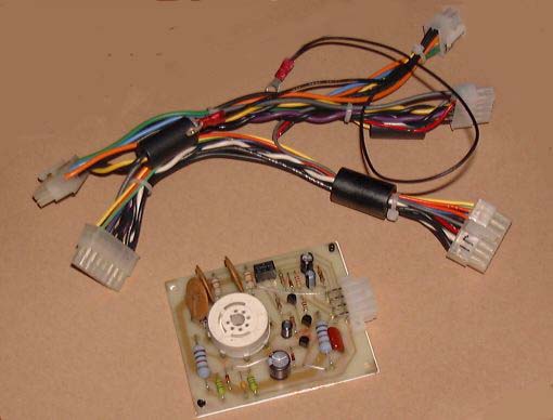

After a bit more research, it turns out that it is NOT a chip but a Micron CRT video board, as shown below in the first picture. In the second picture is a homemade video board.
Now, that is Tinker differently! We need to identify specifically what that homemade CRT video board is and see a modern solution that could replace the existing CRT video board attached to the CRT. Imagine all compact Macs being able to display in grays if this were to be pulled off? The current barrier would be a video adapter device (PDS for SE or SE/30 and external SCSI for older compact Macs) is still required.

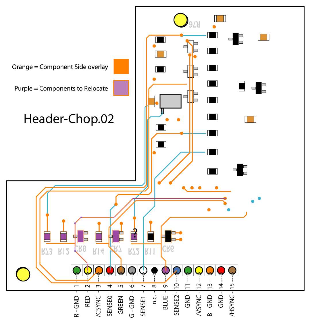

Since you're familiar with it, will the Extron drive your 1024x768 LCD? If so, just about any VidCard would work. The Radius Color Pivot II/IIsi outputting its 16" best resolution would be a great find. Dunno what price they command now, but they were untested/dirt cheap for quite a while from macmetex on eBay. Many folks have timnkerd with using it in the SE/30, fitment of the overlong PCB is the only issue, but I've had the IIsi Pivot Card HeaderChopHack on the backburner for several years.
In this10x10 PCB era this would be a great project for someone. PCB would have a DIP header for IDC cable breakout, replacing the quirky, long OEM connector. It would be mounted on headers 7-16 and bolted up to the (yellow, next to R76) hole and the bolthole on the PDS connector for three point stability. More and better pics of below in this thread.

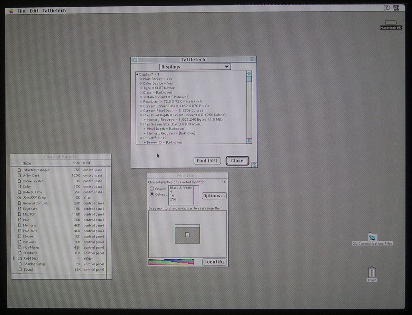

By the way, you can take a screenshot under System 7.6 by Command-Shift-4. For more information, check out this article at Apple Wiki. For below System 7.6, I vaguely remember another way to take screenshots but cannot remember how?

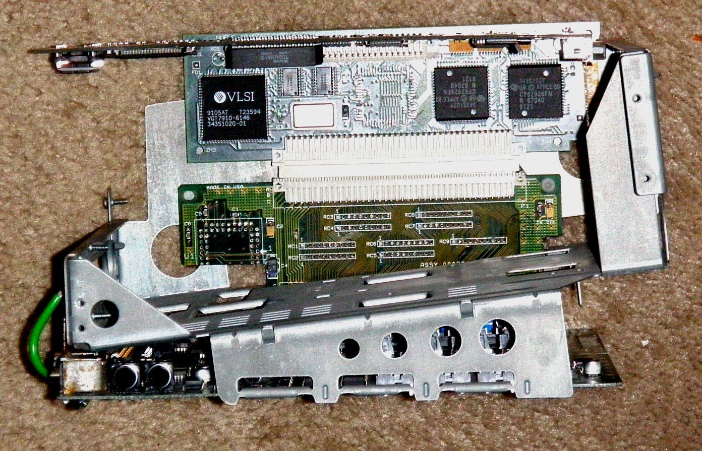

Looked, couldn't find the card for specs/pics. Screenshot wouldn't help you anyway, it doesn't show anything but the contents of VRAM buffer. The unmercifully hacked board in the pic is a SuperMac IIsi adapter for the SE/30 VidCard in question. I've collected all kinds tinkerables over the years.
