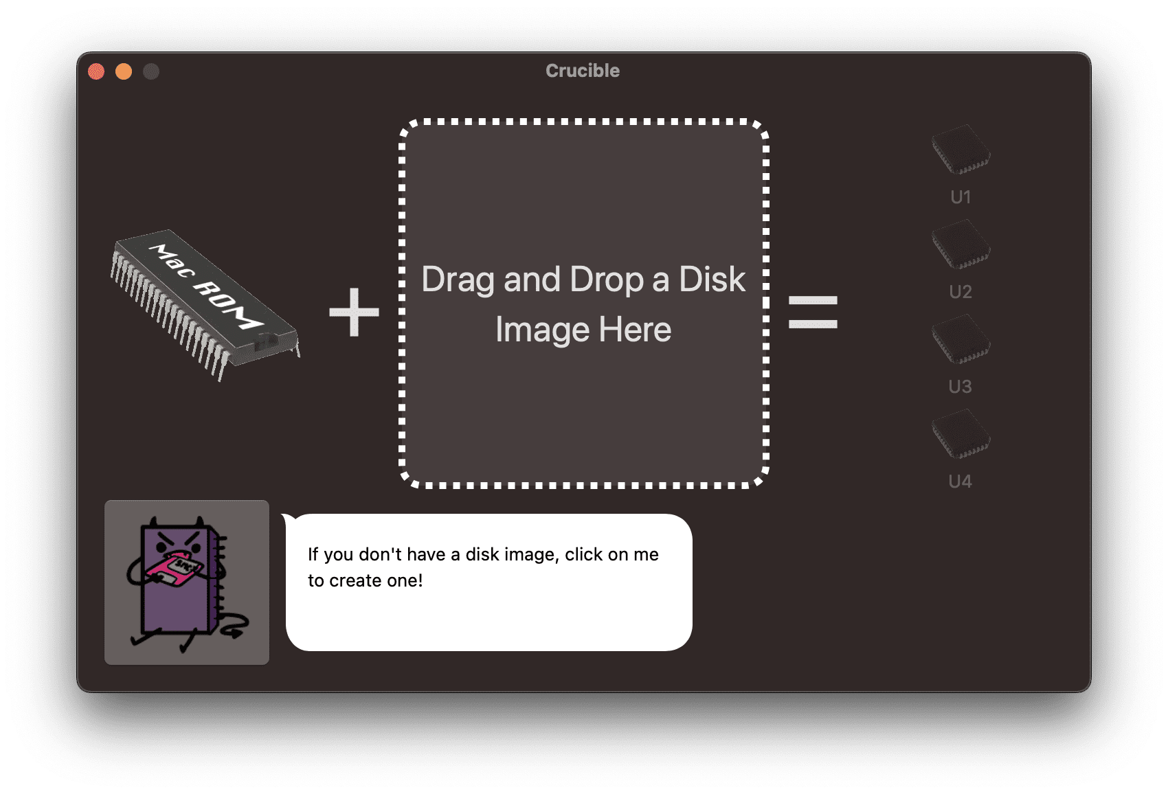

There are several steps to creating a ROM, and to shortcut this, we created a Mac App. called "Crucible" with @OneGeekArmy

The program does not require any C language. Crucible does all the tedious and confusing stuff for you.

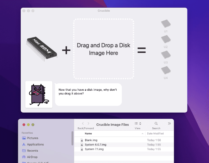

1, Create a 1.5MB boot disk that includes the 7.0.1 or 6.0.8 system
- A boot disk image can be created. These can be created by selecting blank, System6.0.7, and System7.0.1. The created ROM will be completed in the Download folder. These are simple system folders only, so they don't contain anything other than boot. This is edited using the Mini vMac emulator. Specifically, we will add software and function expansion documents so that the upper limit of 1.5MB is not exceeded.
2, Combine the ROMs in Crucible and split them into four.
-Once you've created a boot disk to your liking, come back to the Crucible and merge it with the modded IIsi ROM and split it into four. The split Bin files (U1, U2, U3, U4) will be in your Download folder.

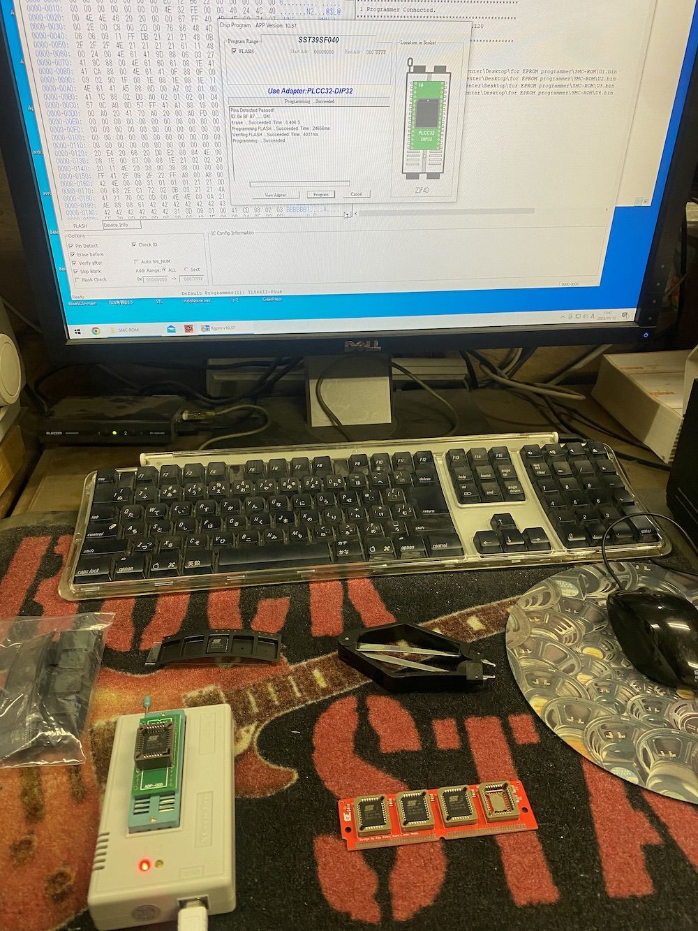

3, Flash the finished 4x ROM files (use a ROM programmer)
*Please note that this work does not use Crucible. The latest T48 ROM programmer is not compatible with Macintosh, The TL866II+ has a third-party Mac program, but it needs to be the latest MacOS in order to set it up via Homebrew.
Steps 1 and 2 are performed on a Mac, but ROM programmer software is only compatible with Windows, so flashing the ROMs must be done using Windows. Use the TL866 or T48 flashing software to flash all four split Bin files (U1, U2, U3, U4), and then set the resulting EEPROM onto the SMC ROM SIMM.

Crucible already contains a ROM file that it will combine for you with the image file you want to use.
You can either use an image file you provide (as long as it's smaller than 1.5 MB as you point out) OR you can use one of the built-in images that Crucible can generate for you:
- a System 6.0.7 boot disk
- a System 7.1 boot disk or
- a pre-formatted empty disk image (of the correct size of course) that you can fill up with anything you want.
So to sum up, Crucible already contains the ROM file (no need to worry about it) and will automatically merge it with a disk image you provide. It will then create the 4 files that need to be copied on the 4 ROM chips using a chip programmer (and put them in your Downloads directory).
If you don't have a disk image handy, it can provide you with one.
If you want, you can try Crucible and see how it works. You can go through the process all the way to the creation of the 4 files.
(we tried to make it fun too :) )

  1. Make your custom disk image. Anything that fits into a 1.5MB image is okay -- even a blank 1.5MB image. That can be a System 6 boot disk or a System 7 boot disk, or be a boot disk with small apps on it too, but you must prepare that 1.5MB disk image first, and it would be best test it with Mini vMac.
  2. Your single (not multiple!), 1.5MB *.img file is what you Drag-and-Drop onto Crucible, so Crucible will combine your 1.5MB image with the IIsi ROM image that is built into Crucible (no need for the user to prepare it), and then Crucible will split the result into 4 separate files and save them into the standard MacOS "Downloads" folder.
  3. The user must then individually burn the 4 files to 4 IC chips using a special programmer (TL866II+ or the newer T48) and special software (Windows-only for the T48) which operates the programmer.
  4. Finally, the user must put the 4 chips into the sockets Kero's Mac Mods' ROM SIMM, following a particular order -- you cannot put the ICs into the ROM SIMM sockets at random.

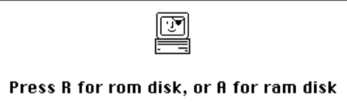

The BMOW ROM-inator II gives users the option of pressing a keyboard key to choose either ROM Disk or RAM Disk (where the content of the ROM is loaded into RAM for the purpose of changing data, which cannot be done on the basic ROM Disk)...
But I believe Kay's ROM is ROM Disk only. There are no special modifier keys at boot time for Kay's ROM.
