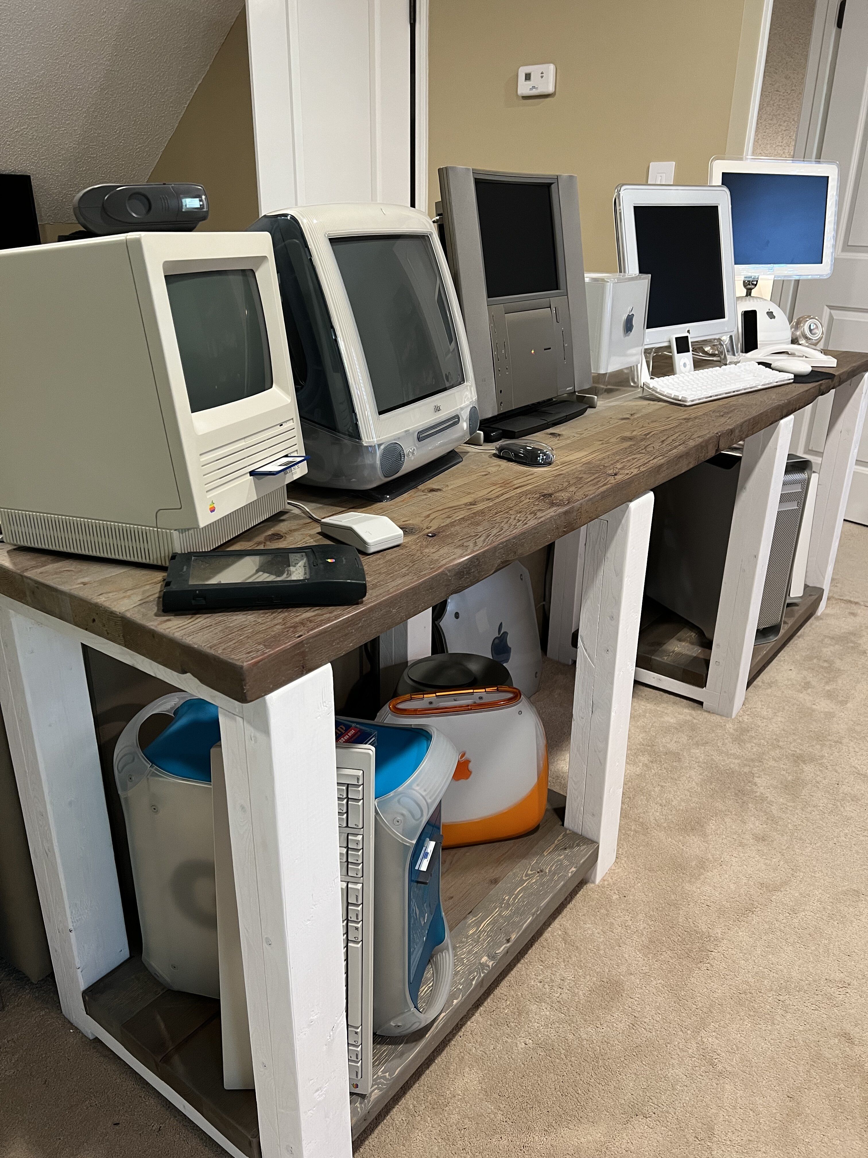

Picture of my collection (My PM G4s are at my workspace right now trying to figure out the KVM / monitor setup):

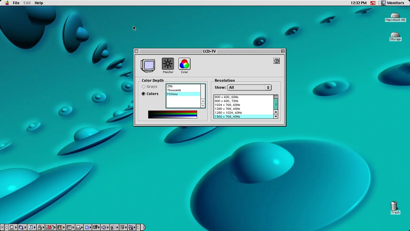

1366x768, that is a tricky resolution to work with. I have a TV that has a native resolution of 1366x768 and I used it as a monitor for a few years. Even though that was its native resolution I always ran it at 1360x768. The TV basically supported three resolutions without scaling, 1366x768, 1360x768 (Which adds a 3 pixel wide bar to both sides of the screen), and 1024x768 (When set to a 4:3 aspect ratio). Long story short the fonts looked better with 1360x768, I don't remember the exact reason why. So if the computer reports 1360x768 try it.
I also just verified that OS 9 works with 1360x768. So if OS 9 doesn't see that resolution your display may not be reporting it or the graphics card isn't registering it as a valid resolution. I did the test on a Beige G3 with an ATI Radeon 7000 with VGA out and I connected it directly to the TV with a standard VGA cable.

I made the display table out of cheap 2x4 lumber with the top made of cedar. Since I'm not using it too often and it has a rustic finish on it, I'm not too concerned with the softness of the wood. Hoping to add a relatively shallow full extension drawer with the LCD on a hinge so it will slide out and flip up, with a keyboard and mouse underneath.
When I built it, I figure I'd have tons of room for my collection to grow, but since adding a TAM and 3 more PowerMacs. I also have a NeXT and Apple II Plus clone I've got to find room for. And a few more Powerbooks. It's turned into quite an addiction for me during the WFH year and a half.

Yeah, I originally considered trying to add a top shelf above my unit, but I’m thinking a taller, multi-tier shelf unit may be in order. Have this one for devices I used regularly, but the shelf could be for devices not plugged in or ready to use.
Sadly no plans. I kind of winged it, since I knew the basic dimensions of the finished product. I made the top from 8’ 2x4 cedar planks joined with wood glue and biscuit joints. Then the two bases I built 4 rectangles out of cheap 2x4 white wood lumber, connected the pairs with a 2x4 at the top and bottom using pocket hole screws. That gave me 2 cubes to rest the top on. the bottom shelfs are the same as the top with notches cut out around the legs. Carpentry isn’t my forte, but it was a fun project and the thing is very sturdy.
Well, I think that unit came out really nicely. I like the look of "barn yard" builds. I think yours looks fantastic. The cedar grain top really makes it happen for me. They look like you reclaimed them right off an old tool shed and the white base comes off "white washed" and yeah, the whole thing is awesome - great job. I did something similar and just built some floating shelves from reclaimed wood from old book shelves I had (these were my folks shelves from the late 70s when I was a kid in the 80s & I somehow have always hung onto them. Anyhow, I now have just one of the shelves and have repurposed the other two into a floating shelf system for my computer room. I like the look and now my BT network printer and classic macs have a home on the wall. alongside my other junk :)
